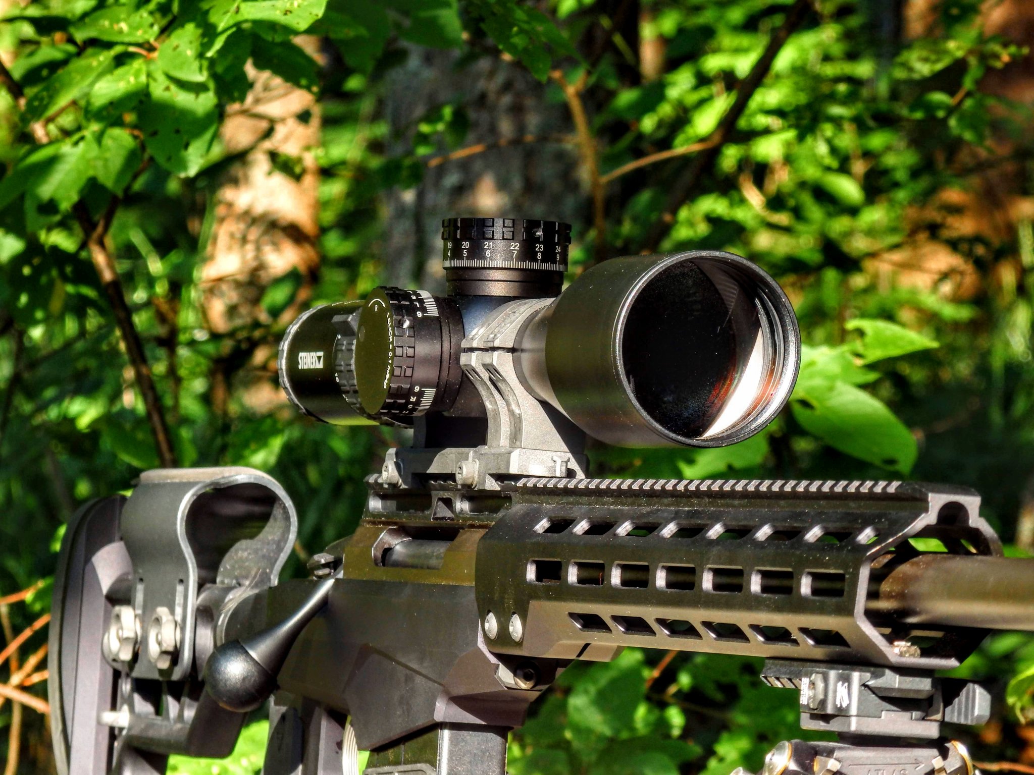

I have been testing for a week now Steiner M7Xi 4-28x56scope.
Awesome glass, just freaking awesome.
Reticle is not the idealist, but it´s not bad, G2D reticle.
Zero stop is also very nice, much like a Kahles K624i i have, easy to adjust.
So far i have shot 100-zero and some 100-m and 300-m shooting, just waiting to get to a longer range.

This is the scope I have the most interest in personally. Tangent is beautiful but I like what the Steiner offers with regards to overall size and magnification range. Not to mention more competitive pricing.
This has by far the best image quality i have seen.
But this one has the G2B reticle, which is not ideal, there has more better for the choose, like MSR, MSR2 what i think is the best reticle ever.
Also Tremor T3 is available, that´s not bad either.
I wish i had that camera adapter for the scope, that image quality is just awesome in this scope.
Reactions: charnicus
