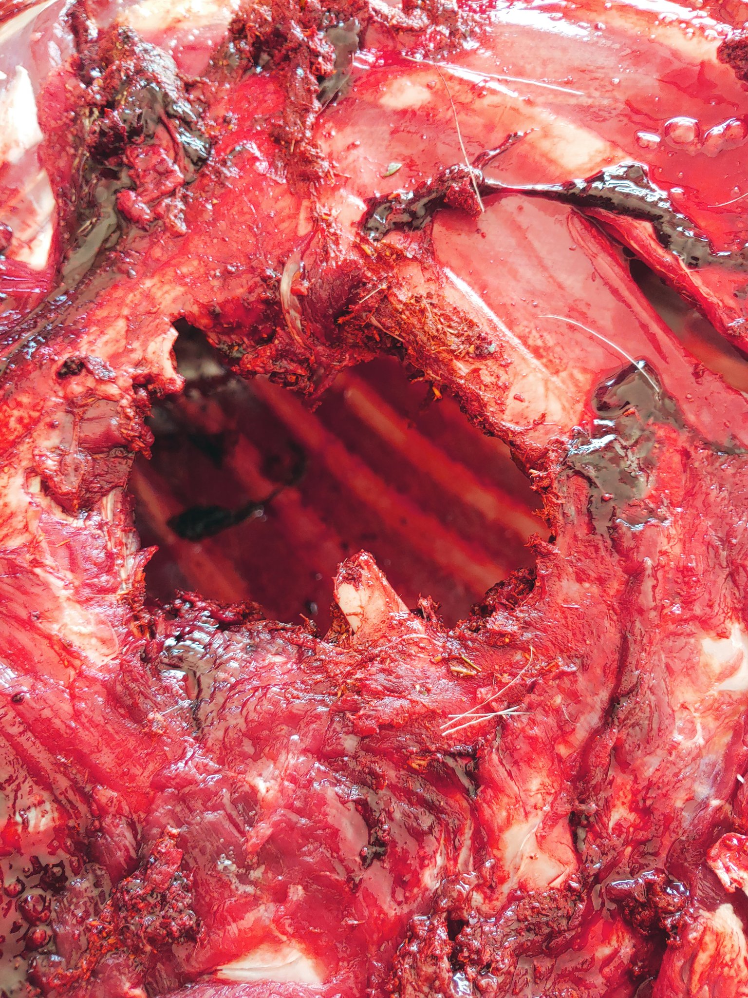

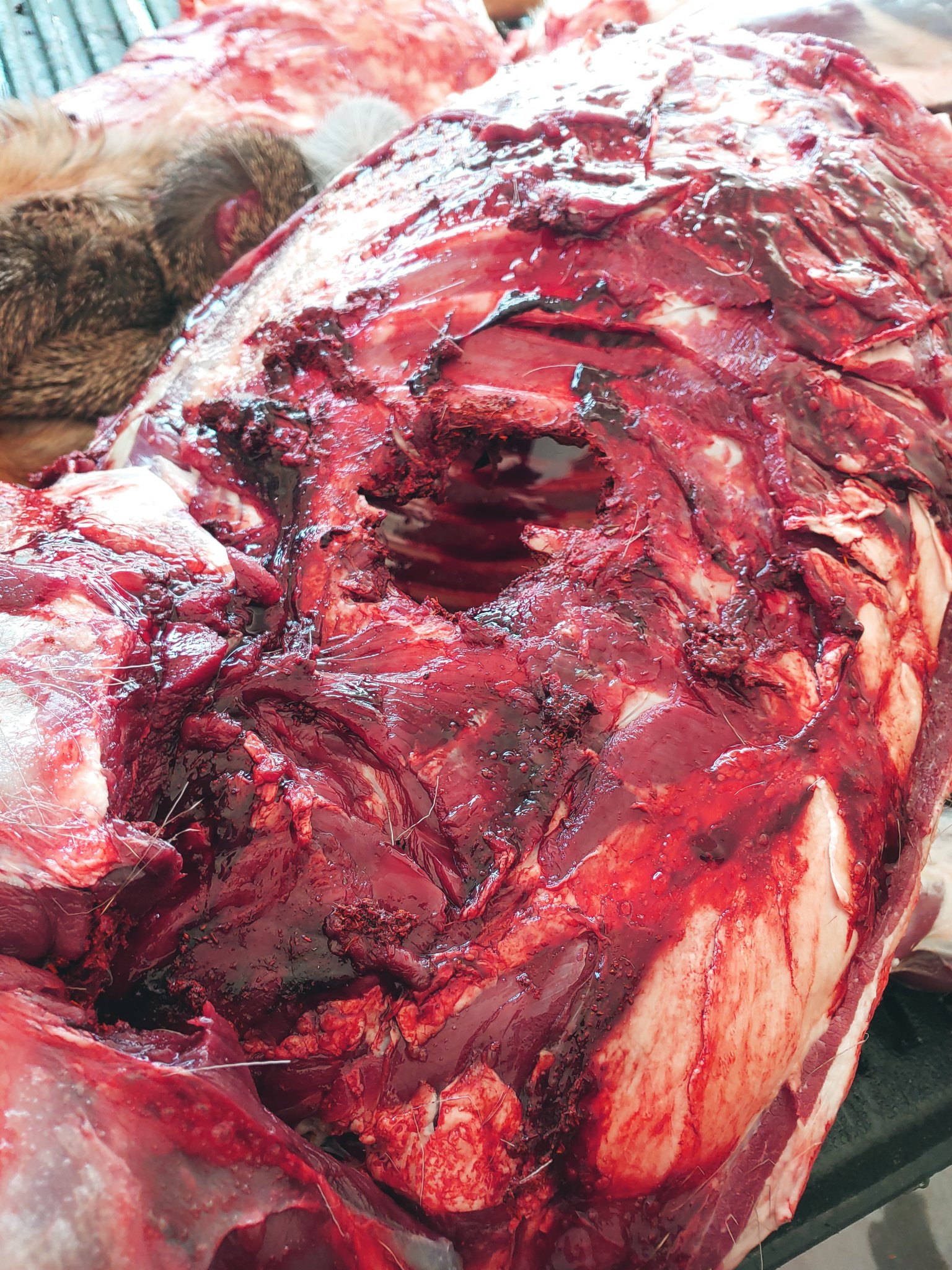

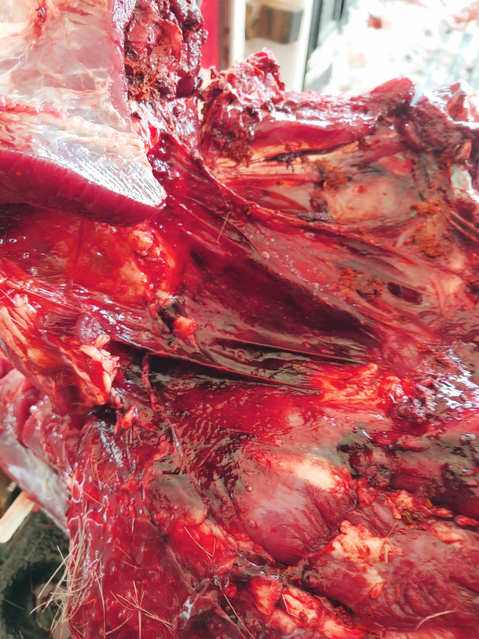

First animal down with the 7mm 151. Mule deer buck at 472 yards. I am very shocked at the damage it did and the entrance hole. But the buck only took maybe 3 steps like to run and slide down the mountain into a tree.

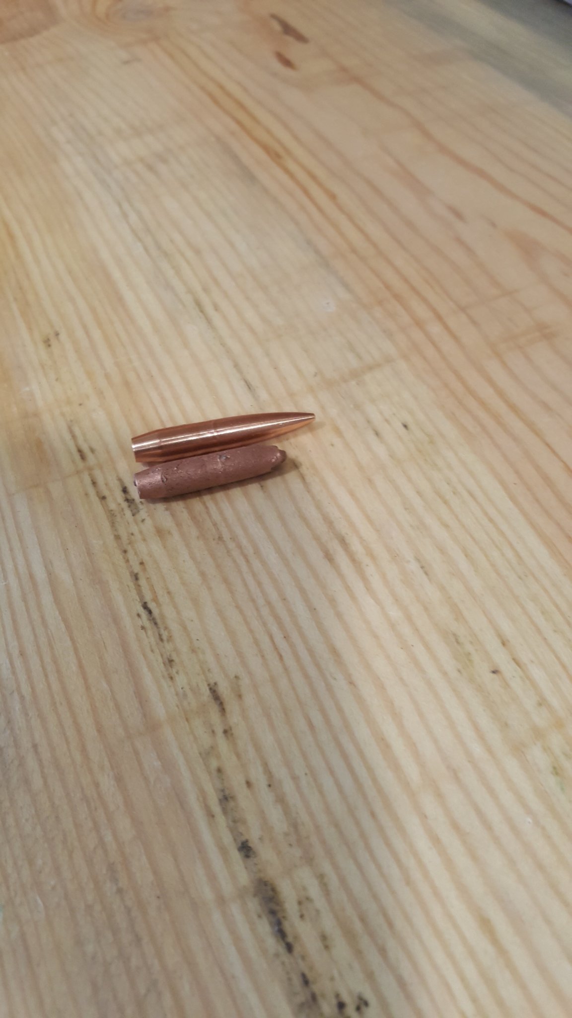

Here's a recovered 170 that I dug out of wet clay at 765 yards, it weighed 159 grains.
I know this isn't a great test media but I'm really not liking what I see.
A recovered Barnes LRX from the same distance and media was a classic mushroom.
I'm not using these on elk this season, I'd like to hear more reports first
Those are great pics! Thank you for posting them. The damage is indeed massive and it reminds me.of the pics that coldboremiracle published last year with the cow elk they shot with prototype 122s in a creedmoor.
Congratulations on the deer!

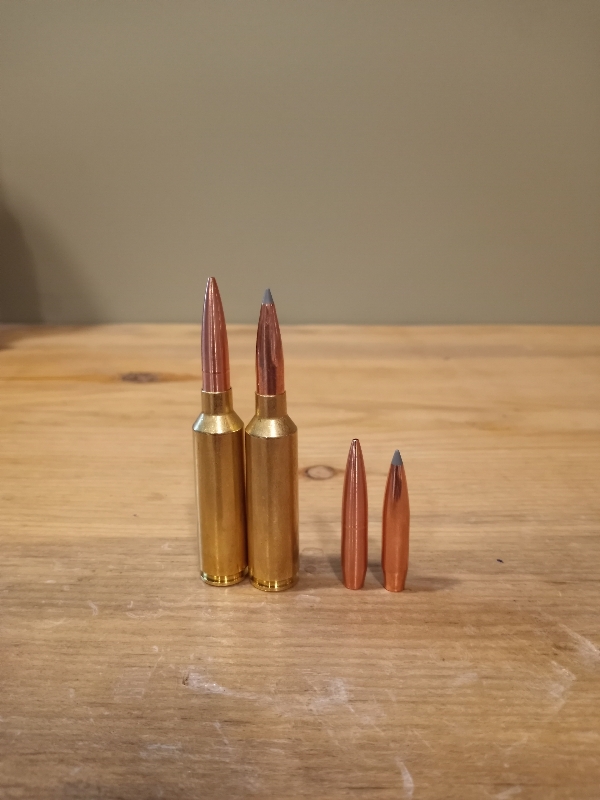

How did these work in your 7wsm. I’m building a hunting rifle in 7 saum and would love to use these 171’s. What barrel length and speed are you getting?
Quick question for @bohem
I just got a pack of your 170 cayugas today that I'll be shooting in a custom 7 wsm.
I should have it back in a little over a week and I had it throated for 175 ablrs.
The bearing surface of the cayuga is about .045 shorter than the ablr so its gonna have some freebore..
Are they sensitive to jump?
Awesome looking bullets BTW
Heres a pic of the two with the ablr at 3.1 and the cayuga at 3.2

I use his 151 and they are awesome dont over look them. I posted pics of a deer shot at 472 with them

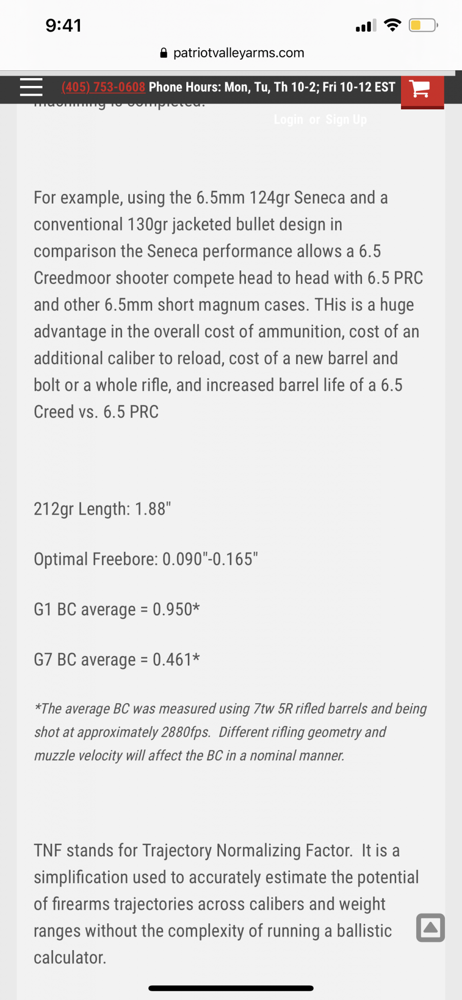

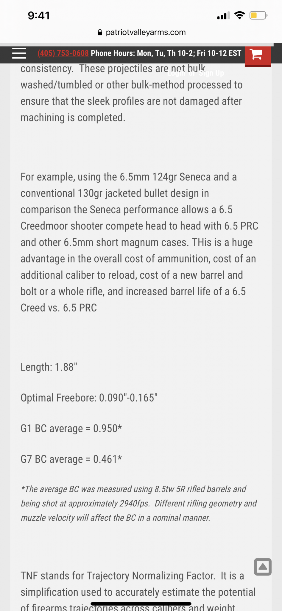

I am considering the 198 or 212 Seneca for a 300 prc. When I look on the site they appear to have the same specs other than twist rate for testing is that correct? I want to try some elr type shooting in the future and am not sure which would be the best fit.
The 212 is a "stretch" version of the 198
It has about 214/198ths of the BC that the 198 does. The slight increase in form factor efficiency is due to the length increase.
I just double checked the website and the specs that are the same is the freebore length. The BC, length, weight, etc appear to be appropriate for the 212 unless I am missing something.
PS: they are in stock and currently on sale through Monday for Black Friday.
I plan on buying some just figuring out which would fit the 300 prc or Sherman prc best. I took a screenshot to show what I meant on the 198 and the 212. Doesn’t really matter, I just want to figure out the best for the cartridge try elr out at spear point at some point.
Good catch! It wasn't the 212 that was wrong, it was the 198 that had 212 data in it.
I updated it and fixed it now. Thanks for the heads up.
