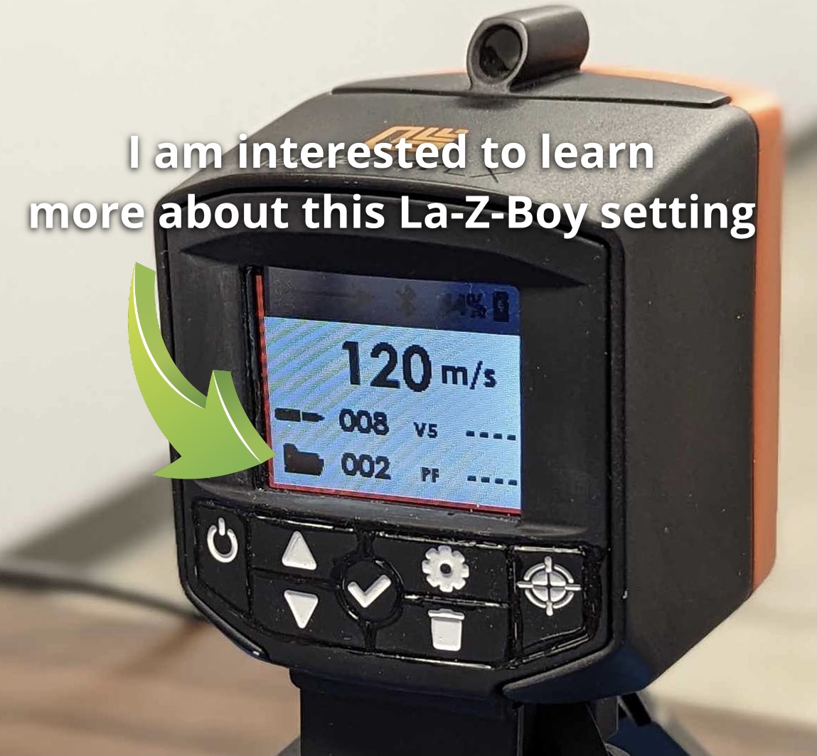

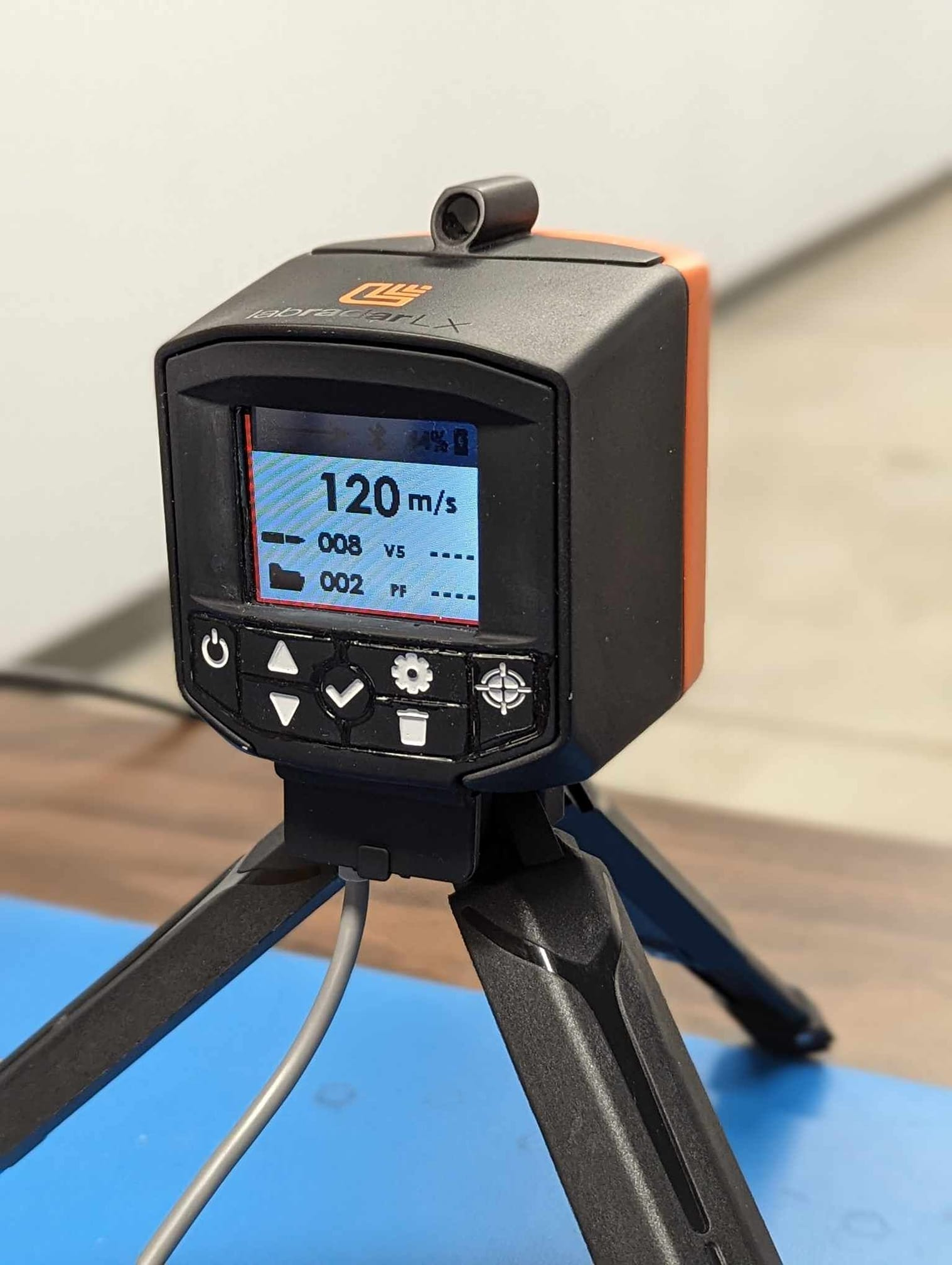

The "marketeering" associated with this photo is impressive. The LR-LX is full bright, shows a high velocity, has a full(er) battery, shows Bluetooth connected, and is displayed from the front where size is similar vs. the side where size is a huge disadvantage for the LX. The Garmin Xero is displayed with virtually no backlight, no registered velocity or statistics, a half-full battery, no Bluetooth connection icon, and displayed from the front where the LR-LX doesn't look like a shoe-box to Garmin's match-box size. It's like every sales display for a clock or watch, where the time is always 10:08 ... so the hands look like a "smile" and make you feel better about buying the clock. Bravo to whoever took this photo ... they obviously passed "Marketing 101" in their undergrad work.
They also have the LR closer to the camera giving it more command or prominence.

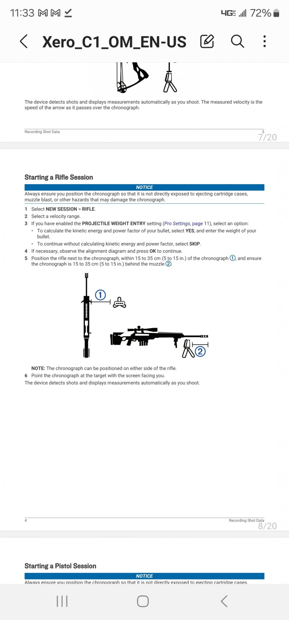

You can smart ass all you want but a dude that is smarter than both of us and made first rifle mounted radar years before Garmin and Labradar, explained in a post how and why both offset and orientation can influence measurements.
Looking for most consistent measurement you need constant offset and angle , best facilitated by rifle mount
There is no magic compensation going on by Garmin or Labradar its just inept users inducing errors and thinking the magic box does magic things :eek:
Well here’s the thing. Academically I’m sure you’re right. But I think what the other guy is getting at is that the velocity isn’t going to vary super significantly.
More importantly, if you’re keeping the relationship between the Garmin and the rifle the same, consistency should be fairly good, which is what most of us are likely after.
I don’t really care THAT MUCH if the bullet is moving 2806 or 2817 or 2830. Hell one chrono to the next has variance like that. What I care about is seeing the general speed and consistency.
In the tests I have seen with Garmin, they’re pretty damn close.
Most importantly, the data from the Garmin is a hell of a lot more useful than missed shots! And I think that’s what the other guy is getting at.
What I saw is Garmin screen size larger while total unit size more compact. 🤷‍♂️

Er....and where did this pic come from, please?
Also came from the Yanick Sab Facebook page (same as pic below) although the original photo (of the Garmin vs LX size comparison pic)I think came from Ryan Cheney ELR's Facebook page. This is probably the last pic I'll post unless I can find more size comparison pics between the Garmin (or other units) and the LX. I think most of us got a general idea of what the size/form factor of this new LX is.
Looking for most consistent measurement you need constant offset and angle , best facilitated by rifle mount.
Garmin at least reminds the user on the screen at the start of every series of optimal placement .
Still looking for a 360-degree view to tell where the charger plugs in, whether there's a SD Card slot, and if they included a port for an external trigger (or not).
Yanik said it got leaked early. Probably months away from actual in hand user testing. If it’s anything like LR of the past, more frustration incoming. I’ve tried other’s LR units. Royal pain in the ass to use with Rimfire.
I think it's on the bottom. The last pic I posted has a grey cable (power? data cable?) and a trap door on the bottom. If I can find a clear pic of it though, I'll post it up.

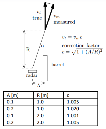

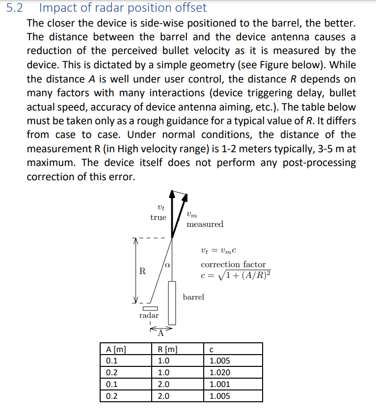

Do you know that Garmin doesn't take angle into account? Seems theoretically possible, to determine the angle of the projectile relative to the line of site of the radar by simply having data points on two points in space of the projectile, then being able to use that data to make a calculation that takes into account the angle.
I don't know that they do this. But I do remember the Garmin EE talking about an algorythm they use to normalize the calculated velocity which takes a few seconds - which is why you see the delay in the display.
Do you have any information that indicates Garmin doesn't take this into account?
More likely than not it doesn't have any correction for it as you have seen correction factor its in 3rd decimal if radar is placed at close to recomended position.
But same problem happens when you place it a different lenghts. to the muzzle or in elevation difference its a 3 dimensional error
Labradar LX having a sight is probably related.
These are problems unique to super short-range radars ,as the measurement zone is short and angular differences can be larger
But like said these errors are likely of no concern to most users.
Ah, so it doesn't matter at all and the placement differences are irrelevant to the results.
At most a 2% error that is constant in the same direction for a data gathering session.

that 2% was from a 10cm shift to the side on an andiscan that is 1m behind the barrel and 20cm from bore line, its not the most error you can have its just one sample
Lets remember posters that went bananas when chrono manufacturer advertised error less than 1%
Like said garbage in garbage out , its up to you.
You can't even read the offsets correctly

I doubt they would waste the code on it…in any realistic scenario it’s inconsequential, IMO
LOL
Educate me
error went to 2% from 0.5% in 20cm vs 10cm offset from bore line.
So your true MV when Garmin was showing 3000fps was either 3060fps or 3015 fps depending on 10cm difference in offset to the side
Garbage in garbage out.
Educate me
So your true MV that Garmin was showing at 3000fps was either 3060fps or 3015 fps depending on 10cm difference in lateral position.
