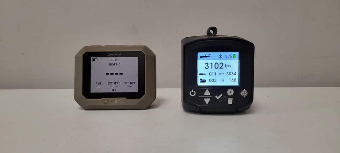

So you get with the Labradar LX
  • unit thickness 2x or 3x the garmin with the same width, with possibly? some battery life improvement (not that the xero has bad battery life at all)
  • metal case increasing weight, but no indication of an IP rating on the brochure which is weird
  • peep sight indicates to me that the beamwidth is atrocious, meaning the unit will be extremely oversensitive to changes in orientation relative to the muzzle without being mounted to the firearm or the firearm being prevented from moving much.
  • buttons on the front instead of the top meaning that applying pressure will move the unit if it's not in a mount or physically fixed in place
  • the screen is in color and isn't a monochrome, transflective LCD meaning that daylight visibility in the sun is going to be trash at anything other than high brightness settings (this is kinda important for anyone that doesn't shoot under a covered bench in good lighting conditions).
  • worse remote connectivity experience (and no information on whether it has remote CSV export or not without having to pull or use a microSD card)
  • same MSRP as a Xero
Yeah I don't see the appeal here unless you literally couldn't find a xero, but the Xero is on the market today, this is not (and who knows when it will be). On top of that, Garmin is a much better consumer electronics company, has a robust service and support division, and maintains their products overtime with feature improvements and updates.
Garmin is more able to meet demand and you can frequently find garmin units on sale at different retailers, when was the last time labradar even ran a sale on their units prior to the panic sale that started in october for full size units?

Comparison pic.

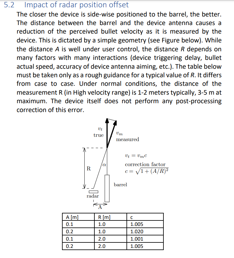

Why the peep sight, why would one need to aim their radar. Garmin figured it out. I don't even try to aim mine. Just point it down range. At least with the LR mounted to the rifle, it will always be aimed at the target. Probably be the only way you might be guaranteed to record all of your shots lol.
I suspect it's to maintain radar alignment in order to more accurately measure downrange velocity.
Reactions: JerkyFreak
any idea how Garmin gets away without needing to aim it?
Garmin can get away with it because it doesn't track nor provide downrange velocity, nor does it need to (for 99% of people's usage).
Personally, the only time I can see downrange velocity (200yd+) being useful is precision rimfire for software truing, but these small consumer grade doppler radars aren't really up to the task to begin with and I suspect this new Labradar LX will be no different.
You are not getting away with it , as folk from Andyscan have explained there are consequences to misalignment as in slight errors in velocity shown, all of these units will suffer the similar due to misalignment.
your suggesting if I have 5 garmins setup on the bench all slightly angled differently they will all read different MV? id love to see that test.
Reactions: FuhQ and Cole440
You can smart ass all you want but a dude that is smarter than both of us and made first rifle mounted radar years before Garmin and Labradar, explained in a post how and why both offset and orientation can influence measurements.
Looking for most consistent measurement you need constant offset and angle , best facilitated by rifle mount.
There is no magic compensation going on by Garmin or Labradar its just inept users inducing errors and thinking the magic box does magic things :eek:
