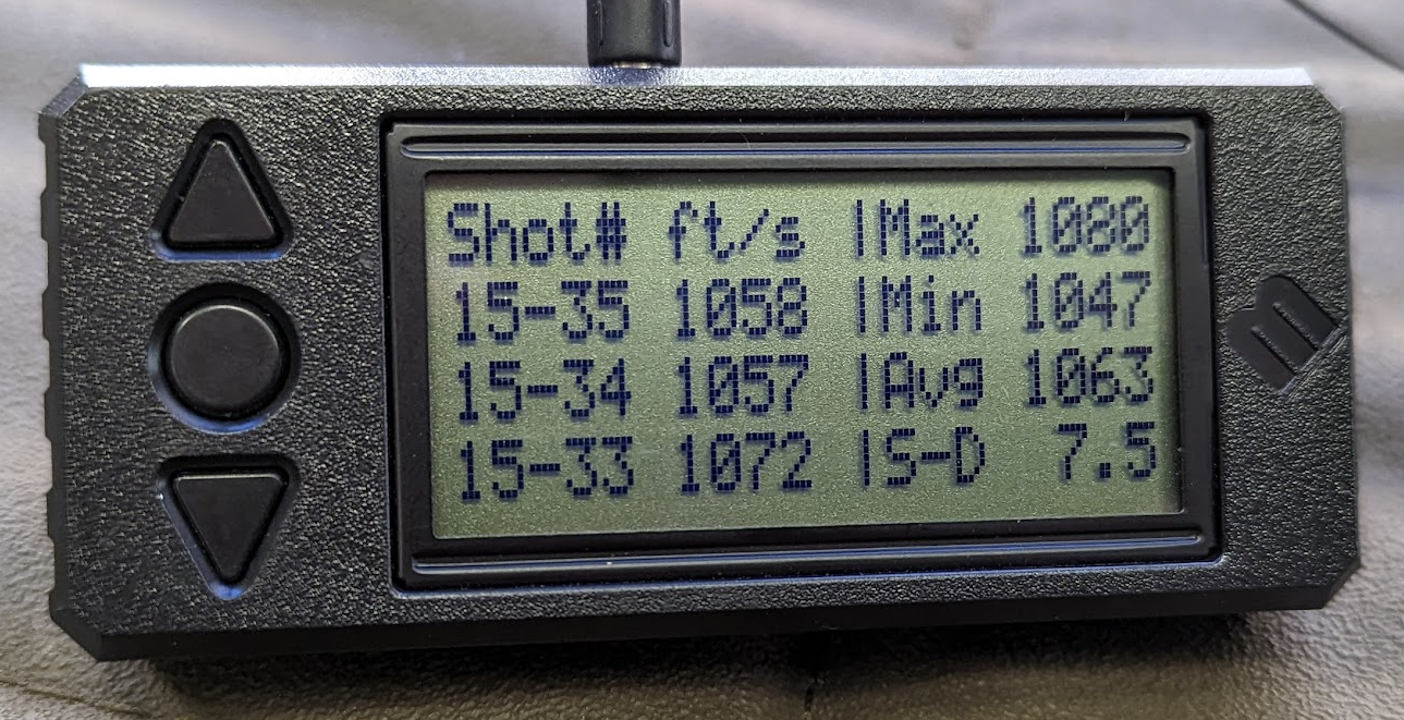

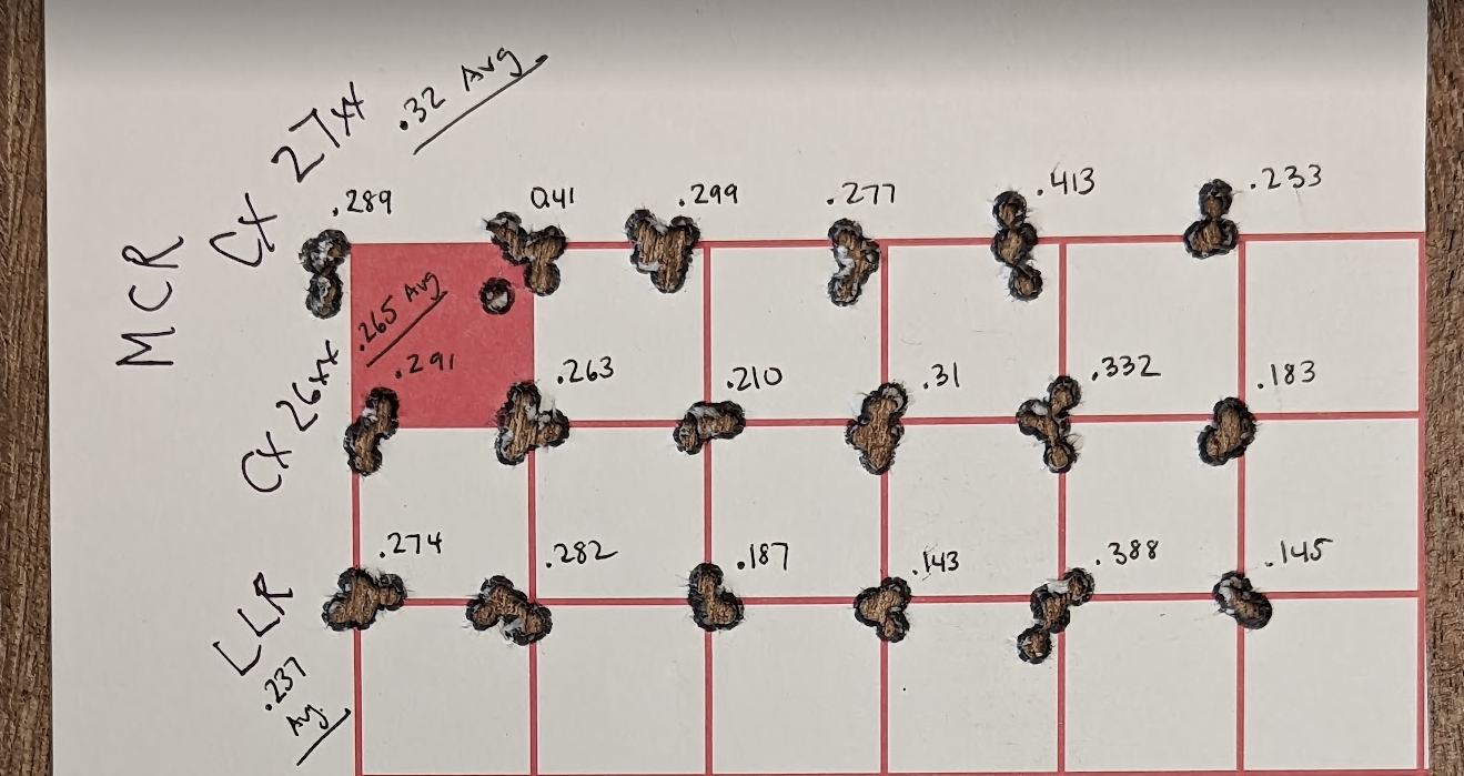

Well haven't shot groups in a long time, and shooting it all in prone, bipod and rear bag. The Center-X 27xx lot was from GSI random lot. The 26xx lot was lot tested at Lapua Test Center AZ. And the LLR was a random lot 36xx from GSI that I just got. First time taking them out for groups. Clean barrel so maybe that's why the 27xx was a little shaky to start or probably me warming up, it actually shot well at Lapua.
Chrono wise -
Center-X 27xx
Center-X 26xx
LLR 36xx
It was slightly breeze, like 1-3mph winds and 46 degrees.
I think I'll keep this LLR...
10 shot group at 104 yards was .75"

Your rifle definitely likes that lot.

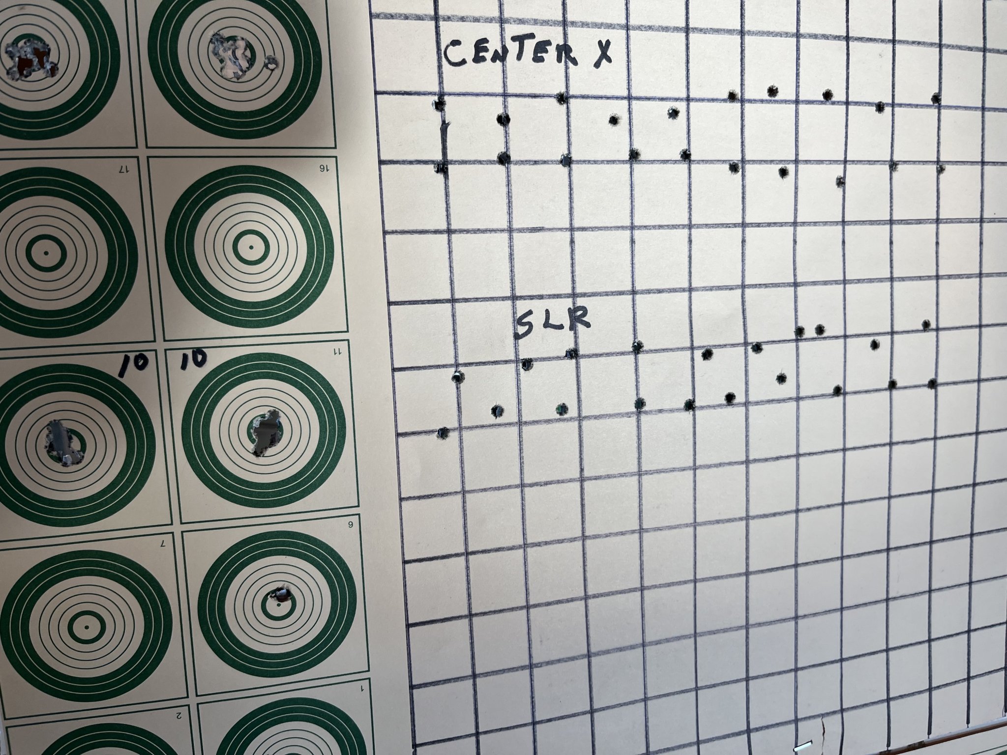

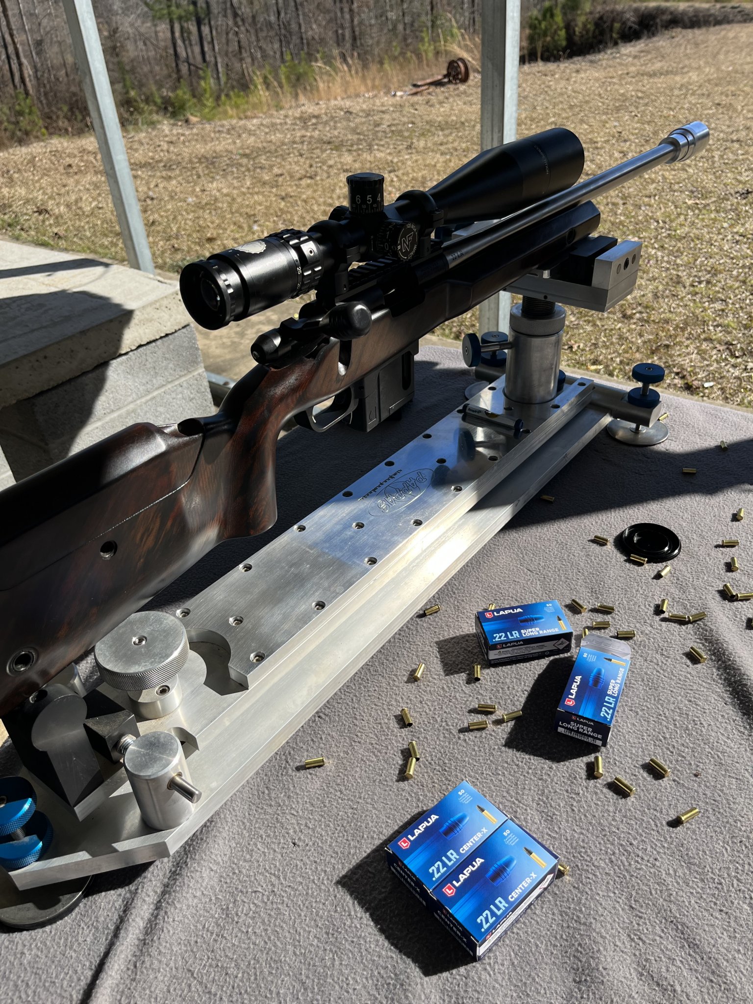

Spent most of the day today at the range shooting The new Lapua SLR against Center X. Gun used today was my Muller barreled Vudoo 360.. First I checked my tune at 50yds with this new SLR. My original tune with CenterX held up with the Faster SLR. One note about 50yds. Just because it says Long range don't think it wont shoot at 50. This particular lot of SLR is some of the most accurate 50yd ammo i've ever ran through this gun. After shooting multiple groups and grid strings most of the day the wind finally laid and i'm posting my final target shot at 100yds. Two 10 shot groups and grid strings with Center X. Then the same with SLR. My conclusions are the same as my first test. The SLR has a slight edge when it comes to vertical. One final note .The SLR groups don't reflect this less Vertical . Like a DA, I shot my hold points out. Scope was zeroed dead on for the grid targets. Most of the day the SLR groups did
show less vertical also.

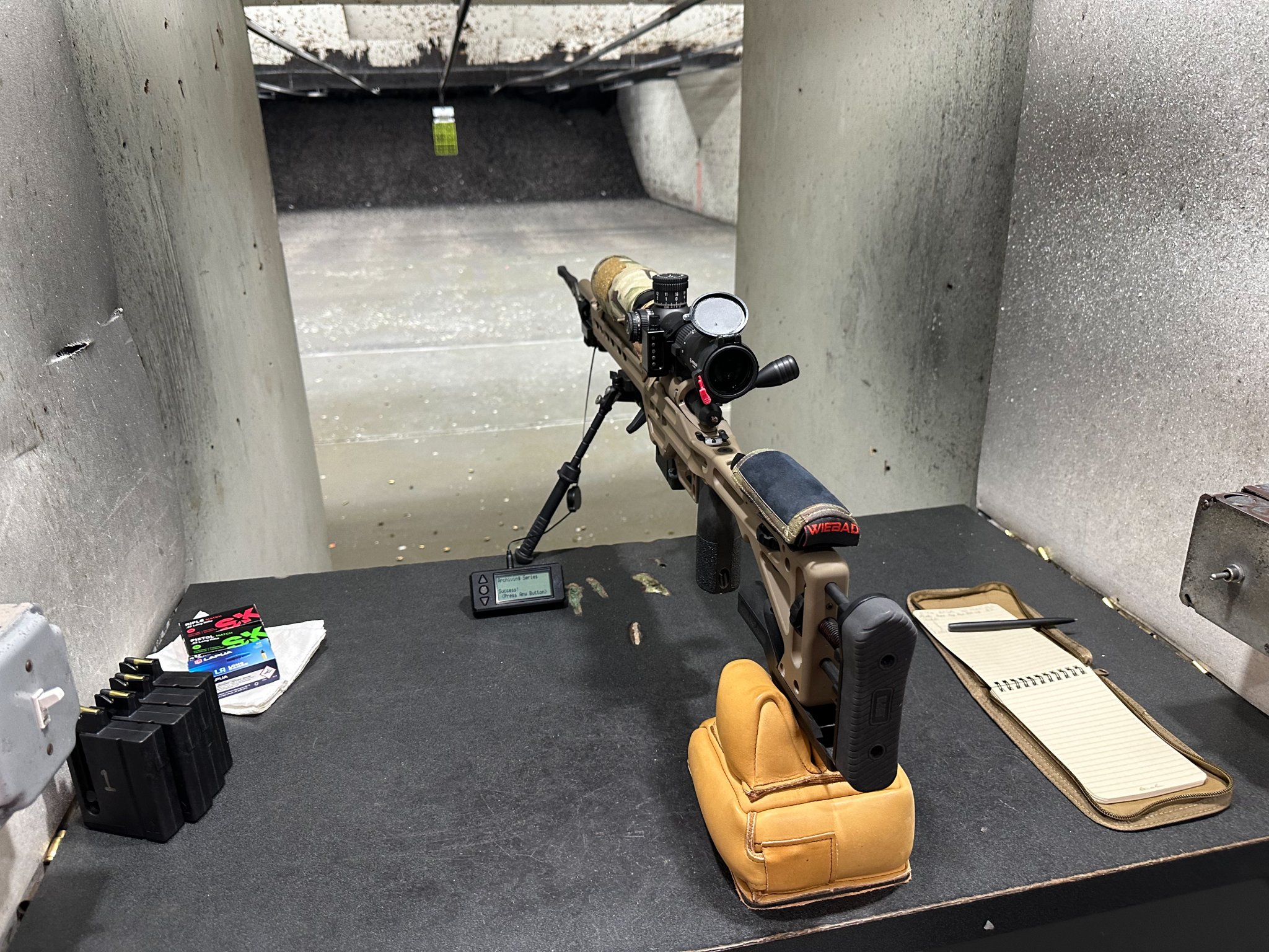

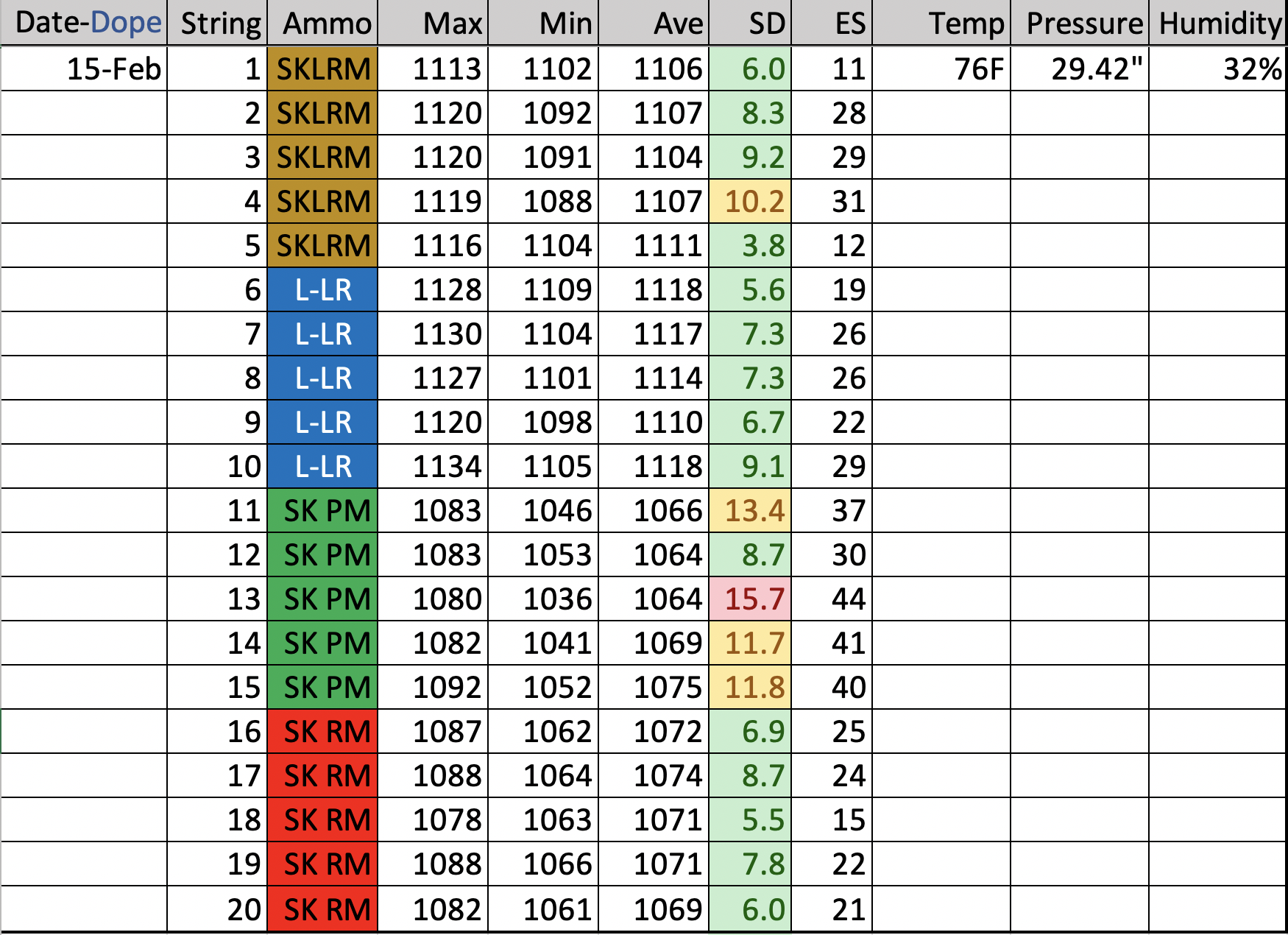

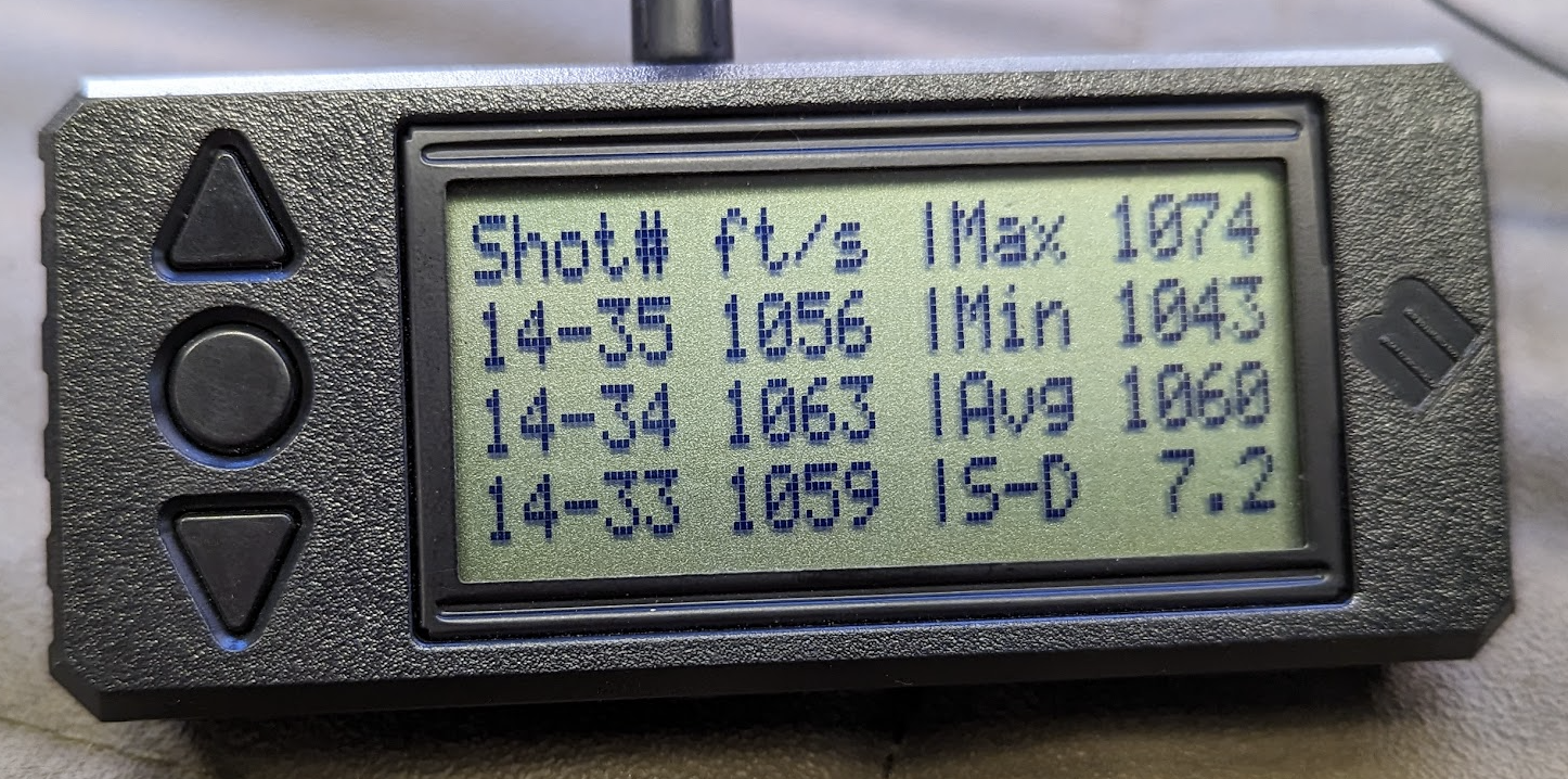

I made it to the 25 yard indoor range, test results below. SD: Green = <10, Yellow = 10.1-15, Red = 15.1+. Rifle is a Vudoo Three-60 with 20" Ace MTU 1:16" barrel. Accuracy was perfect (10 rounds in the same hole was easy), but why wouldn't it be at 25 yards?

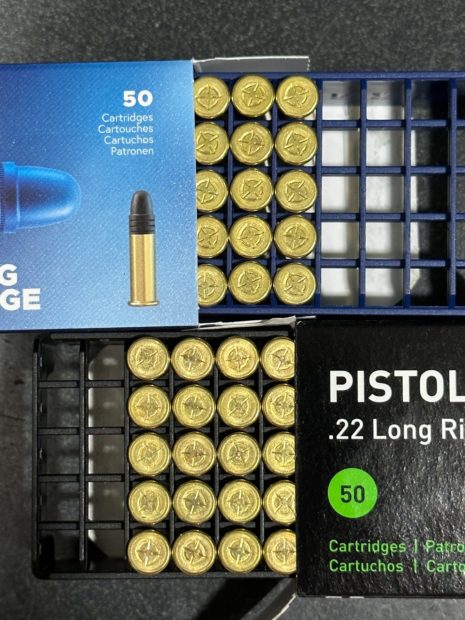

One thing I didn't know, SK and Lapua have the same head stamp...is that normal?
This is not my "good" lot of SKPM (SD 5.8-7.4), I have 4 bricks of that left that I'm saving for competitions.

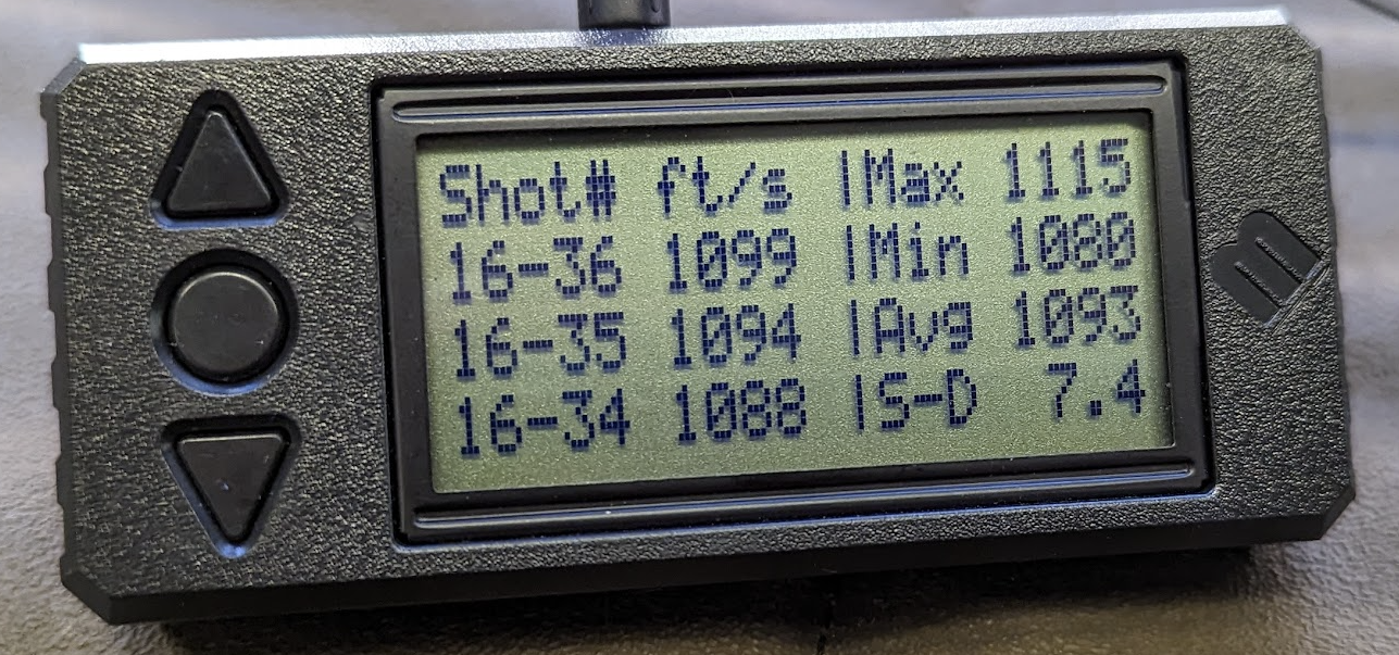

I lot tested my stuff. Was pretty decent at 50 and 100. Going to really test it this Sat out to real distance.
Avg 1092
Max 1107
Min 1081
SD 8.1
Avg 1092
Max 1107
Min 1081
SD 8.1
What was the ambient air temperature when you tested? It was pretty warm (76º) at the indoor range today, maybe that's why I had higher MV out of Lapua LR and SKLRM? What barrel length do you have, that could be part of the MV difference too?
Correct. Lapua and SK share the same cases.

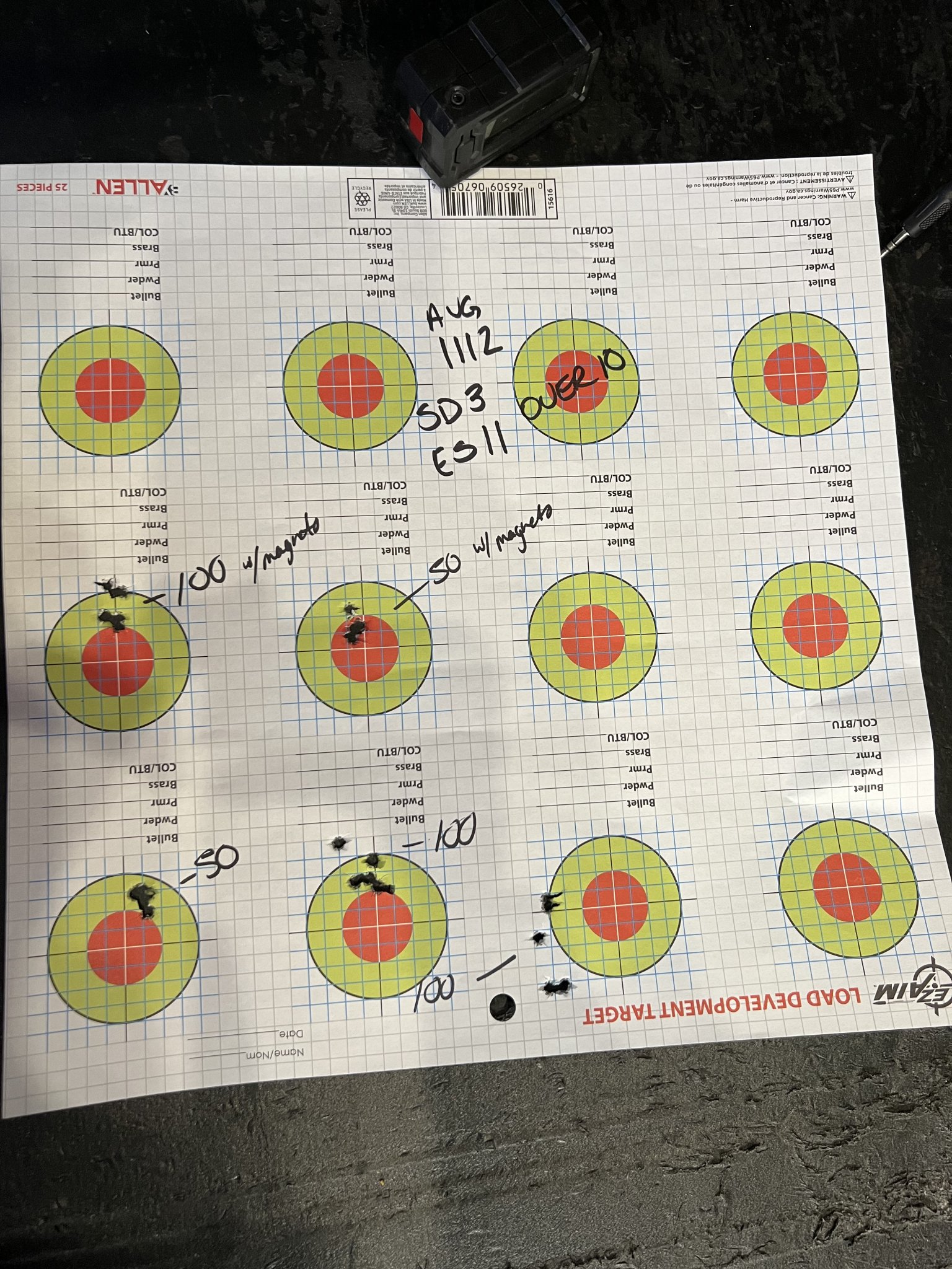

I got some lapua long range in today and ran to the range shoots pretty darn good out of the rimx the first 100yd group was 5 shots a little over an inch acclimating the ammo after shooting sk plus rimx has a 21” Shilen 1-16 ratchet rifling on it.
Speed averaged 1112
Sd 3
Es 11 from the magneto speed
