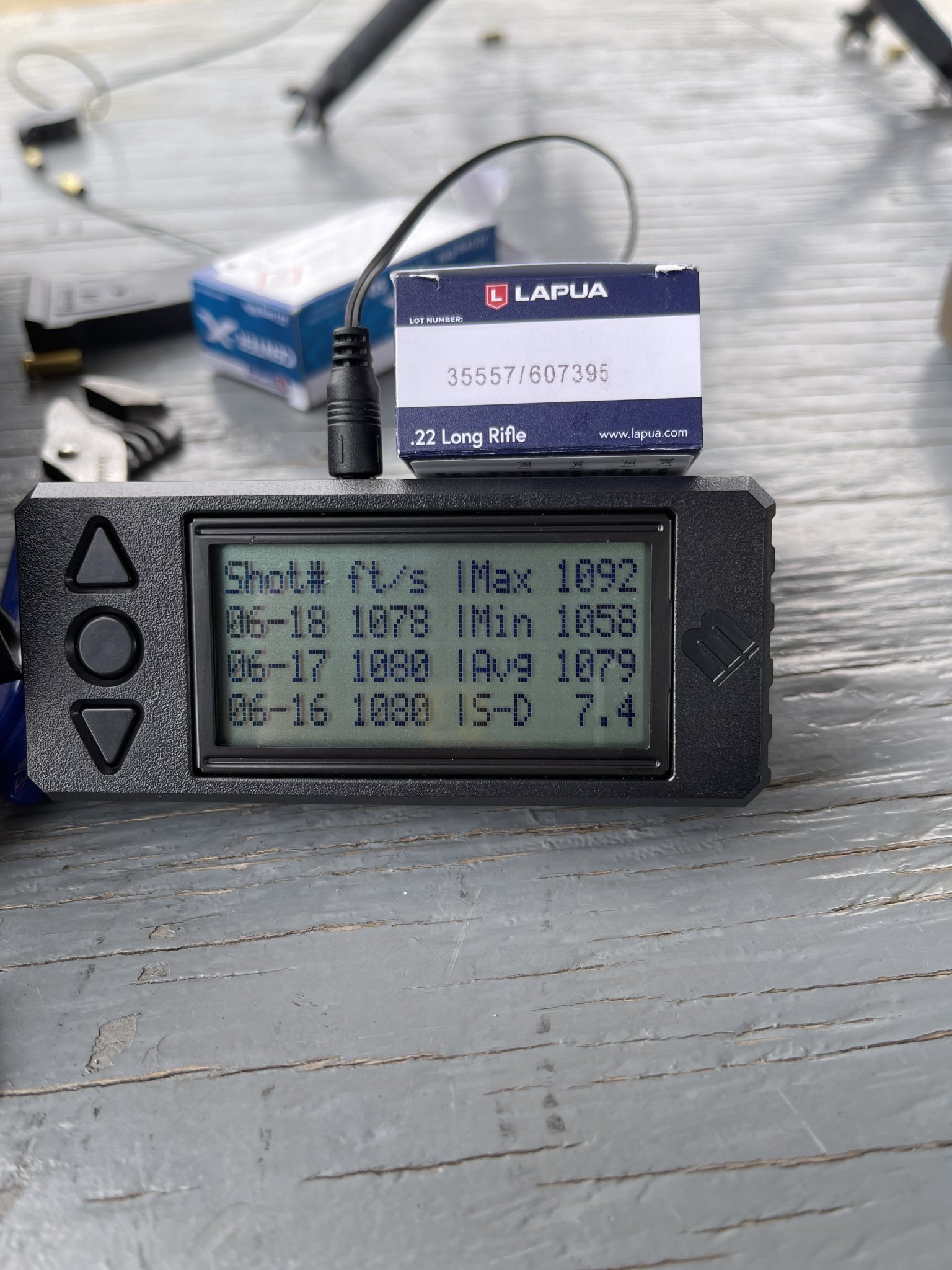

Look at the average velocities from the last two boxes I shot.
1074 fps avg and 1071 fps average....do you see my quandary? :oops:
And as for Super Long Range...didn't even top out above 1101 fps.

Do you have lot #'s? The Box tells you the tested velocity based on the first 2 digits of the lot#. It is possible to shoot a 29xx center-x and a 29xx long range.
LP, my two lot numbers
LSLR # 36557-607362. 1102 fps
LLR # 34557-607455. 1095 fps
Those factory numbers are derived from the average velocities
obtained during lot testing/statistical sampling at the factory.
Does that mean the entire lot will match those numbers?
Not from my experience. Too much variation in components and assembly.
All too often, factory testing doesn't match what is actually shipped. :(

@justin amateur my chrono data is somewhere in this thread. 1071fps for advertised 1070fps ammo...
I've seen a rifle that shoots faster ammo closer to nominal (99.8%) , and slower ammo further off, closer to 98.8% nominal...so its not fast vs slow barrel type of thing...its just lot to lot variation being its 22LR
