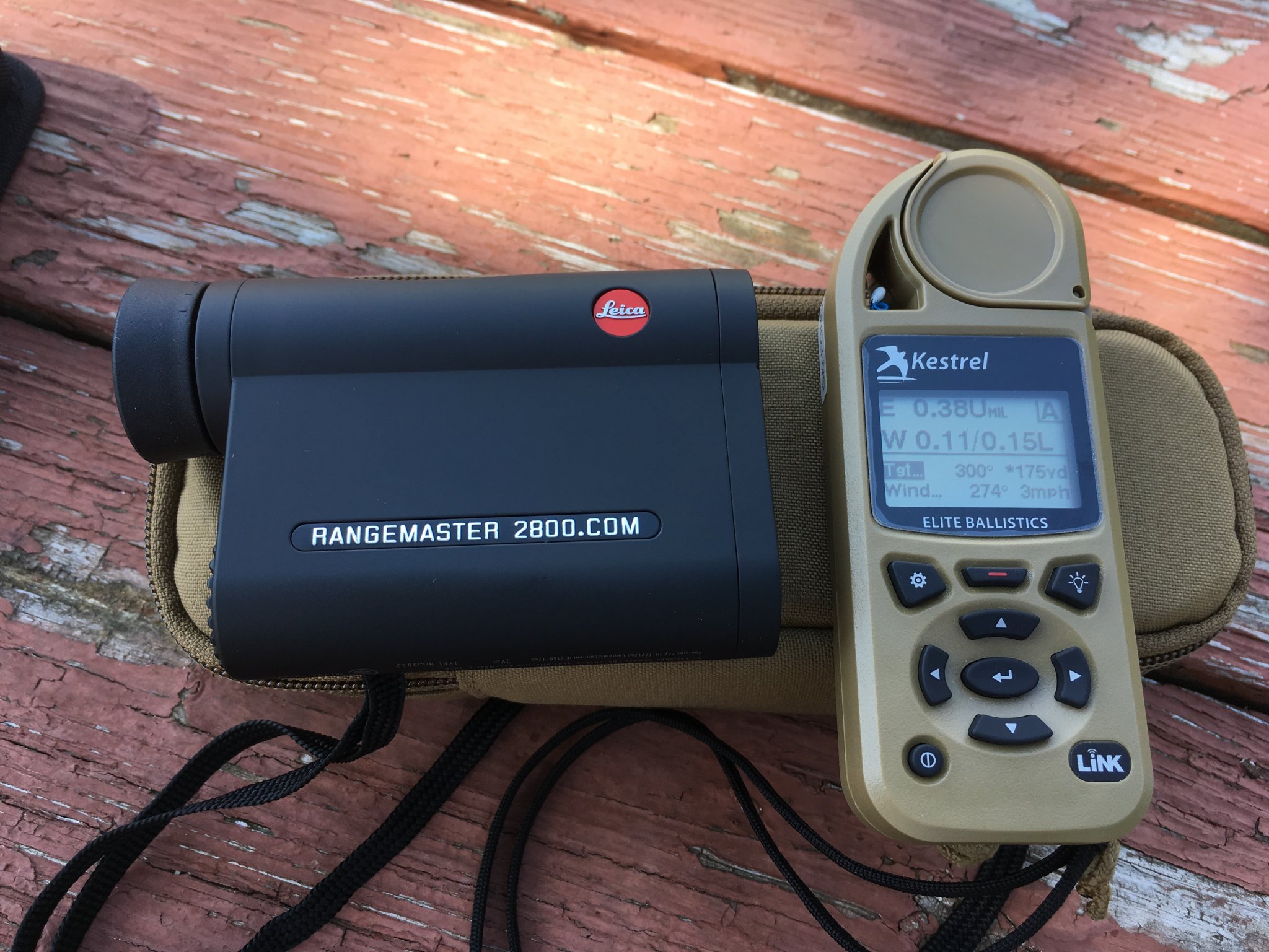

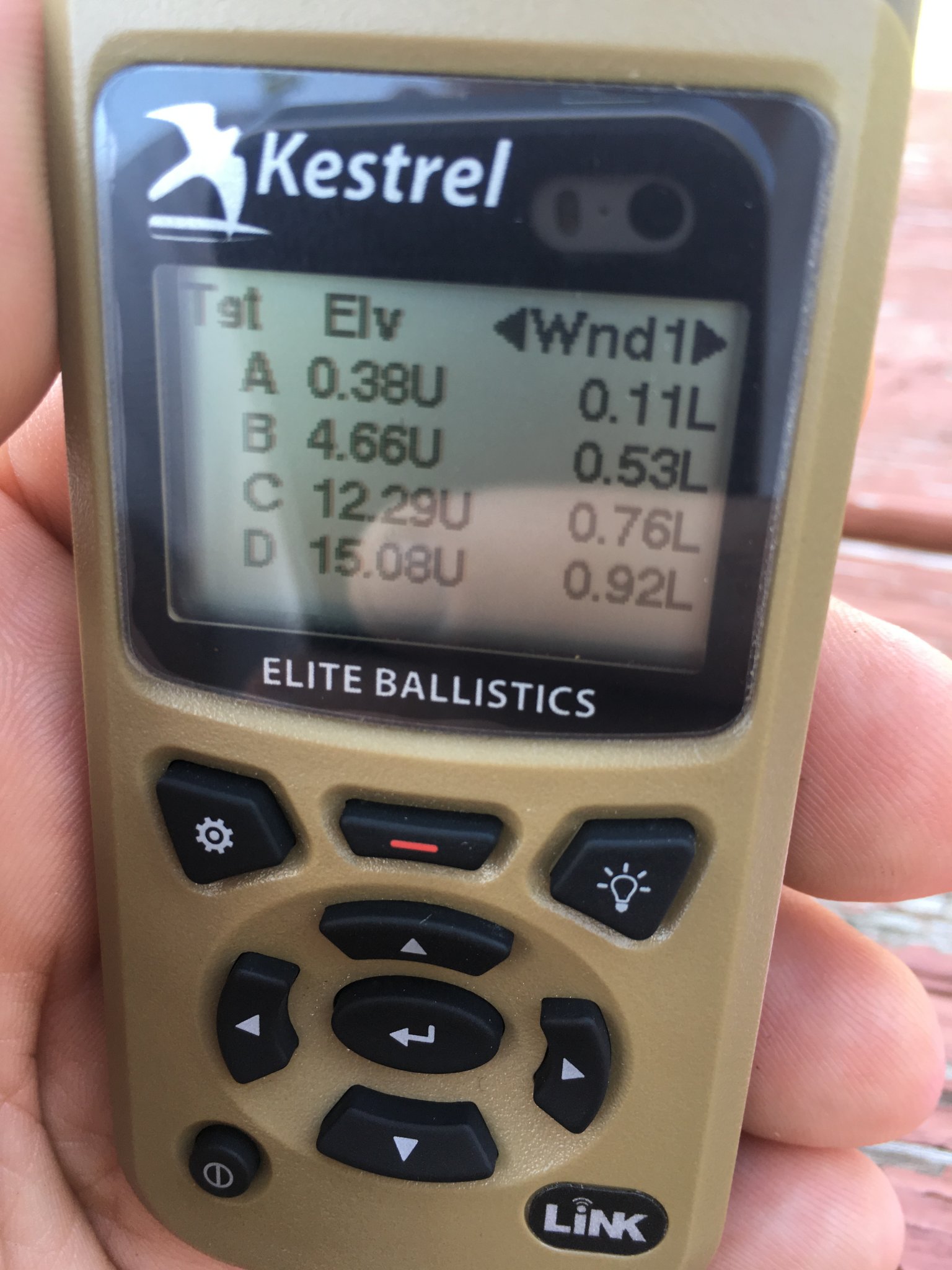

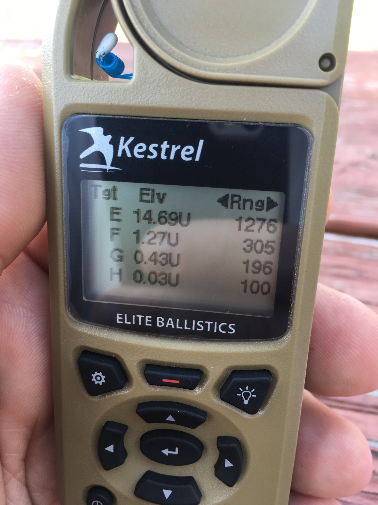

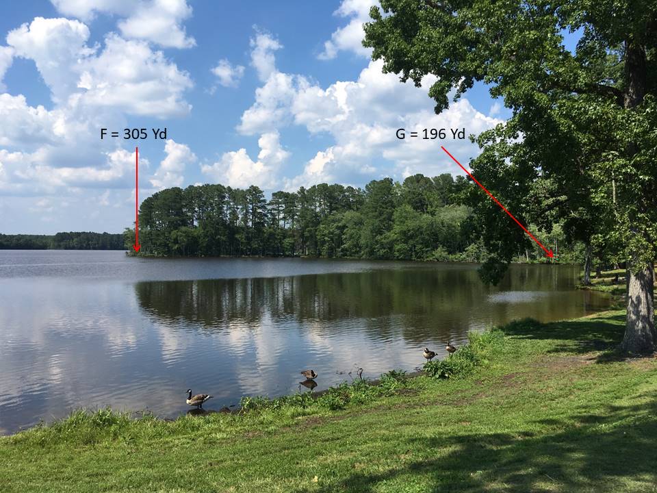

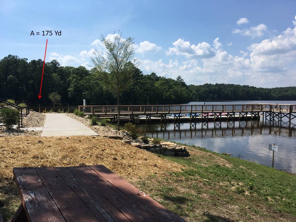

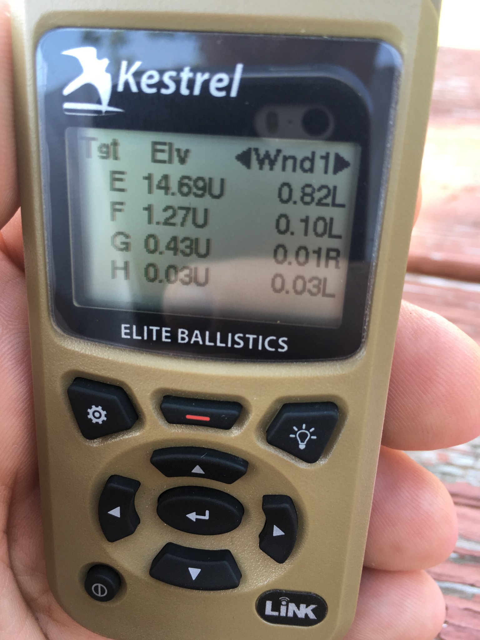

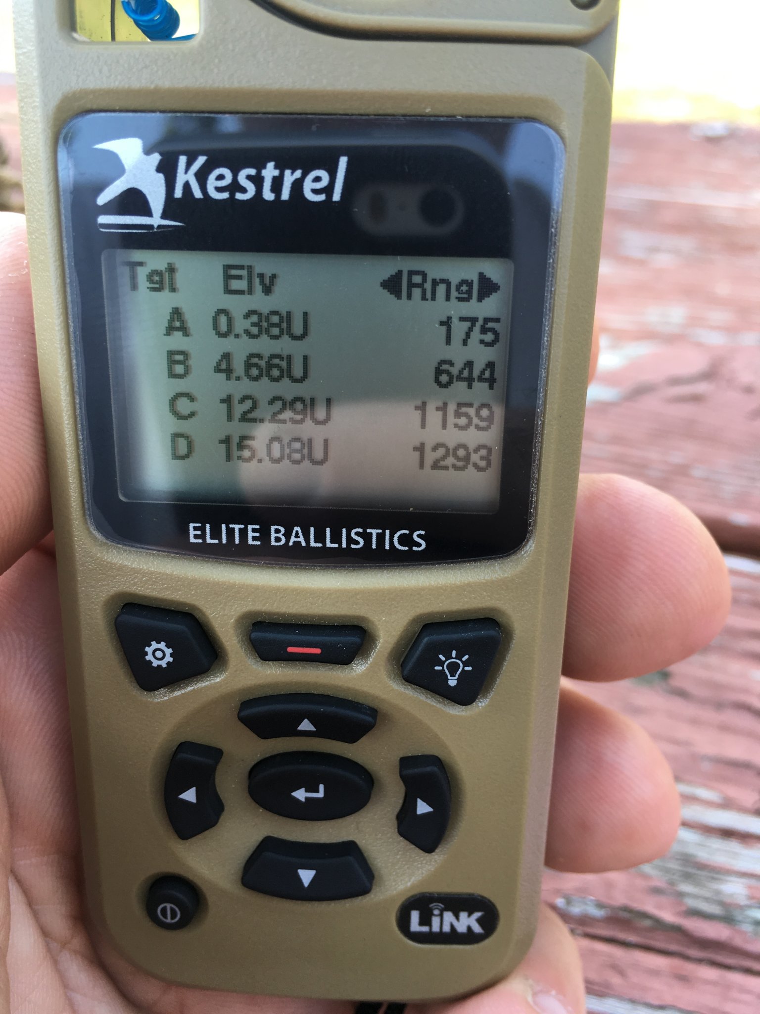

Just got back from checking out this Leica 2800.com and the Kestrel 5700 Elite. Once I figured it out, its beautiful! The target card function is well ........ "The Cats ASS"! :)
I love that once you range all of the targets populating the target card, one can do a "wind update" and it will update all the wind holds for all the targets at once......... sweet!
1.First I watched Doc's video of paring the two units together.
2. Updated the Leica 2800.com Firmware to the latest.
3. Updated the Kestrel 5700 Elite to the latest Firmware.
4. Paired the two units together by Doc's instructions in the video.
Below are photos of the local lake I visited, I marked the Target LETTER and DISTANCE on the lake photos, the Kestrel photos display the RANGE for targets A-G and WIND1 for targets A-G.
On man am I going to have fun with this!
Hope this helps someone.
Jeff

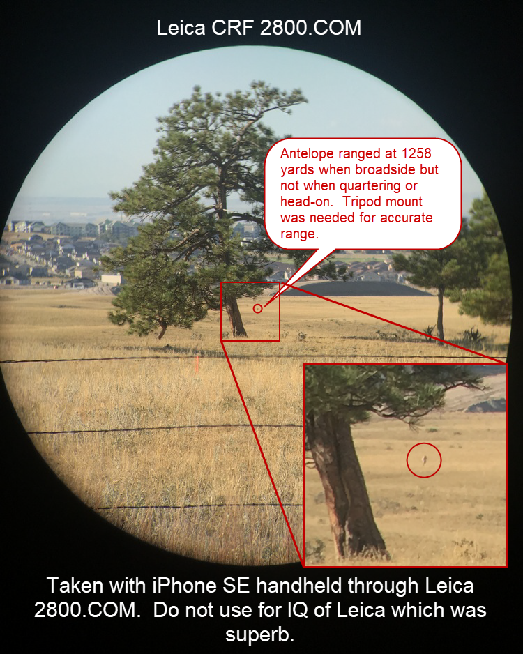

Took out the 2800.COM this morning and stopped by a local ranch that has quite the large heard of Antelope. I like to laze the Antelope because they are the smallest big game animal I hunt and often are the most difficult to get an accurate range on. This morning I had a couple antelope waaaay out that I could not get a reading hand held, but I used my new 3D printed tripod mount and was able to get accurate measurements whenever they were broadside. My readings were consistently at 1258 and had one 1257 reading when the animal was broadside but the LRF could not register a distance when the animal was quartering and head-on, the 'lope was very easy to see through the 7x optics of the Leica and to be honest I was surprised I got any reading, but the fact it was able to do an Antelope at over 1000 yards was impressive.
That you got him under and around that tree is a testament to the importance of tighter beam divergence.
I honestly haven't needed a rangefinder much in the last two years and my HDB 2200s have just about always given me a return when I've wanted to double check something.
The BT connection with the Kestrel is pretty cool though, may have to pick one up just for that feature.
I was trying to pick more difficult situations to see what the 2800.COM could do and not do. Where that tree is was about 120 yards from my position and it sits on a slight rise so that animals behind the rise were actually about 400 yards away, this was a situation the Leica could not overcome, even though the center circle was right on the antelope the LRF would always read in the 120ish range, I tried a little high, I tried a little low but the predominant signal was coming from the rise and not from the animal, it wasn't until the animal was a bit higher (above the rise) in my line of sight that the Leica would pick it up. Later, at my house I was lazing off my back deck and decided to try to thread the needle through an open patch in a tree and the 2800.COM was able to hit the far away target - I was not able to do this hand held which is testament to using a tripod when needing to get very precise measurements.
