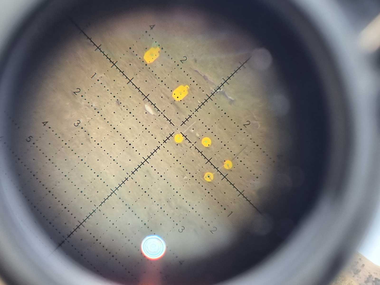

I actually LOVE this reticle...
It would have basically been a perfect simple reticle if they would have used the main stadia from the lrr. My biggest gripe with the msr2 which I love is you lose the .2 wind holds outside the first mil... Why?
I would rather have the msr2 or lrr offered
I like half mil hash-marks as it allows the reticle to be more open as I shoot small furry things that are the same color as the terrain.
However, I’m not trying to be provocative (looks like @Huskydriver has also posted as I type this), but I am just curious.
Many people hate 0.5 mil hashes on reticles. They’ve ragged endlessly upon the EBR-2c and TMR etc. They say prefer 0.2 mil hashes instead.
And then the P5L appears and lots of people come out of the woodwork to say they like it?
Over time i have had many tree based reticles...i also have the S&B with the Gri2d reticle. Since doing more and more ELR, i have come to appreciate a more "simple" but functional reticle.
Spotting misses at ELR distances is VERY VERY hard with the Gri2d for instance its sort of like looking through a flysceen door.....the P5L is so open , but has enough info on the reticle which makes it very easy to spot and correct.
Spotting misses at ELR distances is VERY VERY hard with the GR2ID
Yes, we agree. That’s why I like 1/2mil hash reticles. But I like tree reticles for wind holds, and the 0.2mil dots on the trees don’t seem to bug me too much.
Haven’t used the GR2ID, but with all that stuff above the main horizontal plus the additional verticals grid, yeah, probably too much for me. I use the upper part of the view in a scope for scanning for targets, so I would prefer almost nothing above the main horizontal like the MR4 ret.
I have one scope with the MIL-XT reticle, and the jury is out if that’s too busy for me. Lots of numbers all over and more dots, but I was curious.
Reactions: matt33
I guess the center section (first Mil in each direction) is dashed in such away you have. 2mil holds.
I could see why this reticle could be popular for ELR but having used the P4f in a few PRS/field type matches I wouldn't want the P5L reticle for that game.
I like what S&B did with the center... basically what March has with the FML-TR1. Clean aiming point, lots of space around it. That said, absolutely concur .2 mrad over .5 mrad. I have come to dislike the "hmm... well... I guess that particular part of this featureless line is about .2 mrad... might as well send it" technique.
