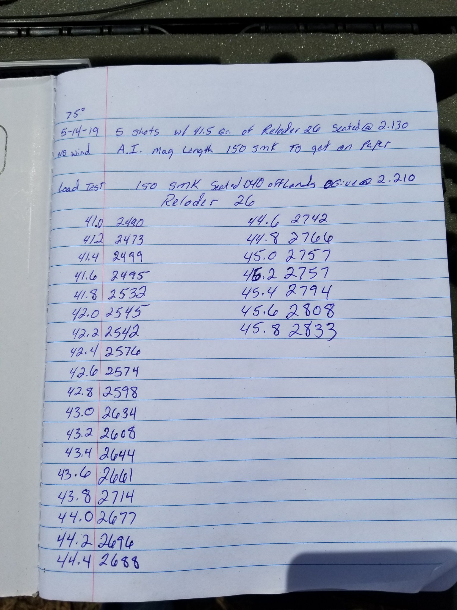

I am running a test on the 150 smk in my savage 10 stealth today with Reloder 26.... CBTO length is at 2.210. This length is 40 thousanths off the lands of my rifle and is single feed... I will post the data later today
Just finished up.... 41.0 grains through 45.8 grains of Reloder 26..
6.5 creedmoor CBTO 2.210
Savage 10 BA stealth....
Starline Brass
CCI 200 primer.
Reactions: cornhusker86

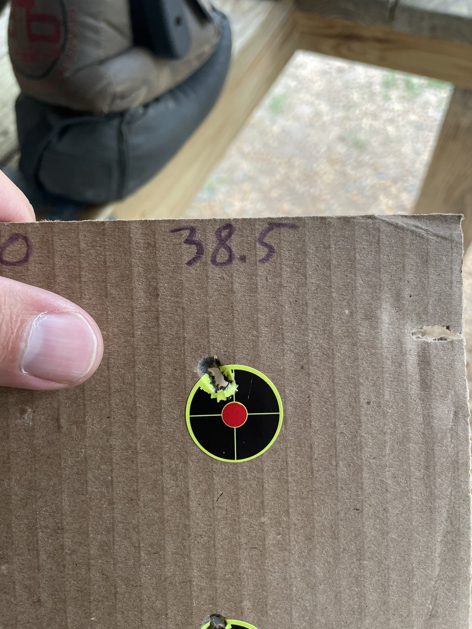

im working on these in a long freebore 6.5x47 right now. H4350 and a 60 thou jump. 7 twist, 28” MPA barrel.
37.0: 2500, 2502, 2504, 2494
SD: 4.2 AVG: 2500
37.5: 2537, 2540, 2538
SD: 6.2 AVG: 2535
38.0: 2570, 2574, 2560
SD: 7.2 AVG: 2568
38.5: 2608, 2607, 2609
SD: 1.0 AVG: 2608
39.0: 2635, 2646, 2634
SD: 6.6 AVG: 2638
39.5: 2673, 2691, 2677
SD: 9.4 AVG: 2680
40.0: 2714, 2717, 2701
SD: 8.5 AVG: 8.5
40.5: 2732, 2729, 2735
SD: 3.0 AVG: 2732
41.0: 2776, 2765, 2770
SD: 5.5 AVG: 2770
