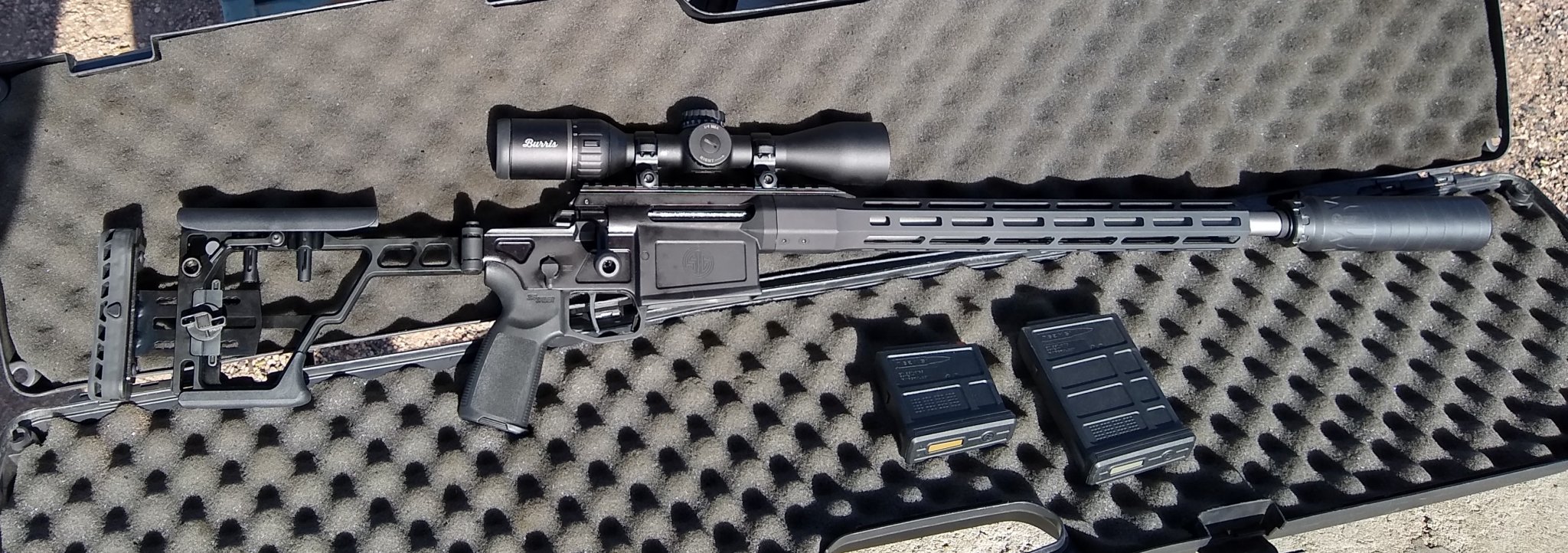

I caved and bought the last .308 Cross within a few hundred miles this morning. I've just gotten to play with it a little, but in really liking the feel so far. It's kind of a bummer that the safety doesn't lock the bolt for a hiking hunter, but I knew that feature was missing going in.
The stock has a shit load of play when "locked" in the folded position, like 2.5" left/right and 1" up/down. I'd rather never fold that stock and lock the bolt with the controls personally (if that were an option), if you don't strap the stock down when folded it flops around like a fish out of water.
Mine is reasonably tight when folded, I'd guess 0.5" - 0.75" of play swing direction and 0.25" of play vertically, but there seems to be some spring tension pulling it against the rifle, so carried vertically I don't think flopping or noise would be a problem with mine anyway.
I guess I could fold the stock while hiking in places where I know the elk aren't, but I try not to spend too much time in those places. Basically when I'm hiking, I'm hunting and I need to be able to shoot quickly if something pops out of the next coulee, so the folding feature is mainly for compact transport in the truck. I do think safeties that lock the bolt are a better solution for hunting rifles, but I bought the Cross knowing full well it didn't have that feature, and I think I'll be able to make it work fine for me. I will say from what little time I've had to fondle the rifle, it seems like someone put a lot of thought into most of the details, I can't wait to get it out on the range.

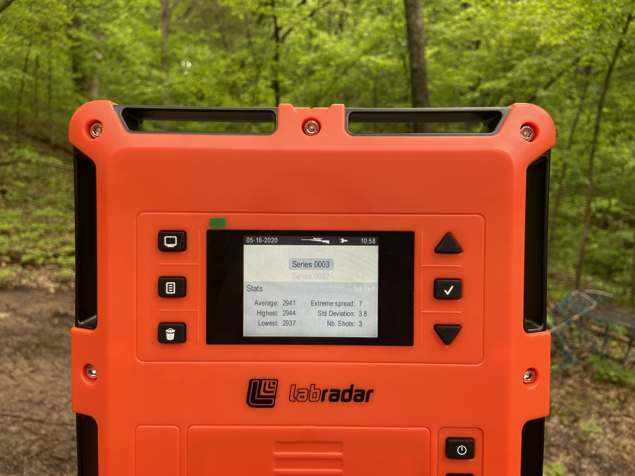

I'm still waiting to see someone's real life Chrono readings of the 277 fury
Speeds from a pre-production model I was able to test...

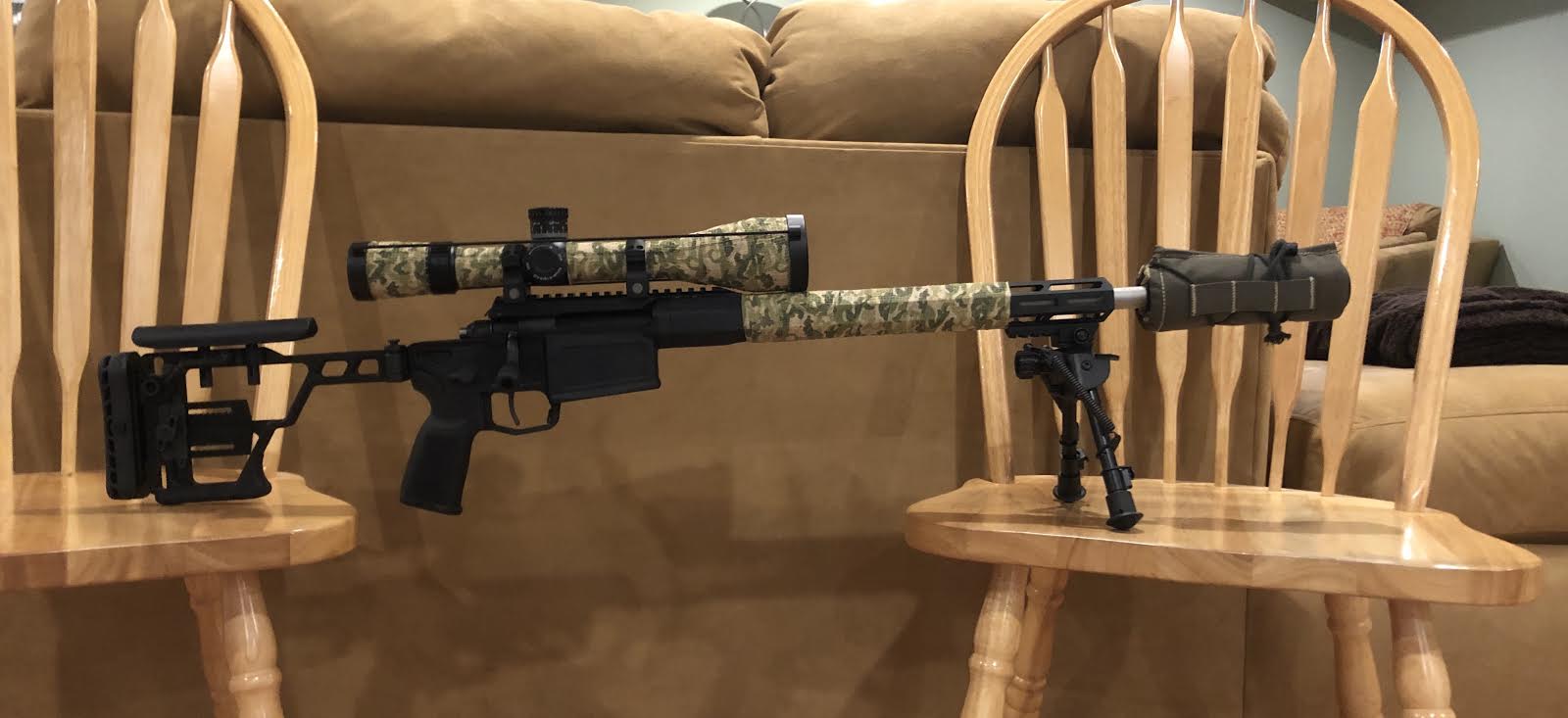

Might be ugly but it damn sure works....

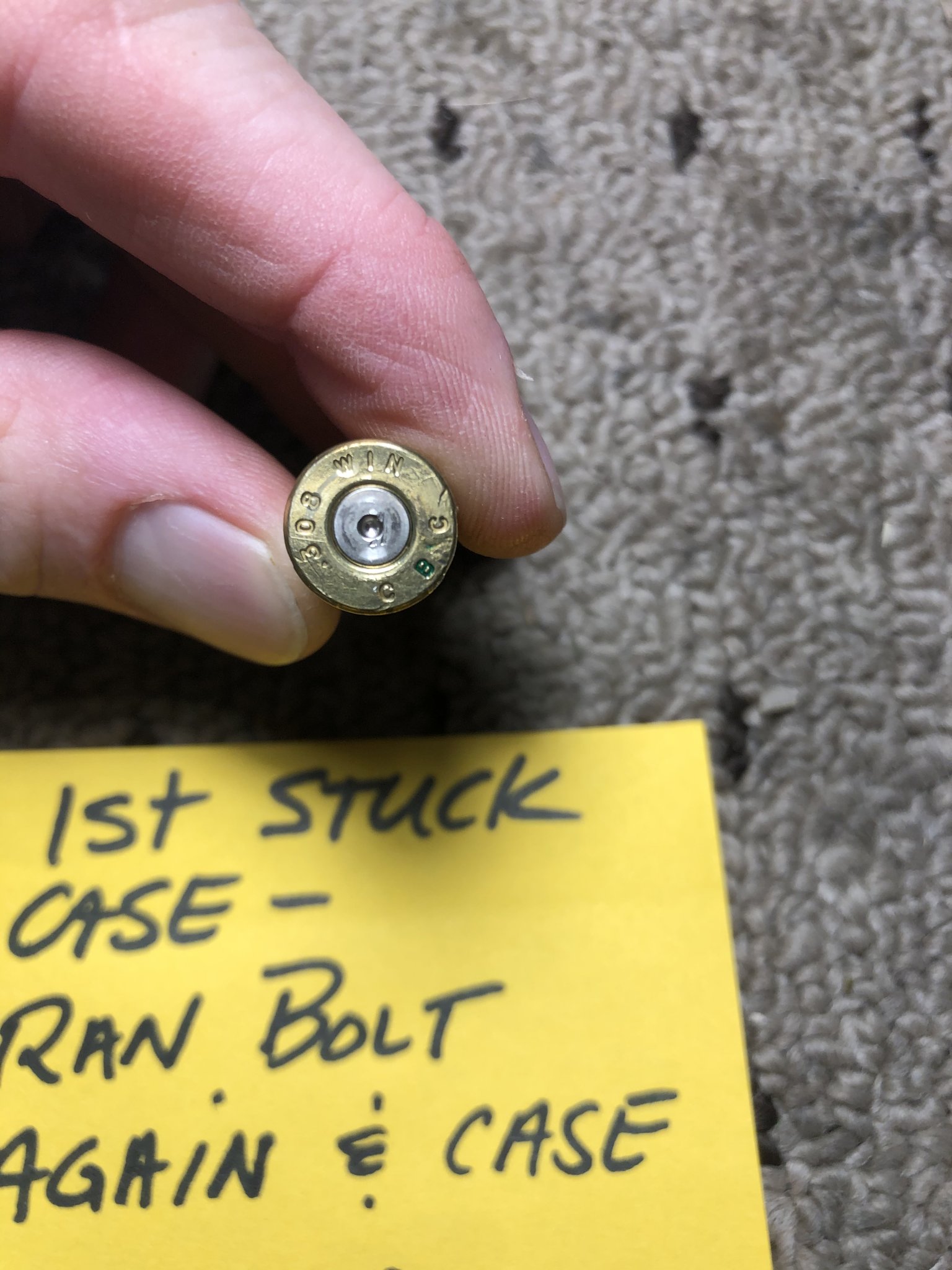

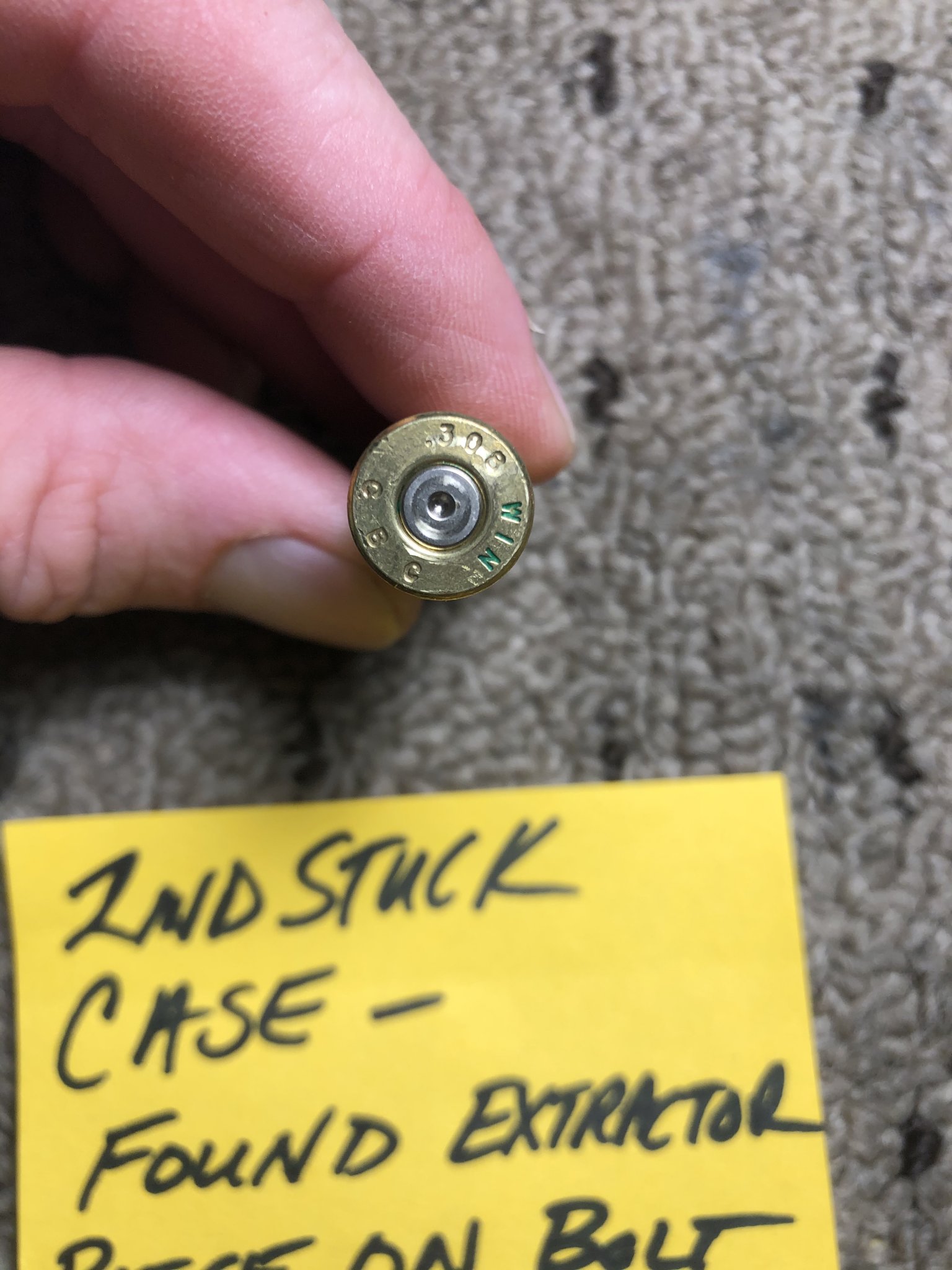

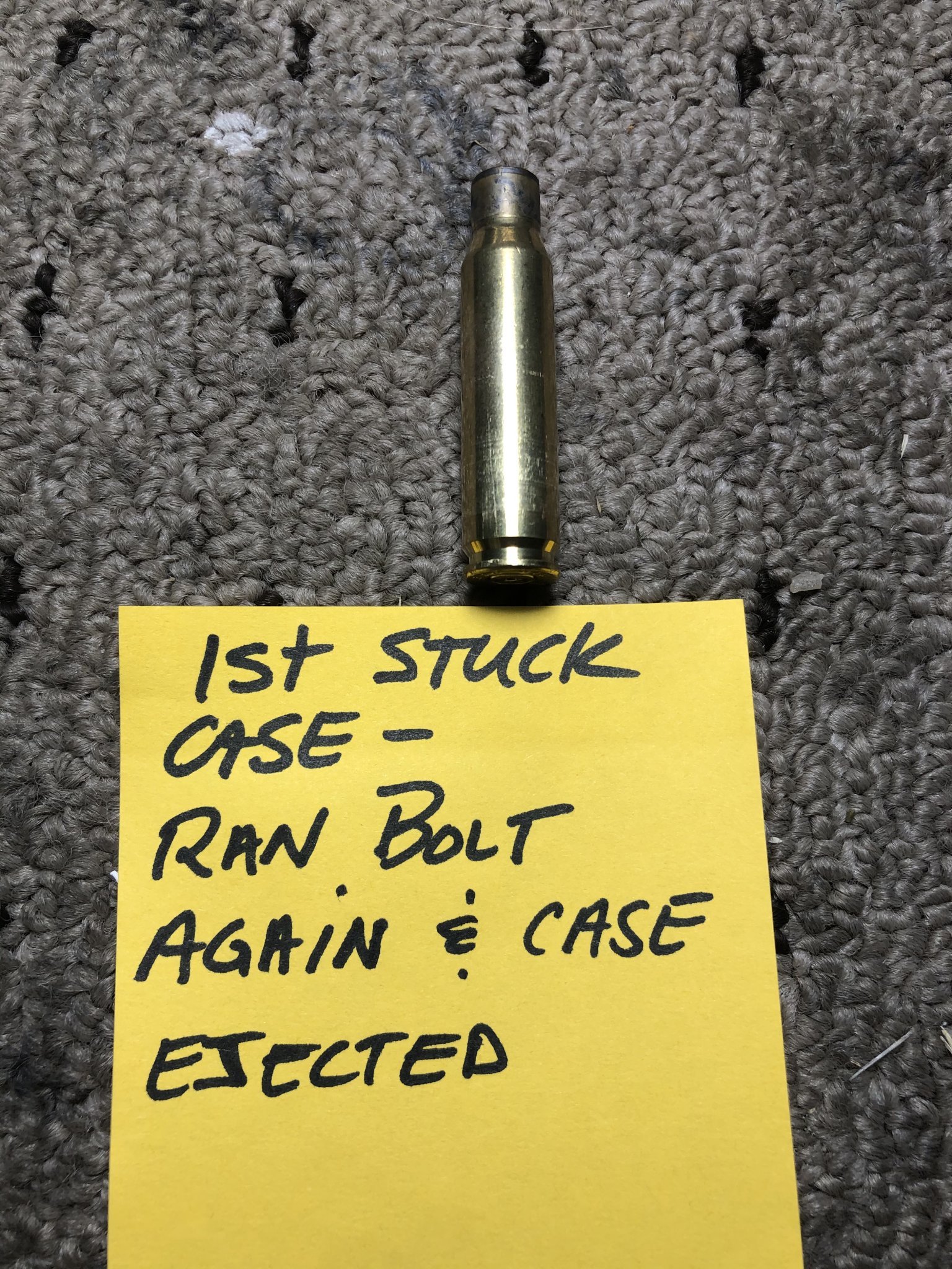

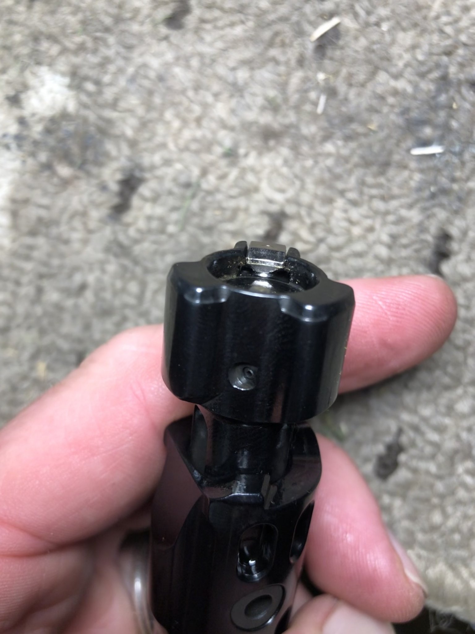

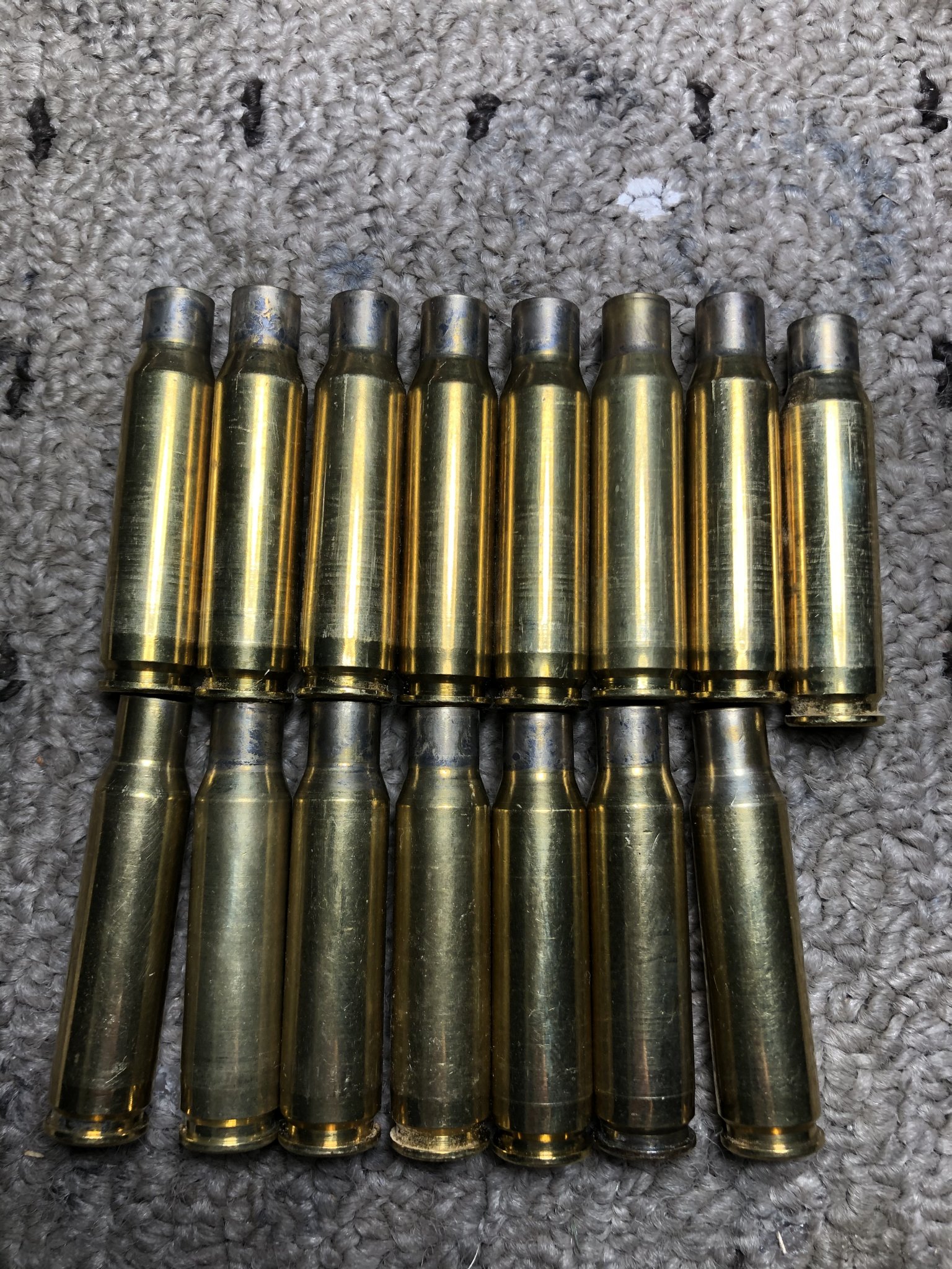

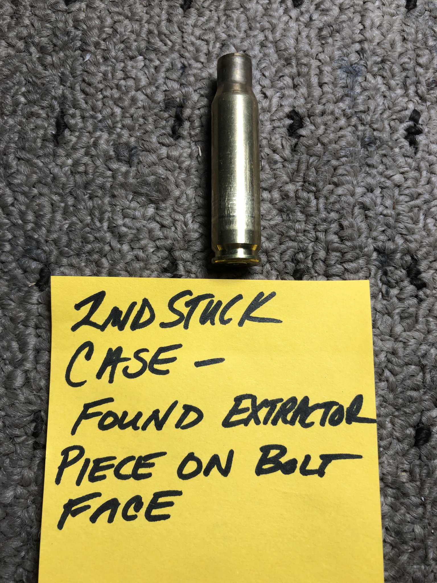

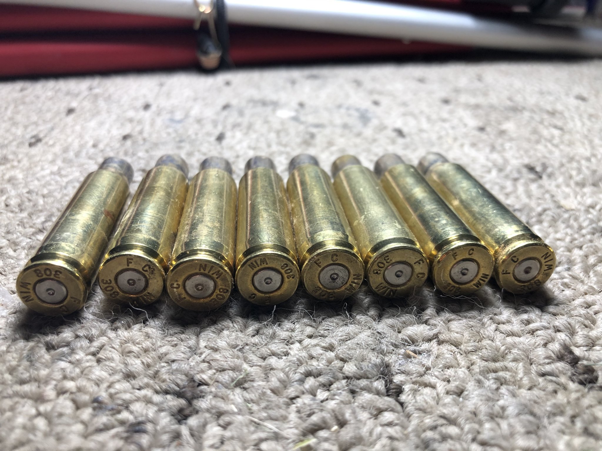

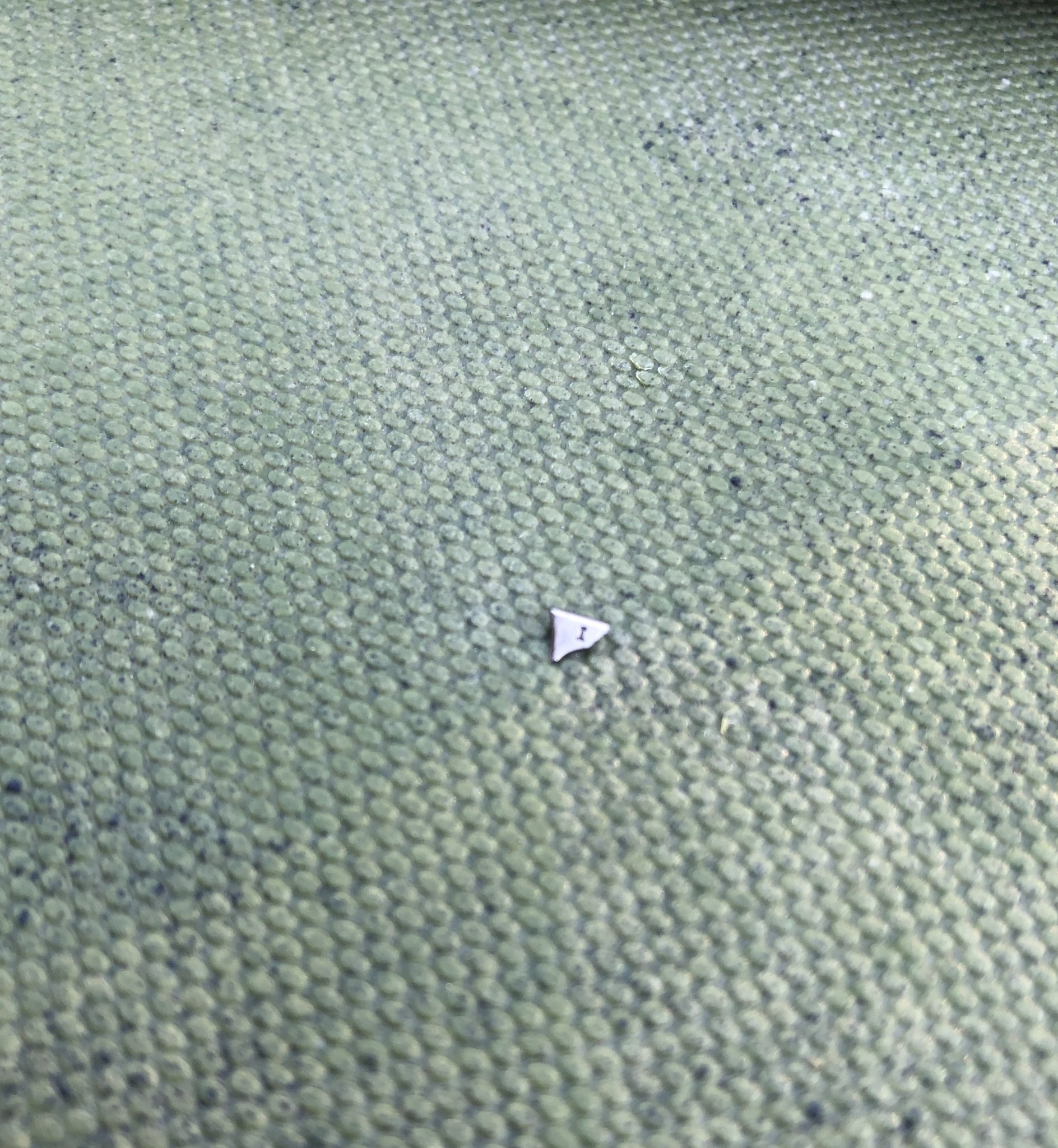

So what do I win for the first broken Cross??

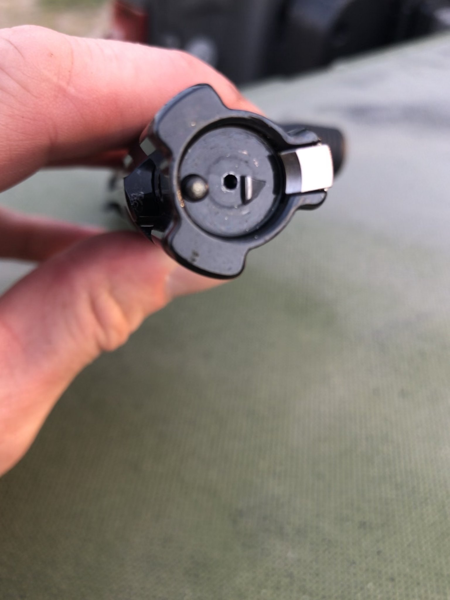

Appears that I have chamber issues,which resulted in a broken extractor.
All rounds were easy to chamber, but had some resistance opening the bolt. No pressure signs, but definitely signs of “rough” chamber. The second to last round stuck, but ejected easily when I ran the bolt a second time. The last round required a cleaning rod to bump it out. That’s when I
found a piece of shiny metal on the bolt face, that appears to part of the extractor(underside?)
I’ll be calling Sig Monday.

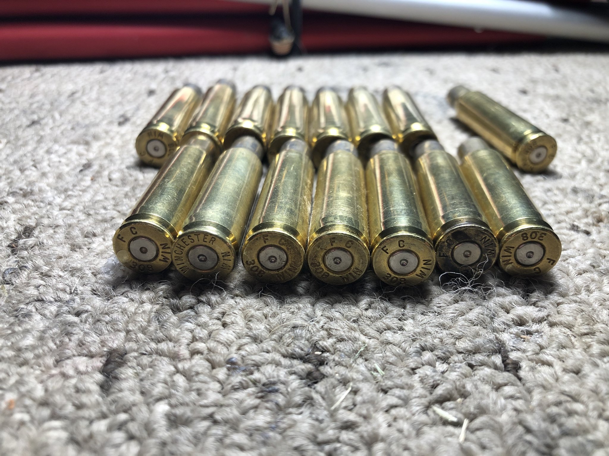

The load is my bulk 308 load that I run in 4 autos and 5 different bolt guns.
175 gr SMK/45 gr BLC(2)/ small base die and crimped at 2.800( mixed brass)
Sorry, but you got Sig’ed.
But...but... 277 Fury! 😬
It's not chamber pressure with factory ammo that can lead to broken bits here. I'm not saying this is the case here but recycling brass through many different chambers has its challenges.
With that being said you want an easily replaceable weak link. I'd rather replace an extractor than tear the lips out of the bolt. I've done both.

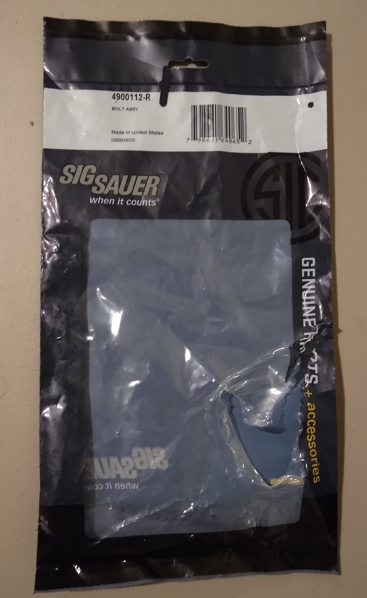

I read on ARFCOM that there was an issue with some of the bolts found during launch. A Sig employee seemed to confirm but said the issue had been corrected.
My Cross came with what looks like a consumer packaging for a replacement bolt in the box, maybe that's how they dealt with the bolt issue after the rifles shipped to stores. Did everyone else have a baggie like this in their box?

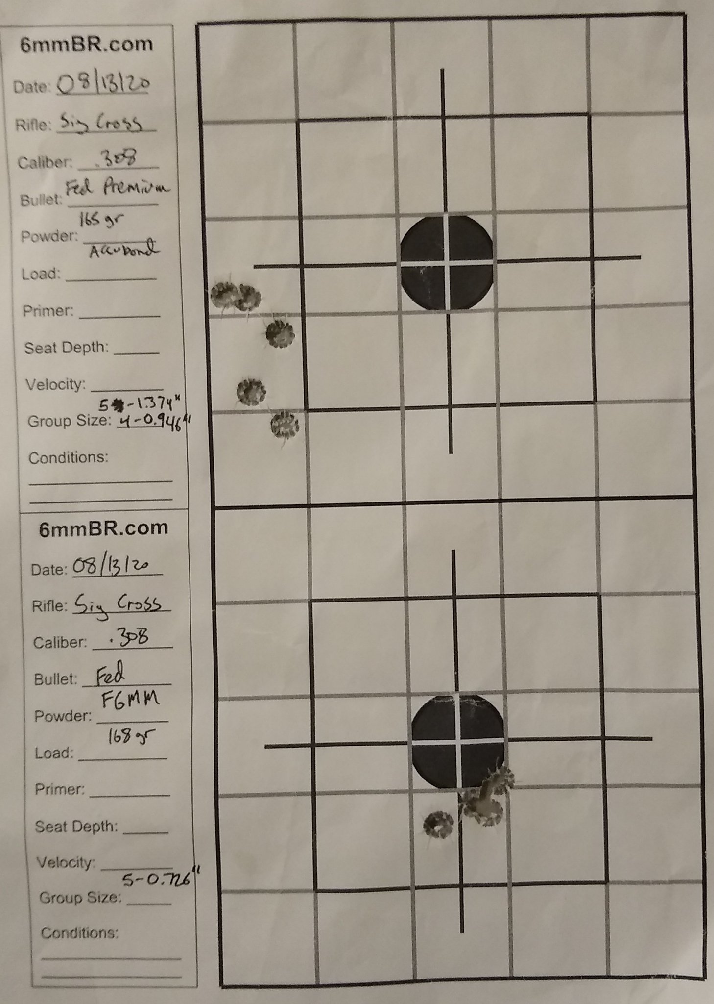

I took my rifle out last week just to make sure everything ran fine. I had five rounds each of Fed Premium 165gr Accubond and 168gr FGMM left over that were the first rounds through the rifle. Don't know if the Fed Premium was me getting used to the rifle (first group) or if that's just what the ammo will do, but the FGMM was looking pretty good until I pulled the last shot.
I also ran two velocity ladders with 168gr ABLRs to find pressure, which I did in the form of slightly heavy bolt lift and ejector marks, but no problems with the bolt or extractor. I like the feel and function of the rifle a lot and think it's going to be a shooter once I get some loads worked up.
I had the same thing in my box.
