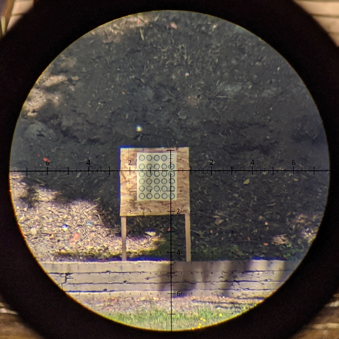

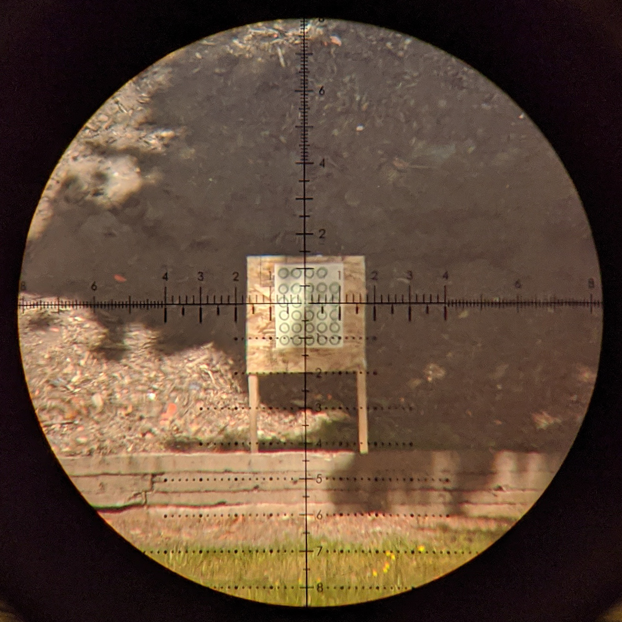

The color representation of the Tract is more like the Leica. Vortex seems to be more 'brown'.
This was the Tract on a different day. The above photos are at 24x, this one is at 30x. But no mirage on this day so the image is a bit clearer. Hard to compare.

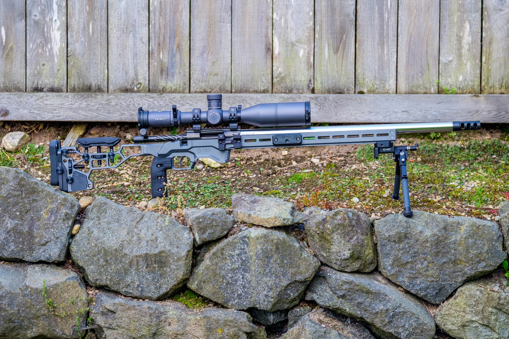

Received my replacement ELR on Friday and took it out this morning working on load development. Had my other 6.5 with a PST II 5-25 as a comparison. The immediate thing I noticed was the eye relief and eye box. Wow...the Tract had a much longer relief and huge eye box compared to the Vortex...not even close. The Tract was also much brighter and detailed, as it should be. Zero stop is 100 times easier to set. This replacement has tighter turrets with 1/2 the slop of my first one...it's very acceptable now. Up to 25X the view is amazing and just slightly drops off when pushing it up to 30X. Still love how smooth everything is. I have to run a throw lever on the PST cause the zoom is so stupid tight...none of that crap needed on the ELR. For what it's worth I used low Vortex 34mm rings and they seem top notch.
A real pleasure to use and I look forward to stretching it out at longer distances...
