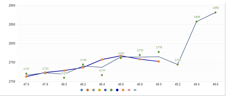

Gotta say, so far I am not impressed. overall no major signs of pressure, even at top end.
Load Data for my 25" 7-08 Ackley @ 36°F
FF'ed PPU 7-08 Brass
trimmed and annealed.
162gr ELD-M loaded to 2.9- I am jumping about 60 thou though.
Variables
- All but the last two rounds were S&B LR. those last two were 210M primers. so maybe this powder needs a magnum to ignite the powder
-barrel has 2-2.5k rounds on it, so maybe it's shot out and the reduced velocity is blowby. though that seems doubtful considering the longer associated barrel life with the 7-08.
-Powder is slow? if that's the case, i'll ask for a refund. i'm not even close to published velocities.
Variables
What speed were you getting previously in this rifle with other powders? 2882 seems screaming for a 162 out of a 7-08 to me, I am not familiar with the 7-08AI though.

So you didnt use the same.brass for all rounds? That explains the spike in velocity....case volume difference
What speed were you getting previously in this rifle with other powders? 2882 seems screaming for a 162 out of a 7-08 to me, I am not familiar with the 7-08AI though. That's also a massive velocity spike with just 0.2 gr increase, any idea what happened there?
My previous data with same bullets and data
7mm-08
39.5gr XBR 8208 @ 2707
7mm-08 Ackley
41.2 gr XBR 8208 @ 2800
*Edit- the published data at max is 2824. I went almost a grain over that and still didn't come close to tbe velocity. The only ones that met or exceeded that were 1+ grain over the 7mm-08 max
In my limited experience I've never had published match. It's more like a safe point of reference.
Sometimes that definitely is the case. But I would say this is an exception. Almost 1.5 grains over max and i am 50FPS slower than advertised with a *longer barrel*. The only two shots that exceeded the published data was about 2 grains over max and only when I switched primers. I need more data to confirm that, but something's up. One of the specific advertising bullets is that it is faster than comparable powders.
1.5gr over what max? The powder has only been out a few weeks.... You talking about Winchester suggested data initially released with the powder? Throw that right out the window. YOUR gun will tell you whats max and all that shit is conservative as hell.
Sierra book max for Varget with a 105 in 6br is 27gr. The known go to load for 105/Varget in 6BR is 30gr and thats what everyone loads and shoots without any pressure. Thats 3gr over Sierra's "book max."
After wasting considerable time and money I pretty much start at published max and go up from there.

Interesting that a 210 would pick up 100FPS over a S&B. Maybe you should redo the test using 210s or Winchester LR primers. Maybe S&B is too mild?
