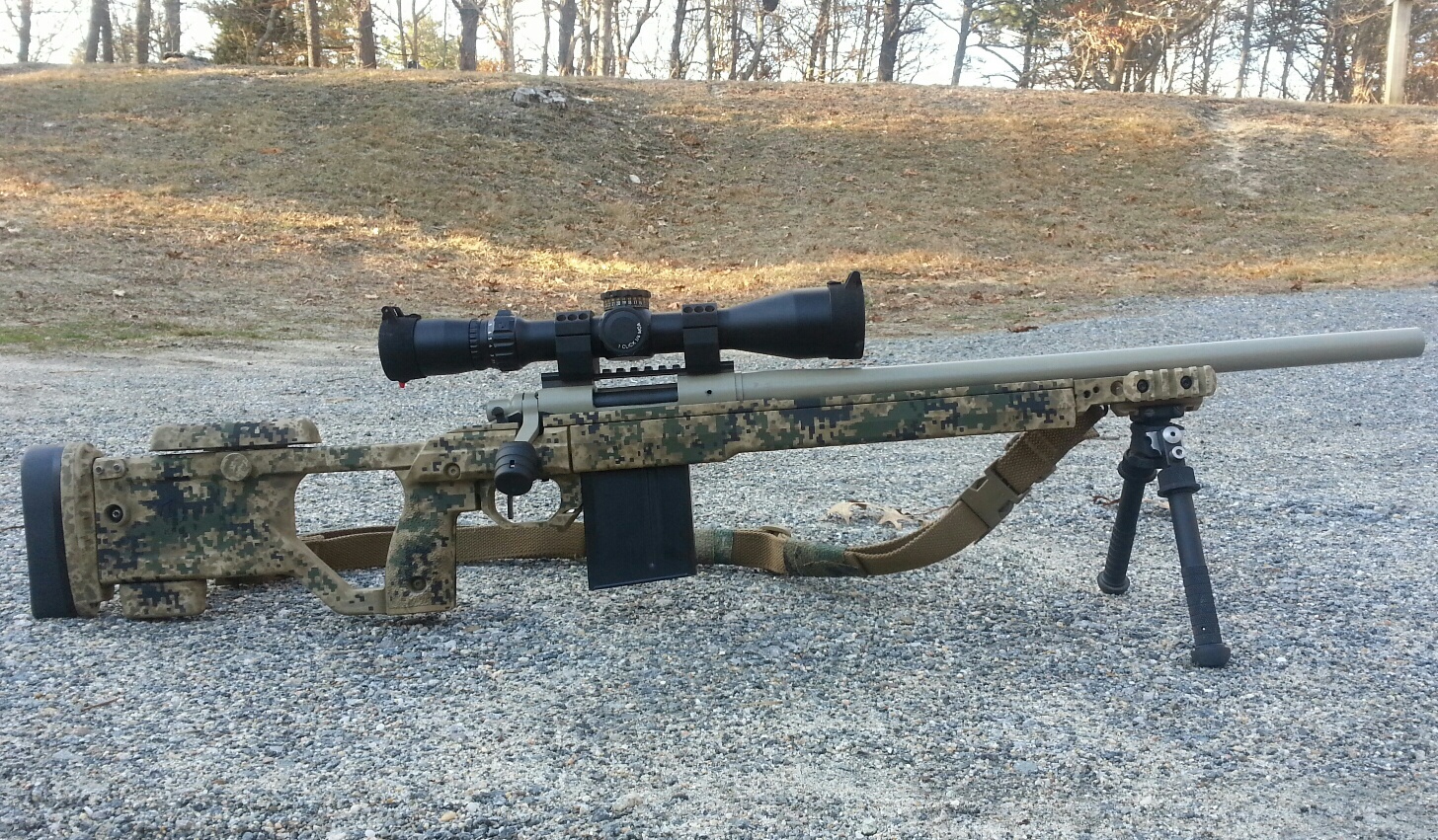

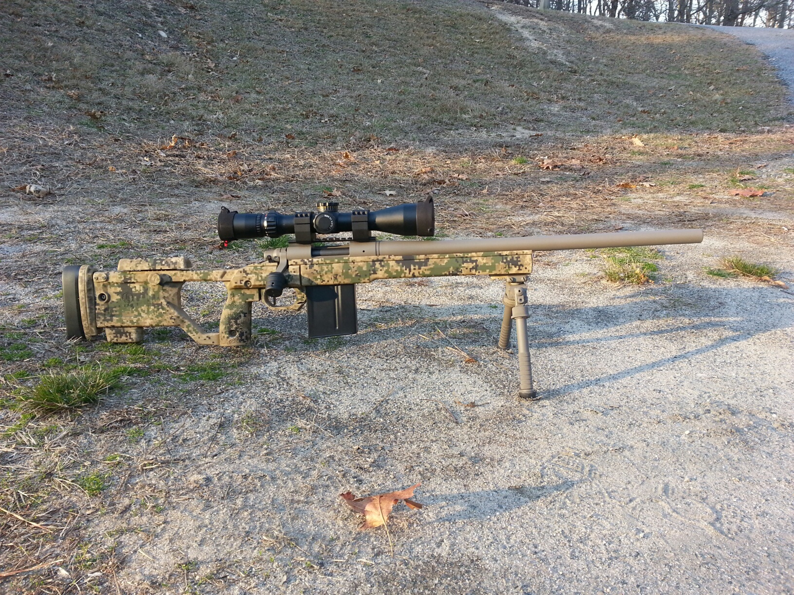

I have the spigot so I can have a NV mounting option and use the flush cups. I also like the bipod to be as far forward as possible but I recently repainted my action/barrel and took it off. It is a bit lighter without the spigot, still just as sturdy but you lose the mounting point options. The spigot is short money and mounts in 5 min so if you don't like it I am sure you can flip to for what you paid but I love mine and its going back on.
Sully

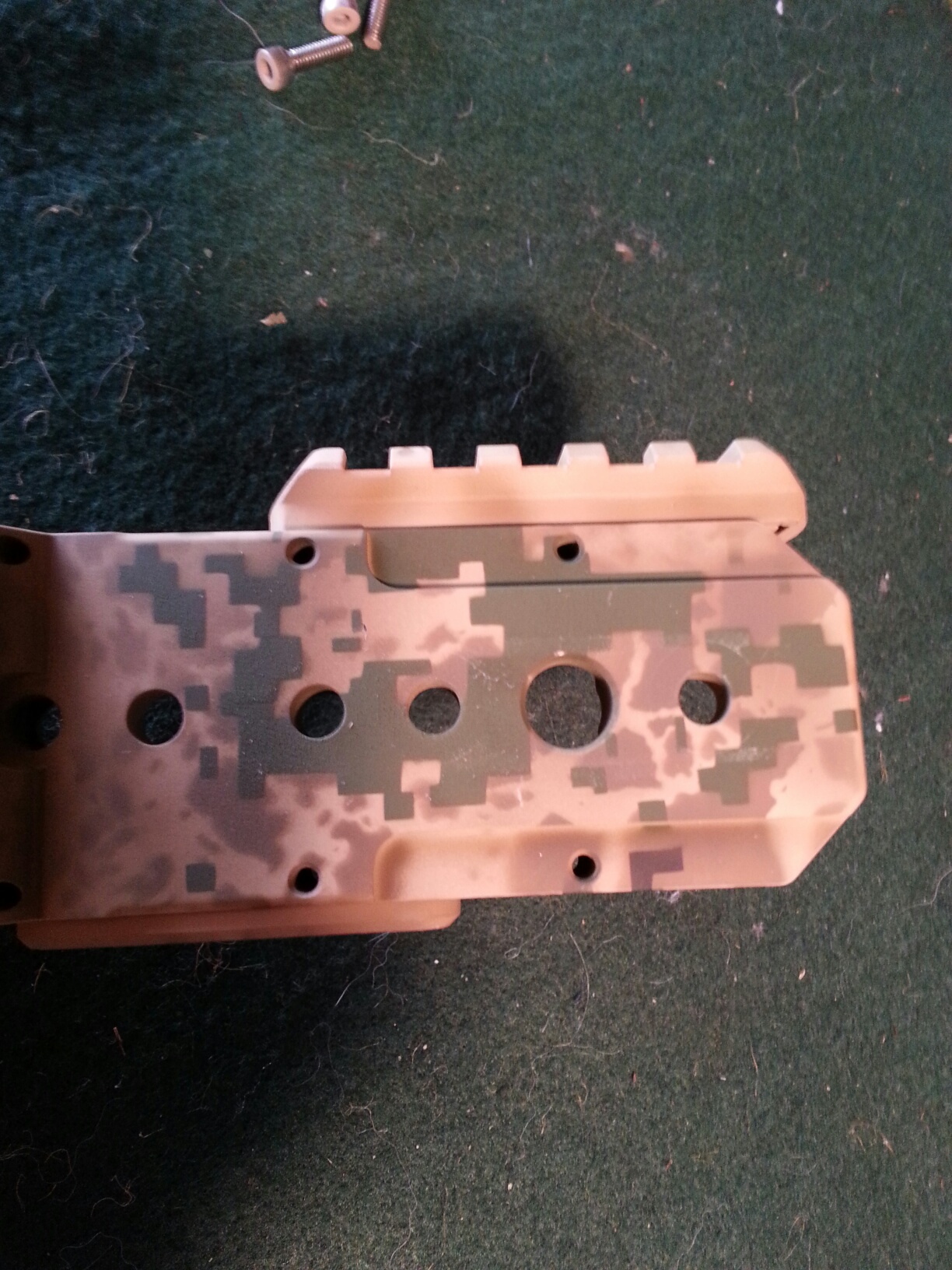

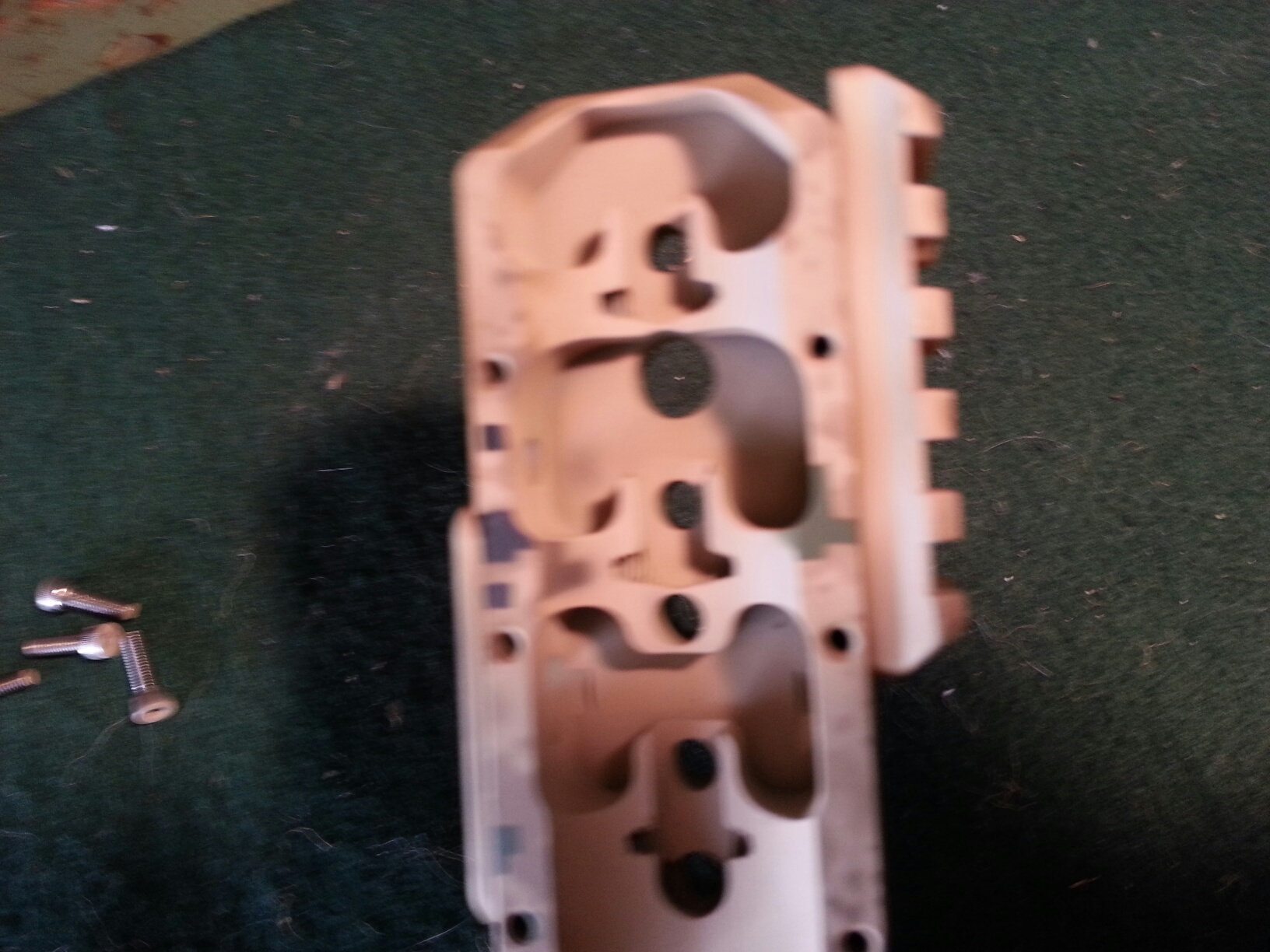

I was hoping you'd reply. How easy is it to install a Harris? I'd hope it's just a matter of moving the stud from the stock to the spigot and attaching the bipod.
I attached two photos of the top and bottom view, so as you can see very easy.
Sully
