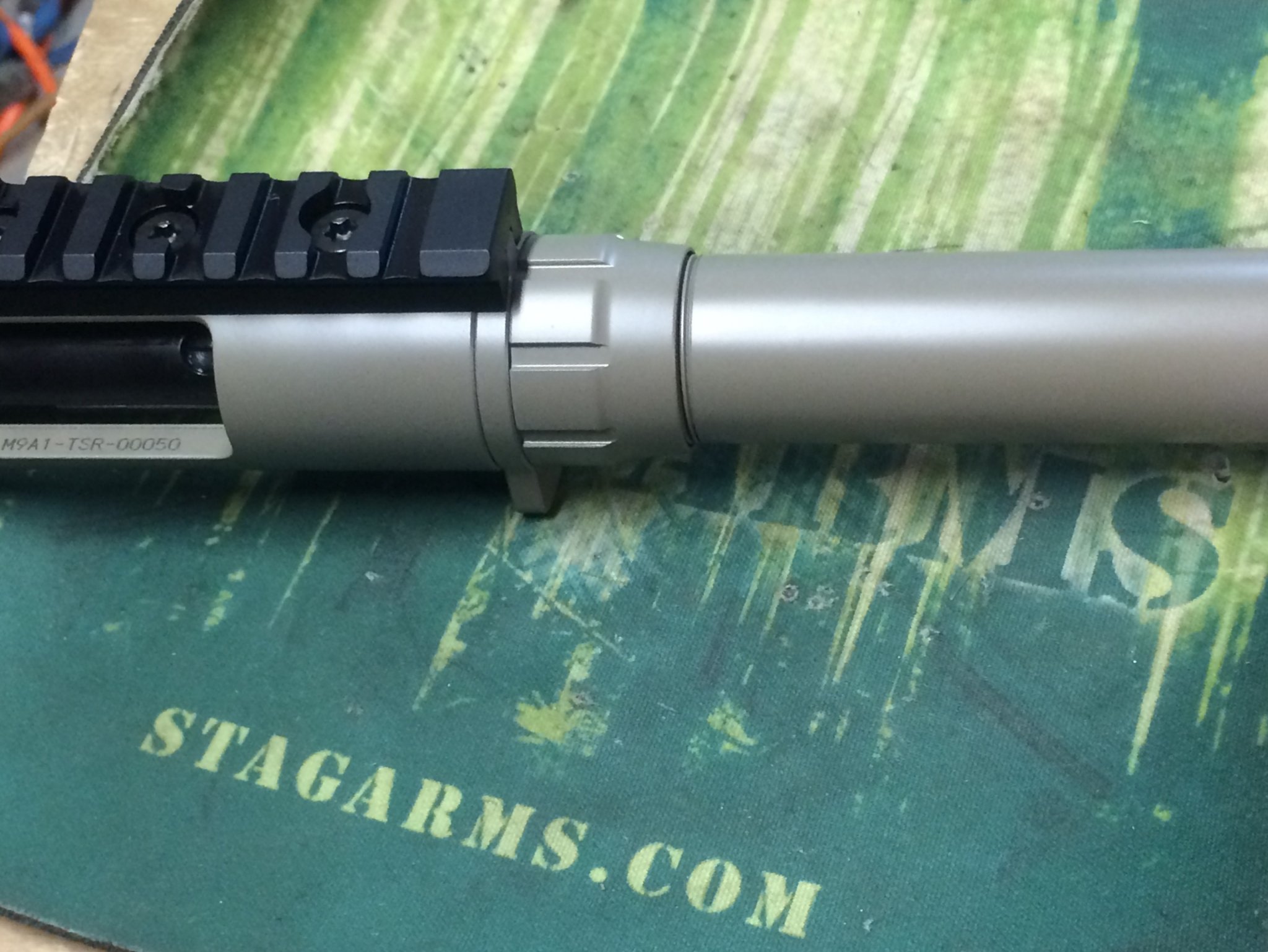

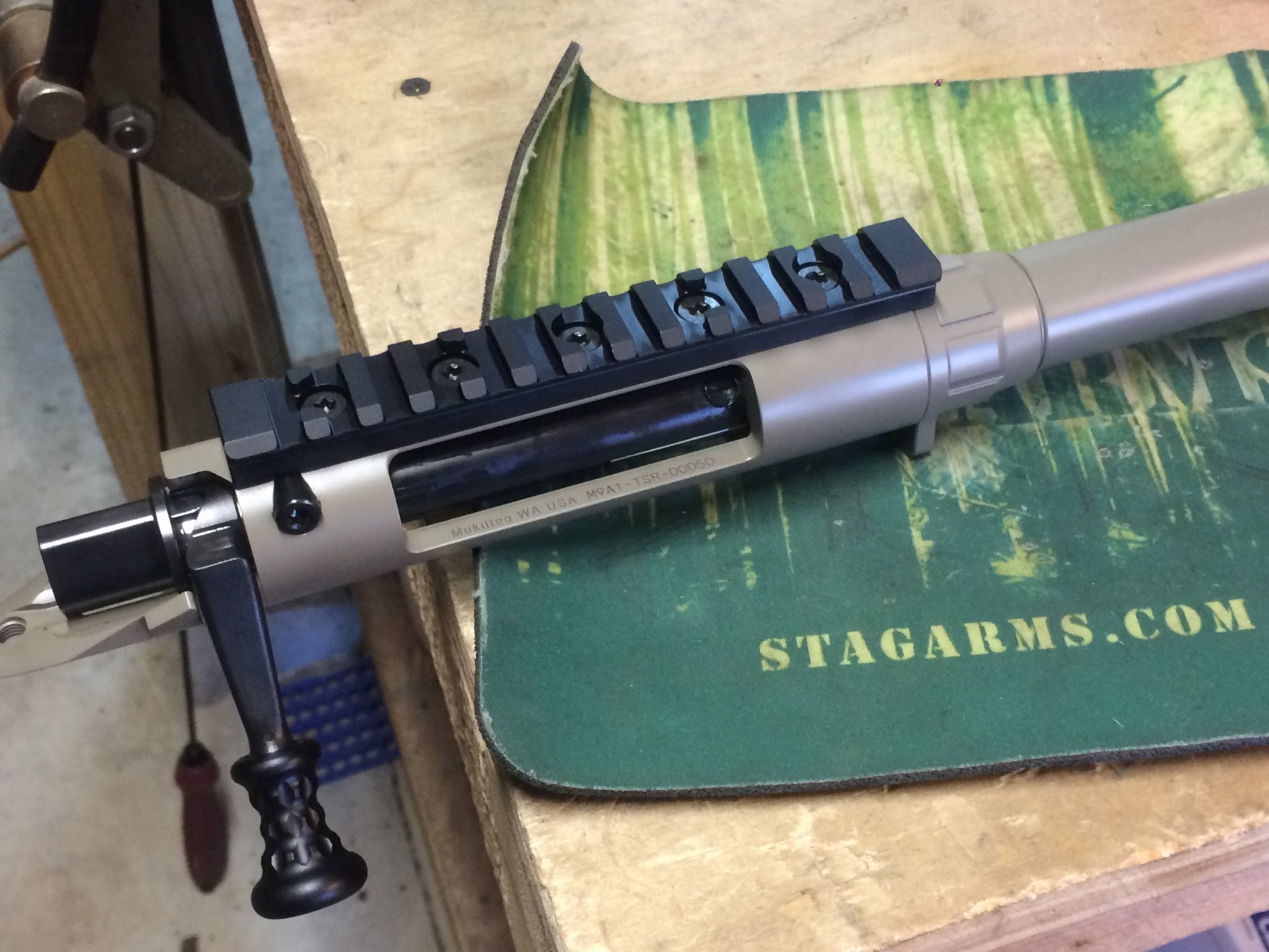

Picked mine up during lunch today (for those still trying to do vudoo math, i was order 245X and this serial number is in the 60s).
Obviously the machining & finishing work is top of the line. Im glad they kept the Mausingfield bolt knob. I think I got more purchase on the tear drop shaped bolt stop at SHOT rather than the knurled knob, but that could be because I was playing with my stripped action vs the JH rifle at SHOT. I wish the bolt lift was a bit lighter, but the short throw is slick. The thing that really got me is closing the bolt - I havent felt any action quite like it. This is defintiely the highest end action ive owned, but ive played with pretty much all of them at some point. Closing the bolt almost felt assisted - similar to an assisted opening folding knife if that makes any sense. I can run this bolt faster than any other action ive tried because of it. Can't find a single thing to complain about - even the serial number location is slick - very clean appearance. I too wish I wouldve ordered a 2nd, but in long action.

I wish my PVA Barrel was etched where yours is. They etched mine 1/3rd down from the muzzle and makes for a issue with fluting it.

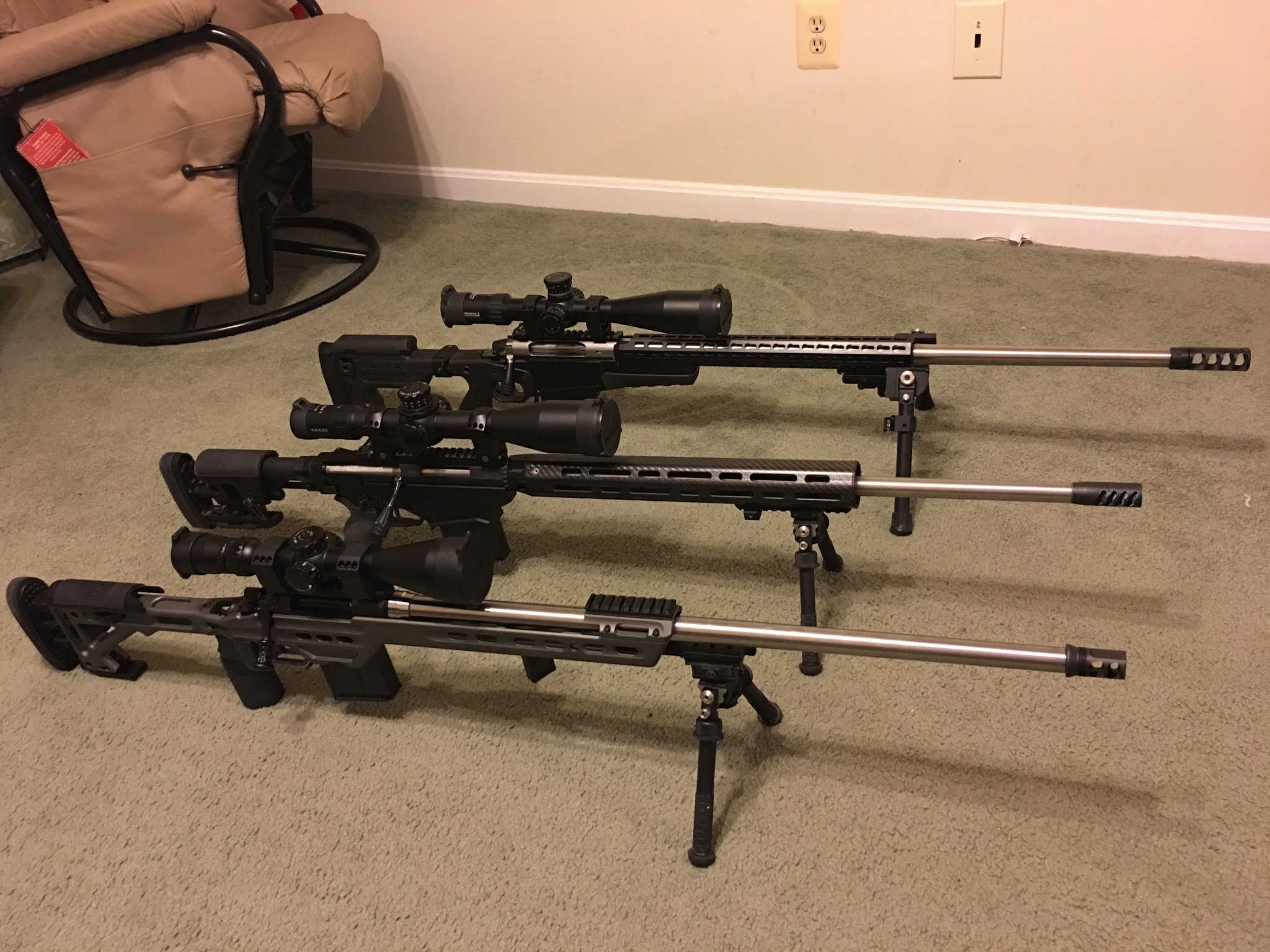

Current cycling mine next to a TL3 and RPR.

Impressions after running the three side by side:
It's not quite a fair comparison to compare a brand new action to well used ones. I also ran these dry only because the Nucleus is in 6 dasher and I don't have any loaded dasher ammo. That being said, the Nucleus is a damn nice action.
The Nucleus needs to be run with authority. I foresee it having issues if users pull back on the bolt too slowly. In order to activate the ejector, the bolt must be pulled back with some amount of force. Pulling the bolt too lightly or slowly causes it to just stop at the ejector. This may be something that just need to wear in however as I notice it getting better already. There is also some binding when the bolt is all the way back. I have determined this is a result of the extractor making contact with the receiver. This is not very noticeable when running the bolt fast. It is noticeable when running it slow. The extractor seems to be a floating design with no spring pressure on it keeping it in a consistent position. Here is the extractor and the marks from making contact with receiver can be clearly seen:
The bolt lift is certainly heavier than the TL3. That's expected since the TL3 is a 90 degree action and known to have one of the lightest lifts made. I would say the bolt lift is on par with, if not slightly lighter than the RPR. This is actually a pretty close comparison as they are both 70[ish] degree actions and both have dual cocking cams. My RPR has a longer bolt handle than the Nucleus so the fact that the Nucleus may have edged it out is certainly a good thing.
When putting upwards pressure while trying to push the bolt forward, it is difficult and binds, similar to the TL3. I would say it doesn't bind quite as badly from upwards pressure as the TL3 does. With downward pressure, they both run well, with the smoothness going to the TL3. The RPR runs regardless of what direction the bolt is pressed.
As far as the bolt moving forwards and backwards goes, the TL3 is easily the smoothest. The RPR bolt makes contact with a lot points within the receiver. While I wouldn't call it "rough", I would describe it as "bumpy". The Nucleus is similar in that respects but not quite as bad as the RPR. The aforementioned binding with the extractor does not help.
Bolt close is very different between the three. The TL3 closes with smooth even pressure. The RPR has a bit of resistance as soon as I start pressing down. As soon as I break that bump, the bolt snaps complete shut. The Nucleus seems to require me to push forward a bit while pulling down in order to get it to shut. I noticed in a few of hereinAZ's videos, he does not smoothly pull the bolt down and I am experiencing the same if I do not push forward while trying to pull the bolt down. There is a little plunger on a spring at the back of the bolt that is causing this. Not sure what purpose it serves. I think this is a non-issue if cycling the bolt quickly like in a match.
The RPR seems to require less effort to cycle back and forth. I can certainly cycle it faster than I can the Nucleus. The Nucleus is faster than the TL3, but my TL3 is a long action so no quite a fair comparison.
Tilt test. I'm not really a fan on this test, but I've seen come people conduct comparisons with it before. With the bolt fully open, I tilted the rifles downwards to see when the bolt starts sliding forward. I feel that there are a lot of other variables taken into account and that it's not a good test for action smoothness. The TL3's bolt was the first to move, requiring the least angle to do so. This was closely followed by the RPR. The Nucleus required a near 45 degree angle to get the bolt to move. I think this is in most part due to extractor binding.
Overall the cycling of the Nucleus is not bad, especially when running it fast. However it seems that this action NEEDs to be run fast to function. I will continue to cycle it and see if it breaks in more.

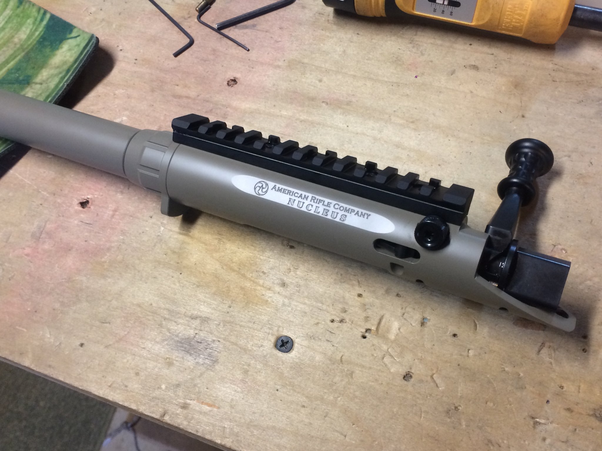

Got my nucleus yesterday threw a fresh coat of elite sand cerakote on it this morning. Bought for the wife to start shooting and she wanted robins egg blue but I told her I couldn’t get caught shooting a blue rifle haha. Overall it’s a solid action from what I can tell. Wife should be happy with it
You can see a few threads on a shilen savage prefit. Not a big deal to me but it might bother some. Now I just need to find a mpa chassis for it

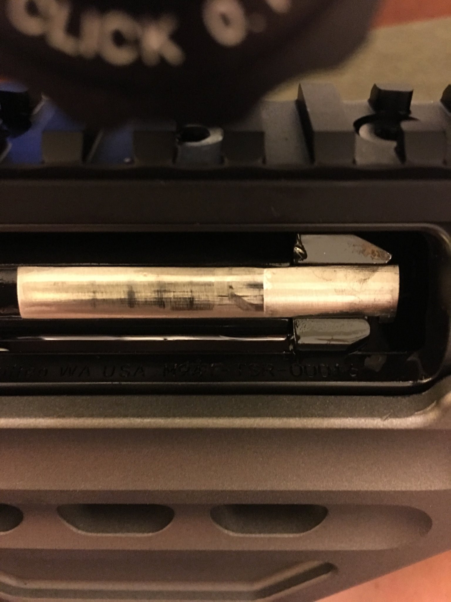

Anyone running the bolt seeing the cartridge snap into the extractor before you run the cartridge all the way in? Mine doesn't act as controlled round feed until it is almost in the chamber. I think that is one reason I'd say it likes to be run fast or with authority. I've never had a control round feed, so don't know exactly what to expect.
I took a video of mine doing the exact same thing. I don't have a youtube account, can I text it to you to post? If you don't mind, please send me a PM.

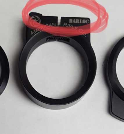

I know the recoil lug in held captive by the rail, I’m referring to the clamping mechanism being indexed by an onverhanging rail bit. That way you don’t end up using an Allen wrench to lever it into position to line up correctly.
It looks like the clamping mechanism is notched out so it can be held from rotating by an overhanging rail. That’s why I’m confused as to why it doesn’t work that way
the gap has to close when you tighten the Barloc.
and in the photos it looks like the Barloc is much wider than the scope rails
