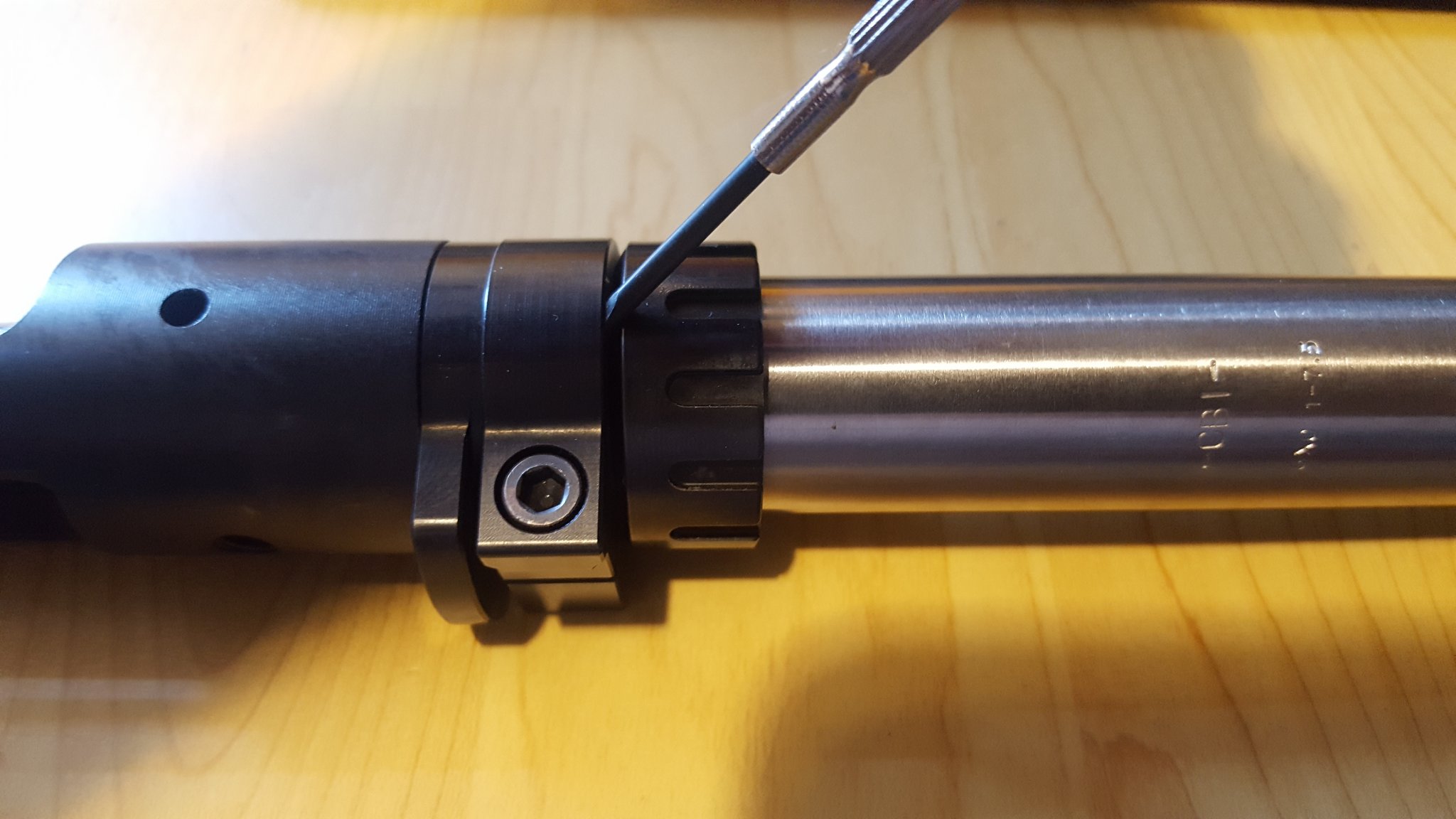

The Barloc DOES headspace a 6xc Criterion and Shillen prefit in both the Nucleus and Savage action.
The pic show how much space remains when the barrel is threaded down all the way onto a 6xc cartridge in a Savage action.View attachment 6918947View attachment 6918946

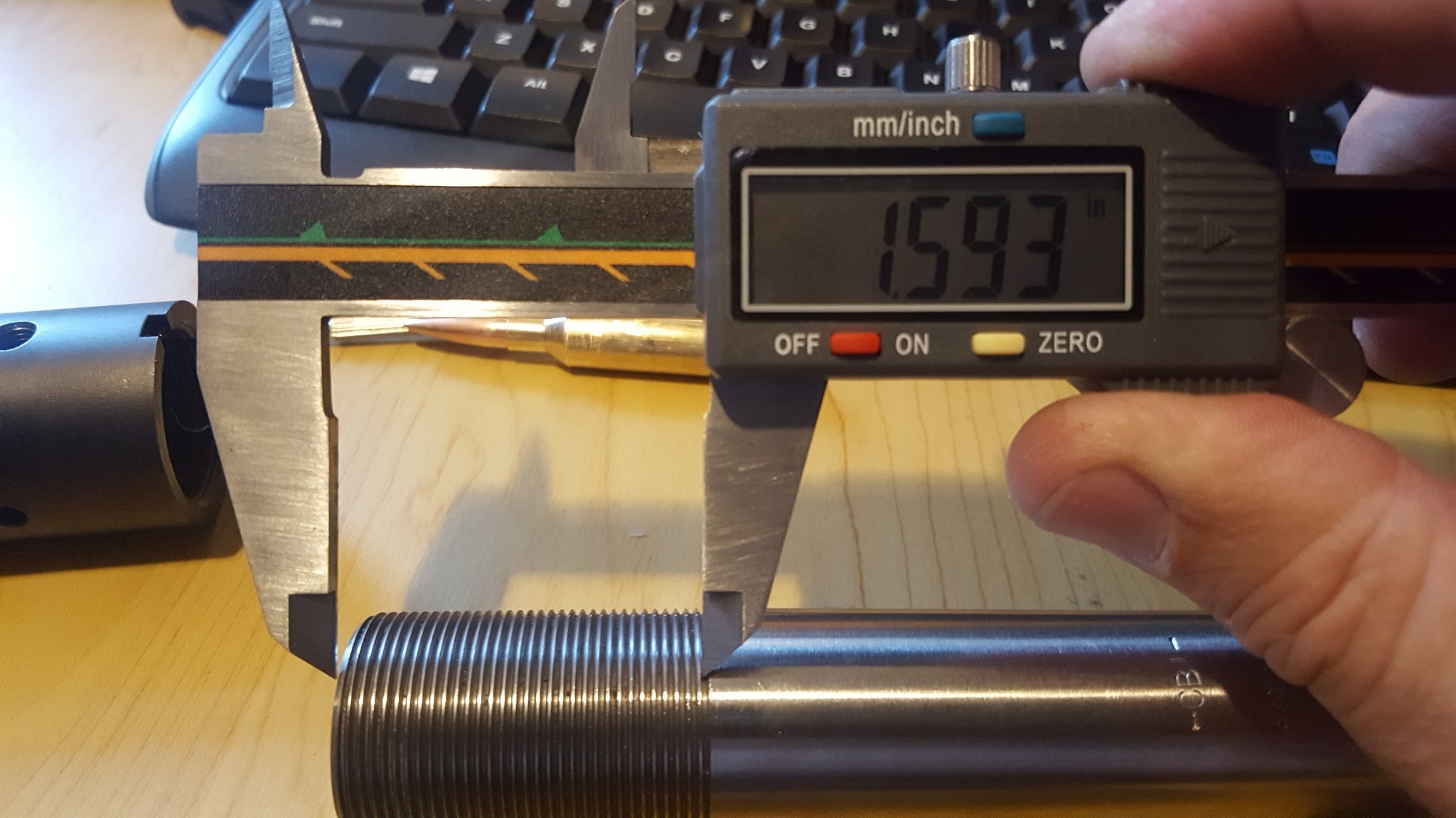

The other pic shows the length of threads on a Criterion. My other Shillen was almost identical.
