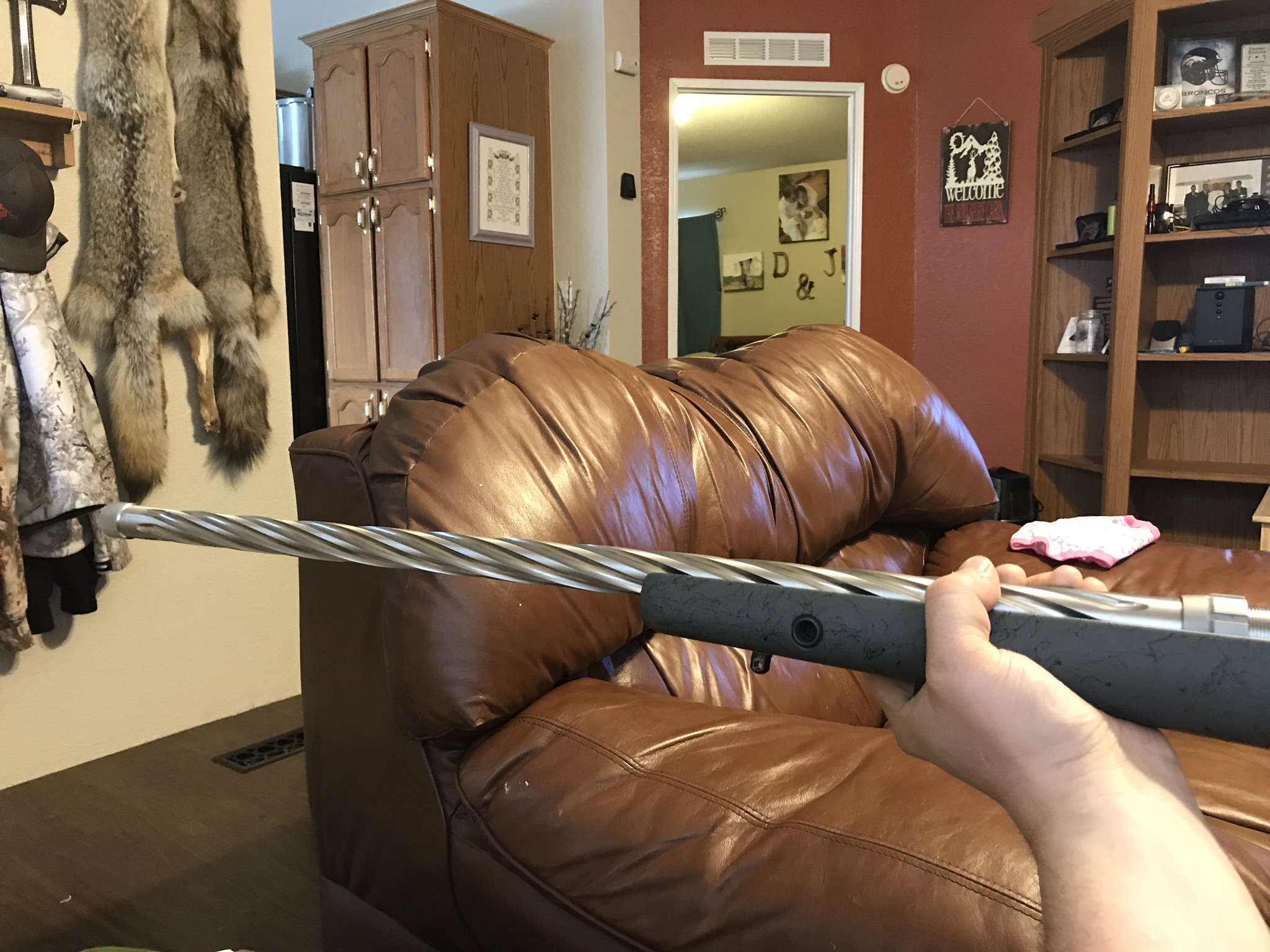

That thing is sweet. And a tangent theta on top? Nice lol. Mine is gonna be a 204. With a shilen varmint contour spiral fluted by LRI in a greyboe terrain, and topped with a Vx5hd impact 29! Love thumpin coyotes with that round. So I figured why not have a sweet action! Haha Already have a load nailed down with the barrel thanks to my old savage action! All I’ll need to do is screw it toether and bed it!

Reactions: hereinaz
