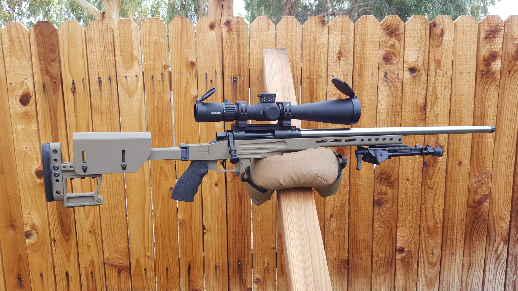

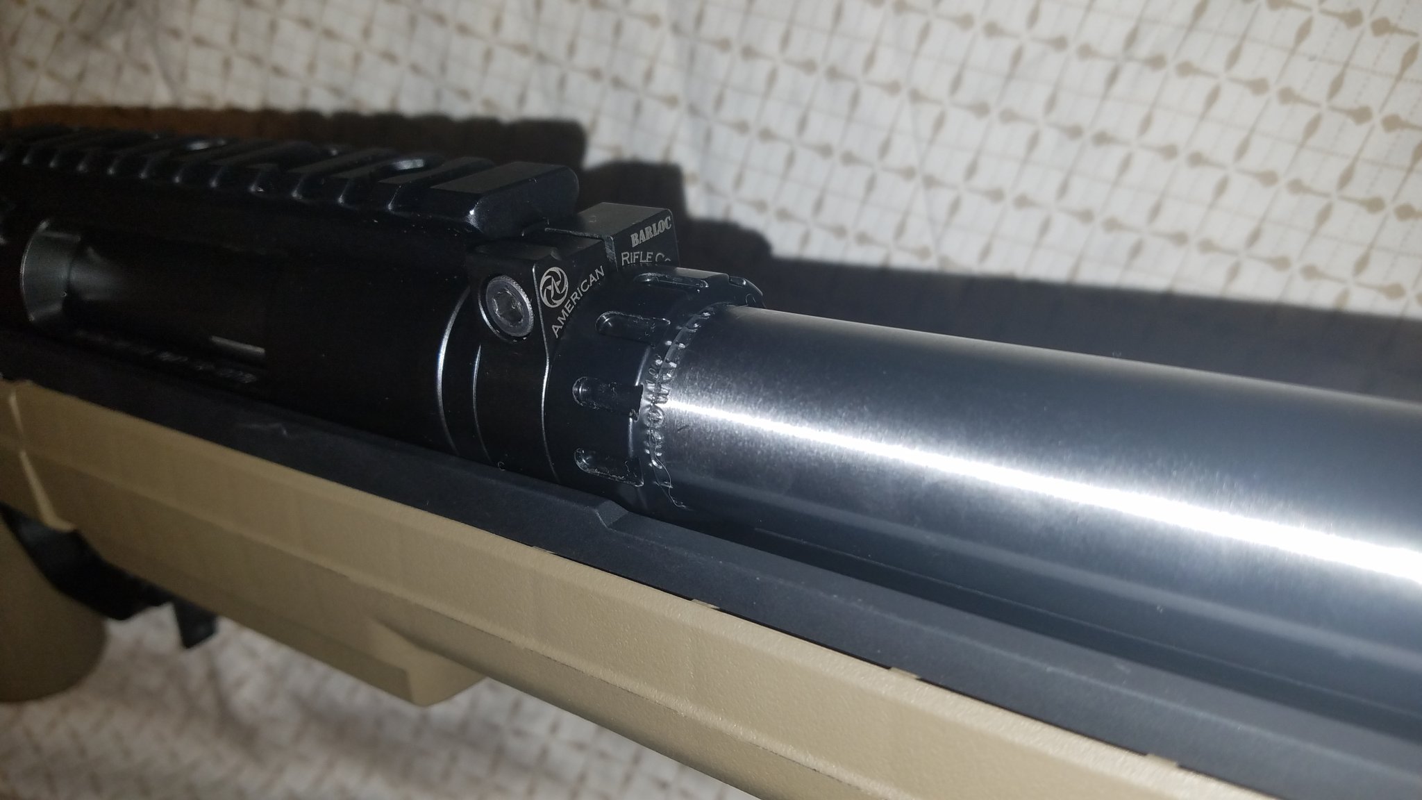

Has anyone put a Nucleus WITH the Barloc in a KRG Bravo? I'm wondering if the recoil lug area will fit all that in the chassis without modification?
Reactions: jgs8163
Sweet bro, thanks. Now that it's installed, to swap barrels would you have to remove the varied action from chassis?
Probably not, though my scope may need to be removed due to the low rings. Your mileage may vary.
This is the wild ass guess of an amateur, but wouldn't doing that without removing the action mean the recoil lug isn't properly seated? I'm not sure. It's only two screws, so I'd probably take it out anyway, just to be sure.
