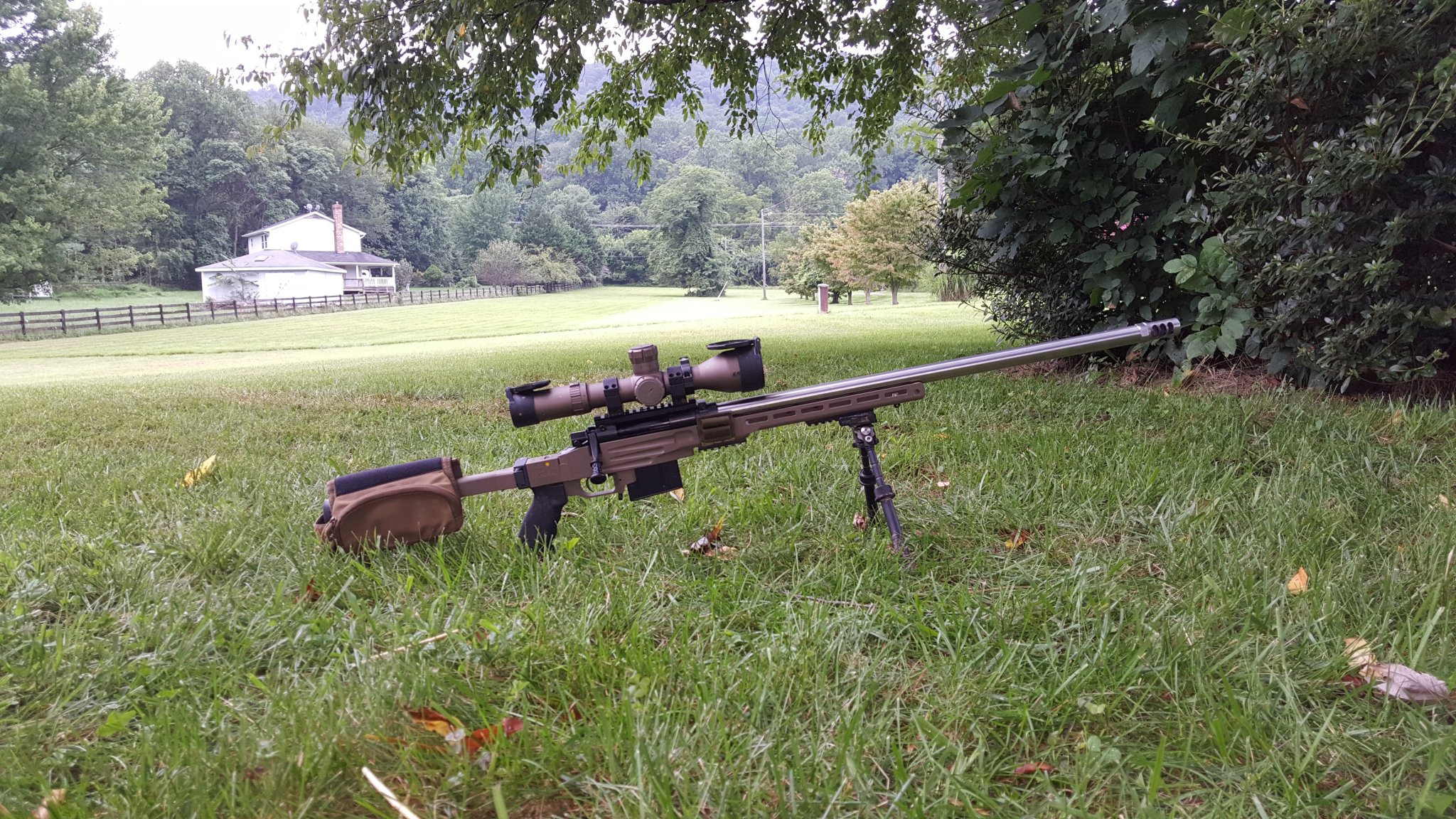

Put my Nucleus with Barloc together this past weekend. Specs:
After waiting 7 months, I finally got to put together my new build:
Specs:
Action: ARC Nucleus
Trigger: Timney 510 (For now, Huber is on order)
Barrel: Hawk Hill Pre-fit chambered in 6.5x47 Lapua
Brake: APA Lil B*stard
Scope: Bushnell ERS 3.5-21 x 50
Chassis: Mcree G10
After getting the hang of the barloc it was really easy to put together. Not sure I'd want to change the barrel at the range, but I liked the system for changing the barrel at home. Action felt really tight at first. It now feels very smooth and is breaking in nicely. About the only thing I don't like is the bolt release. That little knob is a PITA to turn. Overall, really happy with the purchase. Have 50 rounds through it now, and plan on shooting it at the Kestral PRS match this weekend

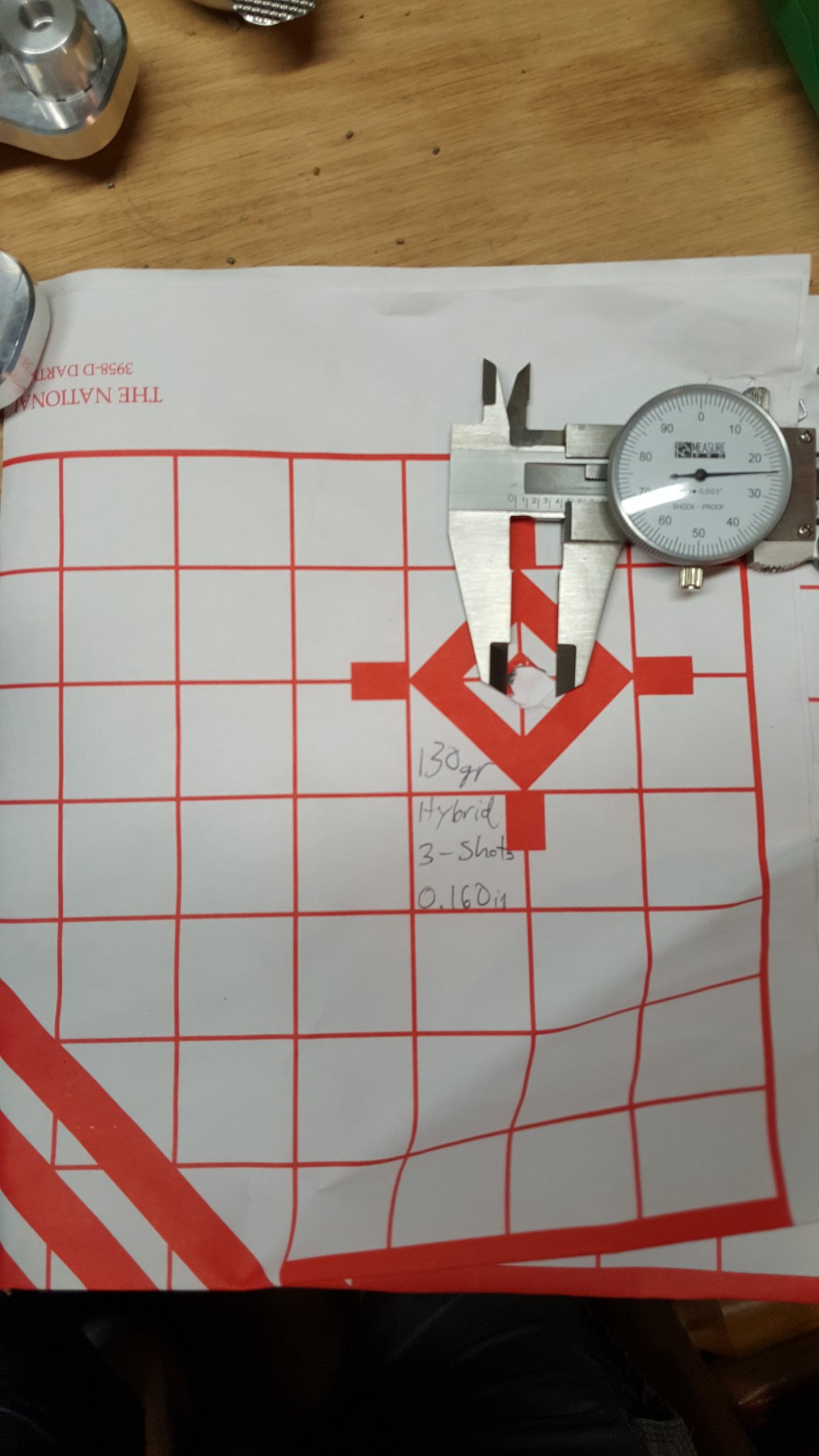

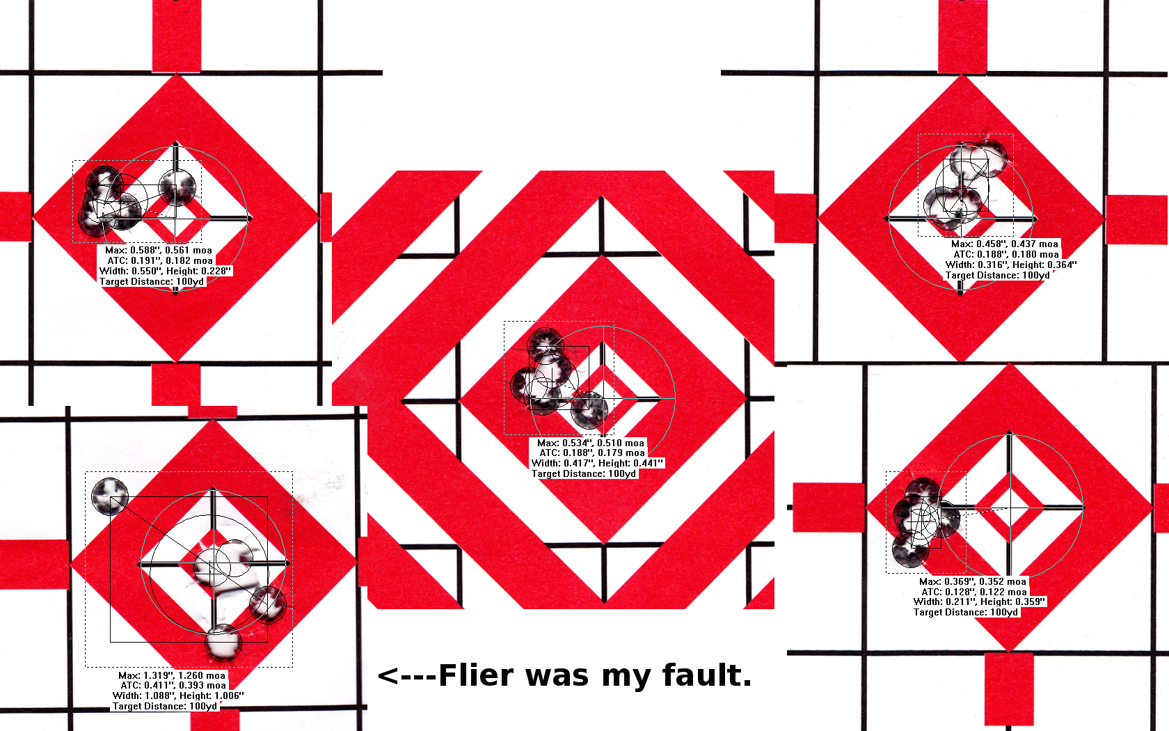

Pic of the rifle below, and shots 18, 19, and 20 of the 3rd load I put through the rifle:
View attachment 6933150View attachment 6933151
Looks like you found what it likes to eat.

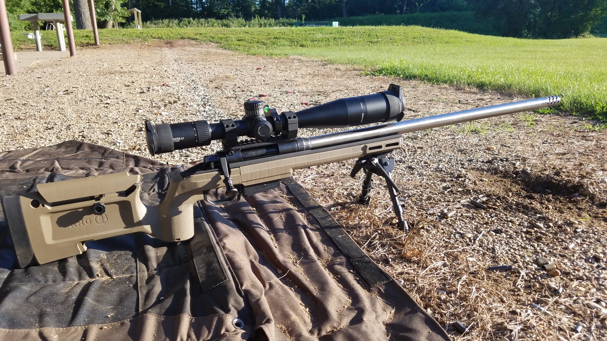

Nucleus action arrived this morning. The action is damn smooth. Doesn't move the rifle off target when operating the bolt like the bolt on the Savage does. Cannot get it to bind no matter what I do.
Bolt stop is difficult to operate in order to remove the bolt. The detent is pretty strong. Seeing reports that it wears in a little.
With the factory Savage barrel nut, I can see one thread on the barrel from this manufacturer. Not a big deal, but I do hope it's not present when I get my Barloc.
Right hand short action, 0.475 bolt face, 20moa rail
KRG Bravo
X-Caliber 26" Savage bull contour 6.5 Creedmoor with Pepper Pot muzzle brake
TriggerTech Diamond
Vortex PST Gen II 5-25x50 EBR-2C MOA
