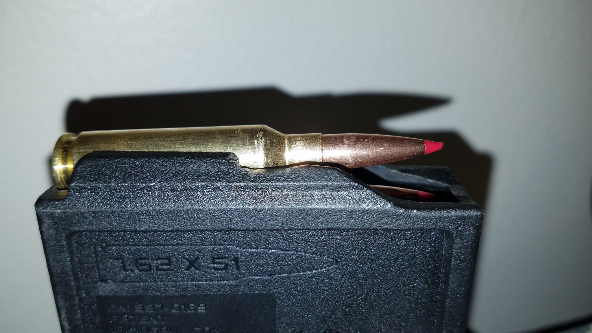

Tried trimming the feedlips on a MagPul 5 round AICS mag. Looks bubba as fuck, but damn, did it work.
This is with 6.5 Creedmoor. Previously, my rounds would push feed unless I was running the action fast. Now it controlled round feeds no matter what. Will have to crank up the machinery to get my Accurate mags to do the same.

I hate to be the bearer of bad news but it would appear you are having a similar issue.
To test this hypothesis, move the bolt forward until the stripped round/case base clears the shoulder of the round in the magazine, now move bolt rearward. Does it continue to control the round or does it leave it sitting halfway in the chamber? You should be able to move the bolt rearward at any point and maintain control of the round in a controlled round feed. A Mausingfield, W70, and TL3 will all maintain control.
Please notice the difference you can see in the video how the TL3 bolt does not have to reach the chamber to eject the round.
Does this mean the Nucleus isn't a tough and reliable action? No. So far it has performed extremely well without malfunction. But it isn't control round feeding.
I will get a video up later when I have time.
I just tried it. You're right.
If I pull it back immediately after the round leaves the magazine, the extractor doesn't grab onto the case. But if I push it far enough forward that the bolt face comes flush with the forward inside edge of the ejection port (but not fully into battery), it will fully grab the round. Any less, and it either pulls the round halfway out and lets go of the round, necessitating it be pulled out manually, or it just doesn't pull it back at all (like a push feed), meaning I have to bring it into battery to get it out.

The issues with CRF seem to be more with tuning the extractor and cutting back the feed lips than the chassis or stock. The mag has to be high enough for the bolt to strip a round, which I why I am thinking it is extractor related. My question is whether anyone has tuned the extractor yet?
That extractor is the obvious next step after cutting feed lips, but I'm not brave/desperate enough to attempt to dive into that yet.
I am not in a hurry either. At some point, when I have a few moments to concentrate, I am gonna research how to do it and then I will break out the needle files. Anyone have anywhere to point me? From what I understand, it is just adding a little radius to the extractor to tune it. Worst case I buy a new extractor, but I really don't think I'll have to do that if I go slow. Also, I'll be able to polish the exterior of the extractor while I am at it.
Here is a thread I saw about the Mausingfield CRF, seems just as applicable here...
http://www.snipershide.com/shooting/threads/mausingfield-feed-issues.6473960/
Nice find. I learned something new today.
