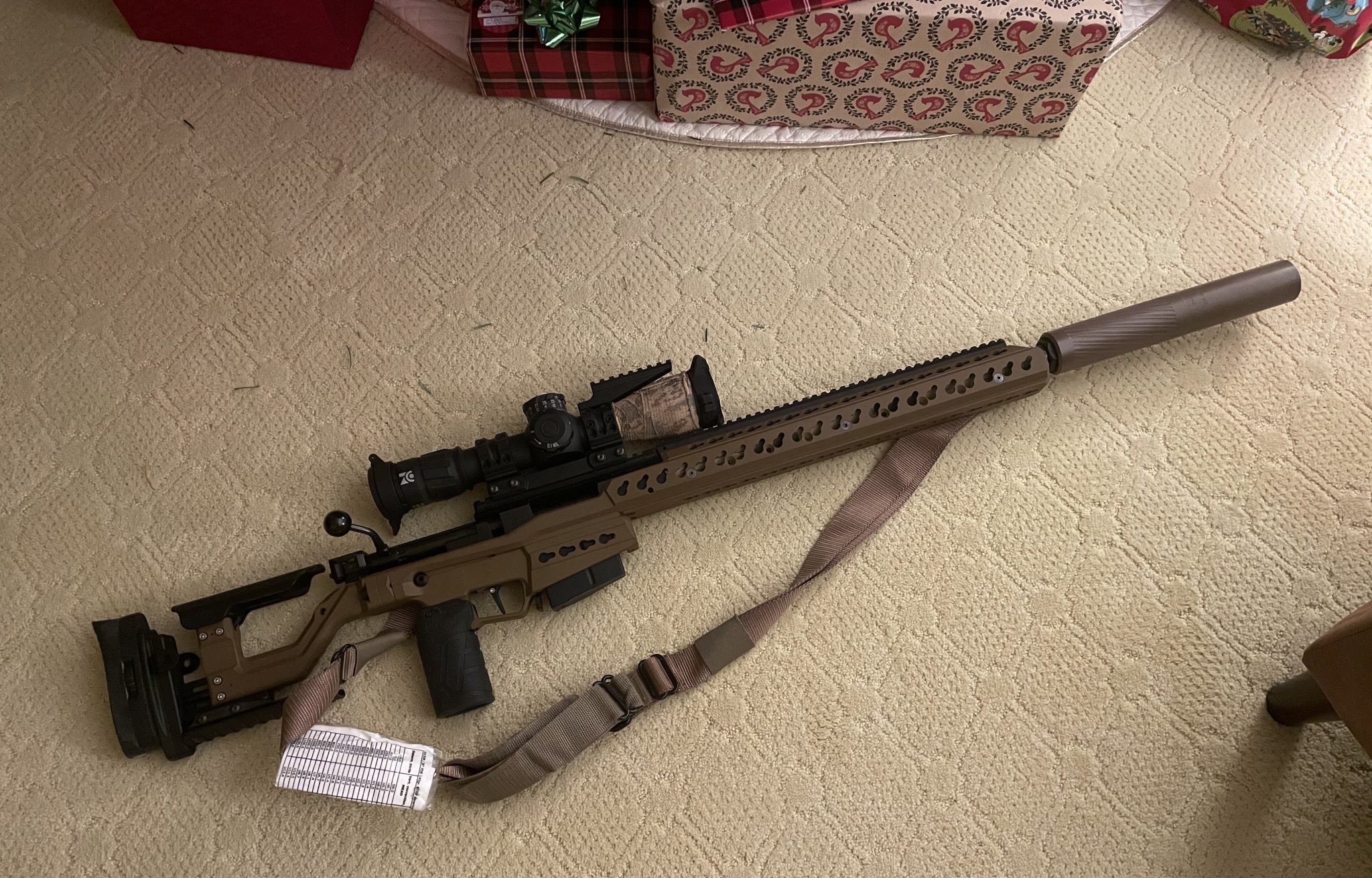

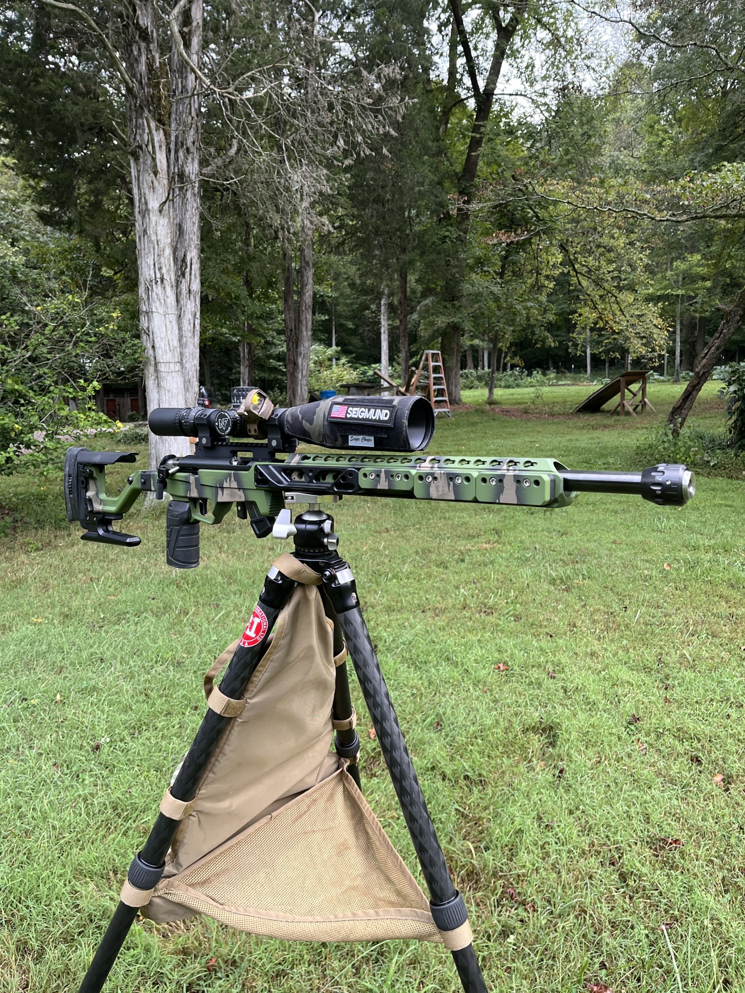

Less talk more pictures....But any reason I might be having issues with the bolt not stripping the next round every so often? First AI rifle for me. Do you have to run the bolt quick/fast? I was gathering data today for the first match next weekend so I was going a little slow.

Is it a first gen rifle? They shipped a load of them with this issue. Never quite got the bottom of the probelm (AI wouldn't admit there was an issue), but generally the magazine was sitting too low in the mag well and cartridges didn't always sit flush against the mag feed lips, so the case head sat low in the rear of the mag. This combination meant the bolt head didn't properly connect with the case head, so the bolt would ride over the round. Solved in come cases by shimming the mag catch and changing the magazine follower. There was a long thread on here about the issue, but it's since disappeared.

+1 Check the SKU of your magazine.

I don't think so...believe it's a gen 3. How snug do the mags sit when properly adjusted? Im able to push up maybe an 1/8 of an inch if that when its latched in.
@cypriss32 could you confirm what gen? Did you have any issues feeding?

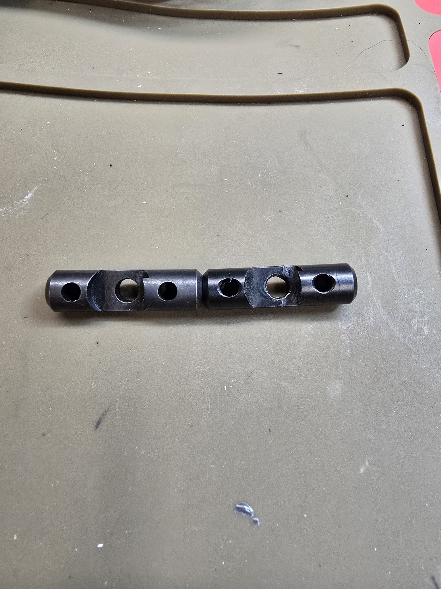

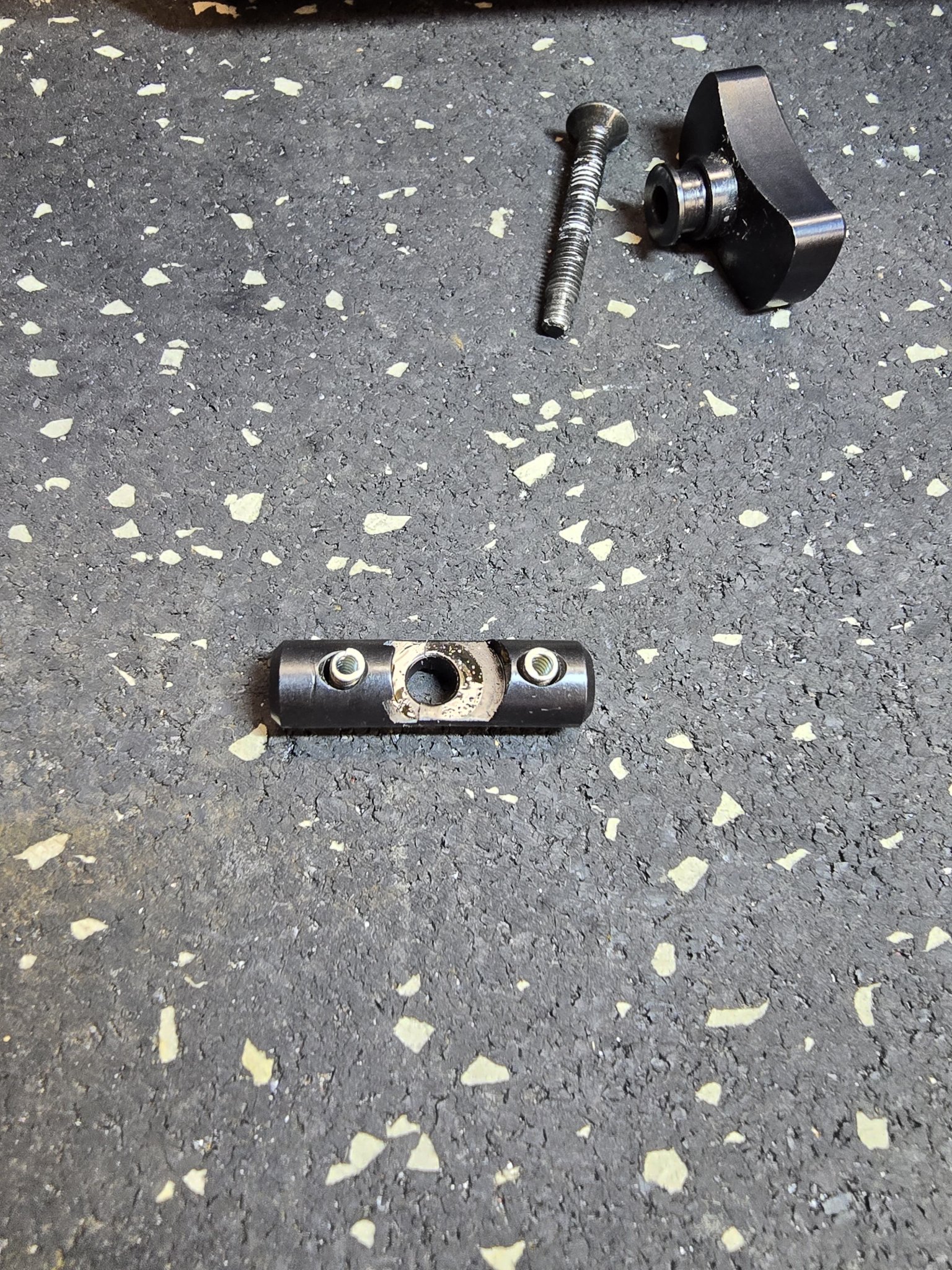

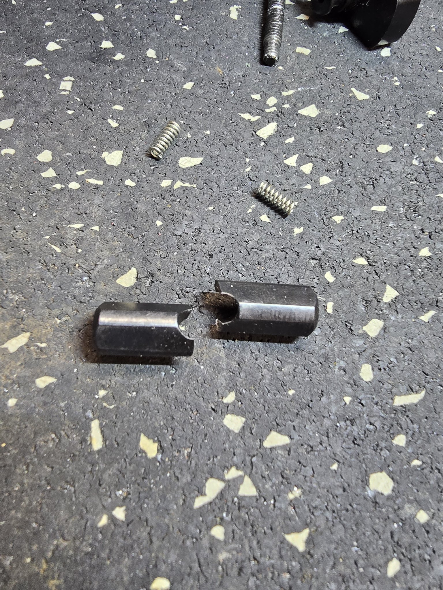

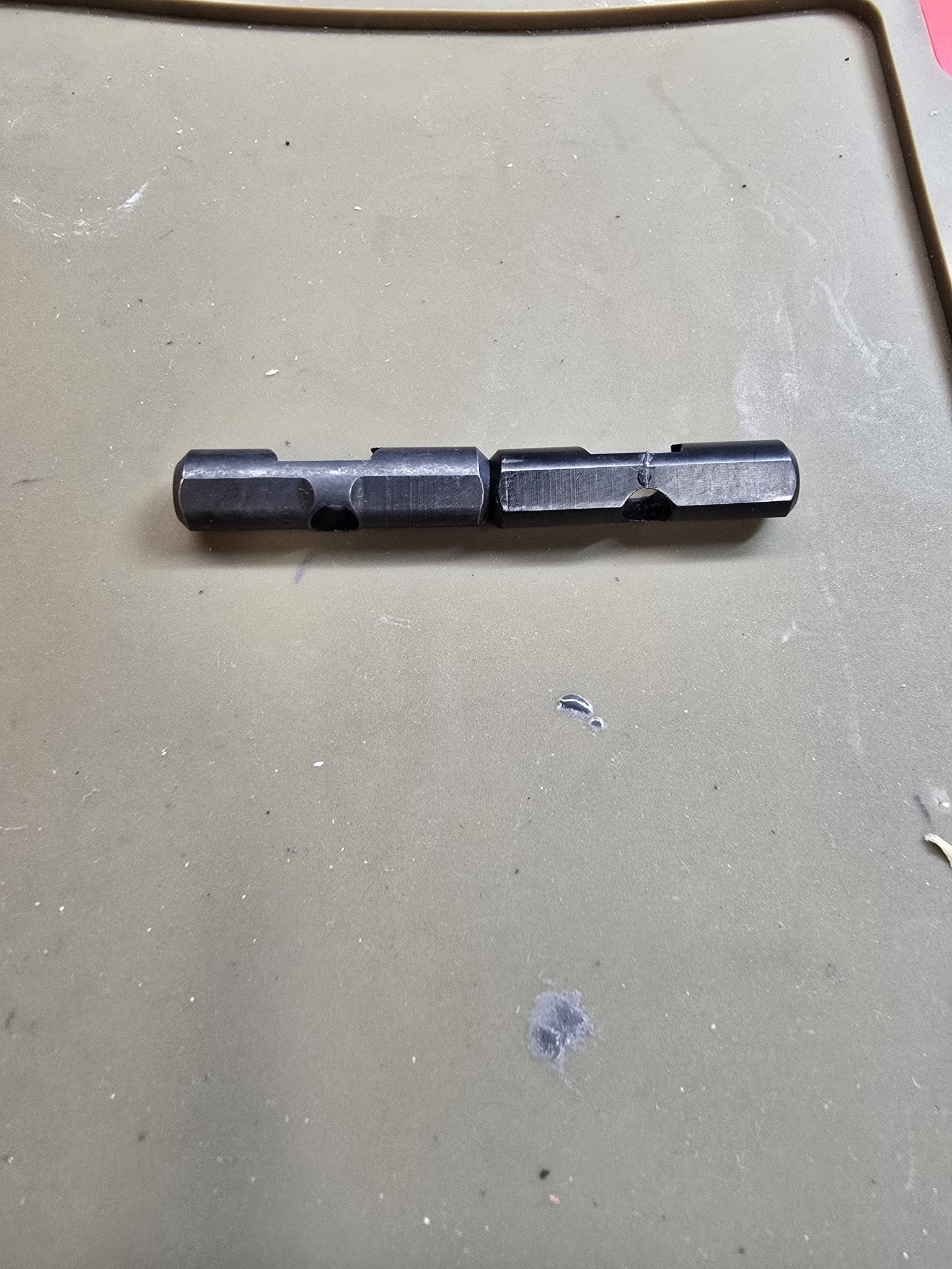

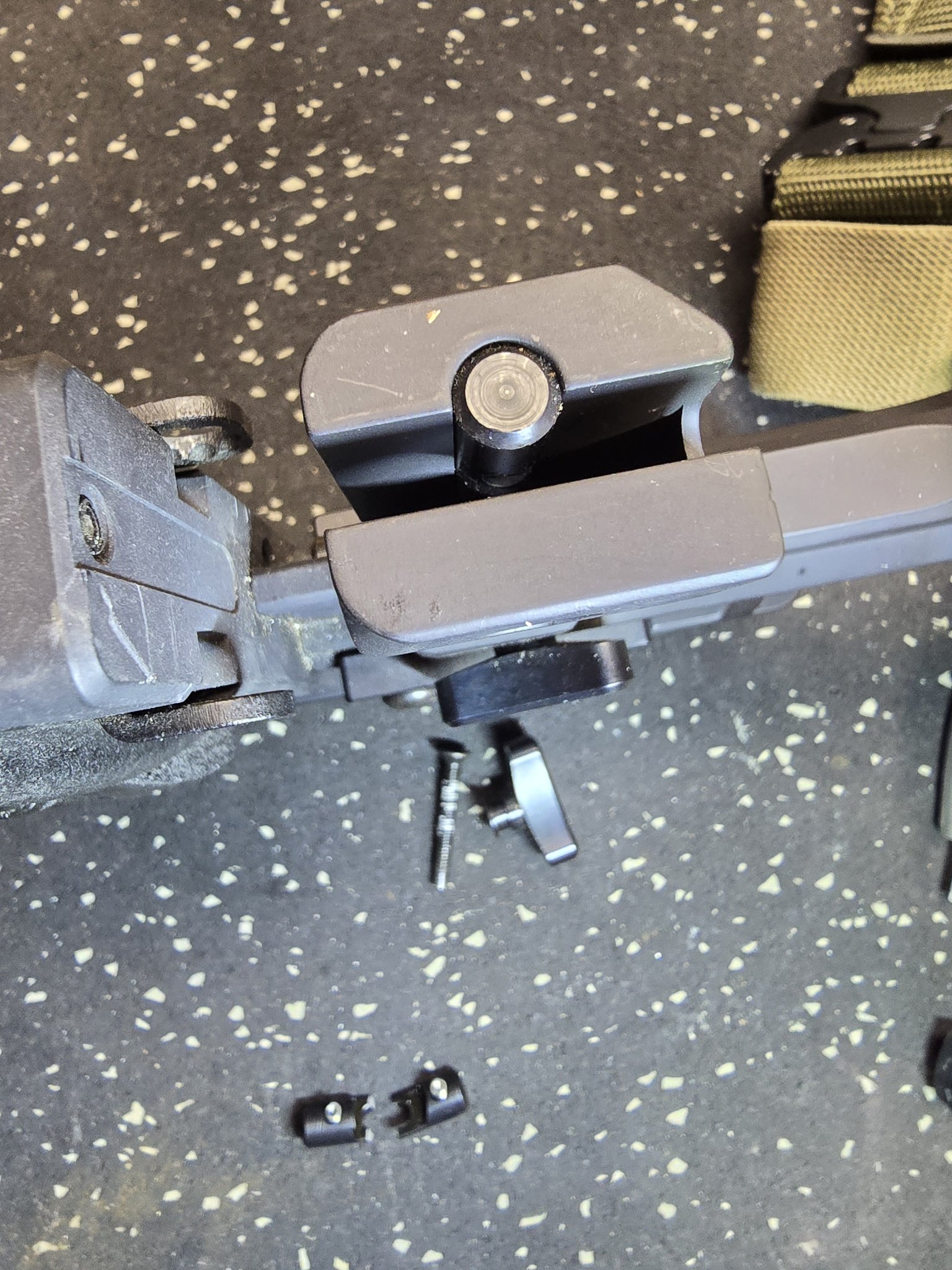

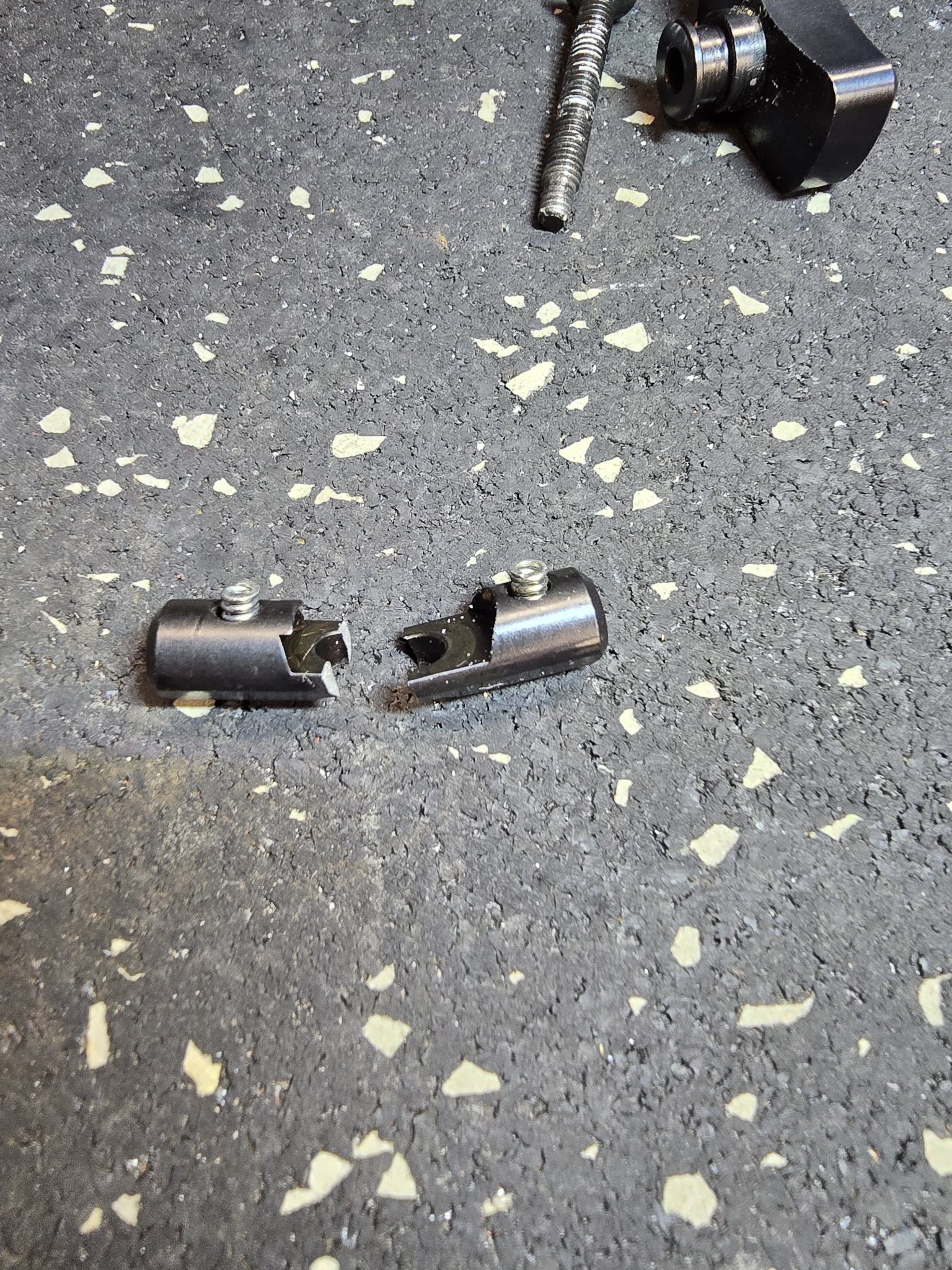

Good afternoon guys!
I was training this weekend and I noticed my cheek riser mechanism moving around. I checked the tension thumb screw and it was tight.
So I pulled the cheek riser out and saw this.
Any idea where I can get this cylindrical part from?

Call Mile high and they should be able to get one for you
