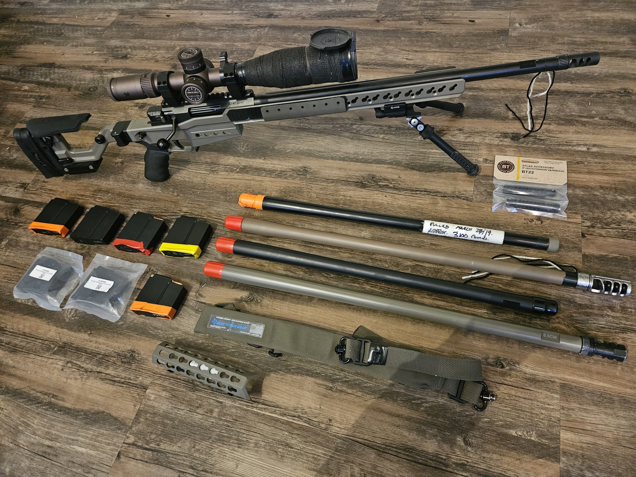

Anyone heard any updates on the 6.5 PRC bolt and mags?
Saw the barrels on Mile High with a vague ETA.
With the folders finally coming from the factory I’m going to pick up a AT-X this spring. On paper it seems doable to make weight for NRL hunter with a proof cf barrel.
“oN pApEr”
Very slim margins man; can be done with compromise
Reg length CF or short steel. Seen it both ways on ATXs

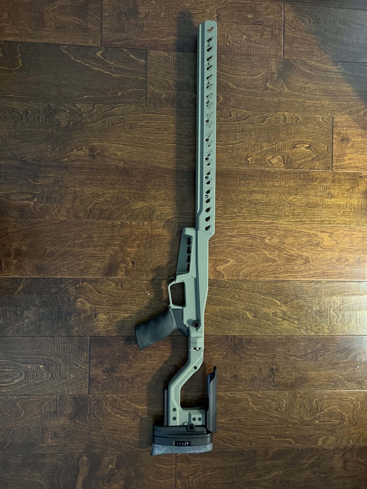

New beginnings
