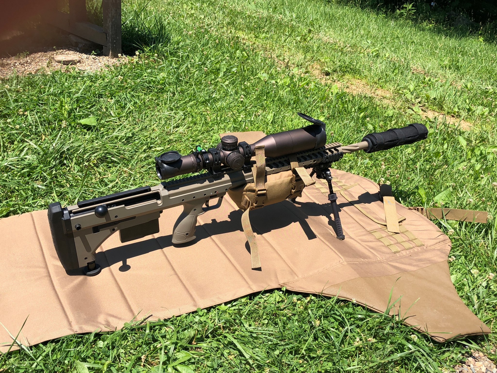

Hey guys, wanted to post an update here. Got behind the SRS today to stretch her legs a little. Out to 1020 yards, and she did very well. The Hornady ELDX in .300 win performed better than I expected. I have a 26 inch barrel, and a TBAC Ultra 9, velocities around 3025-3050! The SAC barrel has 170 rounds through it now, it was also 90 or so degrees shooting today. Wind was a non issue, and I found myself overcorrecting for wind quite a few times. A few guys at the range were shocked at how well the Ultra 9 suppressed the .300. It is absurd how quiet the can is and its weight. Great day out at the range. Looking forward to more time behind the rifle this summer.
