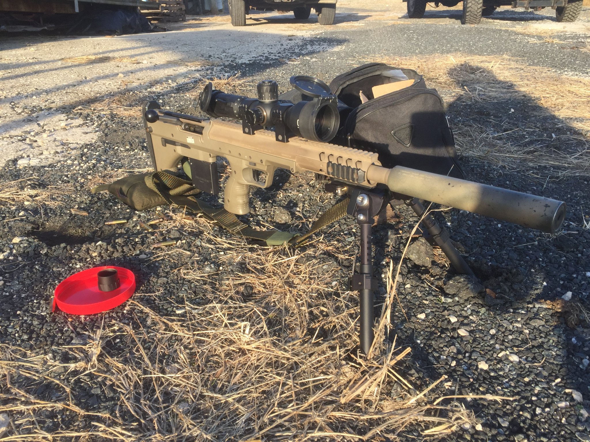

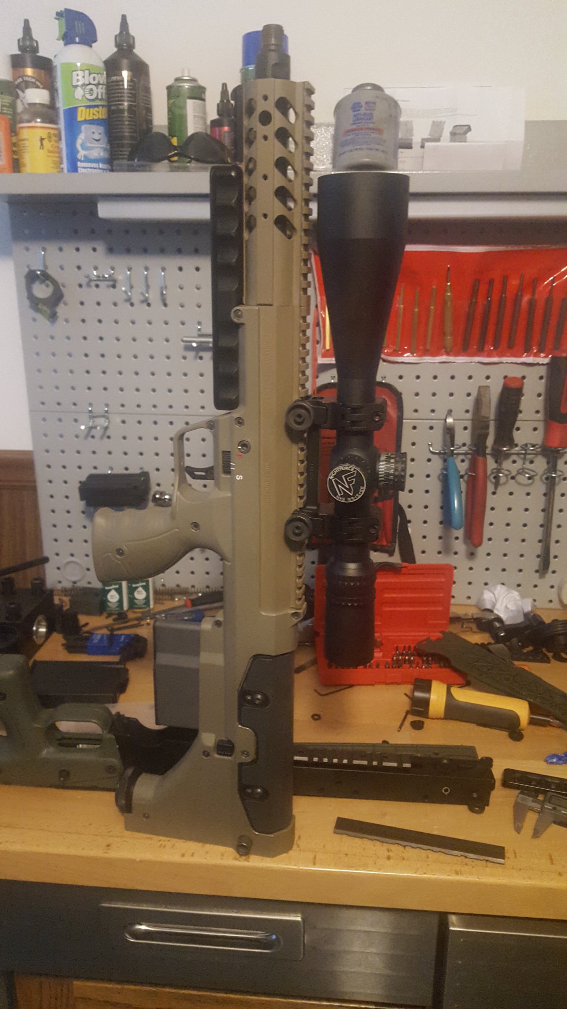

I went with the 7.7 twist and I’m shooting the 73 gr eldm. That’s it in the middle with the can

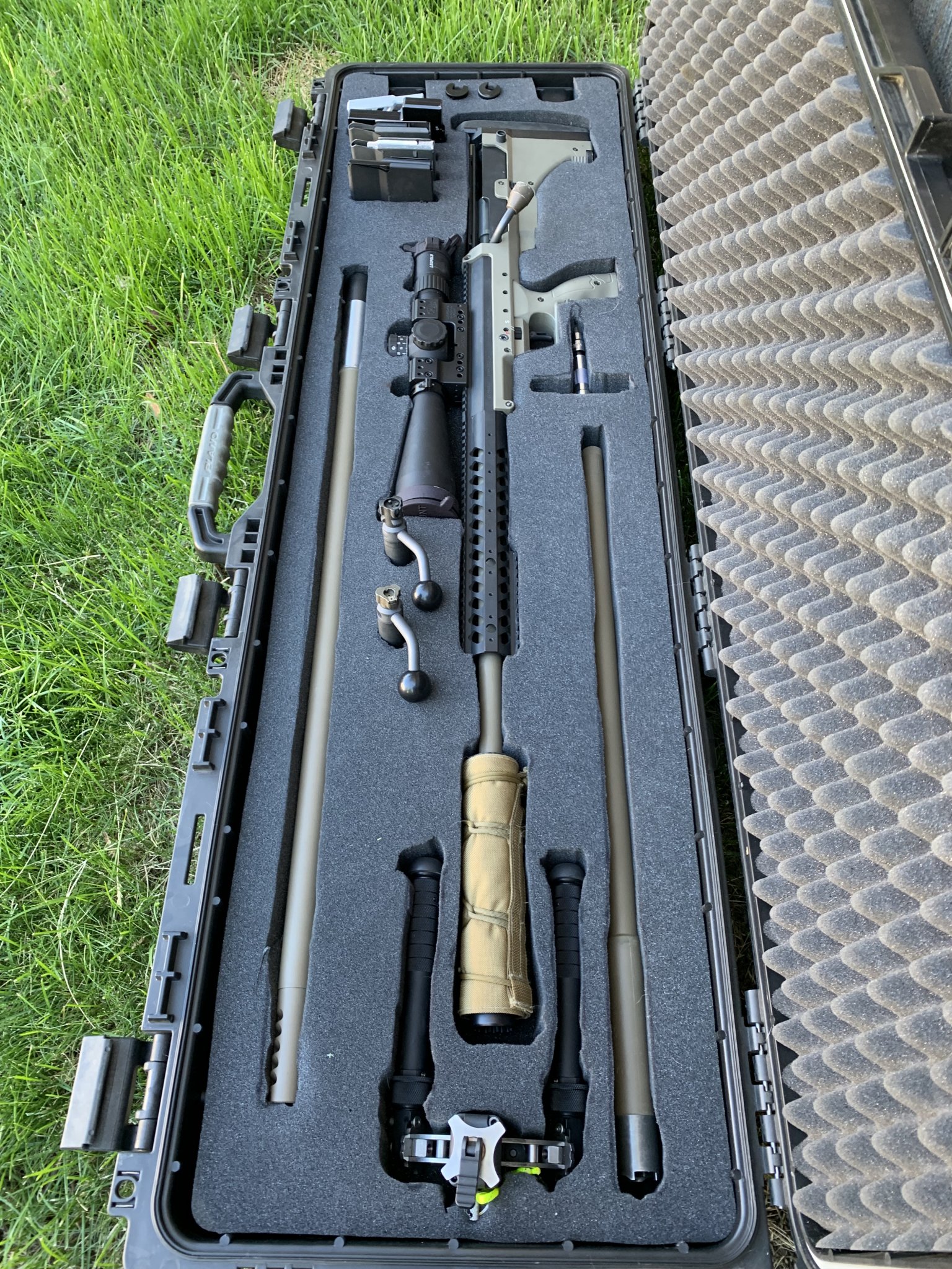

Received my 223rem conversion from SAC today. The fit and finish of this package is absolutely top notch. I thought they screwed up and didn’t thread my muzzle but it was just the thread protector that was so well machined that you couldn’t even tell there was two different pieces. Packaging was immaculate and everything went together perfect. Now to see if it will print tight groups in two days.

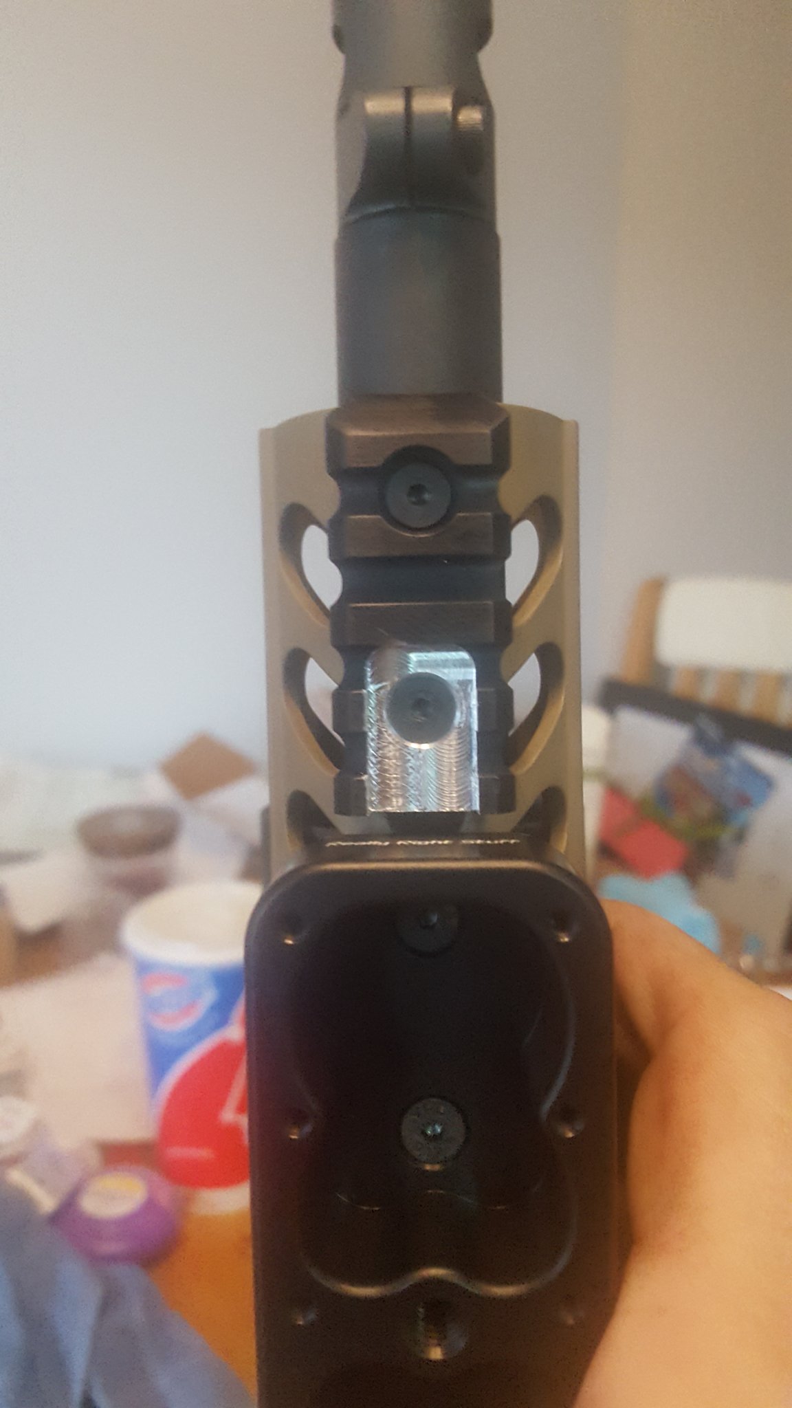

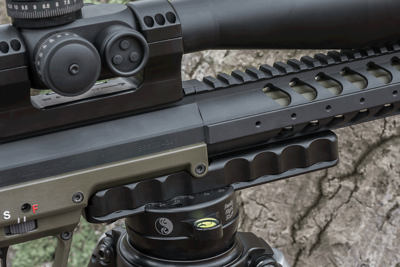

What is that lol I was talking about this. I just ordered one. Should I cancel it

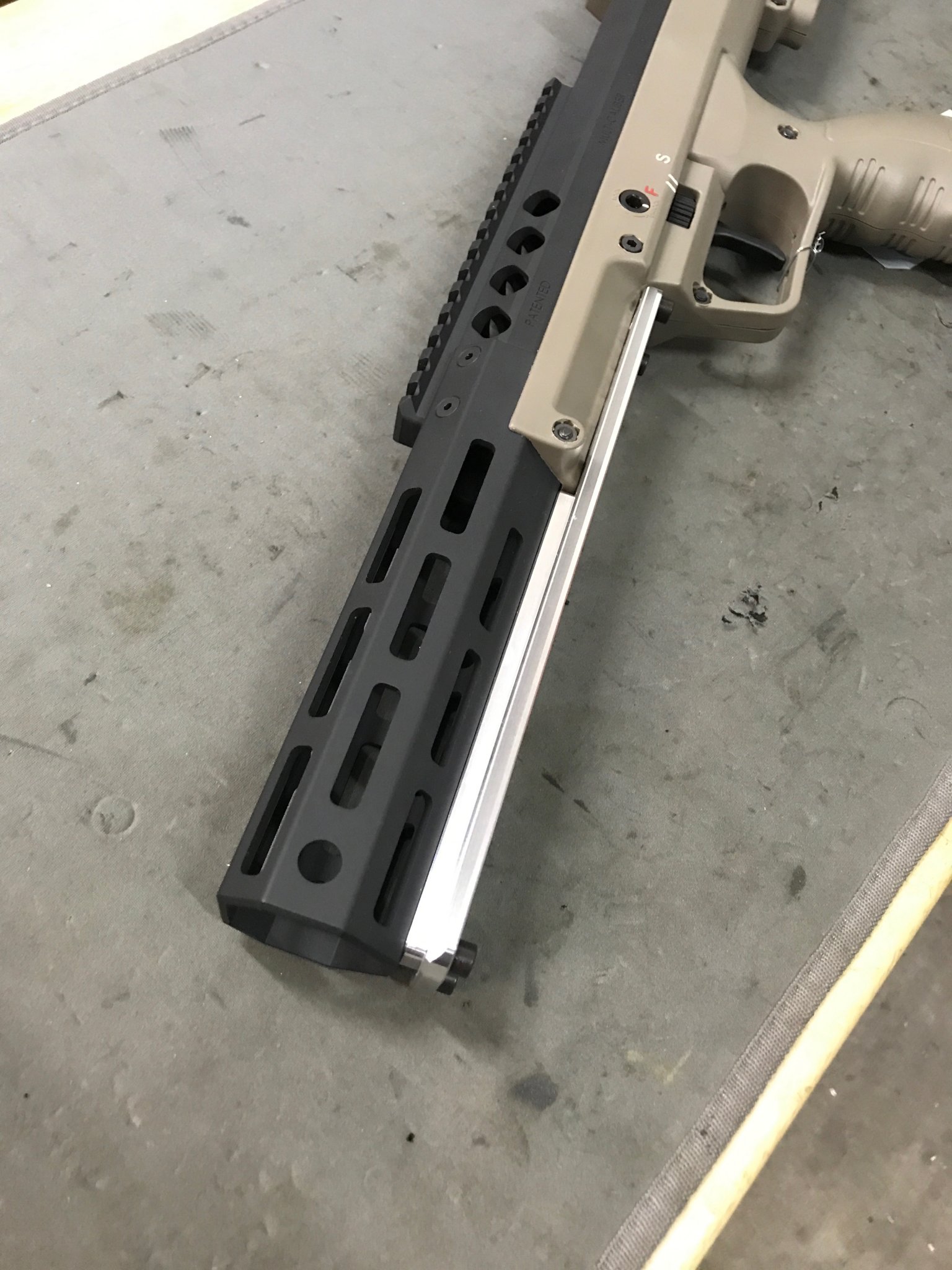

That will fit an A1. However, it mounts will three bolt and for some reason on the Covert Rifles, Desert Tech did not drill and tap one of the screw holes.
The style that we are currently working on will work with the A2 Covert and SRS chassis. We will have a shorter rail like the RRS the will mount on either a Covert or SRS. We will also have full length rails for the Covert and SRS.
  • Sad
Reactions: deersniper
Does your rail fit a a1?
