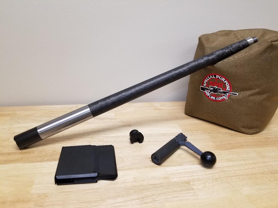

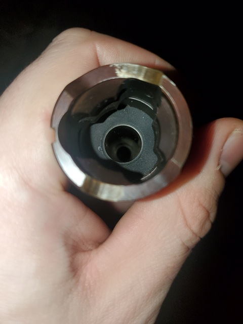

What is this barrel shank, Ext A or Ext B? Not sure if this is the old style barrel extension or one that would work on the newer SRS A1 rifles?
Feedback appreciated.
My 223 kit is shipping today.
Like everyone has said, that is an old Gen 1 barrel extension. The good news is you can send the barrel in and have the barrel extension changed to the current Gen 2 barrel extension which will work in all the chassis from Gen 2, SRS-A1, and the current SRS-A2. The barrels themselves haven't changed. Just the way the barrel extension indexes the chassis. Here at Special Purpose Rifles we can swap out the barrel extension for you so you can still use the barrels. Just message us and we can see if it makes sense to go that route as far as cost goes..What is this barrel shank, Ext A or Ext B? Not sure if this is the old style barrel extension or one that would work on the newer SRS A1 rifles?

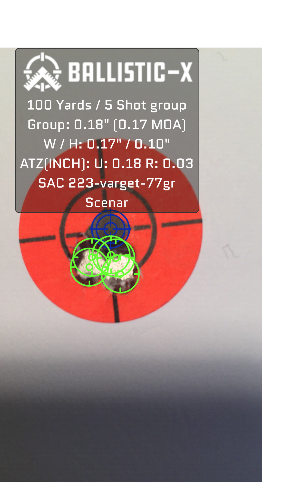

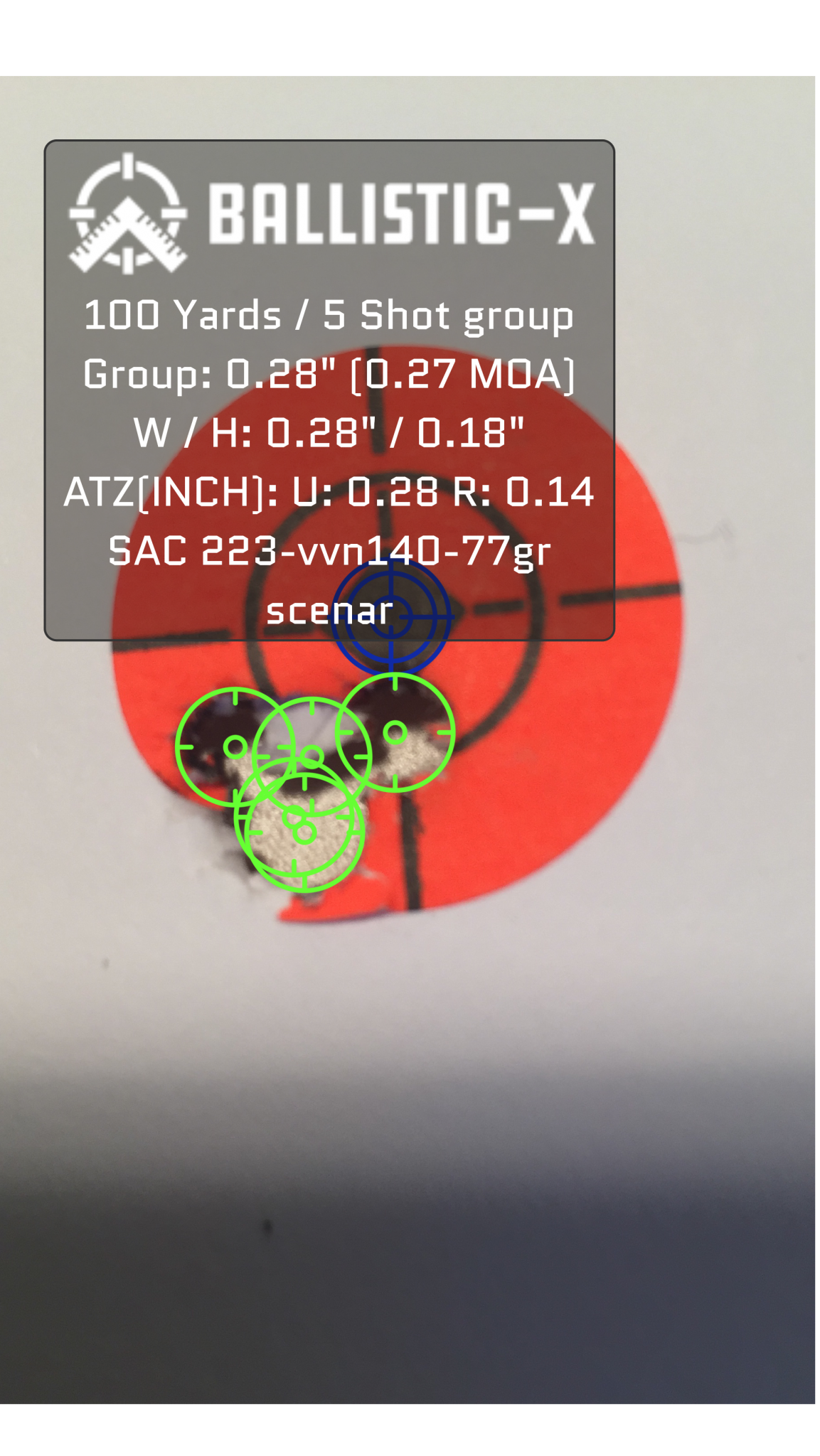

Maybe this will increase your anticipation a little more. Shot these groups just this past Sunday. One was with varget, the other vvn140.My excitement level in anticipation of receiving the 223 kit just went way up!
Did you go with the 1-6.5 twist or 1-7.7 twist barrel?Maybe this will increase your anticipation a little more. Shot these groups just this past Sunday. One was with varget, the other vvn140.
Ok now your just being a dick. Just kidding. Those are some seriously awesome groups. May have to try those projectiles out if the 75elds don’t pan out.Maybe this will increase your anticipation a little more. Shot these groups just this past Sunday. One was with varget, the other vvn140.

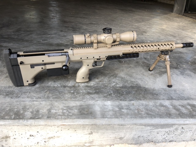

Those are some awesome velocities. what type of barrel life is typical for a 22Creed?Just put a few rounds through my SRS for the first time. Did a quick run up on powder loads for the 22 Creedmoor to see any signs of pressure. 41.0-43.0 grains of H4350 and 80gr ELDm. 41.0 gave me around 3250fps, 43.0 was 3,440. No flat primers or stiff bolt. Granted it was 100 yards but this thing is really easy to shoot well. ES Tactical 24” with APA Gen3 brake.View attachment 7208932
