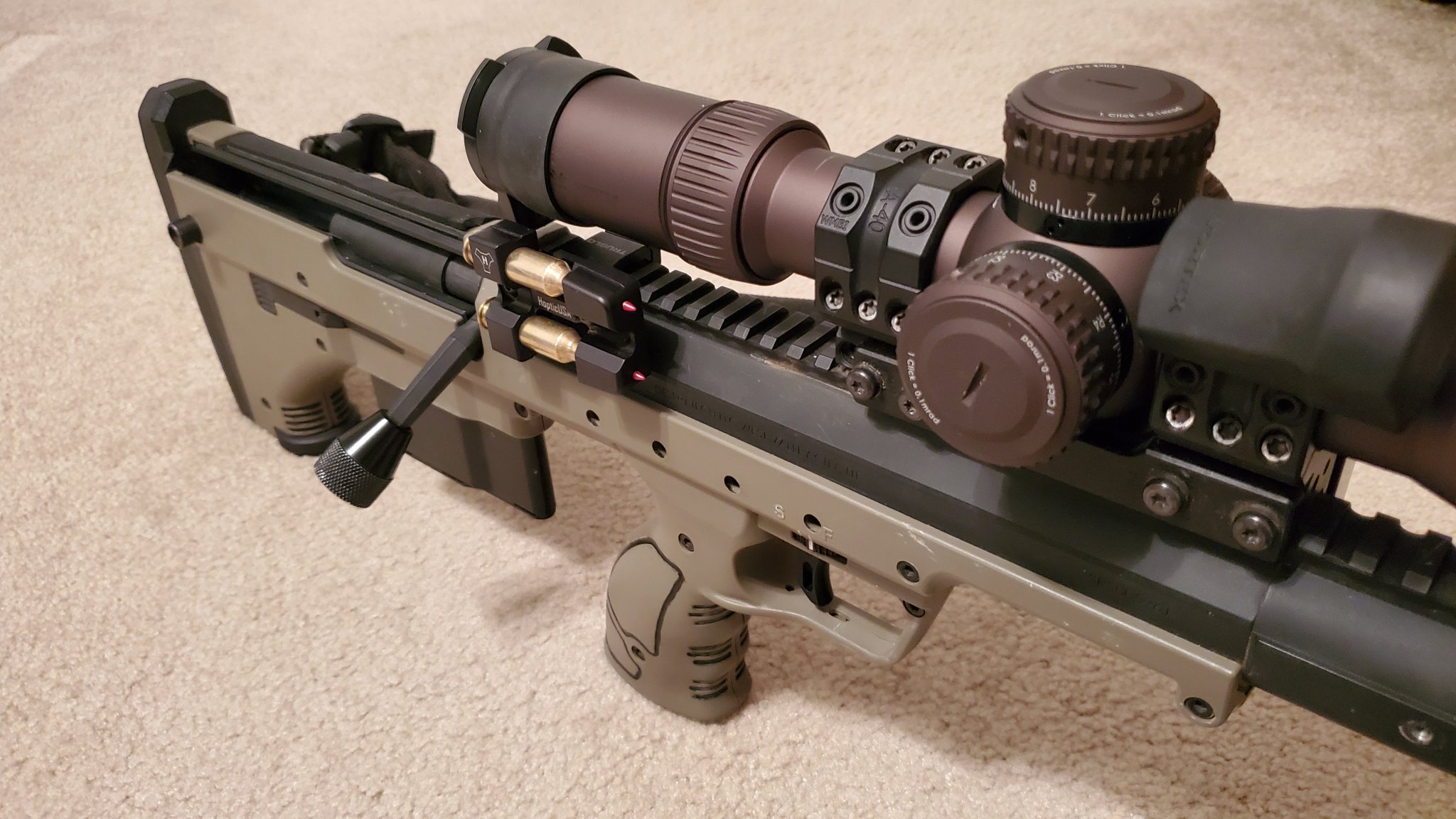

I have a 400 round count 26” barrel I would sell for $800 shipped. The factory barrels shoot really really well. I bought this to use in my covert but then I bought a AI and srs and don’t needn’t it as a backup tool the moment

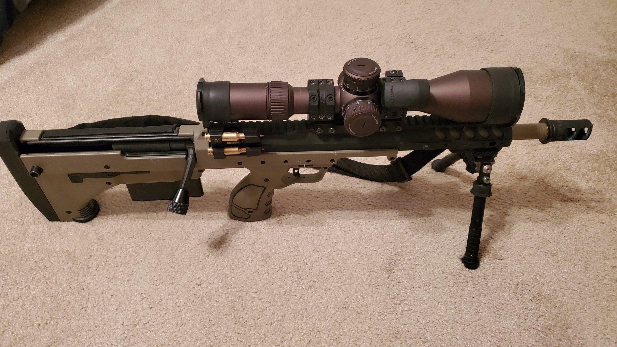

I think i'm going to pull the trigger on a covert hand guard for my SRS A1. I currently have 3 DTA barrels: 338, 6.5CM and 308. I'll probably cut the 26" 6.5CM to 16" rather than searching for a new barrel. I'll keep the 308 as is at 22". I'm contemplating about cutting the 338lm, but i'm not sure i'd be too thrilled on the big boom with that caliber on a short barrel. Folks with an 18" 338lm, how is it?
Also to those who did the hand guard conversion. Do you find yourself ever moving back to the SRS hand guard? Or once you go covert, you never go back?

I was in the same boat. I pulled the trigger and got the kit. Works well with an 18" 6.5 and a 26" 338. It wasn't a quick change, so that keeps me from going back to the longer rail. Unless I'm shooting 338 for an entire week or more, I'll keep the covert rail. I feel more stable with my bipod out further on the longer barrels, but the covert is so nice an compact for the shorter barrels. I rarely go back to the longer rail.
I bought an SRS when there was no covert back in 2010 or so. Got tired of adding extensions to my short barrels and finally got a covert handguard for it. Have never looked back. The long handguard gains you nothing unless you need the length for a rail mounted starlight or thermal. I've been running barrels from 16" to 34" with no issues. I had the 33XC out in South Dakota last year shooting out to 2500yds. I've got a couple 30 in barrels I run in 7.5 Swiss and 338 Lapua and neither of them have any problems with the short handguard. The gun balances well on the bipod and doesn't tip despite the long barrels with suppressors mounted on them.
