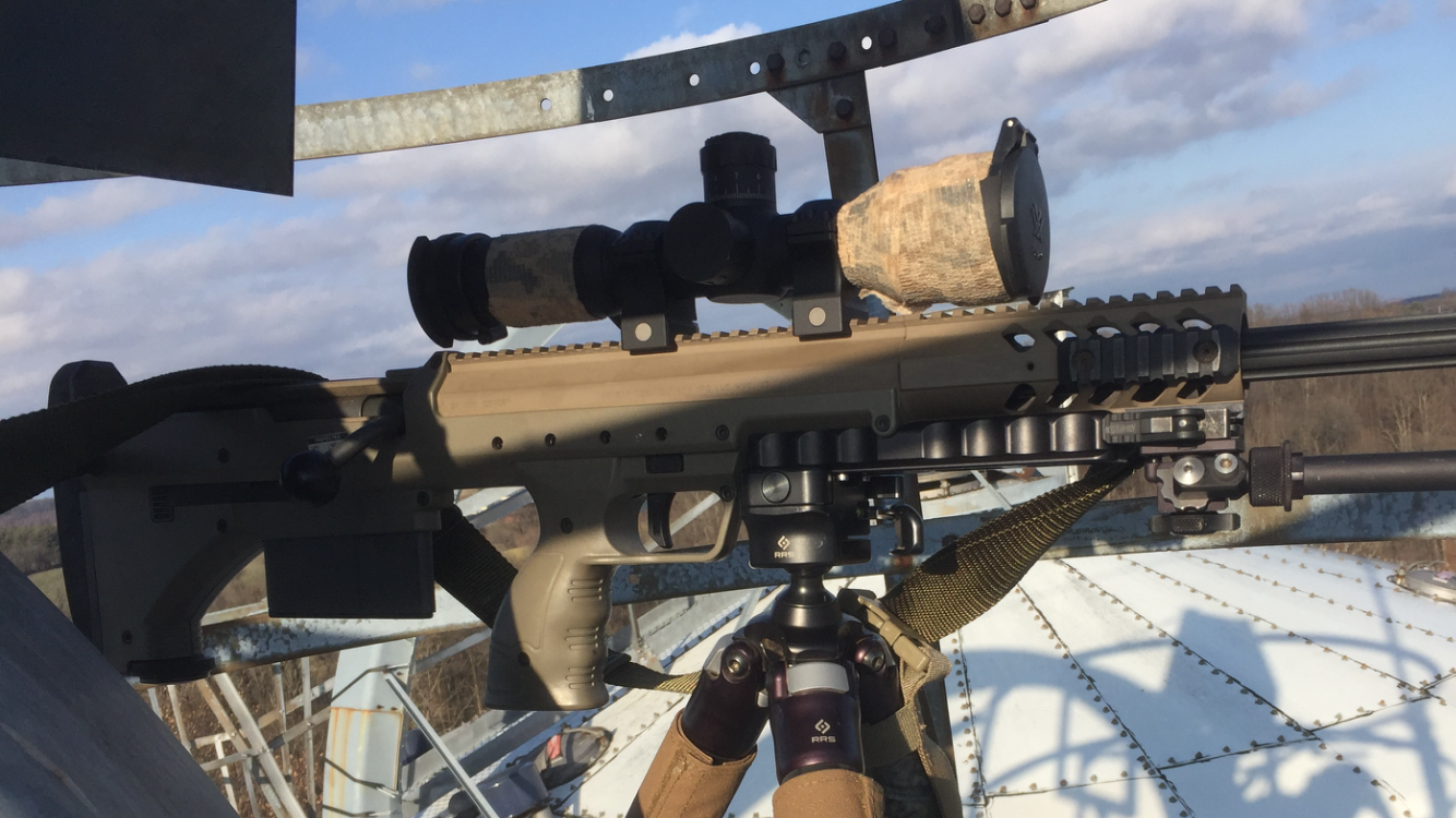

Finally got my 223 barrel back from my Smith and took it out for the day .
Such an awesome Calibre for the SRS virtually no recoil , can't wait to develop some loads for it .
big thanks to SAC for the parts ,
Had the barrel made locally in Aus .
24" Lothar stainless fluted 1:8 throated long for 80's .
0.89" at the muzzle slightly heavier than the factory profile . Showing heaps of promise already
Looks fun! What is the height of your scope mount and does your scope have a 56mm objective? I want to get my scope down low like that.
Reactions: M77
It's a spuhr 4802 - 1.44" I believe .
44 moa /13mil
You can kiss running a front cap goodbye though. Kind wish I had 1.5"
SP-4802
13 MIL/44,4 MOA
Height: 38 mm/1.5”
Length: 121 mm/4.76”
Weight: 254 g/9.0 oz
I have the same mount for my TT525P and I noticed I have the cheekpiece at the lowest setting and sometimes still press my face against it.
Not sure wtf I was thinking it's been 5 years since I bought it and looked at the specs again
Apparantly it's been good enough to last 5 years ;) ?
I checked and with my TT525P in their integrated Tenebraex cap system the caps fit but there is minimal clearance between the rail and cap. Just enough to float over it though.
If you need the older Tenebraex system it might be a tough fit.
Reactions: M77
Yes, ran the 1.375" 30mm NF unimount for a short while with a March 3-24x. The mount was fine; I thought it might be too low but it wasn't.
That's good news. With the march is that a 52mm objective? How much clearance roughly would you say there is between the forearm and the objective? 3/16" maybe 1/4"
I like a pretty high comb for my cheek weld compared to most people so I am trying to stay fairly low
