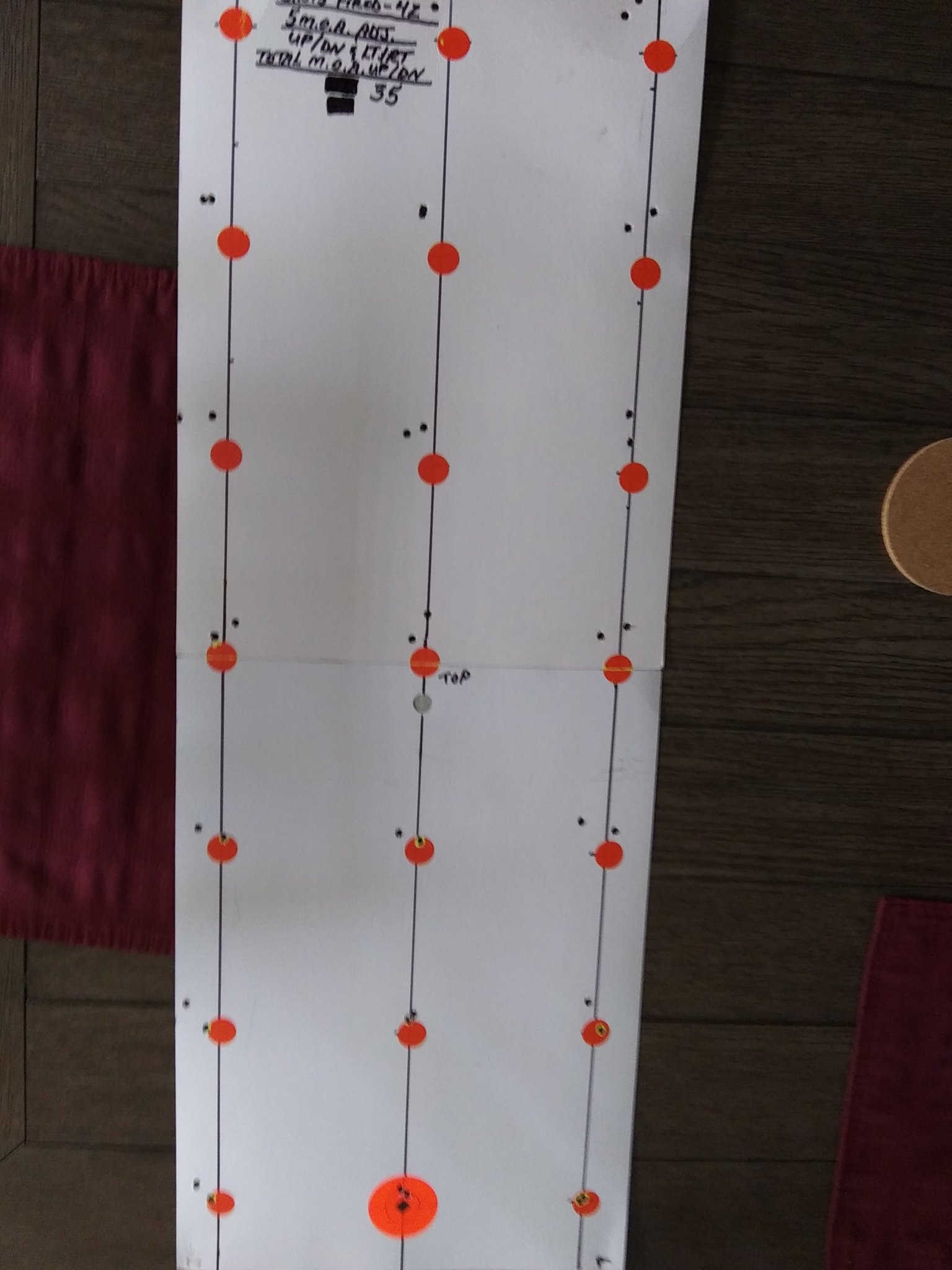

    UPDATE #4......Old thread, but maybe this update will give those that are considering a Vortex optic, this might answer the tracking questions.
    Got a few projects completed on the homefront, so, I figured I'd fine tune my rifle/scope combo. Did a box/tracking test at 100yds. Made up a target, using 5 moa spacing for a total of 35 moa (up/down) and 10 moa, in total for right/left. Didn't re-zero from last time, but, I used older/different .223 ammo, instead of my usual 5.56mm TMK's, which shot higher (1.5"). Shot a total of 42 rnds. (2 per poi). See photo below and I know, I can't write worth a crap anymore. Thought scope tracked well, considering I had full value wind gusts up to 15 mph. A couple of shots, were touching, soooo....I think the scope did quite well and works as advertised.
