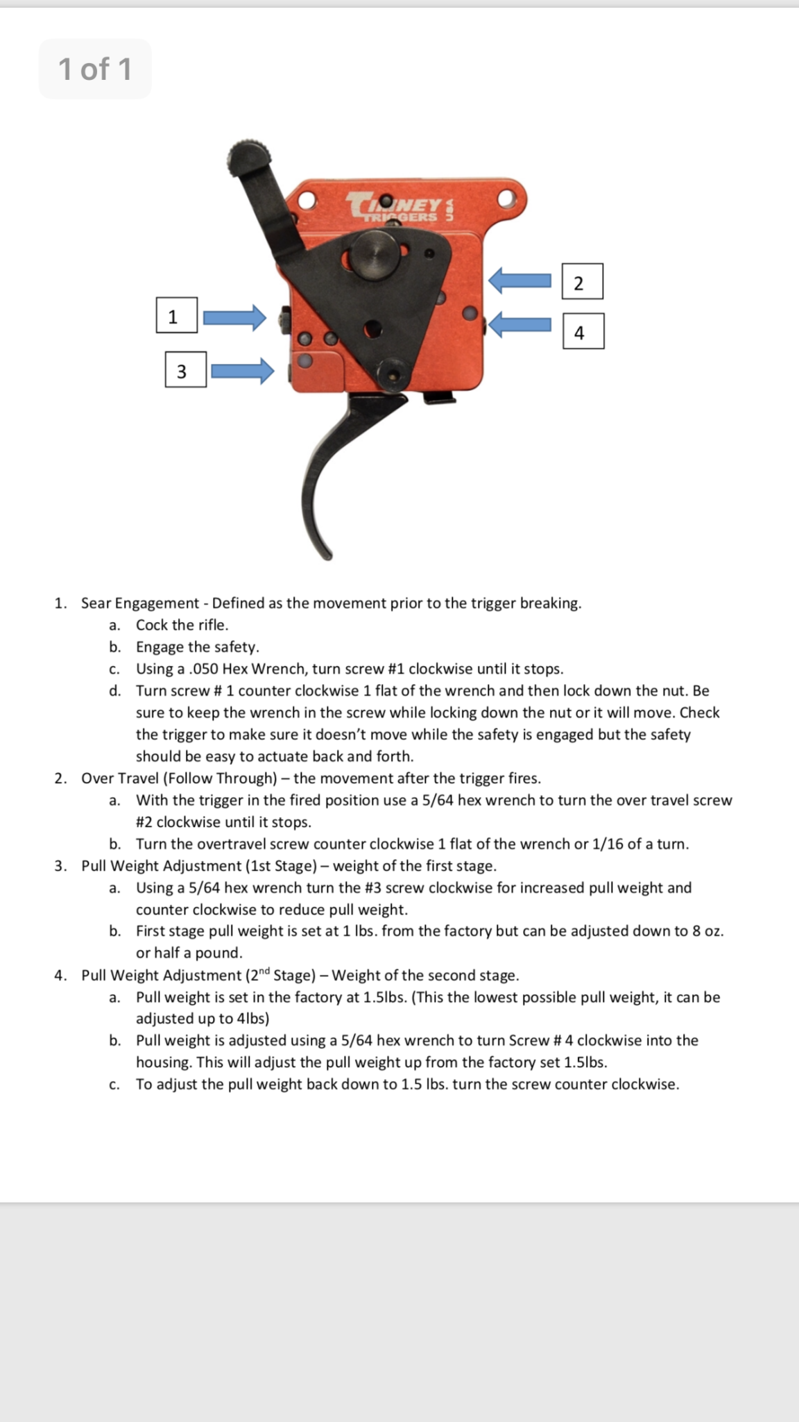

Timney Calvin elite two stage didn’t work on my Origin. The sear in the trigger disengages but firing pin doesn’t fall, it just moves a tiny bit along with an audible click. (I think I’m describing this accurately). I tried adjusting it a bit to see if I could get her to go but no dice. The single stage Calvin Elite works flawlessly, I ran 60 rds with it set at 8oz this weekend. Dialed it back up to 1lb tonight.

my Timney CE did the same thing at first. had me frustrated as hell. i had to adjust the the over travel and now it works perfectly.
Reactions: Rover31 and ZEROGUY
I tried adjusting the two screws on the front with no luck. I believe the top front is over travel and the bottom front is pull weight?
I did not try the rear screw with the green glue on it, is this the one you played with? I wasn't going to touch that one until I heard back from Timney, but if it worked for you I may give it another go.
no i did not touch the one with the glue. that's the sear engagement
But yeah the top front screw is the overtravel.

Timney Calvin elite two stage didn’t work on my Origin. .
If you want, send us the bolt and we'll modify the cocking piece to make the CE 2 Stage work. From what it sounds like, there's too much engagement between the cocking piece and the trigger sear.

Got a response from Timney:
“Zeroguy, it sounds like the overtravel is in to far, it’s the top screw on the front, turn it counterclockwise about ¼ inch”
I’ll try and carve out some time tonight to try it out. If that doesn’t work I’ll send zermatt my bolt after this month’s match.
I am about to order an Origin myself and I am wondering about the Trigger Techs. Are they adjustable for sear engagement and overtravel in case the one I get needs some adjustment?
actually, I did adjust the sear adjustment
That'll do it! It's not a problem as long as you haven't had any issues where the firing pin falls without pulling the trigger. As long as it's safe, there's enough firing pin fall there for reliable ignition. And the bolt lift/close probably feels better now than it did.

This didn’t work. These instructions don’t even make sense.
I’ll be sending my bolt to Zermatt later this month.
