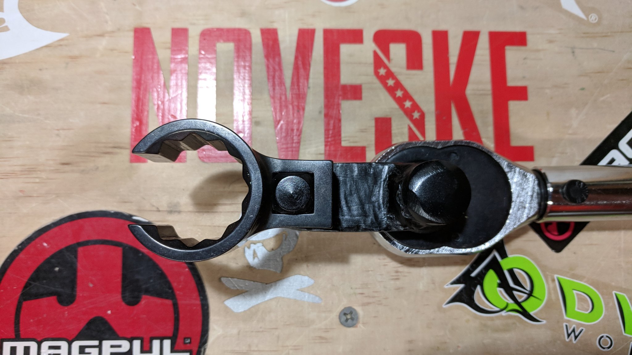

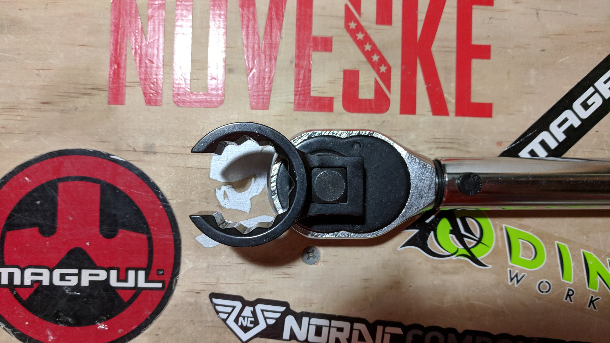

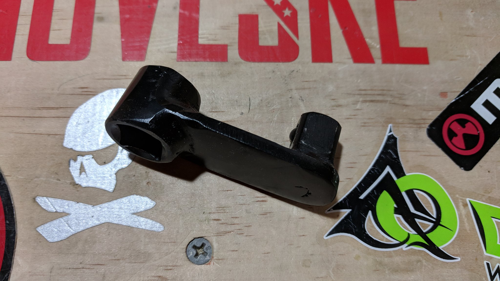

Has anyone used one of these for the 12 point barrel nut? Yay or Nay?
https://aboloxtools.com/williams-scfxx-1-2-drive-crowfoot-wrench-flare-nut-12-point-sae
I did use that crowfoot wrench with the Bighorn 12 point barrel nut with a couple issues. The torque wrench will interfere with barrel with the short offset. I solved this by making a "offset extension" from a 1/2" extension. Welded the male and female ends of the extension to a short piece of 1"x1/8" flat iron. It worked excellent for me, I think a 1/2" universal joint would work as well but I wanted something rigid. Obviously the torque will be increased if the extension is inline with the wrench or basically unchanged if it is perpendicular to the wrench. Hopefully this helps!
Thanks for the advice. I ended up ordering the flare nut socket already. Now I just have to decide if I want to buy the torque adapter or machine an offset extension for the socket.

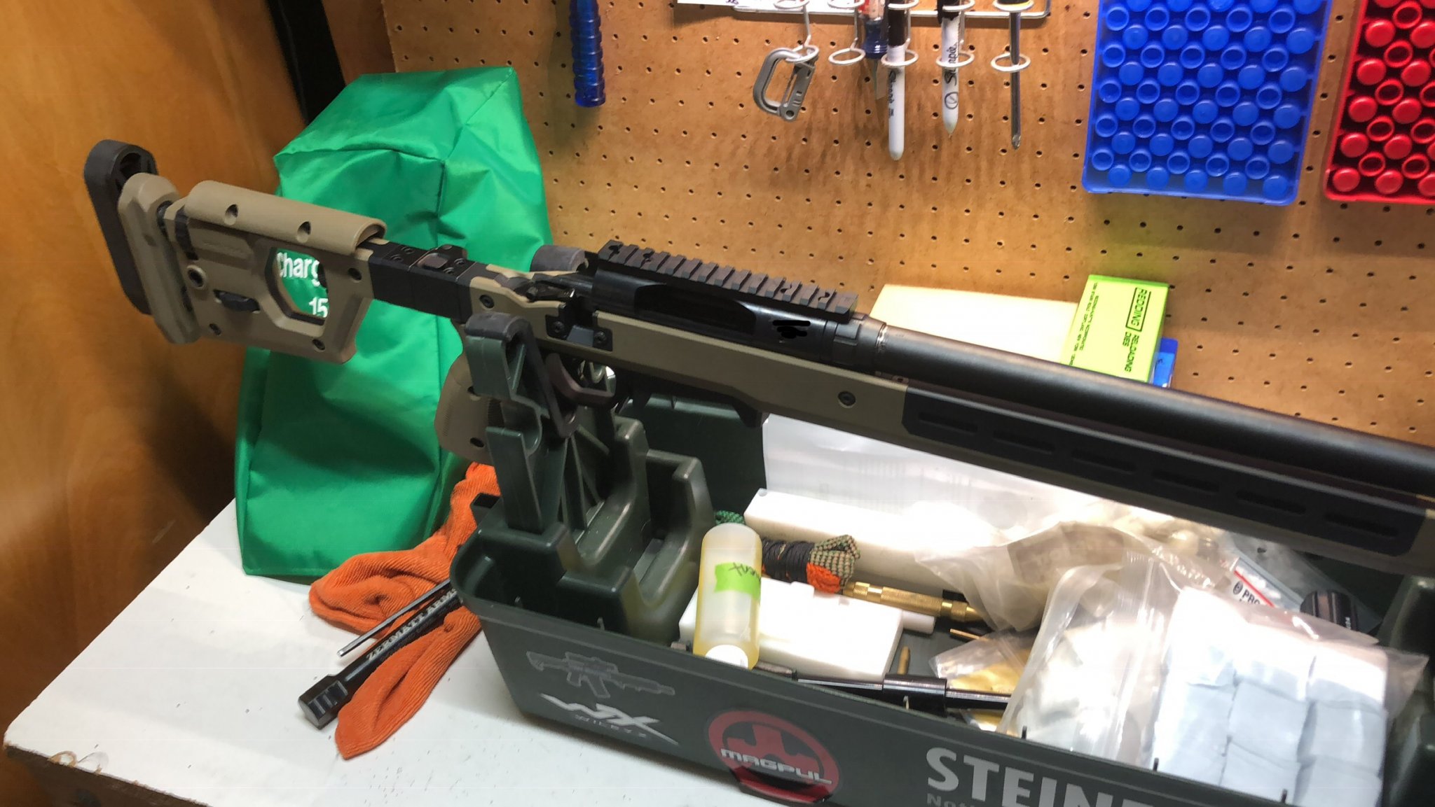

I got the rifle assembled with my 26" .308 CBI bbl for the range this weekend. Rifle will look pretty much like this when complete with PVA bbl except it will have a brake and shouldered bbl.

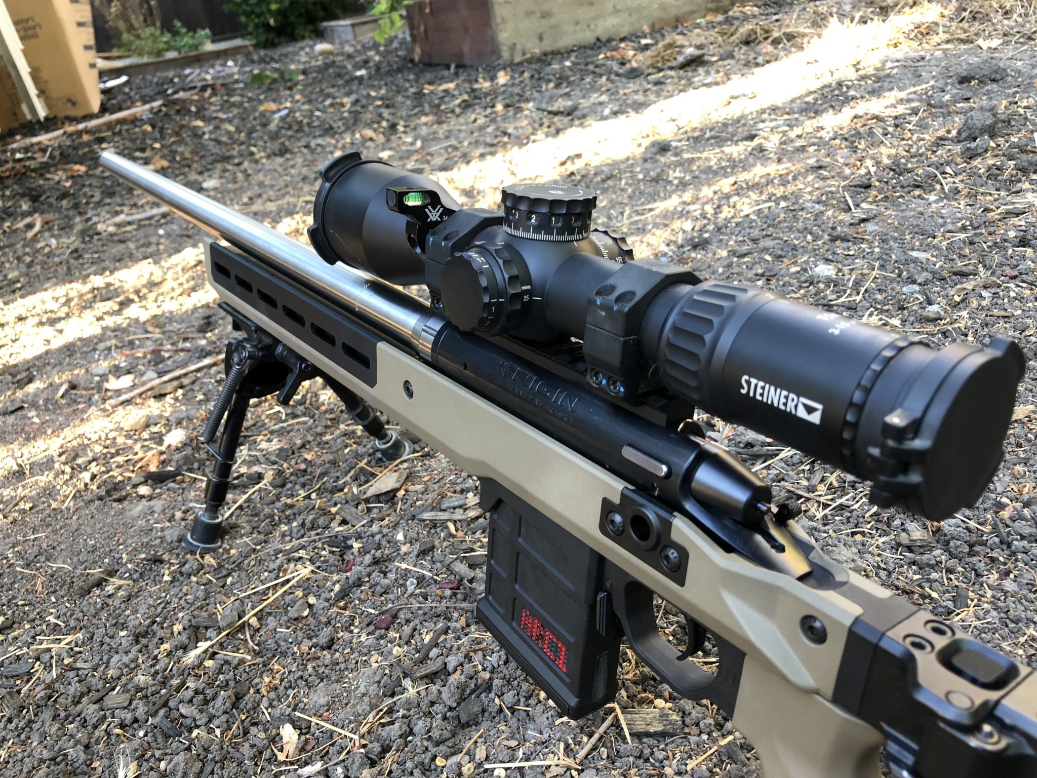

Did Keystone need your action? Let us know what barrel your using and how it shoots. Looks sweet
They didn't NEED it per se, but since it was already coming from the manufacturer and I don't have a vice/action wrench yet (have to spread out these purchases a little), I had ZAI ship it straight to Keystone who torqued on a shouldered, threaded button (not his Kreiger's) barrel. He didn't charge anything extra for this and like I wrote previously, he turned it around in 24 hours. I tell you, between ZAI hitting the mark on delivery and the great experience with Keystone, I am very pleased so far.
