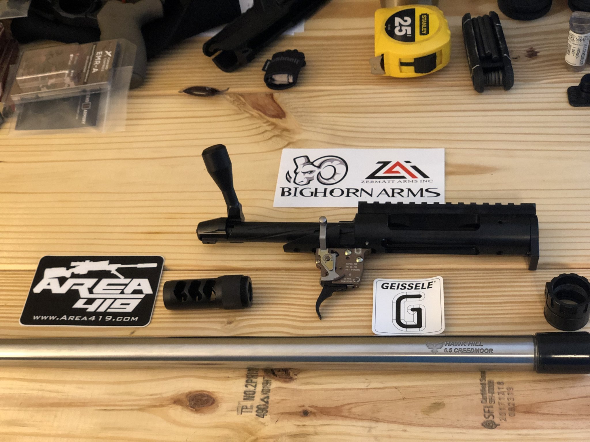

Here’s my Origin. Took only 30 minutes to assemble thanks to awesome components. Don’t seem to have an issue with the Geissele trigger.
Bighorn Origin action
Geissele R700 trigger
Hawk Hill 6.5 CM Savage Prefit
Area419 Hellfire Brake
ARC Barloc barrel nut

When I had my super 700. It had a slight cock on close. I am waiting for my replacement. Back from geissele. When did you get your trigger?
I received one of the first shipments. Customer service is being slow on sending the shipping label.
I maybe be wrong, but I believe the Origin is a 50/50 cocking action and not 105/-5. So it’s suppose to cock on opening and closing. Yes you can trim it to make the bolt lighter when closing but it will also lighten the fire pin stike as well.

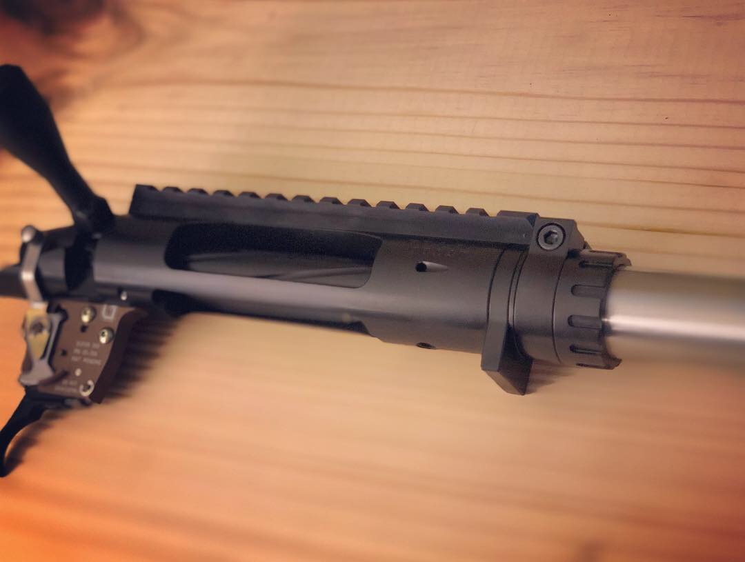

Had my Origin at the range today for the second time. Got another 50 rounds through it. I can say the bolt work (open/close) is smoother than it was when I first assembled everything (after having sent it in to get it to function with my trigger). My friend was there with his rig built on a Defiance Deviant and I compared bolt operation of the two. His Defiance was just a little bit smoother opening and closing, but the Origin is still very nice and I'm very happy with it at this point. Not sure if I'll have it timed or not because it is nice as is and you know the old saying about if it ain't broke.
My build is as follows:
Bighorn Origin
Manners T4A (bought used with a bottom metal, not sure which flavor)
Criterion Savage Prefit, MTU contour, 26" in 6.5 Creedmoor
Triggertech Diamond Elite
So far I've been burning up some Hornady American Gunner I already had to get it sighted and broken in. Shot a few groups today at 100 that were right around MOA. Shot two five round groups at 600 today, one right at MOA, one well under (was about 4-4.5").
Again, after a bit of a rocky start, I'm very happy with my Bighorn Origin.

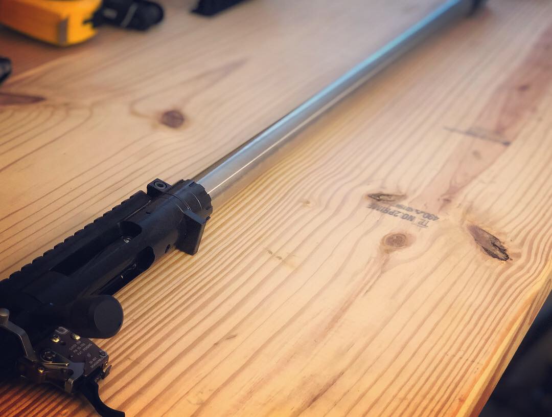

How do you like the barloc barrel nut?
I'm waiting on the chassis to arrive before I can shoot the rifle but I dont expect any problems there. The Barloc barrel nut made assembly a breeze without any special tools. The big advantage it has over a standard barrel nut is that it allows you to torque/load the threads without effecting the headspacing. A common issue when torquing a standard barrel nut configuration.
If you have a barrel vise and action wrench then I believe shouldered prefits it the best route to going. This will give you better RTZ results if switching barrels.
