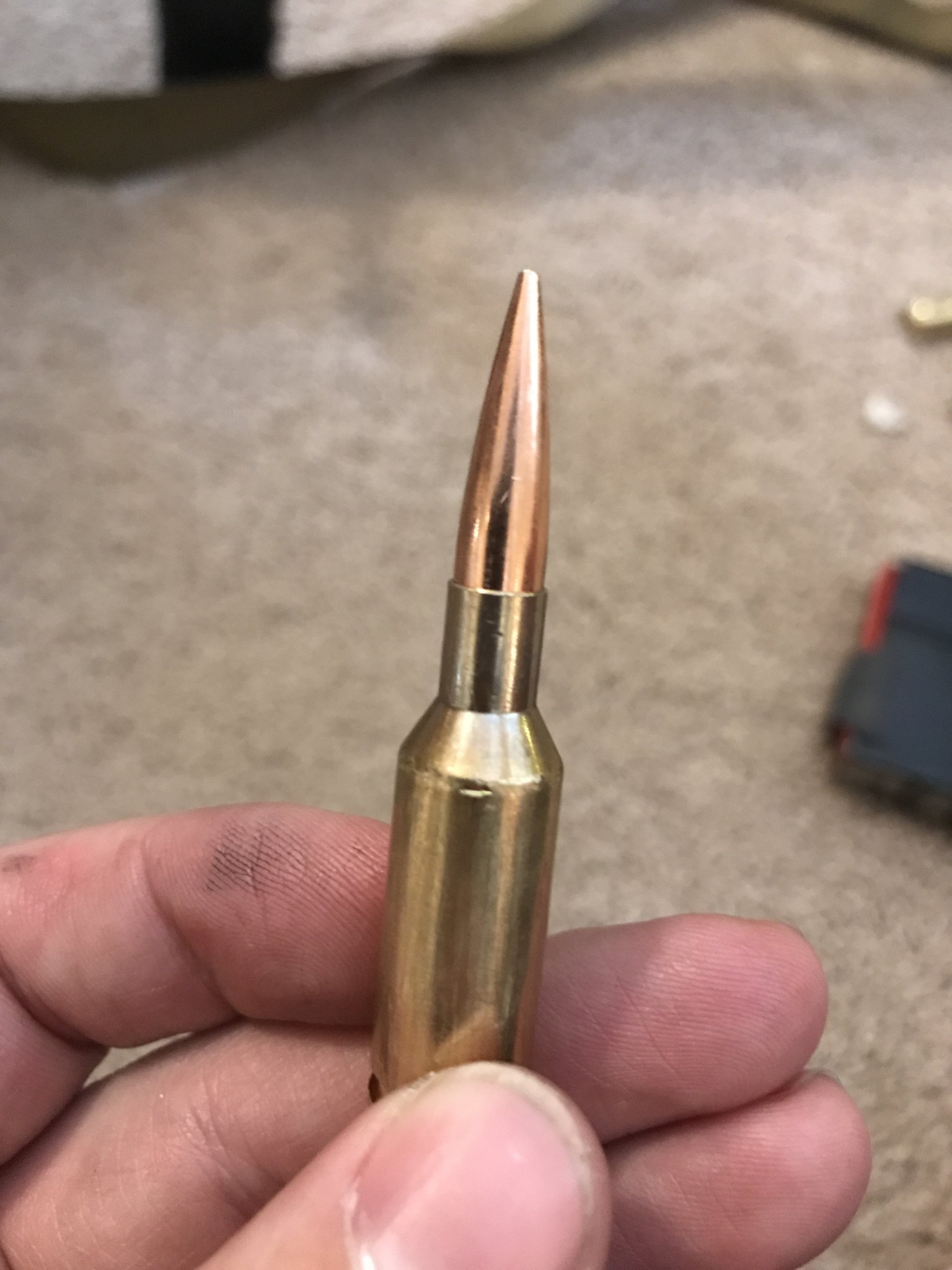

Has anyone had any problems with the 6br in the origin. I’m messing around with mine and some dummy rounds and in is catching the shoulder of the round in the mag and hanging up th bolt. I think it is catching on the pin hole that holds the pin that holds in the bolt head. Any suggestions? It’s really aggravating.
Origin action in an xlr envy chassis out of arc 10 round mags.
That looks like an ARC mag in the background with the original follower. I have a friend who runs a TL3 in 6mm Dasher with ARC mags, but he's got a follower specifically for that round.
I run a 6br/origin/XLR Envy combo and three 10 round AICS mags with the TS Customs/Primal rights spacer kit. Feeds perfectly every time.
