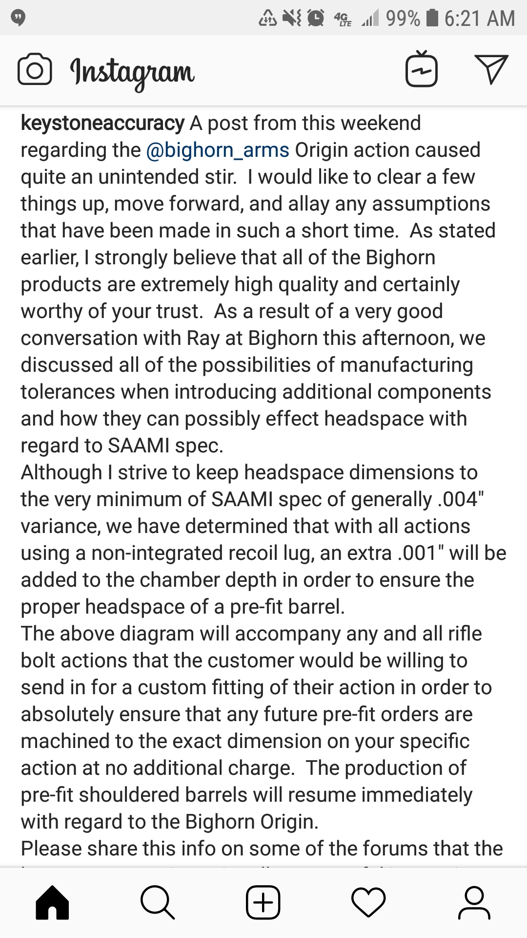

I don't know much about Keystone but the image they posted makes me not want to use them. It seems crazy that a company that makes something for precision shooters would put a picture online with their tools (e.g. no-go gauge) being rusted. Makes me wonder how well they keep their reamers.

I’ve seen you advocating for them previously, being a mod I would assume you have more knowledge then I could ever forget. Would you be able to get some information on the examples that led Keystone to make the announcement?
If you've followed me here on the Hide you know by now I dont rep for or get paid by anyone. Many companies send me products to test and appreciate my no bs honest reviews. Keystone has been coming through with excellent prices, super fast turn around times and the accuracy I expect from a precision rifle gunsmith. All of my Keystone button and cut rifled barrels shoot tiny little groups with little to.no effort load development so yes I will speak highly of a product I can stand behind.
I dont have an Origin, but from what I was told they took measurements off the first Origin they had in house and made a shouldered barrel for it and recorded those measurements just like they have for the TL3 and Curtis, etc..
They then took a few orders for Origin prefit barrels without the customers action just like they do all the time for TL3's and shipped the barrels. Customers complained the barrels didnt headspace correctly. This hasnt been the case ever for their TL3 prefits and I have or had at least 8 or more... that's the extent of what I know
I spoke with John at Keystone today to learn what he had seen and clarify any miss steps that may have happened on either side. Here's what we discussed:
We talked about the demand customers have to keep chambers on the tightest possible side of SAAMI specs and the difficulties that presents when producing pre-fit, shouldered barrels. The difficulty lies in the fact that we (Bighorn) have to provide a perfect product to the consumer AND they (barrel providers) have to assume a perfect product to cut a "zero tolerance" chamber. Perfection is obviously something we all strive for when delivering a product of any kind to the final consumer. If either side misses a dimension that still lies within their tolerance call out, the total stack between the two pieces have the potential to be thrown out of the final (in this case, head space gauge) dimensional tolerance range.
The TL3, along with other integral recoil lug receivers, is much easier to mate a barrel with a "zero tolerance" chamber without measuring the receiver and push the limits of SAAMI because it's only one piece that has a sub .001" tolerance range. The Origin, along with other non integral recoil lug receivers, is much more difficult to make the same thing happen without measuring the receiver.
Now, like I stated earlier and from the beginning, the Origin in NO way is an inferior product with regard to dimensional tolerance or quality control to the TL3 or SR3. What is different is the non-integrated recoil lug on the Origin. In the design and production process, Aaron and I (Ray) actually had a disagreement on how we should control the thickness of the recoil lug on the Origin. I wanted a slightly larger tolerance to improve the logistics of production but Aaron wanted it to be controlled very tightly to fall in line with the scope of our quality control measures. Ultimately, Aaron won that battle and recoil lugs are controlled dimensionally to .2500" +.0004 and -.0002 per the production print. Anything that doesn't fall within those numbers is not used for our actions. Pair that with the head space control on the receiver body the same way and you can create a total stack of nearly .001". The TL3/SR3 receivers only have the one dimension to control and that makes pre-fit shouldered barrels with the tightest possible chambers within SAAMI specs much easier.
So, within John's practice of keeping his chambers as tight as possible, the Origin creates a higher total tolerance stack (still well withing SAAMI) and makes it much more difficult to achieve. Aaron and I have suggested, and John had agreed with me on the phone, that it makes more sense to allow for an additional .001" when he is measuring his chambers for pre-fit shouldered barrels intended for the Origin. It will eliminate tight head space dimensions that would need to be returned to have chambers set back slightly to conform to the action. John, from my understanding, will require someone wanting the tightest possible chamber on an Origin to send their action in for measurement. But if the customer is willing to accept a barrel with a chamber that is slightly less tight but still within SAAMI's specifications on head space, he will offer the shouldered, pre-fit barrel to them.
Bighorn has advised this to a number of different gunsmiths in the past and that practice is being used by the major companies offering pre-fit, shouldered barrels on both lines of actions we produce. There has not been a notable difference in accuracy between barrels cut the way John cuts them or the way other companies cut them and there's a thread on this very website noting that very thoroughly.
We believe Keystone Accuracy is still a good, viable option for pre-fit, shouldered barrels as long as they continue to offer them. There are no hard feelings or bad blood between the two of us in any way and we are going to do anything we can to keep that as the case.
We'll always stand behind our products as being controlled to the highest level as we manufacture every major component but our firing pins, springs and screws in house. We want our products to be among the top of the list when people ask for recommendations on a custom action. We've seen that we are right there in most conversations between the end users and top level shooters. We believe the stance we have on maintaining the highest levels of quality control and customer service are the reasons we're there. If there is anything we can do to help a customer with an issue or answer questions about or products, we'll do everything we can to make that happen.
Thank you, and have a great day! - Ray
