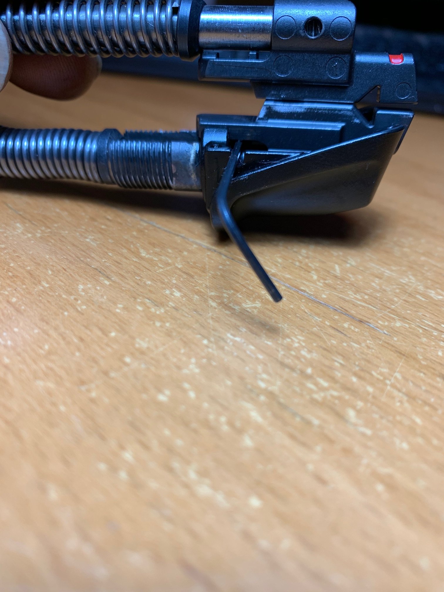

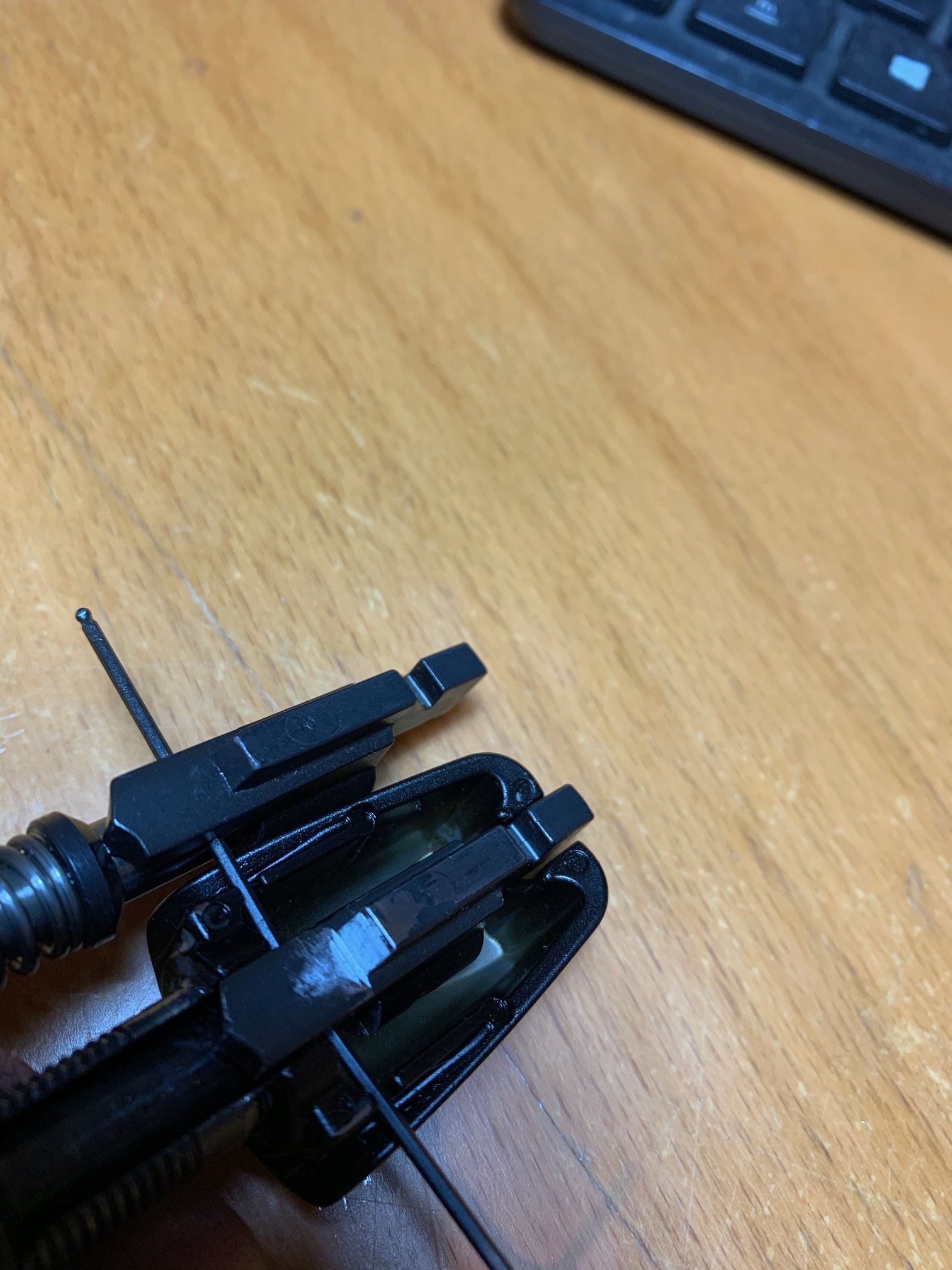

Pics of this "cocking piece trim"? Not picturing it

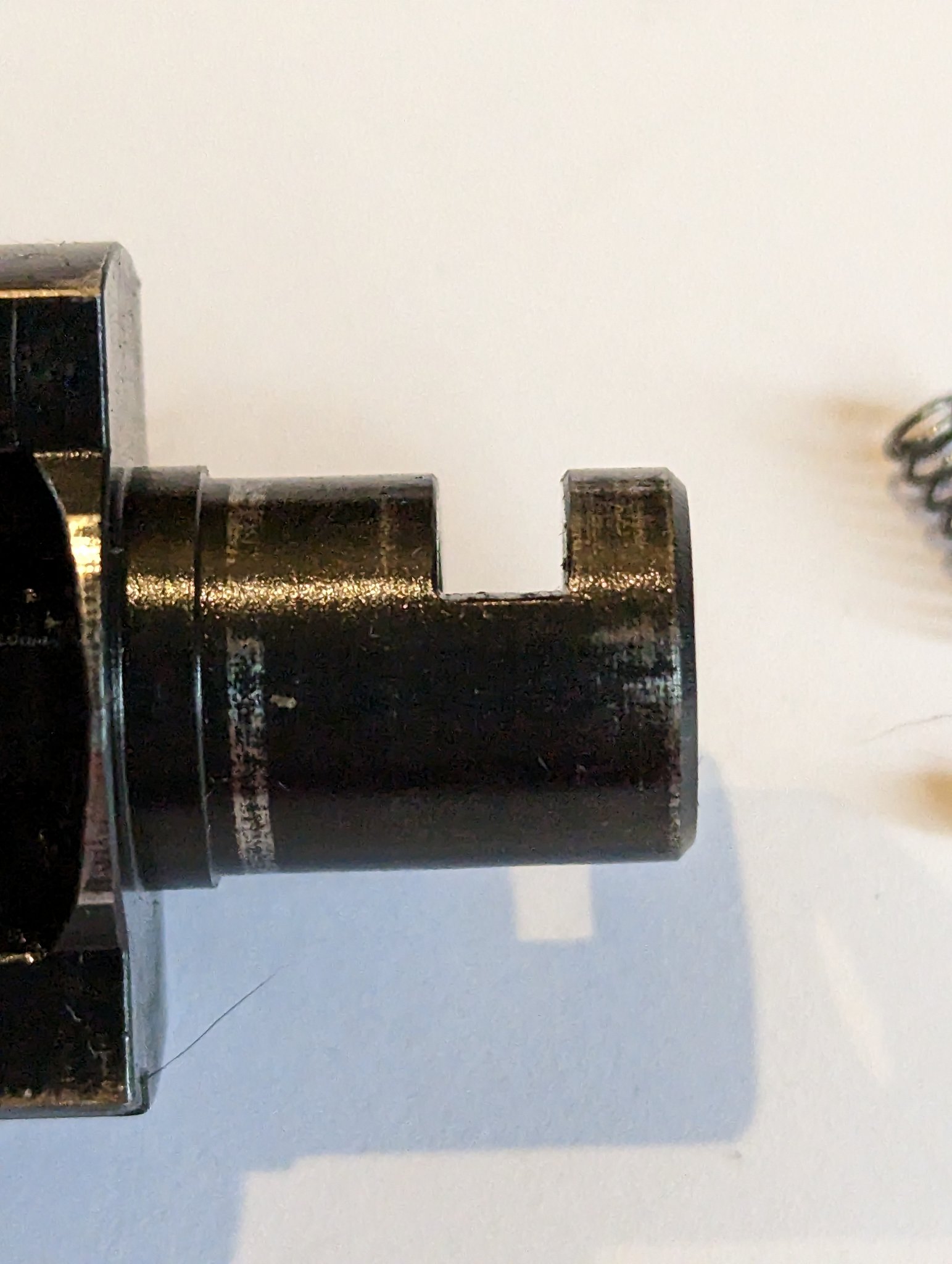

I just happen to have mine in pieces at the moment.
You can see the sear engagement on the shiny part of the piece I milled. Carbide end mill had no issues cutting it.
My Huber had .070 additional cock on close. with the old style cocking piece pictured (unmodified) it put the spring in coil bind and bolt would not close. The new style has 3 less coils on the spring and did not coil bind.
I still wanted to set the Huber for zero additional cock on close & hoped it would smooth the action closing cycle to be less disruptive on barricades etc.

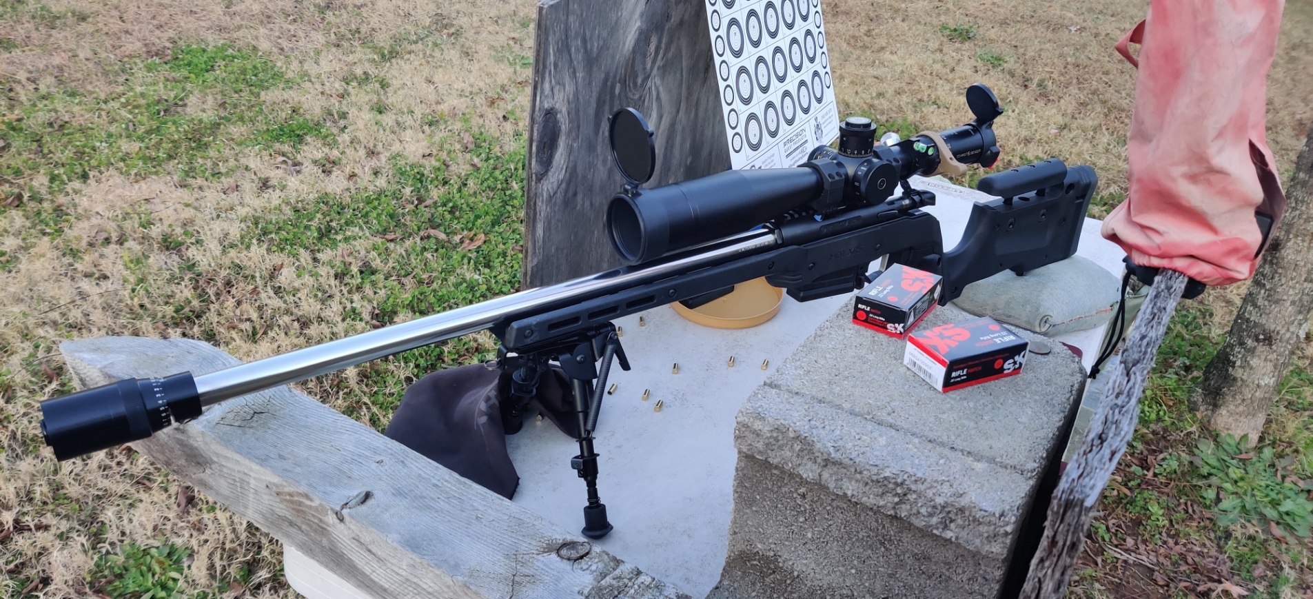

@Kisssofdeath Looking forward to hear your thoughts on the XLR Envy and see some pics :) Thanks for the informative thread brother!

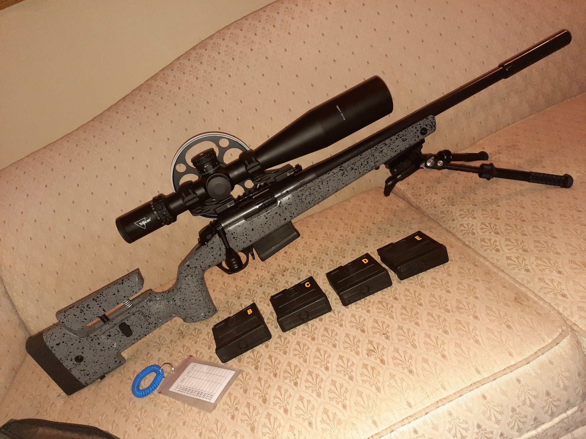

I put the B-14R CF version in the Envy. The Envy is a lot lighter than the factory stock. I'll what happens then probably move it to the PB-14R. I can say now that all the mags I have (6) seat and eject perfect. That's not the case with the MDT XRS, some do and some don't.

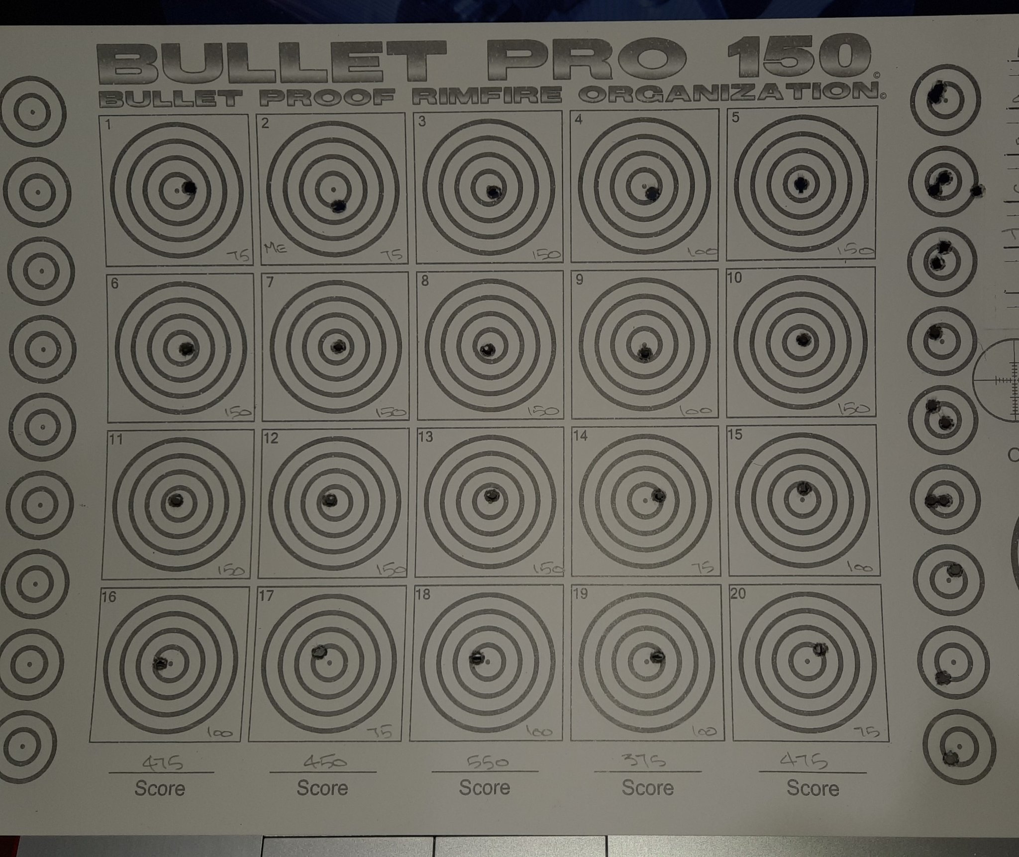

Something like this target see what it scores consistently
I was just introduced to the Bullet Pro 150 target at the LGC, and I really like it. When people use a standard score card, it's very easy to evaluate
how your doing in real time. I don't mean it has to be BP 150 but a standardized ring size seems very desirable. I don't have a shadow graph to view the targets but with dial calipers it looks like the ID of the smallest circle is .38" and it's OD is .50" The maximum possible score is 3000 pts.
One shot per bull allows for a much better read on the wind too. I took one target to my UPS store and had them reproduce them on
.0145" thick card stock. The bullet holes print much better then on regular .0035" note book paper.

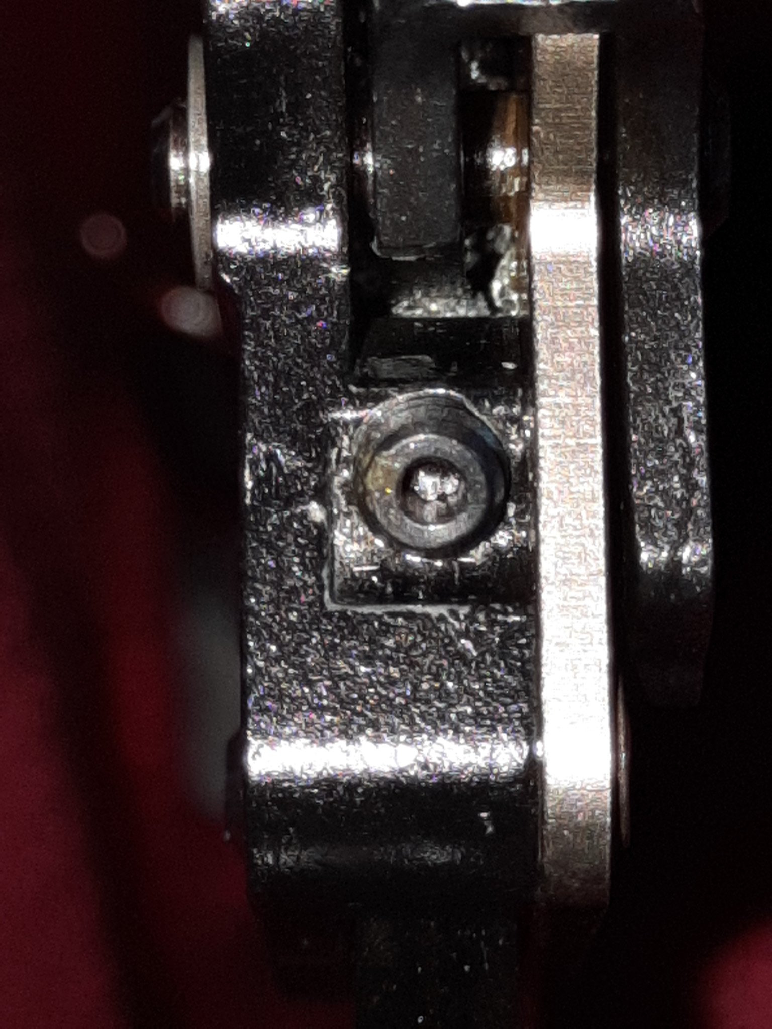

I was however willing to modify my trigger in January of 2022 with a long nose spring plunger and that lowered the weight to 11
ounces and it provided an adjustable sear engagement too. Cost was $20.00 and 20 minutes of time. It's an easy modification with
a drill and tap at home.
You don't even need to take the trigger apart. Just drill, tap and install. The plunger cost $4.56 and is basically a set screw with a
4.5-pound spring loaded nose. It is shown next to the dime in image #5. I got the one with the nylon locking element to prevent
it from moving. It has a #6-32 body ( .138" OD ) and is about .62" long. It is shown installed in the last photo.
I took the opportunity to cover the Vudoo, Lapua and Ivanhoe logo's on the target and add some lines for information that was useful to me.
Stuff like: Gun, scope, wind, temp, ammo, mirage, etc.

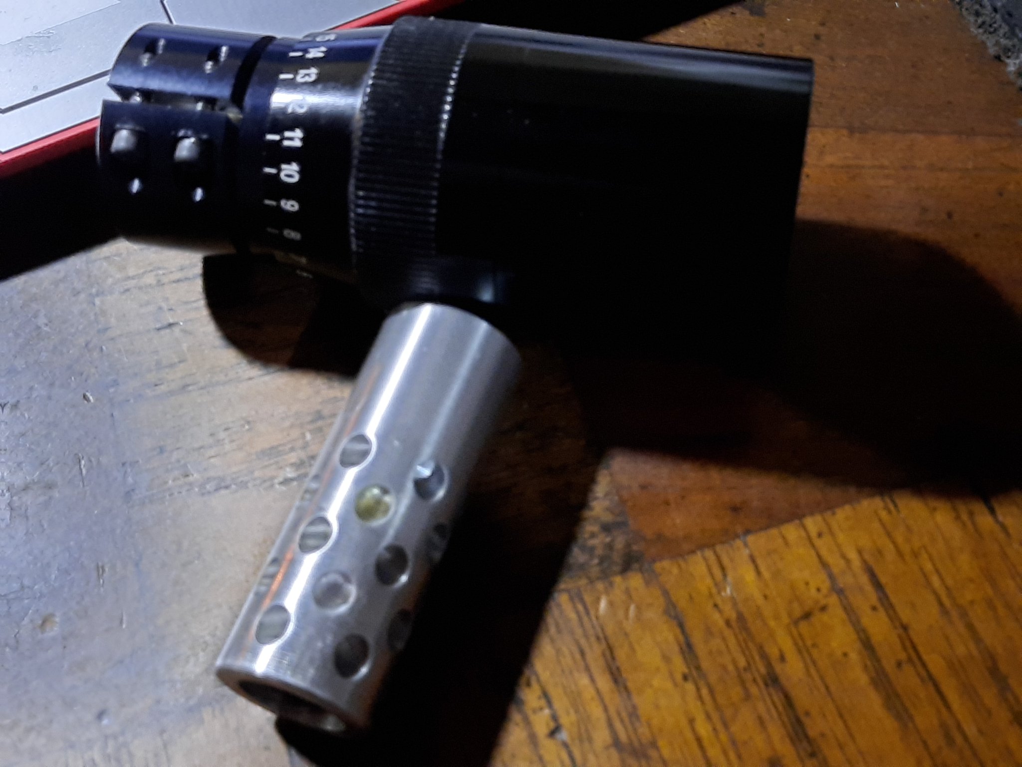

Did you ever get the Penrod sorted out? Can you recommend a high quality plug? Yours looks very clear !!

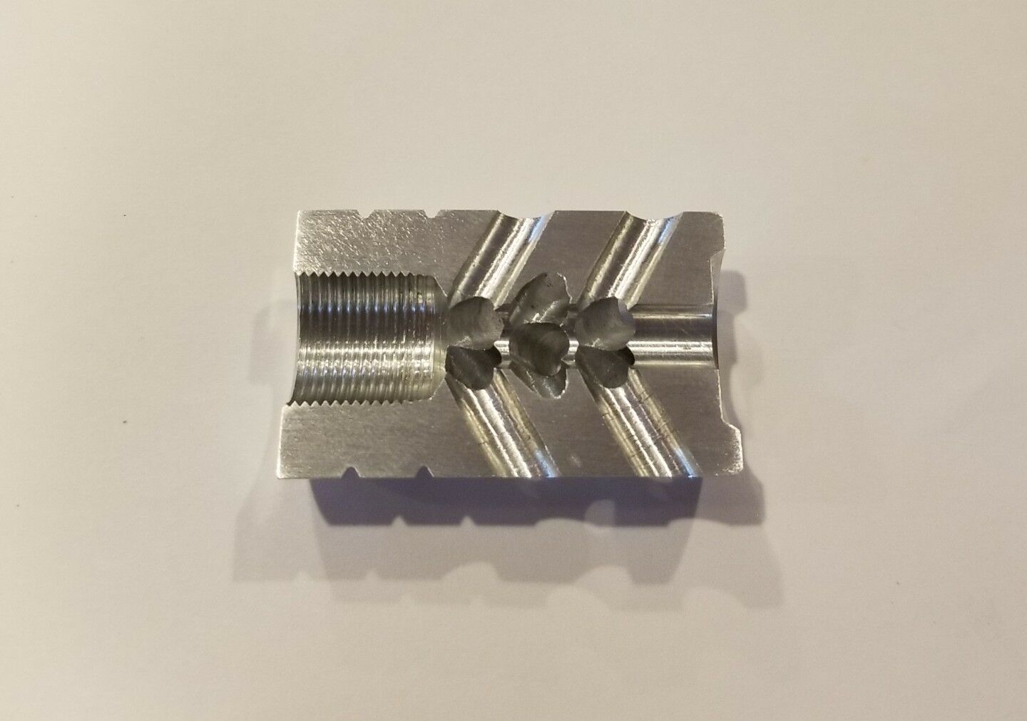

I had my tuner bored to fit my .860" CZ MTR barrel. Then I had a FAUX muzzle brake with blast ports that didn't go through. The allowed me to move my tuner from gun to gun with ease. I just had to keep the tuner DOPE for each gun. On my faux brake the holes were only about 5/16" deep and simply for appearance's sake. If I did it again, I would get the tuner and see how deep Harrel / Ezzel bored the hole. The new adaptor would basically be an inch long thread protector that the tuner could clamp onto.
