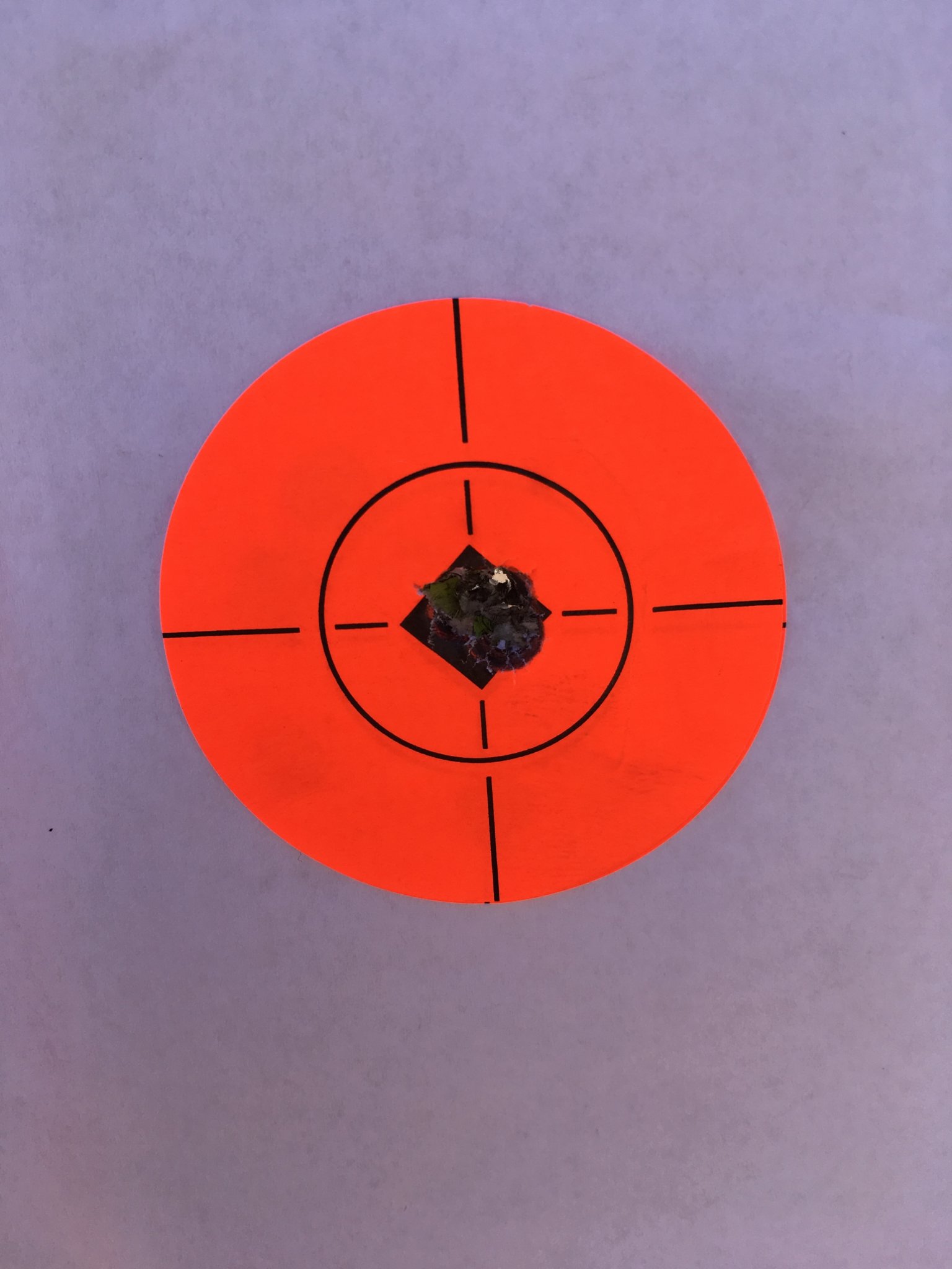

7 Mag from PCR
5 shots during load testing
100 yards
168 Berger VLD on the lands

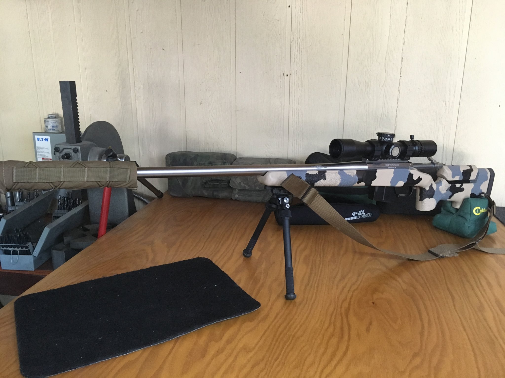

Hornady “Match” ammo had the lowest SD by far.
6fps with the 120s and 12fps with the 140s.
2705 avg and 2850 avg. with a 24” barrel
I’m guna shoot the 140s

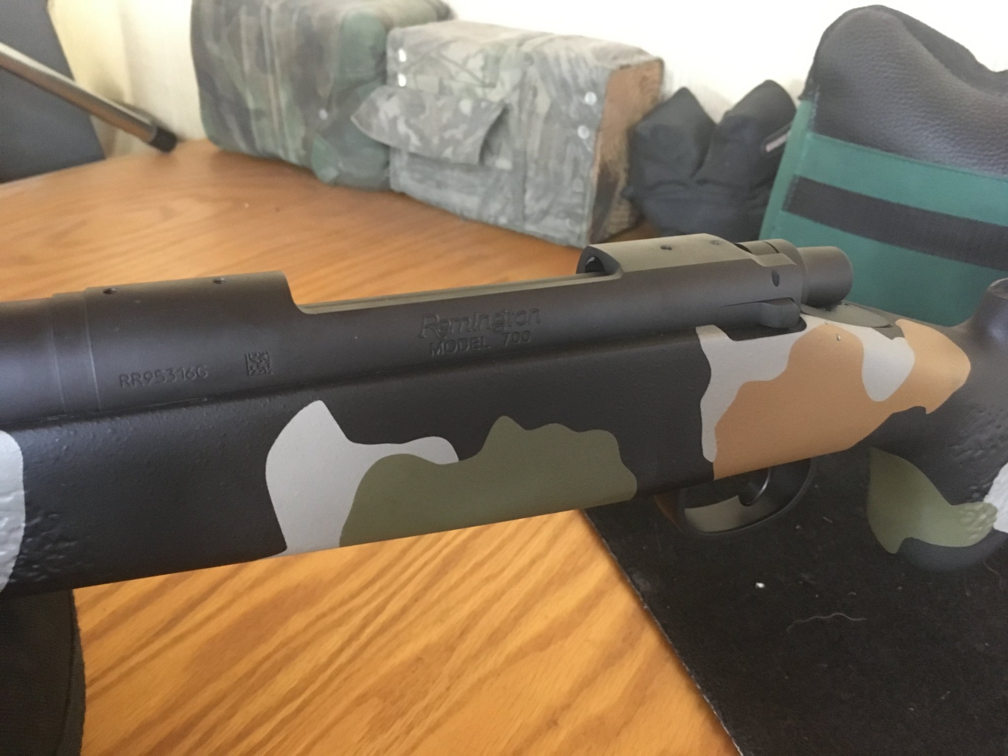

I can't recommend these guys enough. They have done a 6.5 creed and a 28 Nosler and both are outstanding. Accuracy was exceptional and they were a pleasure to deal with. Prompt responses, easy to get a hold of as well. I'll also add that during one of the builds they even talked me through some of the options I'd requested and steered me away from some of the work. This led to a better rifle for what I wanted at the expense of money in their pocket. Says a lot about what kinds of guys they are.

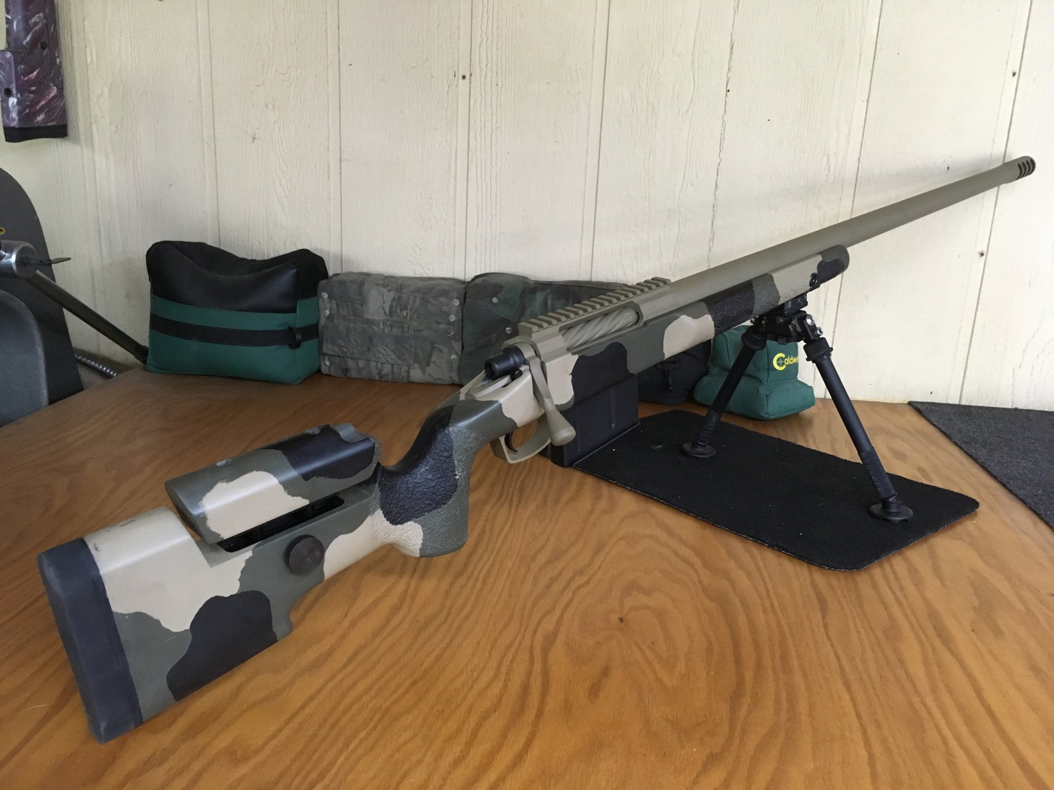

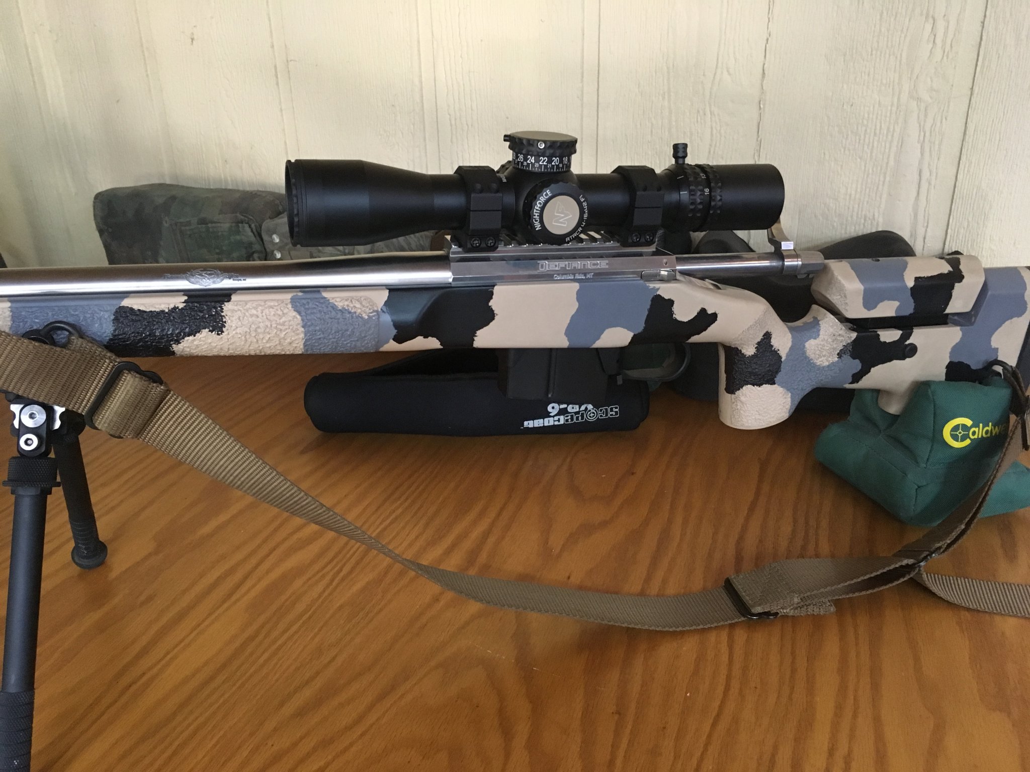

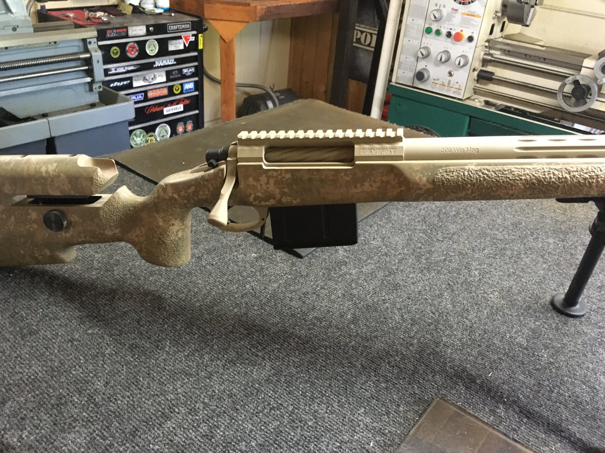

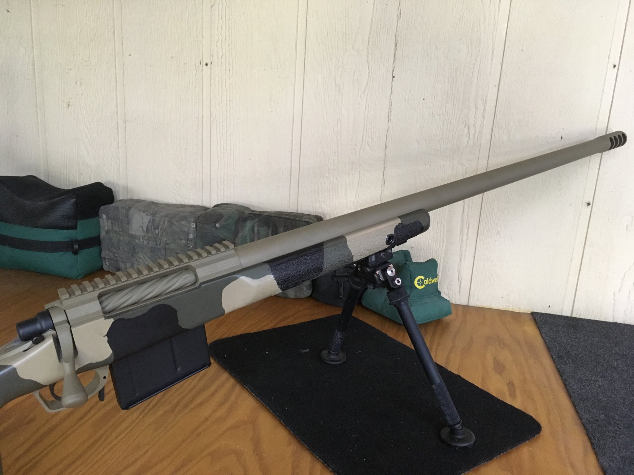

Super sweet 338 Lapua

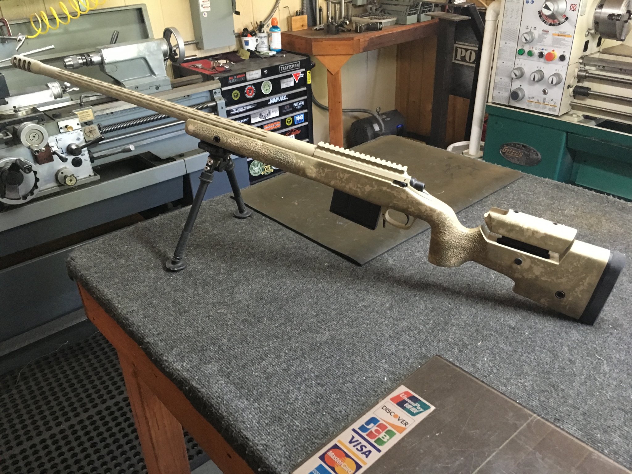

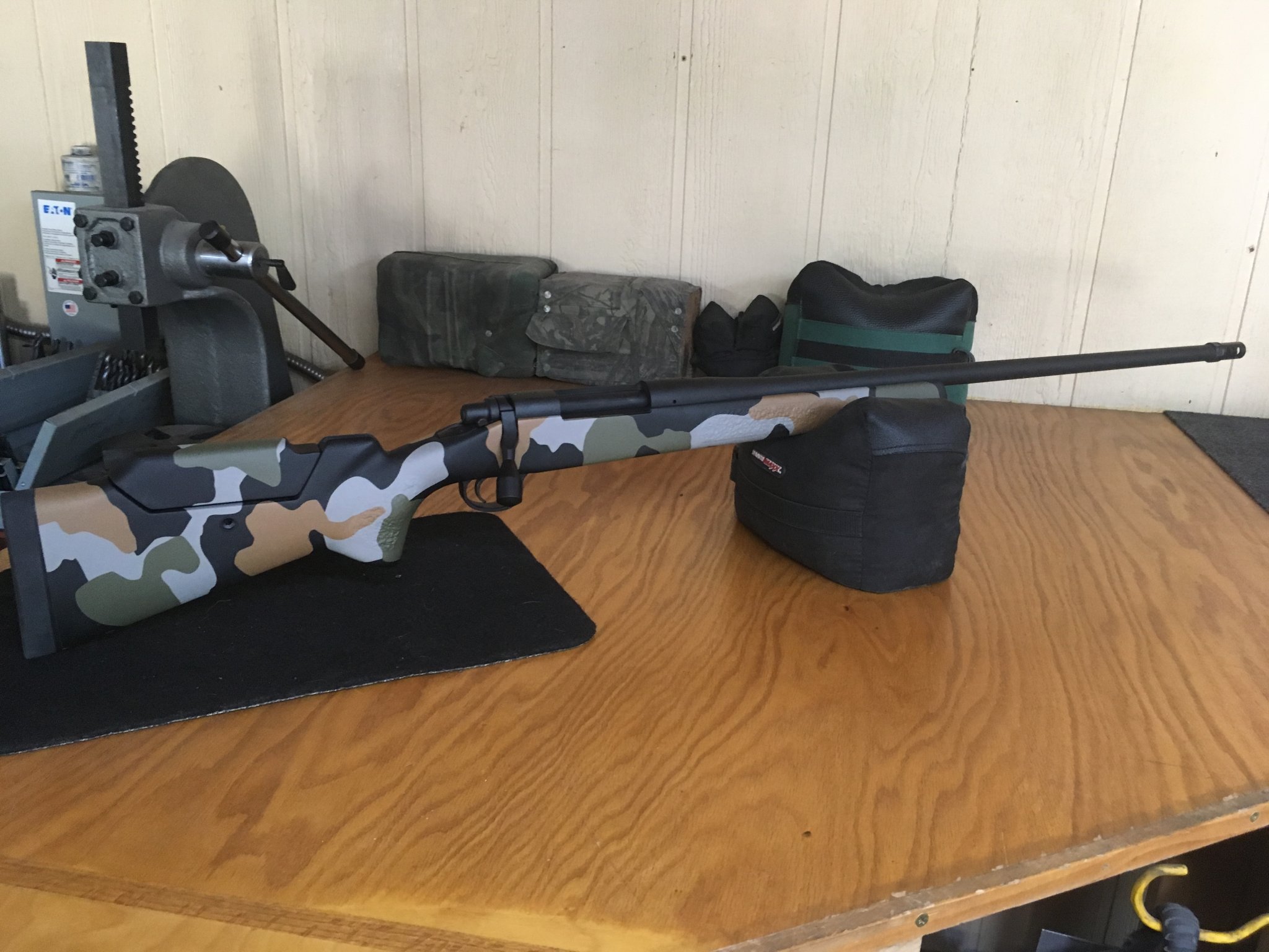

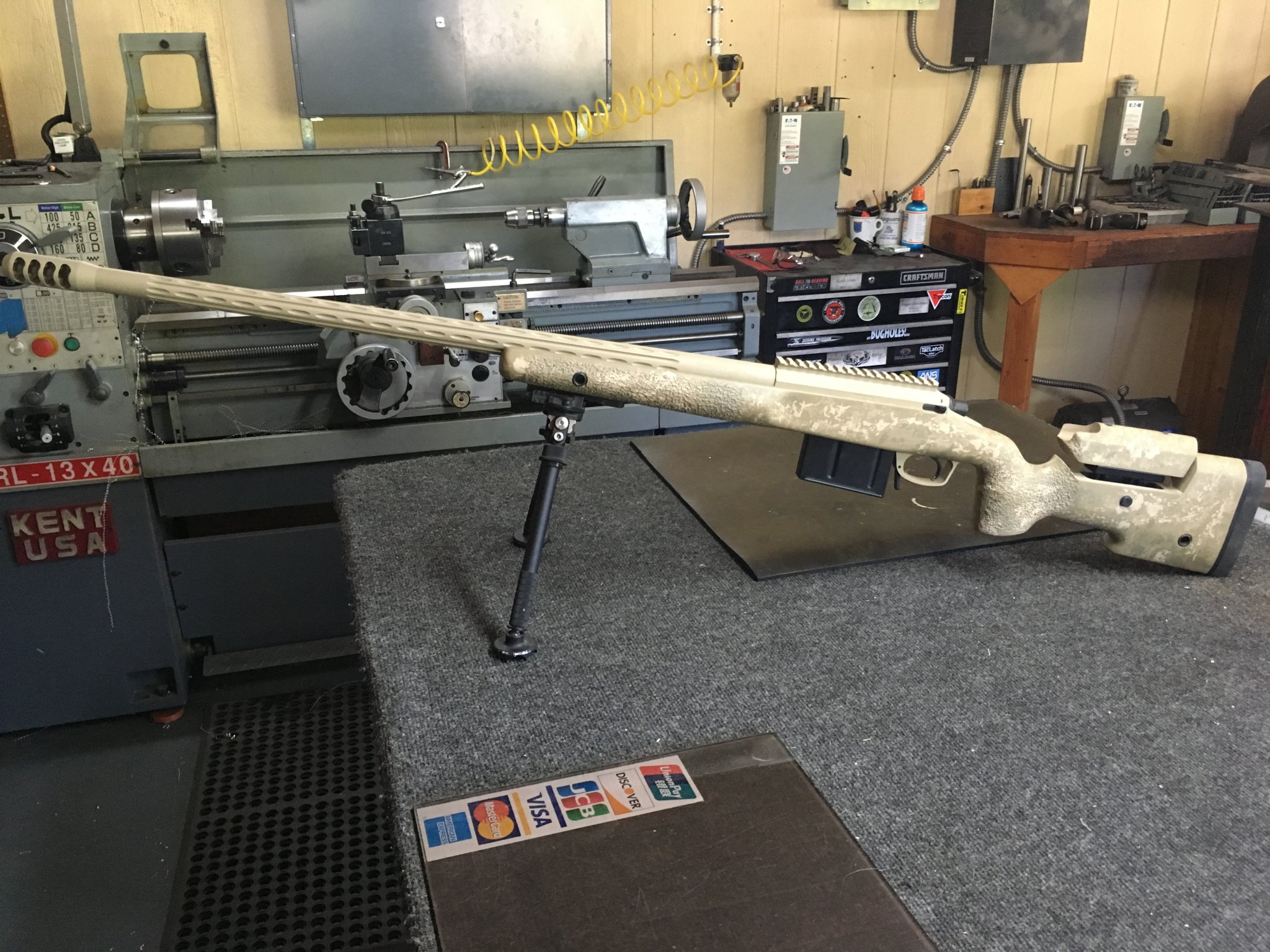

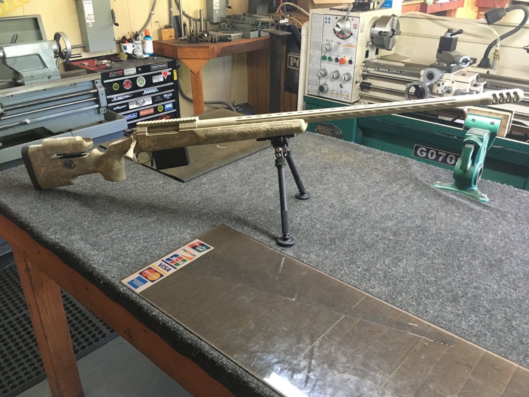

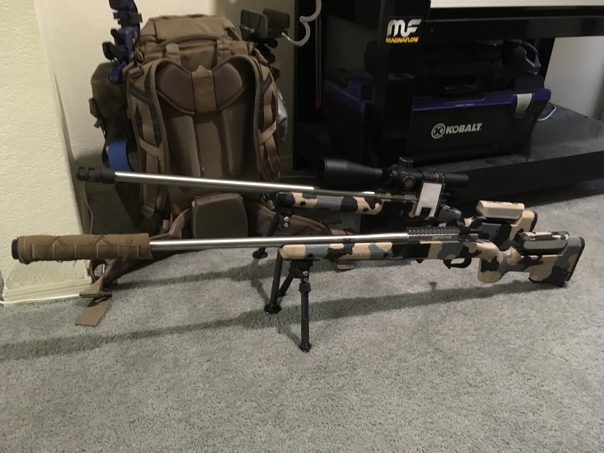

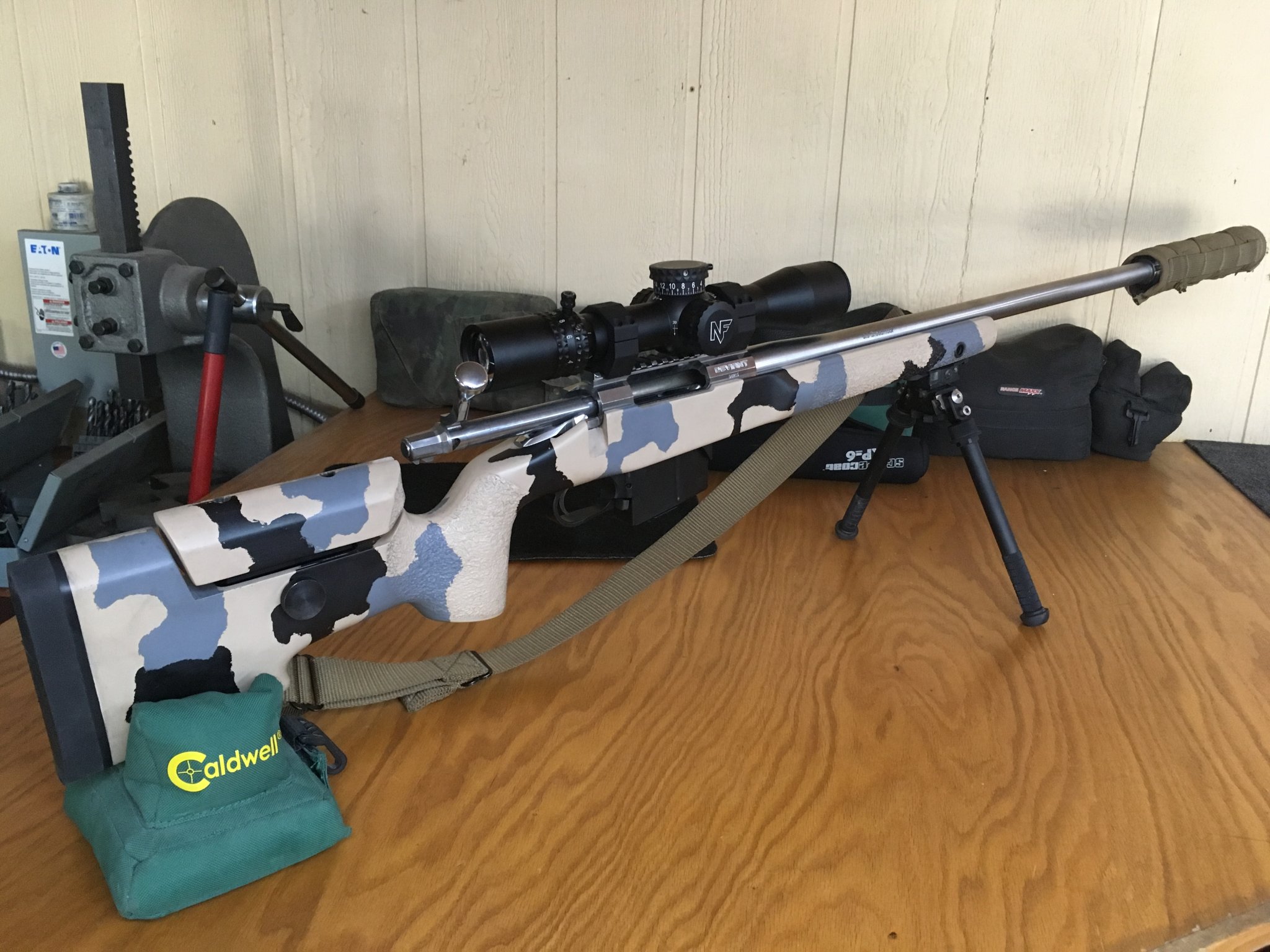

Couple awesome rifles finished recently.

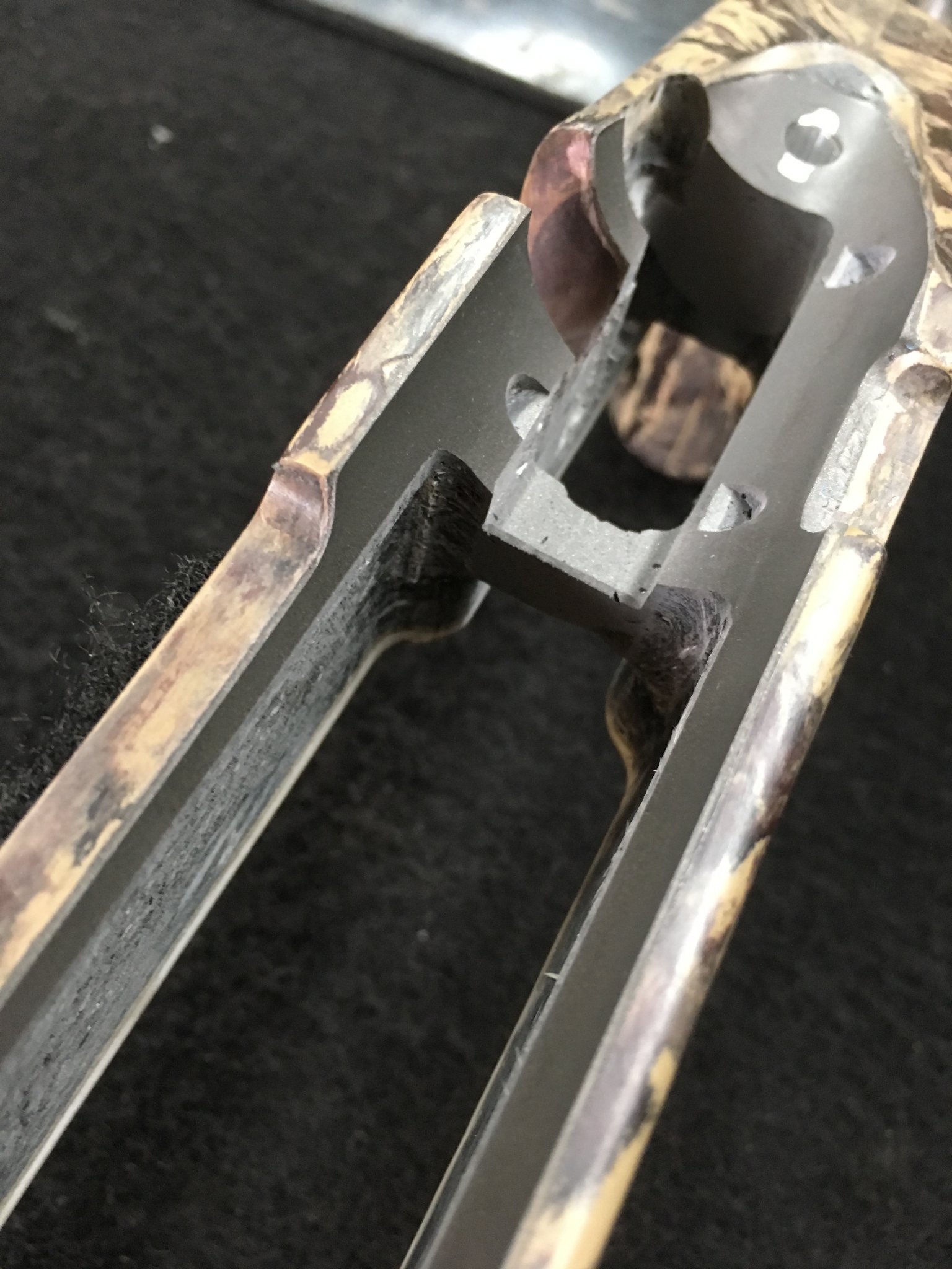

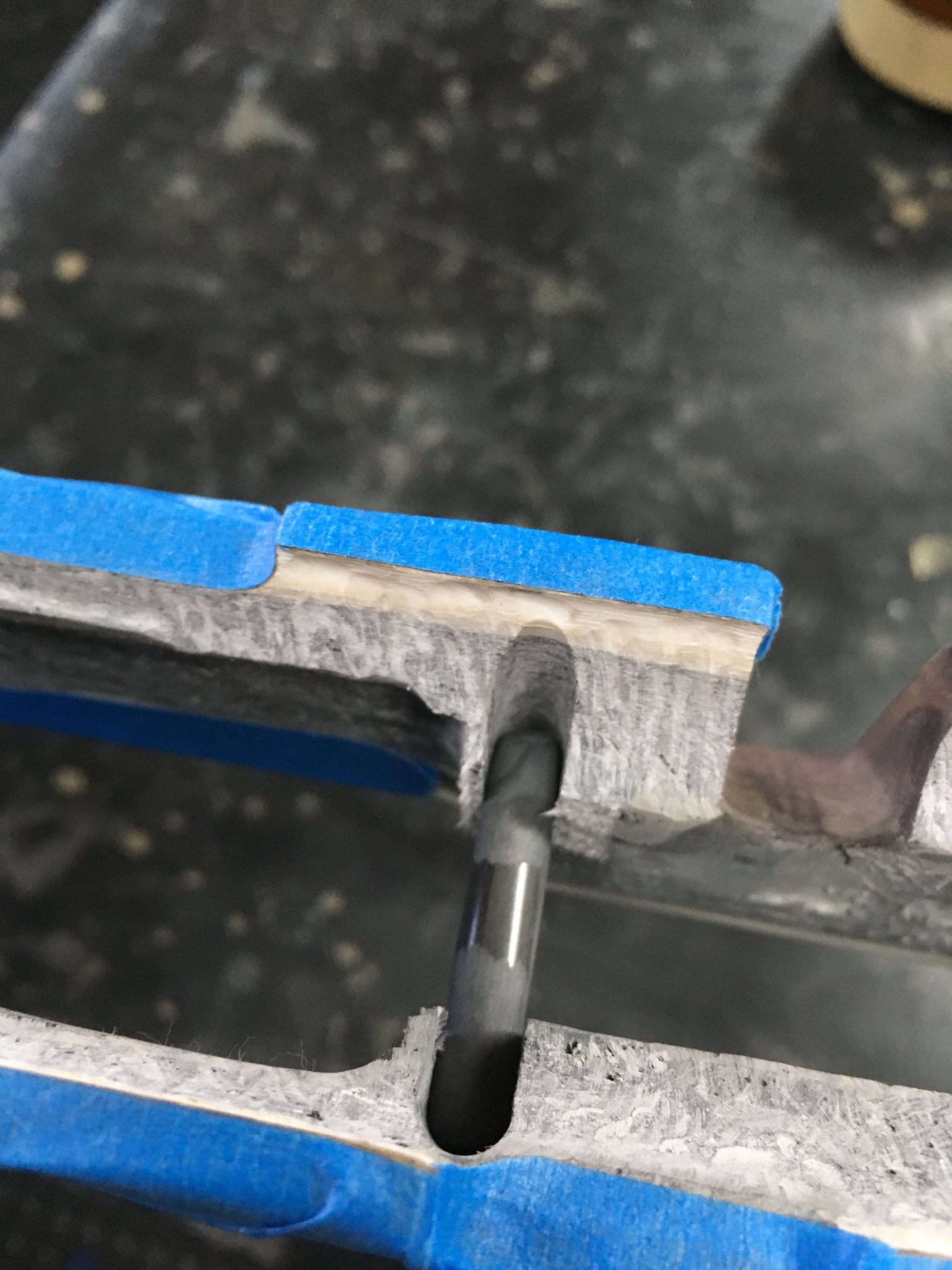

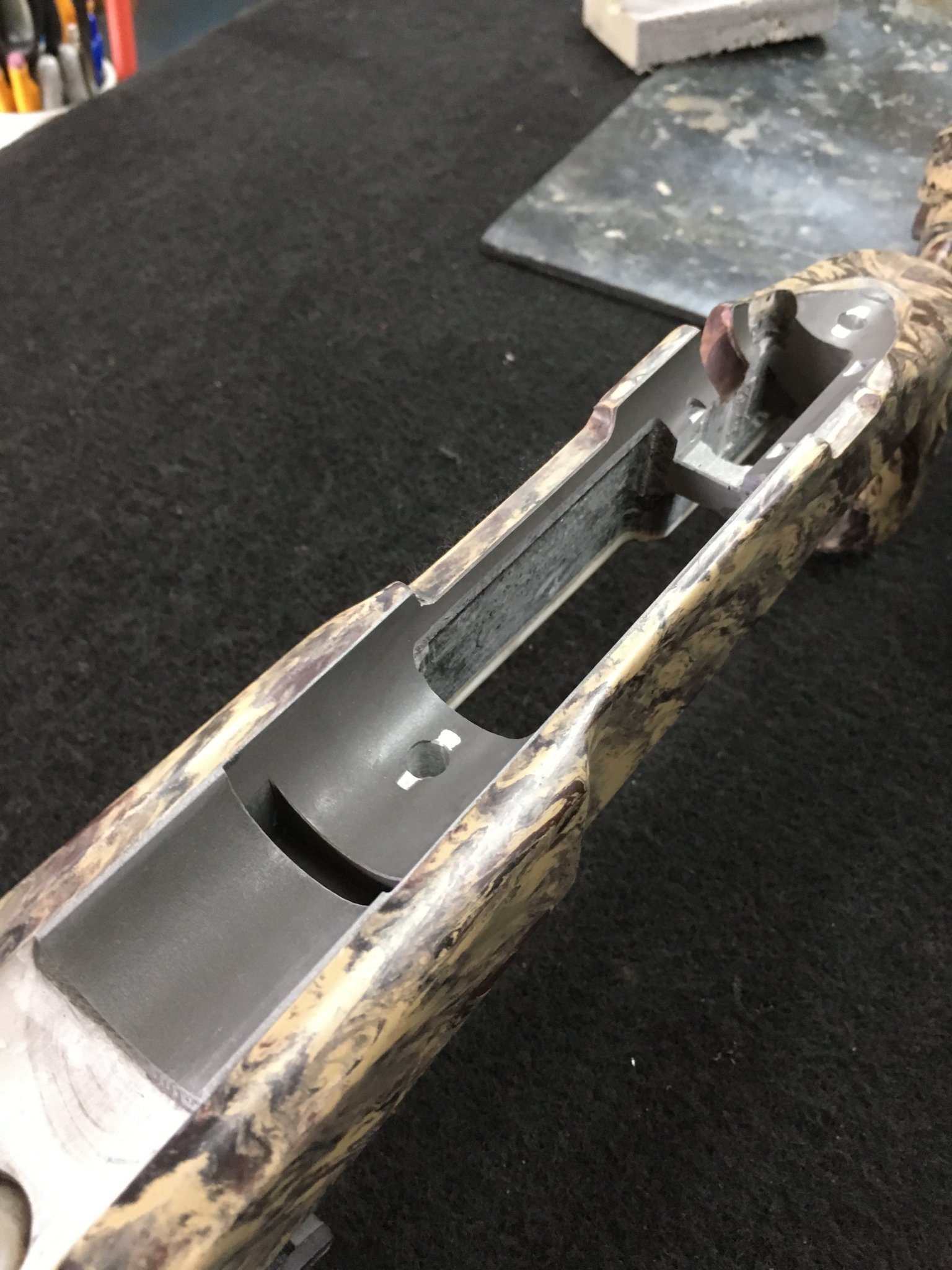

Pillar/epoxy bed job with carbon reinforcement.

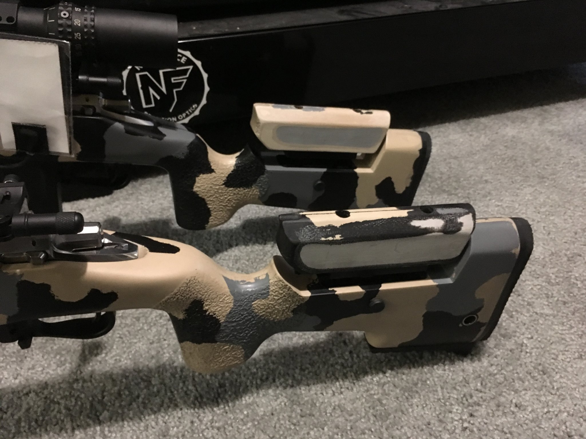

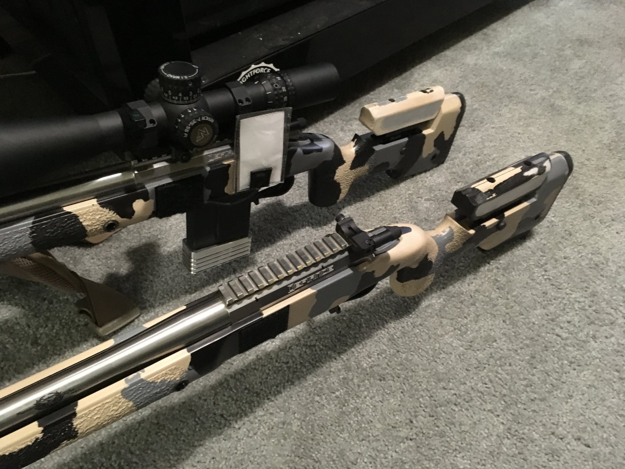

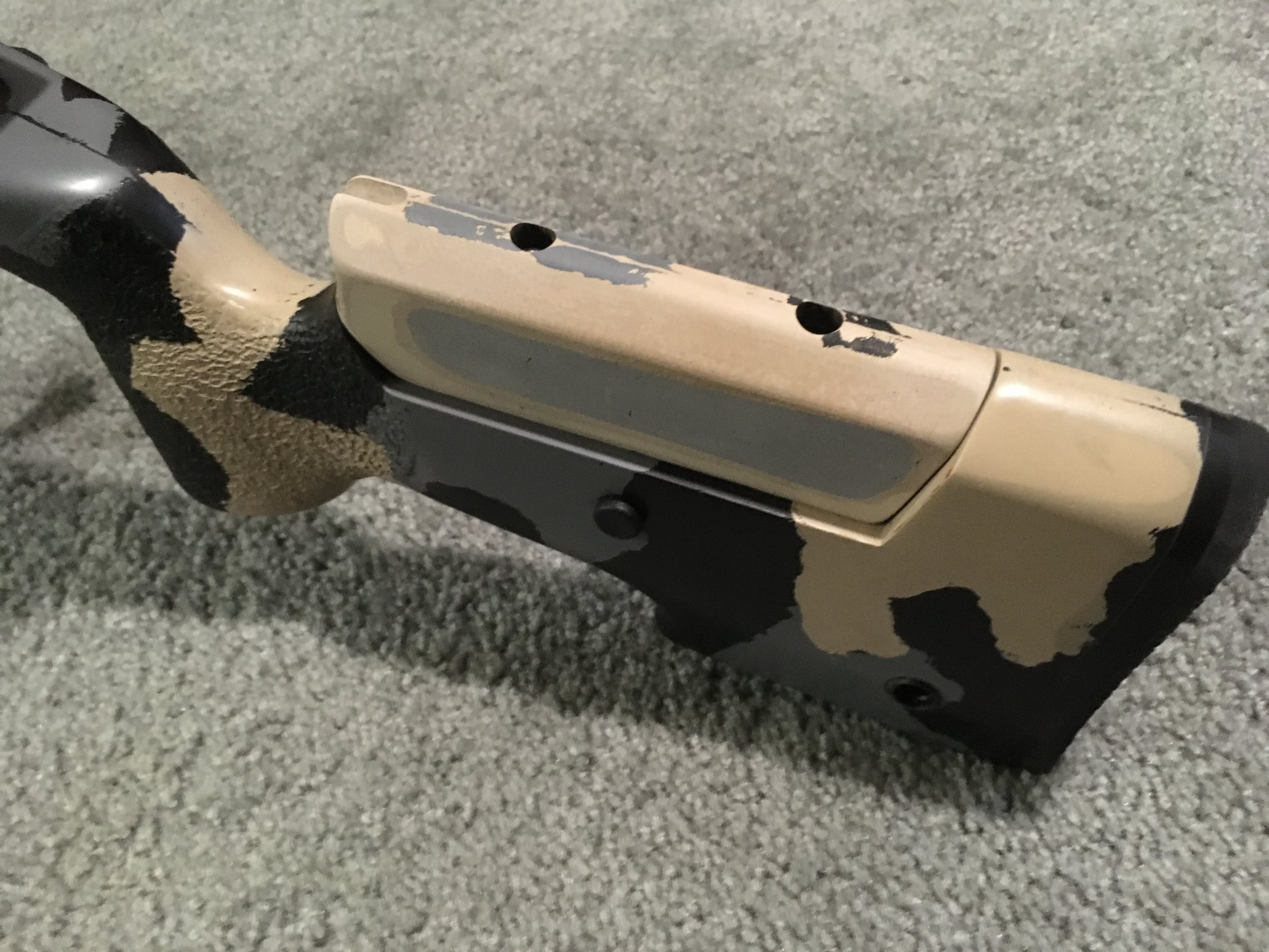

And my new narrower cheek piece prototype for Mcmillan A series. Let’s you keep your head more vertical behind the scope from BOTH sides of the rifle. I should have these two done this week and will post finished pics.
Thanks
Reactions: Basher

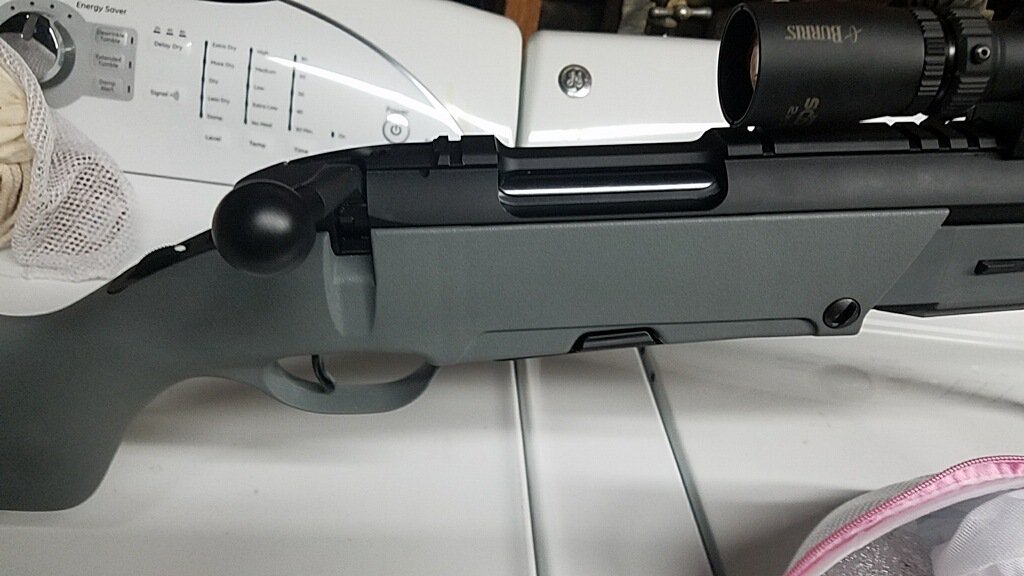

Keith,

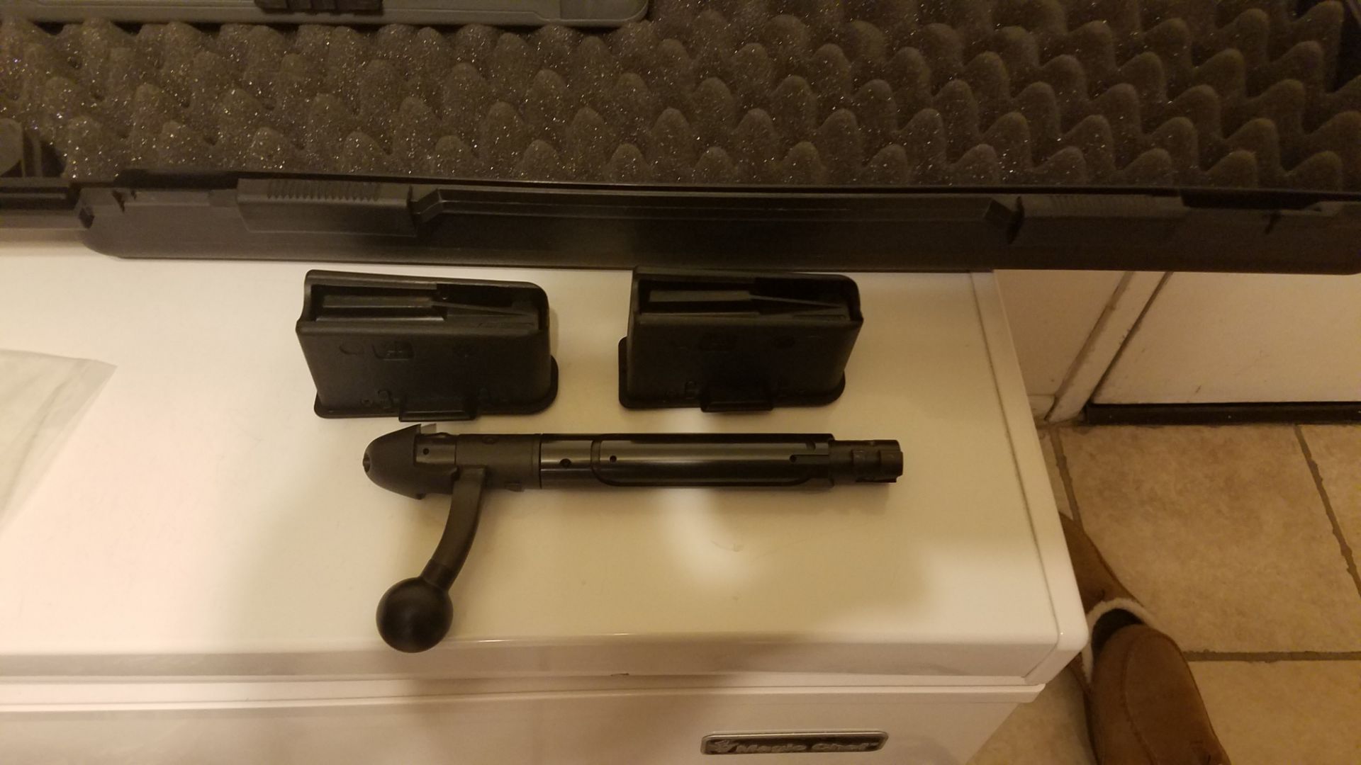

Are you able to work on Steyr bolts? I’m looking at changing out the bolt knob on my Steyr Scout and possibly my Steyr Elite as well. Do you have anything in particular that would mate well with a scout rifle?
If the handles are already threaded it’s easy.
If the handles need threads, I’ll have to look at them in hand before I’ll know how easy/hard it’ll be to do an install on.
Text me some pics of you can. I may be able to get a good idea from a few pics as to whether I can do installs on them.
And again, anything already threaded is a piece of cake. Imperial or metric, and any handle size, it’s no problem if it’s already threaded.
Reactions: DaleGribble82

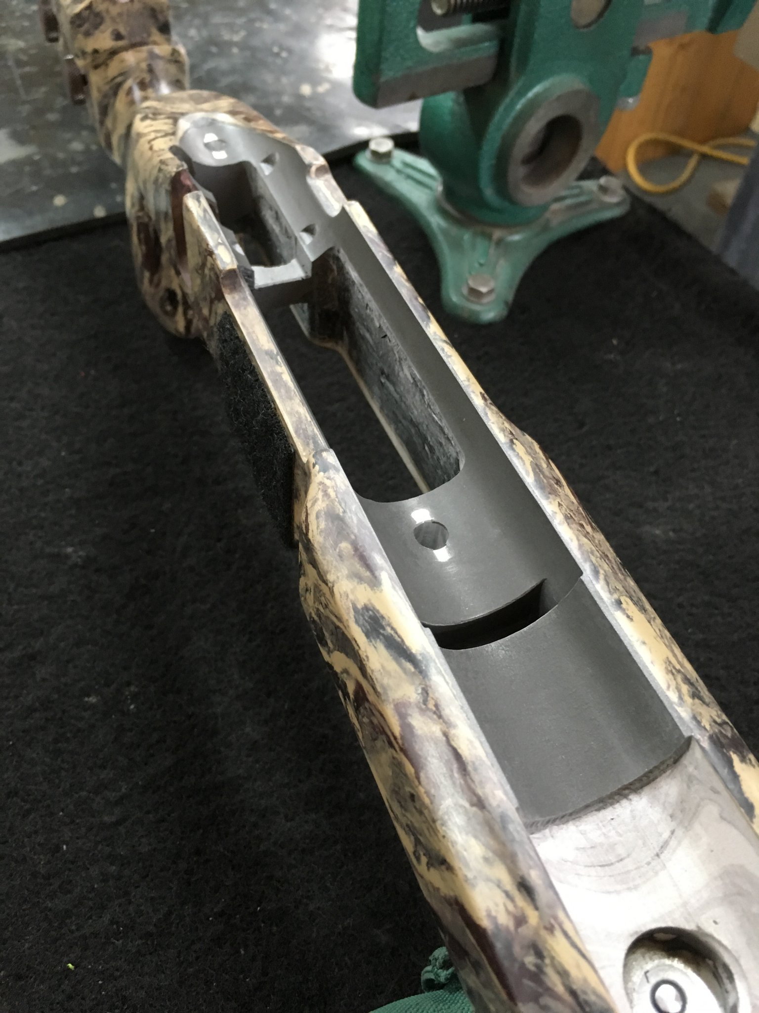

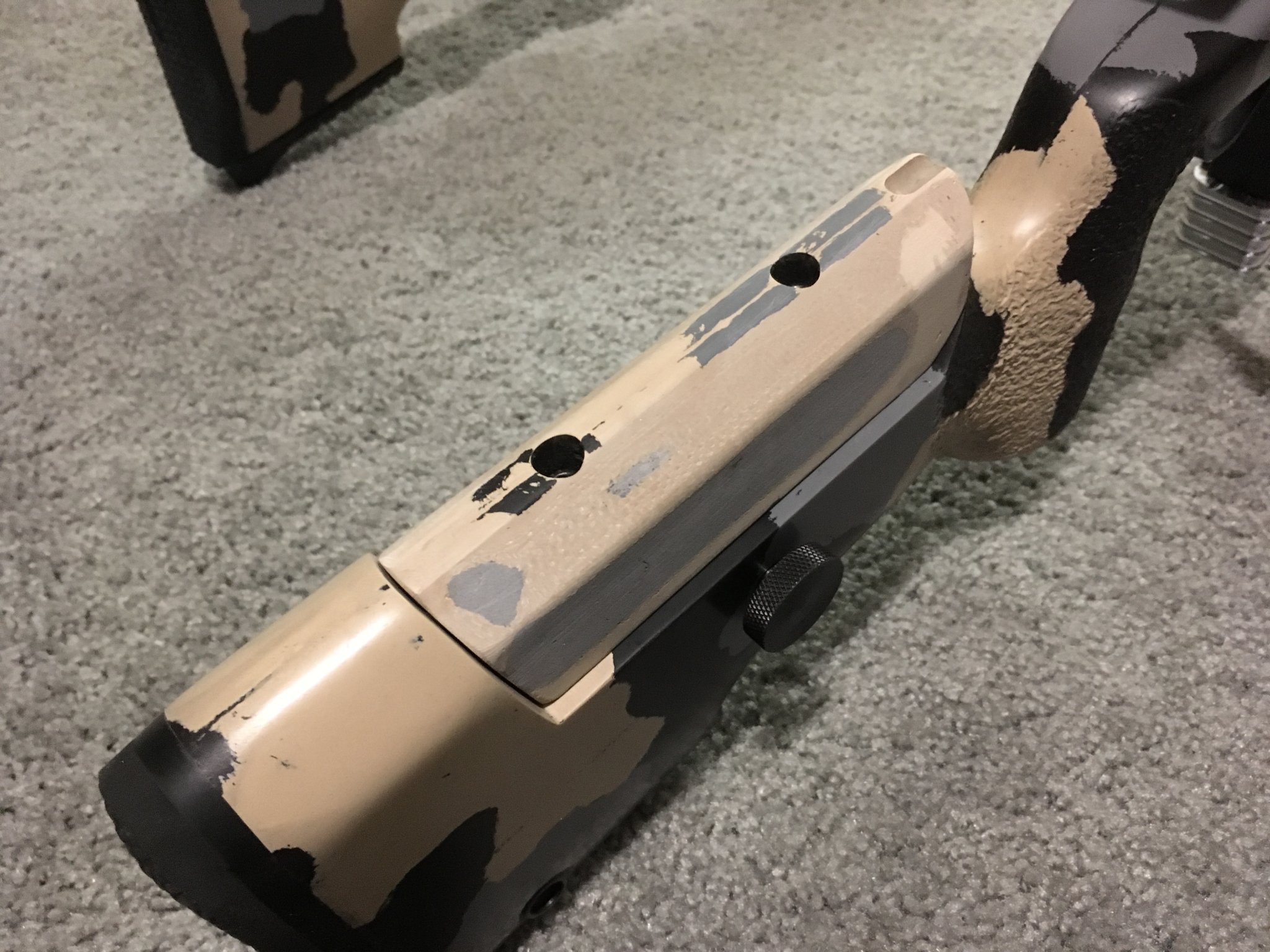

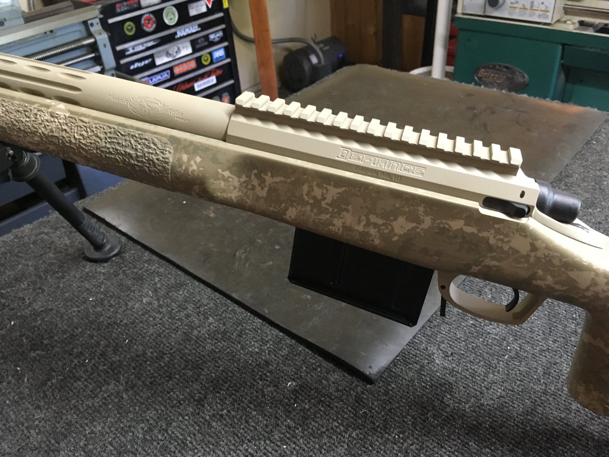

I put some lead in my A5 to balance my rifle on barricades with the heavier barrel it’s soon getting(this is my secondary(backup) stock).
I also narrowed this cheek piece as well cause it’s awesome.
Don’t hate ;)
The two spots you see epoxy have lead shot below it. I filled as much of the rear of the stock as I could. The grip area had a cavity in it which helped me fill it with more shot than my 5/8” hole would have otherwise taken.
The rear portion you see, I milled a stair-step pattern in it(making as large of a space as I could to fill with lead.
I didn’t overdue it and kept stock strength in mind.
Trust me I’m not weakening anything. It all gets epoxy/carbon reinforced. I don’t baby my gear and everything I own gets ran hard.
The cheek pieces, and that epoxy over the lead fill spots, will be cosmetically addressed soon. I have two matches this weekend and I’m racing to get done what I want done in time. I’ll make it pretty later. I can make it look perfect once I get our new epoxy kit from mcmillan(which has all their colors in it).
Thanks for lookin.

Keith,
This is what I’ve been able to find about my particular bolt on the Scout.
"Tactical" Scout Bolt Handle Modifications
The latest "Tactical" Scouts are fitted with a bolt with a more conventional shape and a large round knob. The ball is about 1 inch and diameter and while it is easy to manipulate some folks feel the knob is a little too big and looks out of proportion to the rifle. I am investigating making up some additional ones and will post availability here. However, if you have access to a friendly machinist you can make your own of any size or shape you like. I have found that a knob about .80" to .9" in diameter works just as well and looks better.
To remove the original knob proceed as follows.
  1. Remove the firing pin assembly.
  2. Hold the bolt body in your hand with the bolt lever protruding between your fingers.
  3. Using a propane torch carefully and evenly heat JUST the ball until you feel the bolt lever begin to warm between your fingers.
  4. Clamp the ball between two pieces of wood and unscrew. (Standard right-hand thread) The factory ball is aluminum so do not use pliers to remove or you will damage it.
  5. Clean the threads with a mild solvent.
Have your friendly machinist make a new knob to your specifications. The threads are standard metric 8 mm Coarse (1.25 mm pitch). Just have your new knob so threaded--use a 6.75 (6.8) mm drill as a tap drill--and you are in business. See below for suggested dimensions. A shaft length of about .25 - .3" works well.
Below I’ve attached a photo of the bolt.156A0AB0-641E-4C74-BA8F-C647D39AD8B6.jpegE3590CA1-DB3E-4EF9-A6D8-85670B1D3313.jpeg

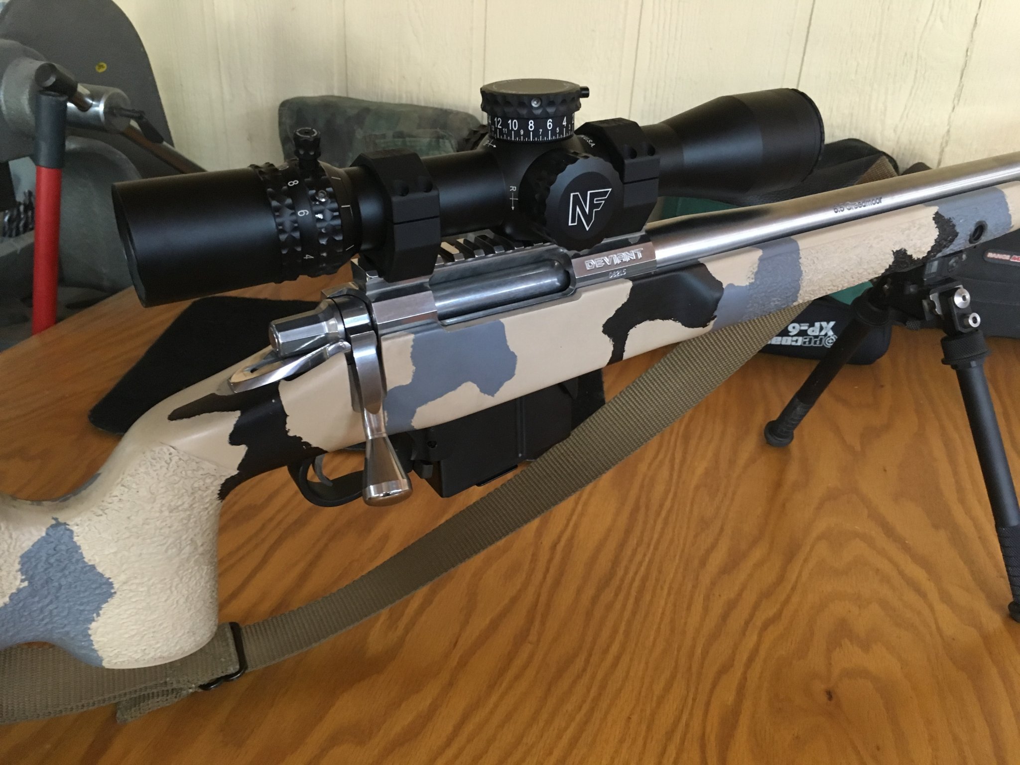

Shot a bunch this weekend. Cheek piece is awesome.
I’m trying to get what we need to start filming the shooter and the impacts at matches, then edit it together and post. It’s kinda boring to only watch one or the other.
It’s hard to remember to film during a match but I’ll get better at it and can sometimes even bring a helper :)
I’ll post some pics after I make the stock above pretty again. Too busy shooting right now to have it down.
I have 3 A5s I’ll be doing pretty much the same things to and posting pics.
Soon to come are some different forend rails(for barricade wedges). Hard to beat that fortune cookie or game changer but if you have the rail you have the options.
I’m pretty sure mcmillan is offering at least one of the rail systems pre-installed in some of their stocks.

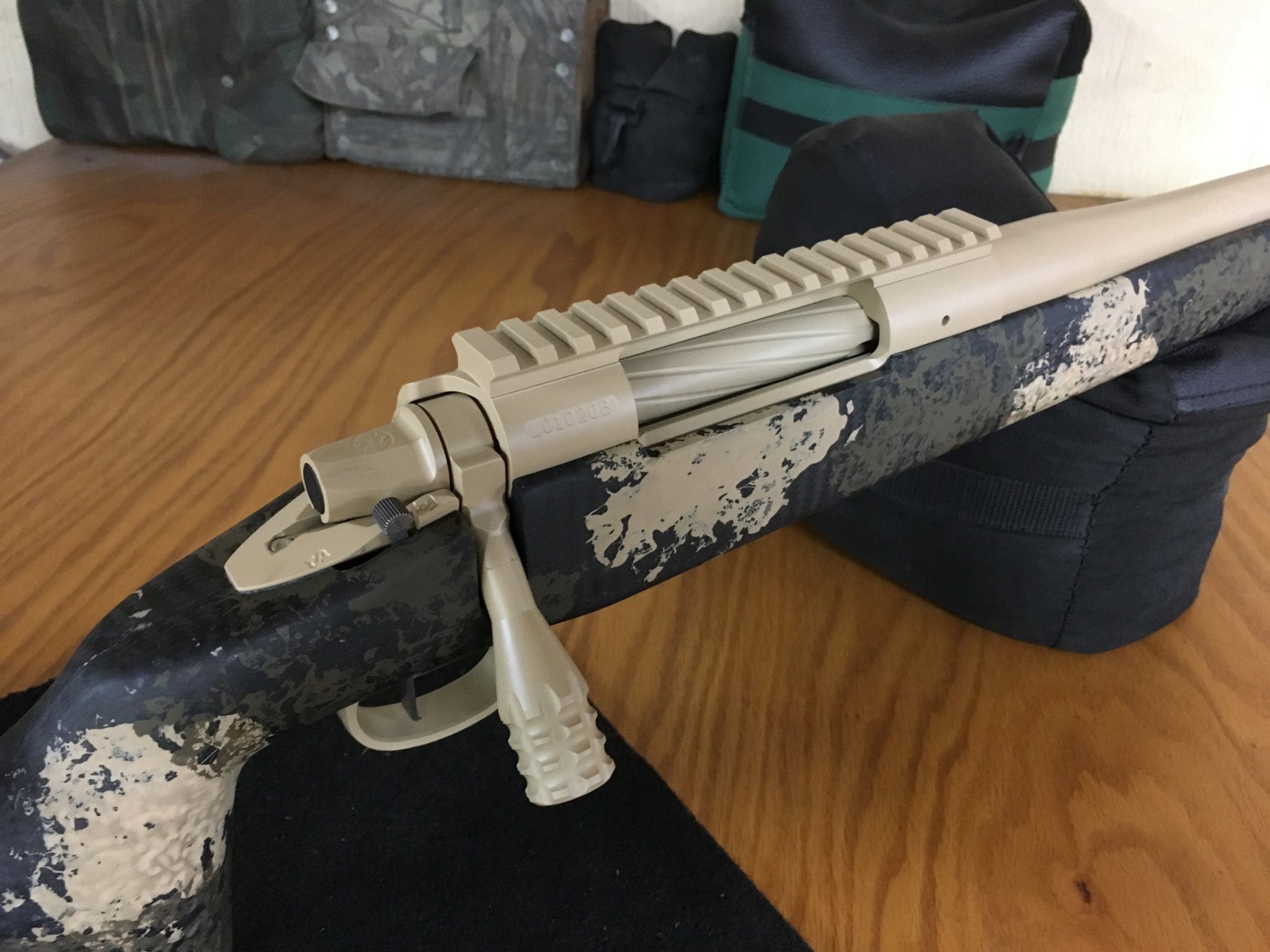

We are going to start offering Tikka receiver facing. It’s not squaring it up or “truing” it I’m after, it’s increasing the diameter to 1.200” so standard size barrels can be used.
Tikkas for hunting rifles I’d suggest keeping the 1.125” receiver face to keep unnecessary weight down.
For tactical Tikkas that benefit from heavier barrels I will be suggesting to cut the face back to 1.200” diameter. An m24 barrel on a faced Tikka is a stout rig. Barrel comes back to meet the receiver diameter flush/evenly.

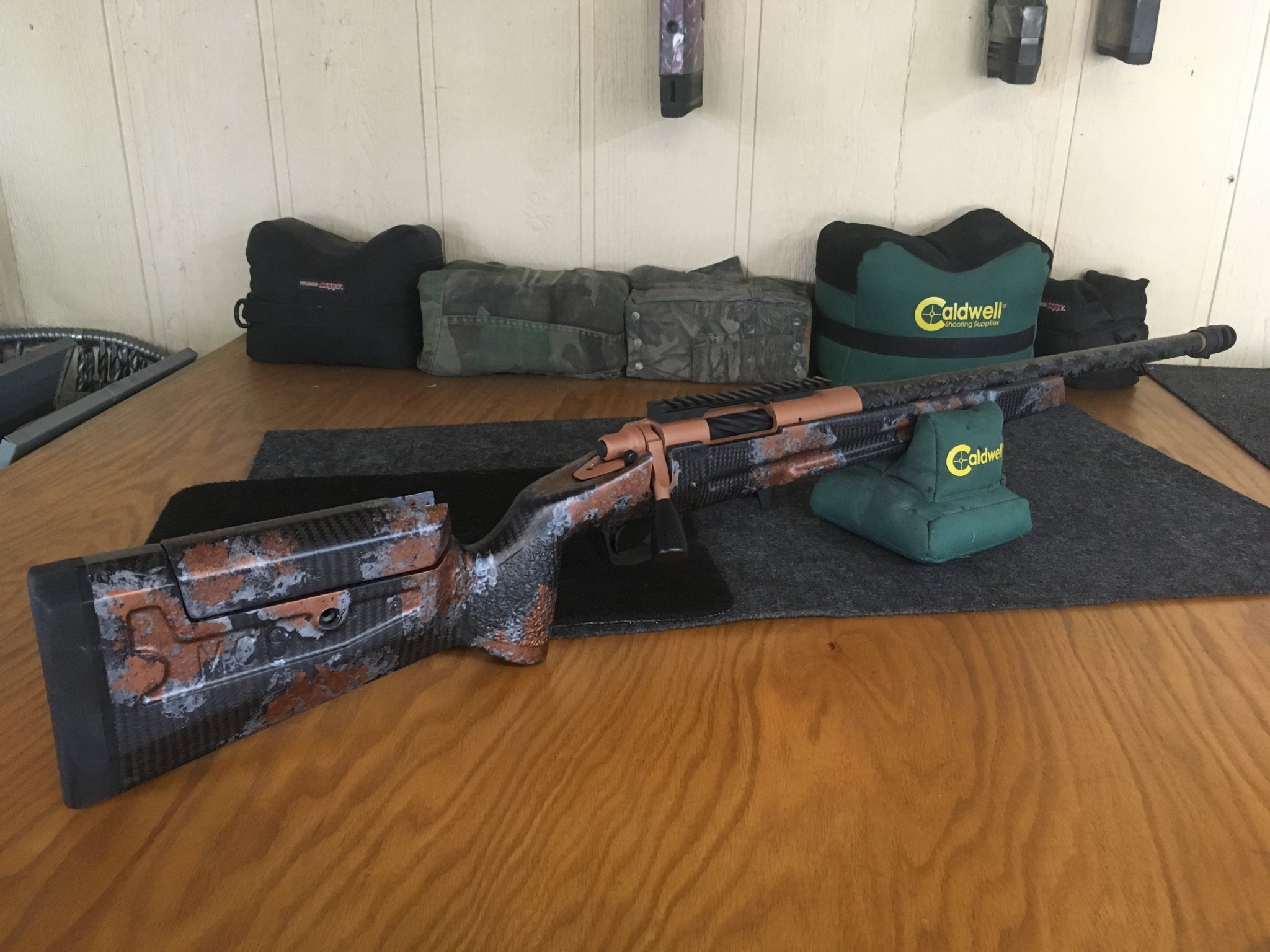

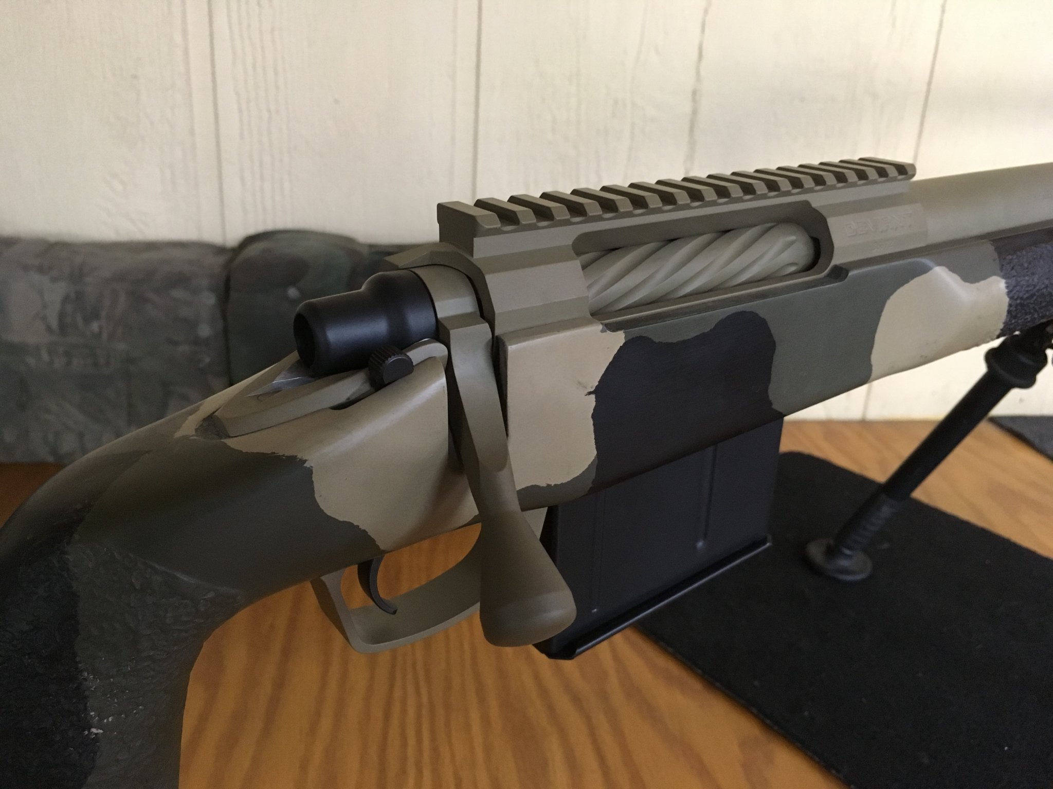

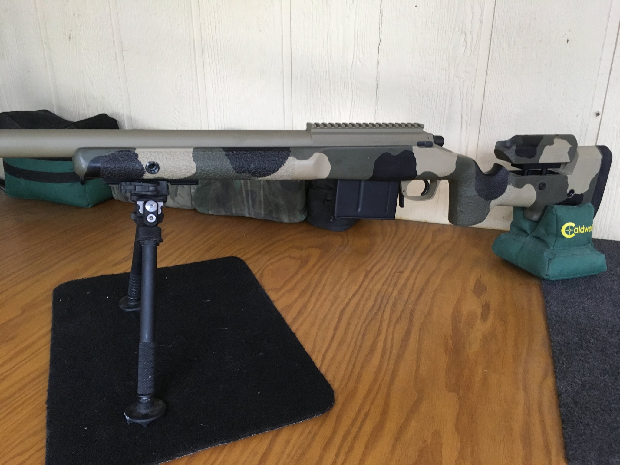

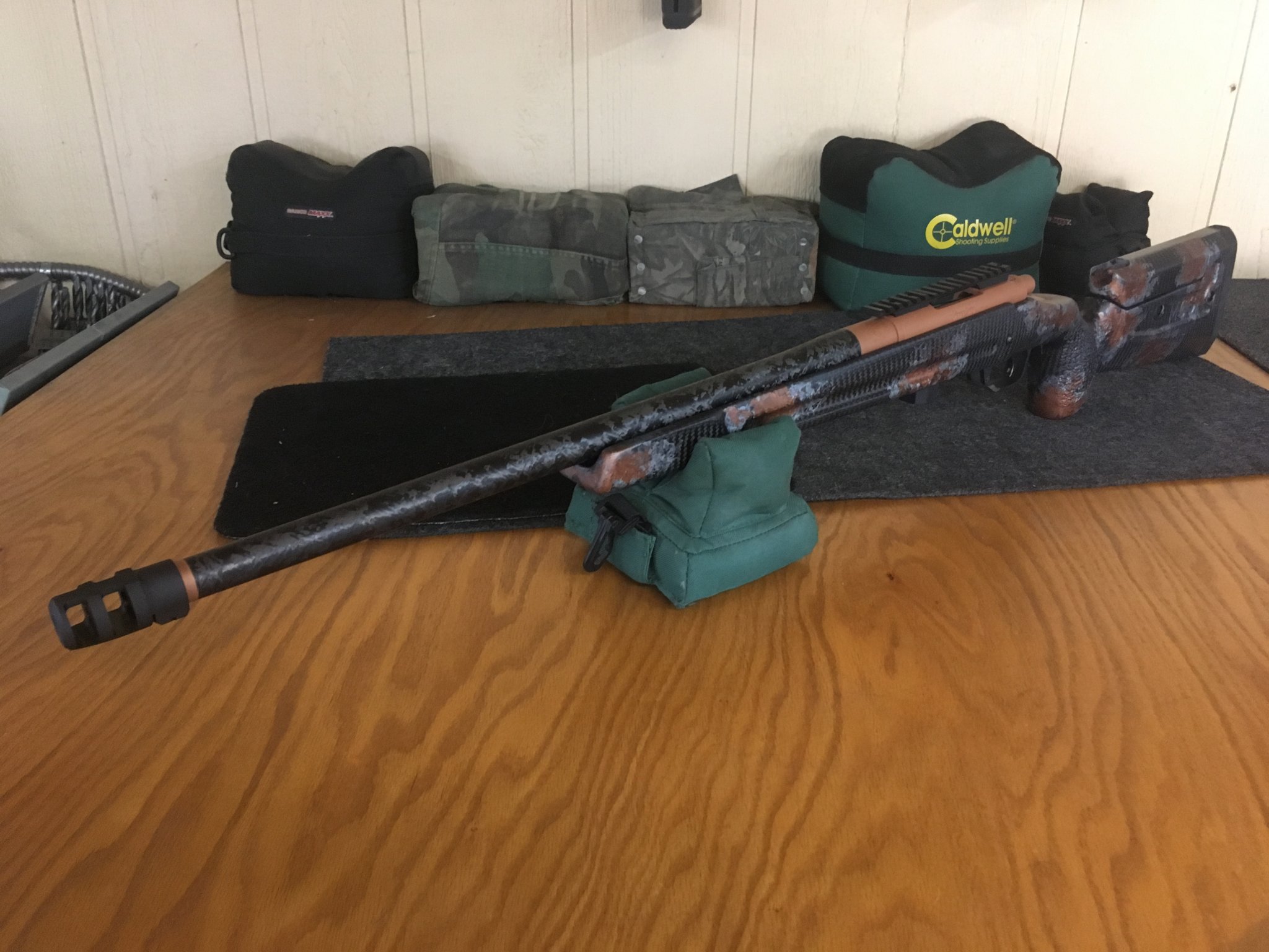

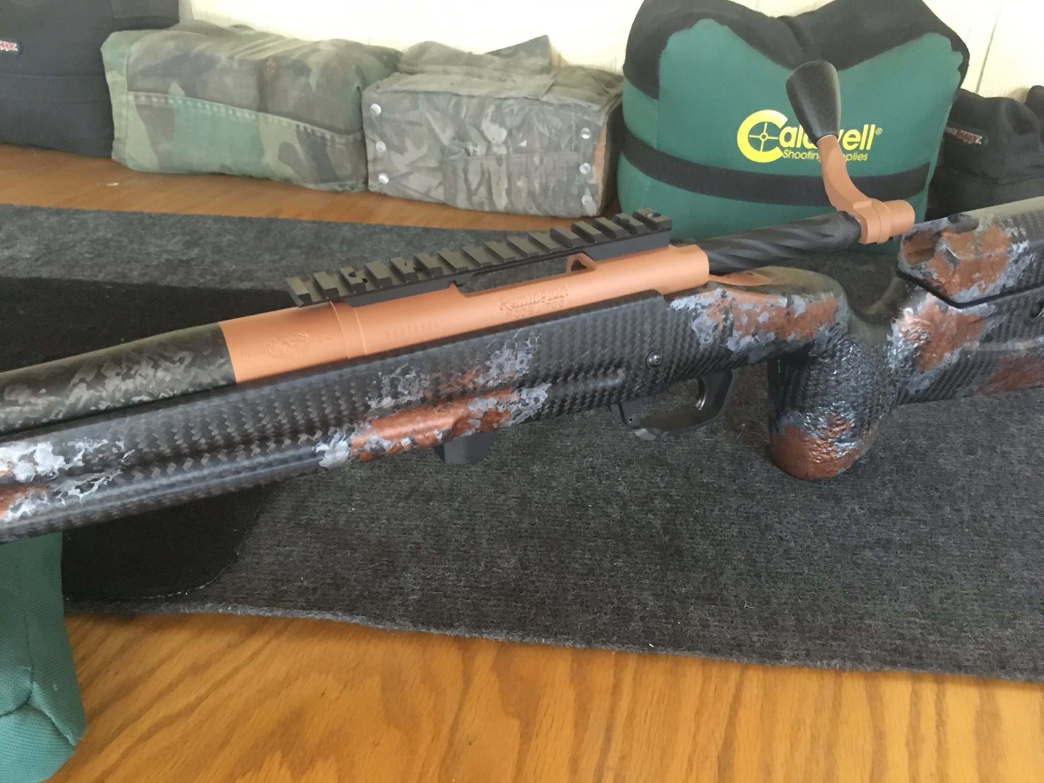

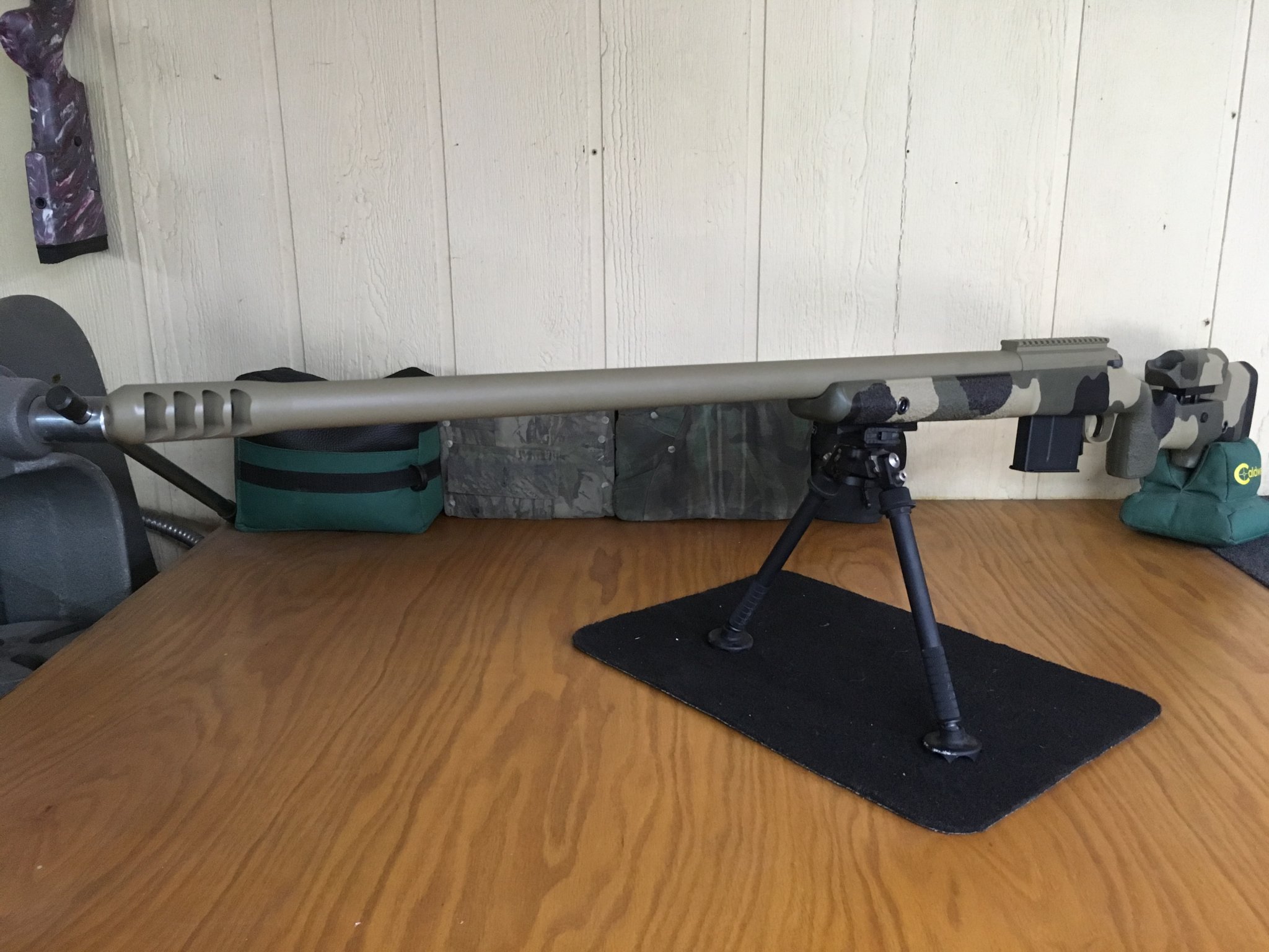

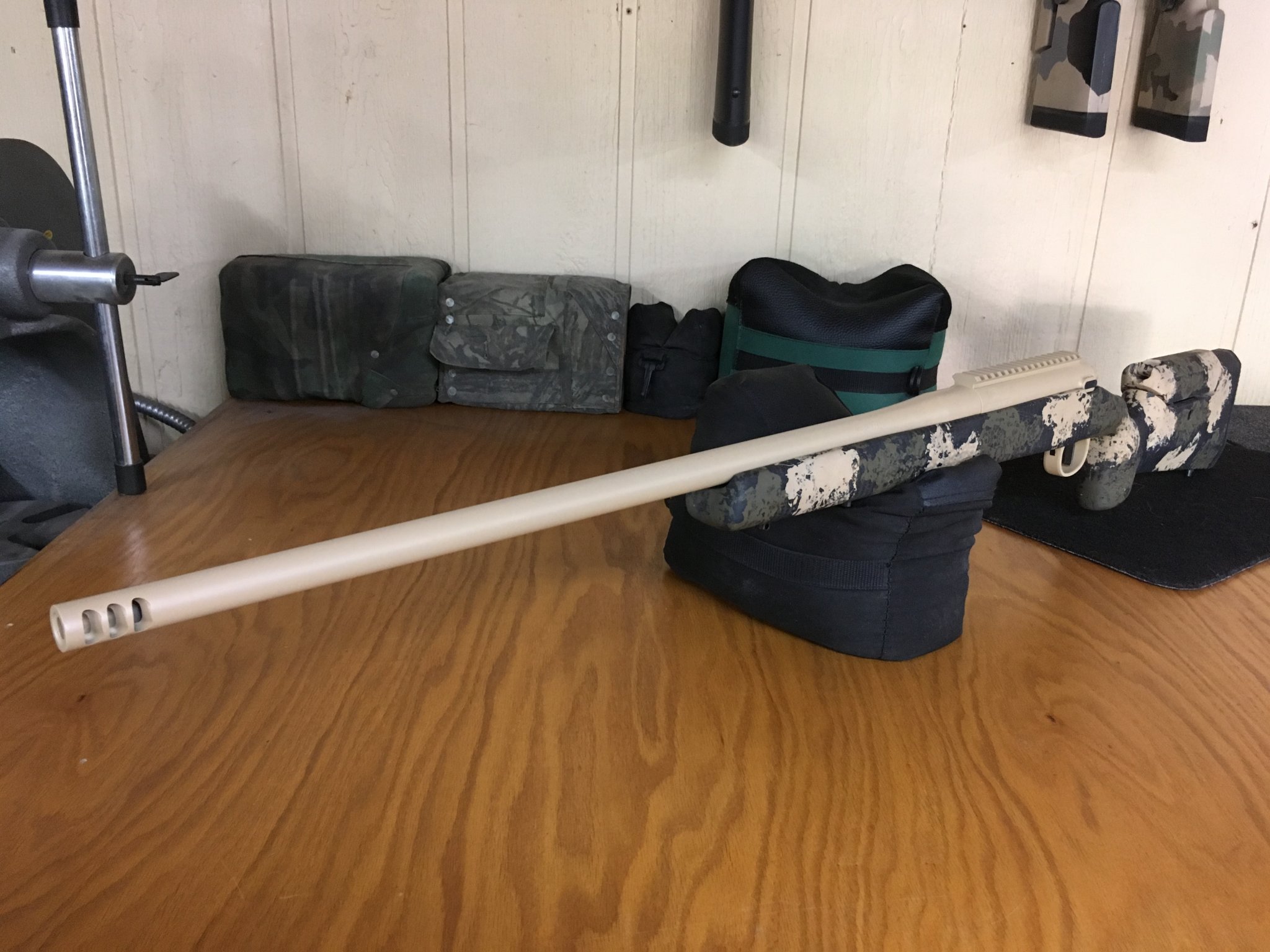

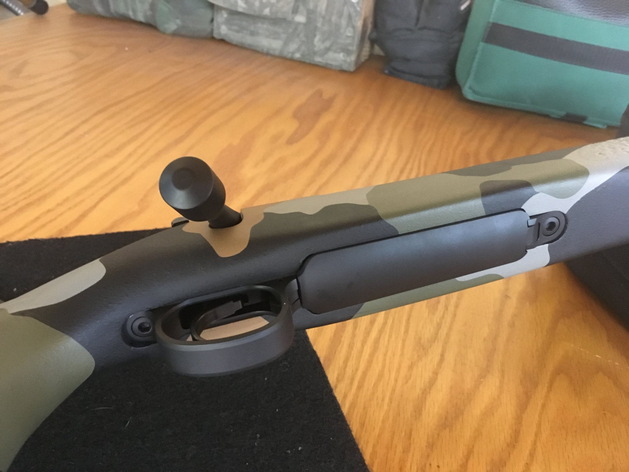

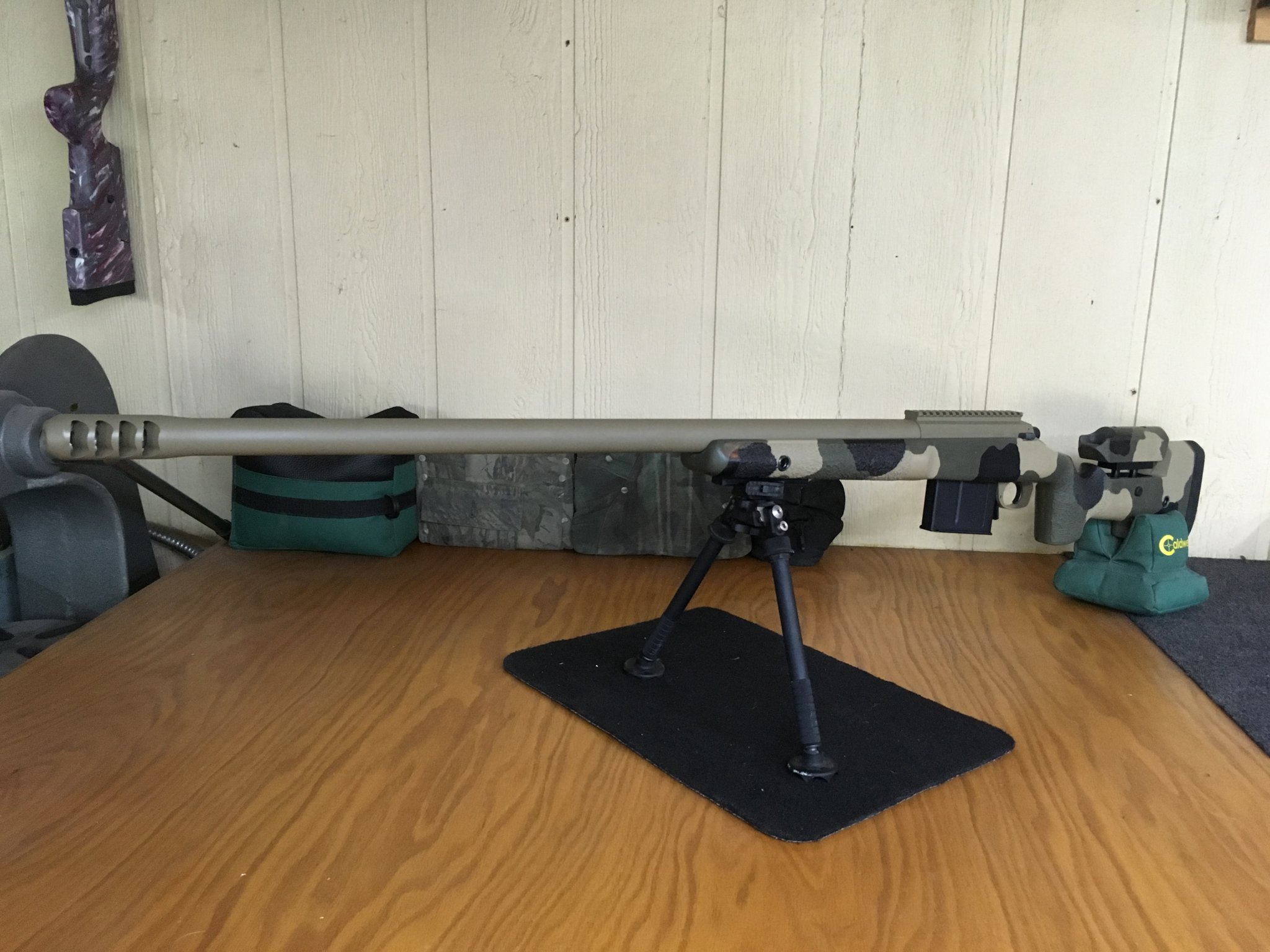

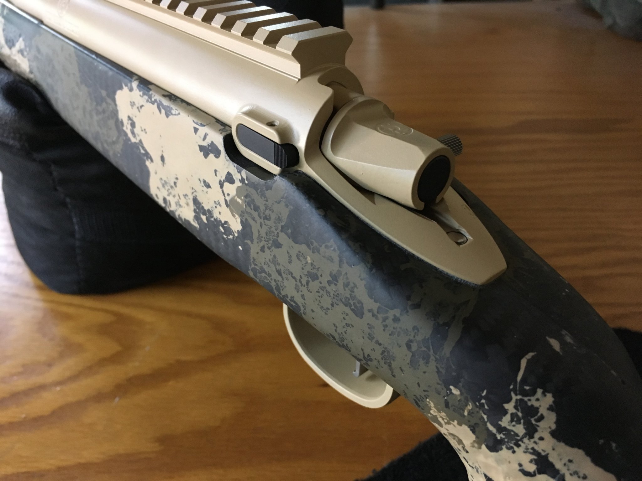

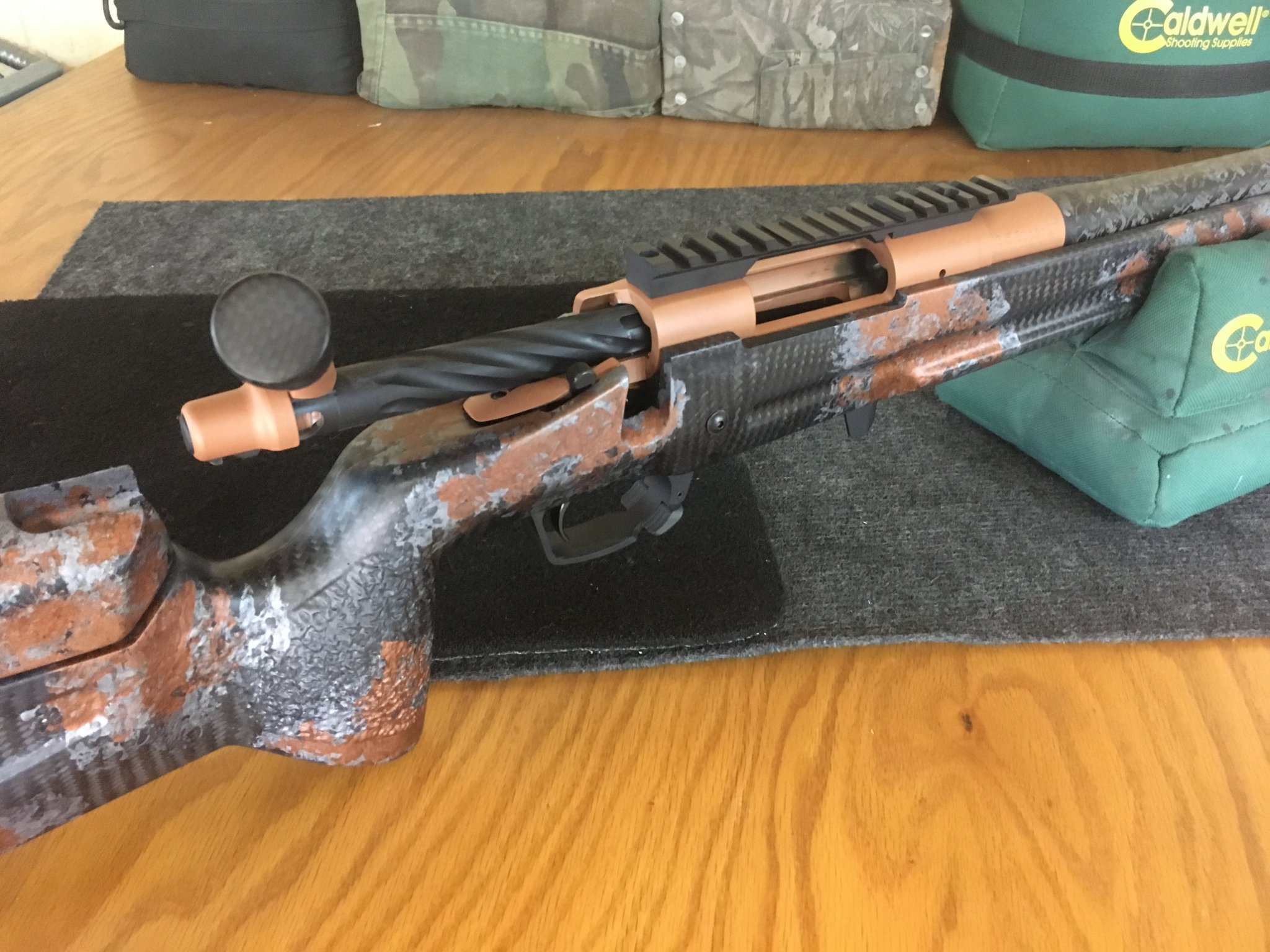

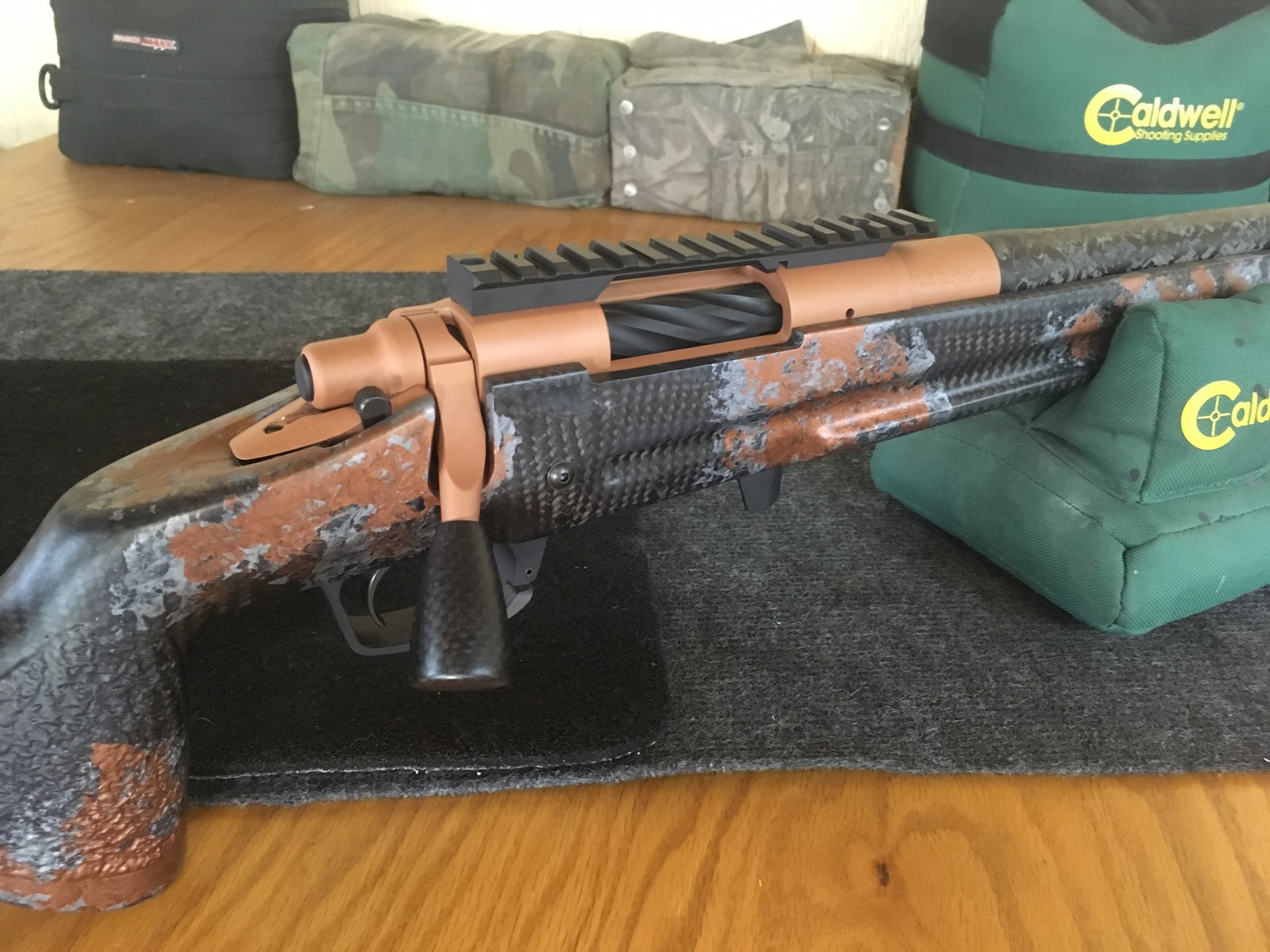

Cool Copper color cerakote we came up with to match the Manners copper color.
Uses a mixture of three colors.
Reactions: duramaxed
