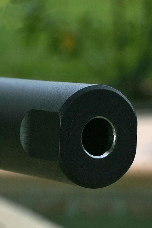

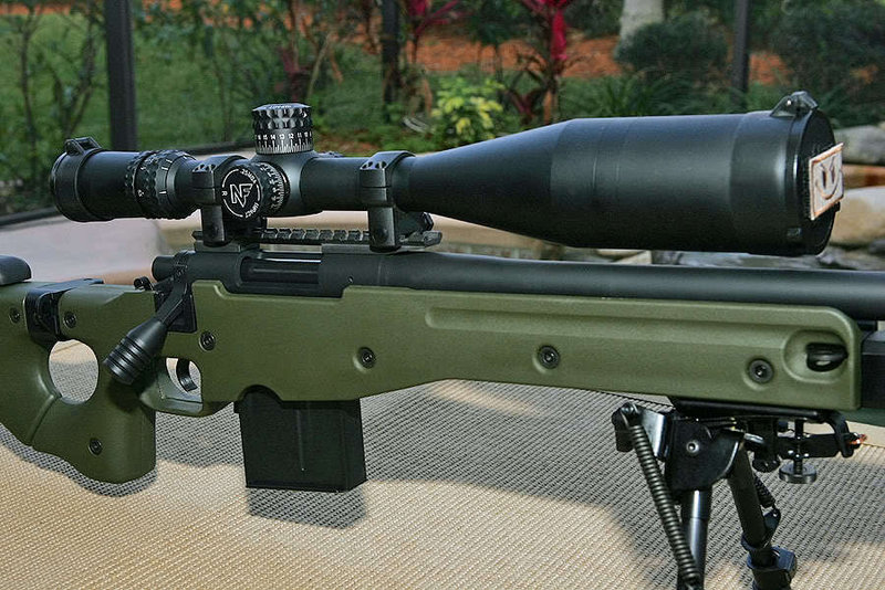

I supplied the reamer and all parts except bottom metal.
Remington 700 action
Action trued
PCR bolt knob, shroud mod, and reinforcement screw
PTG tac. Steel bottom metal
Lilja 10twist barrel finished at 27", remington varmint contour/fluted
5/8x24 muzzle threads and seamless thread protector
Chambered in 30-06 Ackley Improved
Barreled action and bottom metal cerakoted
Grey Bull Precision stock

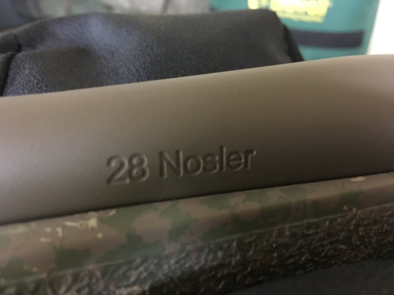

Someone told me that you had a 28 nosler reamer set up for the 195 bergers and would still fit in a magazine. If so, what would be about the max coal that the reamer would allow and what velocities and loads are your customers getting? Thank you for your time.
Yes we have a 28nosler reamer with a .185" freebore and 1-30(one and a half) degree lead angle which should put the OAL to tip around 3.600"
Plus, you can still shoot 162s/168s and up. You're not stuck with the 195s like you would be with too long of a freebore.
Reports back from customers have been great.
I do suggest using aftermarket Ultra Mag actions for this cartridge. Like a Defiance Long Action (Ultra mag version).

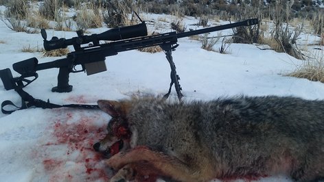

PCR 300 win mag build
Rem 700 action LA
Bartlein Barrel
Timney 510
Precision Arms M11 Brake
XLR carbon Chassis
Took out this coyote at 915yrds....head canoe!

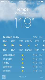

^ But it's a DRY heat right? Kinda like a blow torch on the surface of the sun?!! I would be thinking of changing the name of your company to "anywhere BUT Phoenix custom rifles" !!

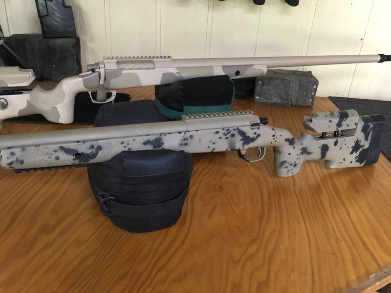

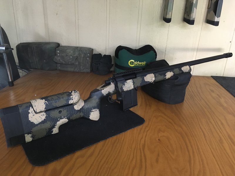

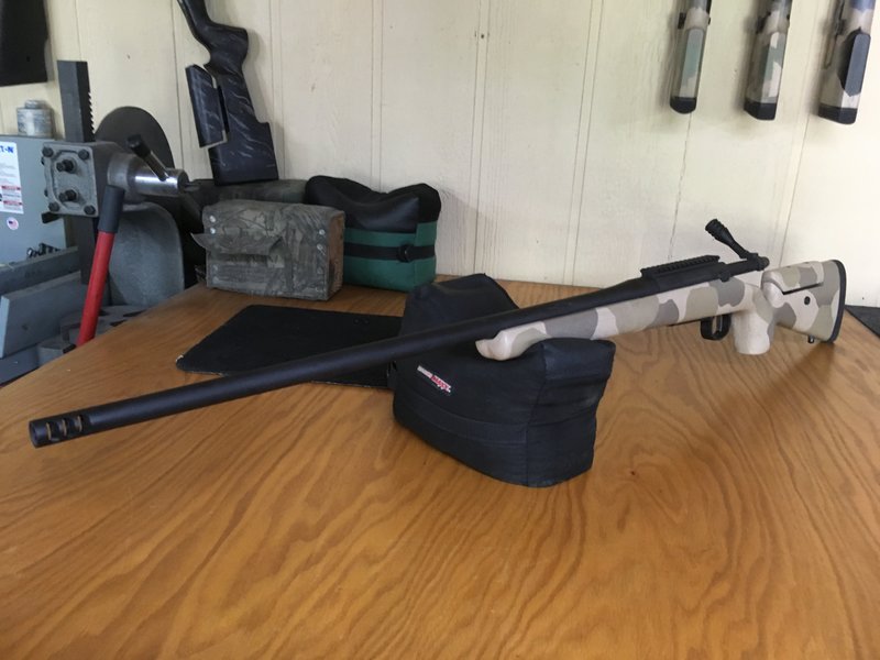

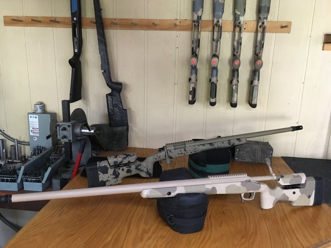

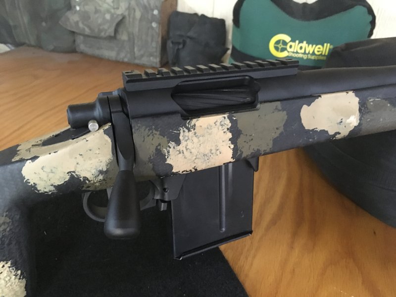

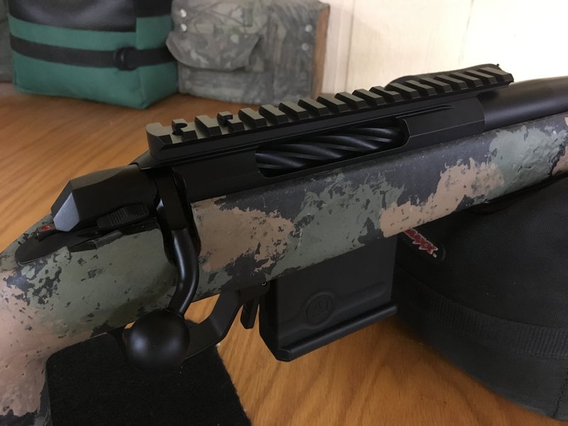

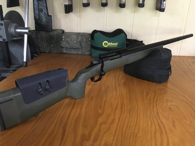

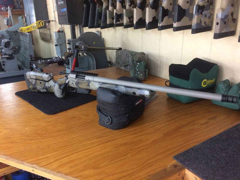

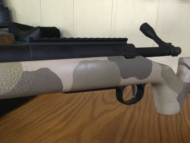

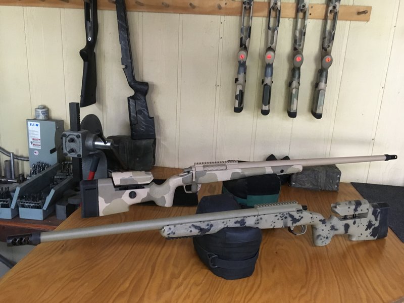

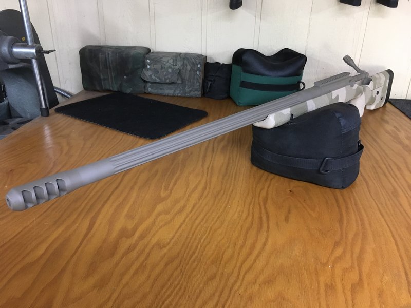

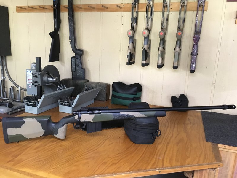

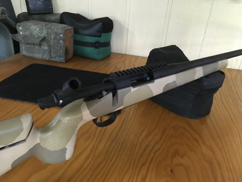

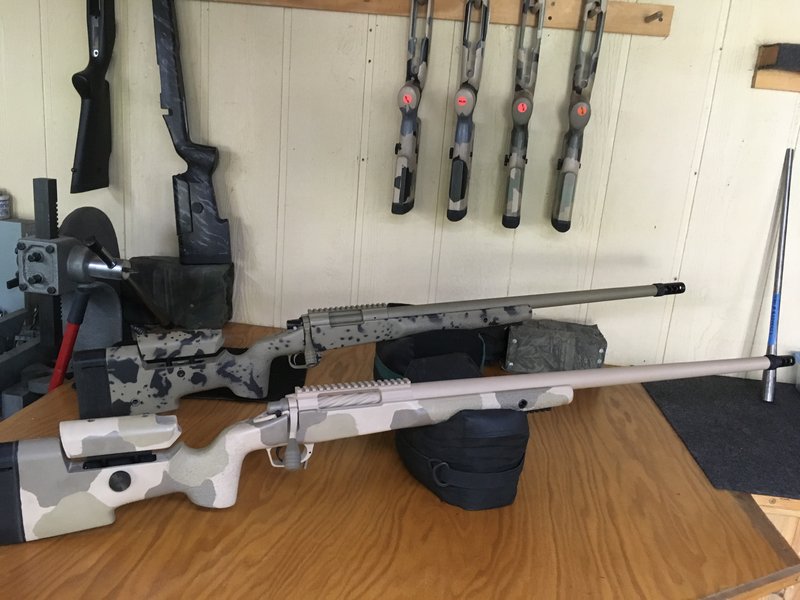

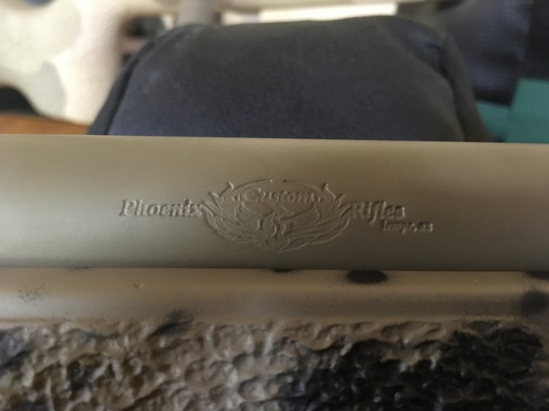

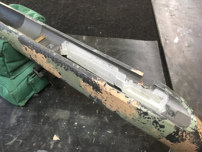

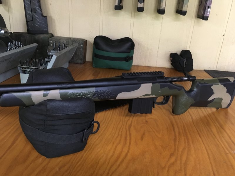

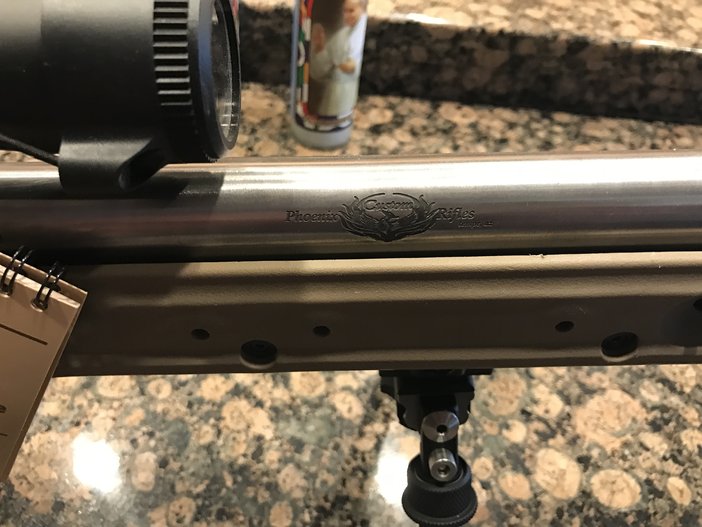

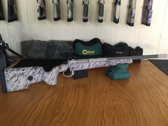

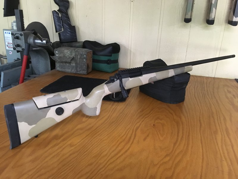

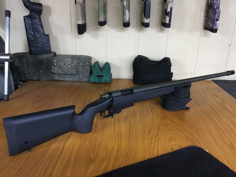

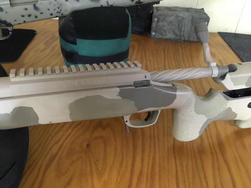

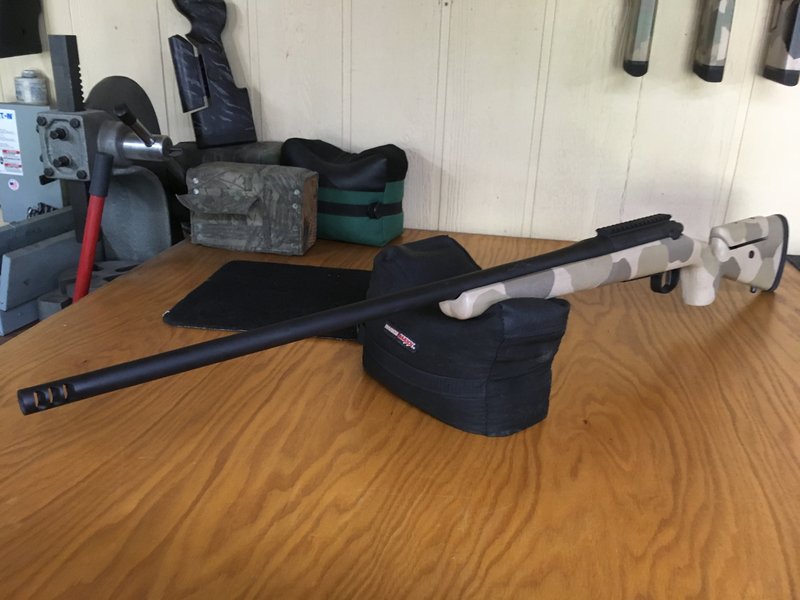

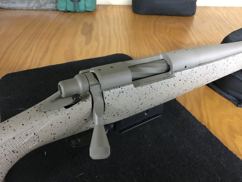

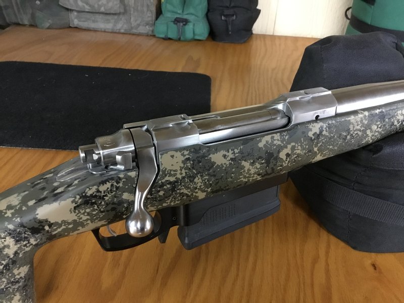

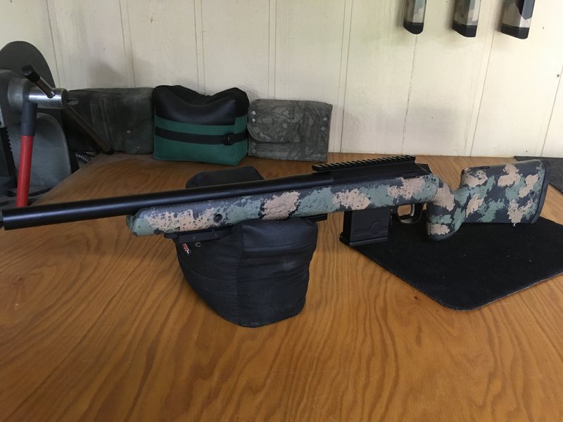

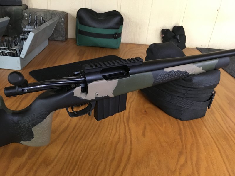

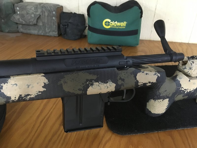

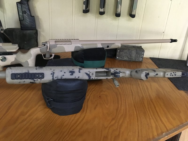

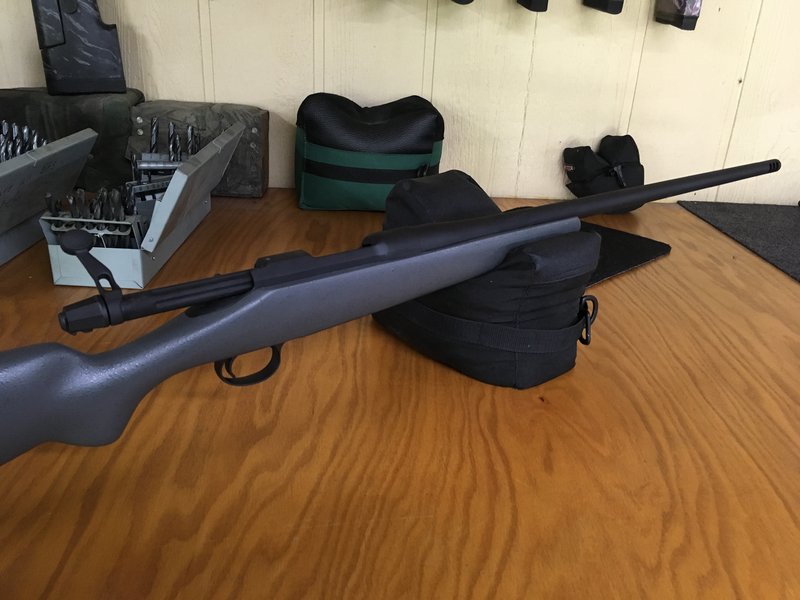

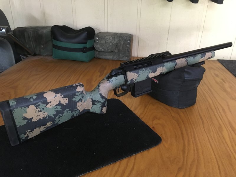

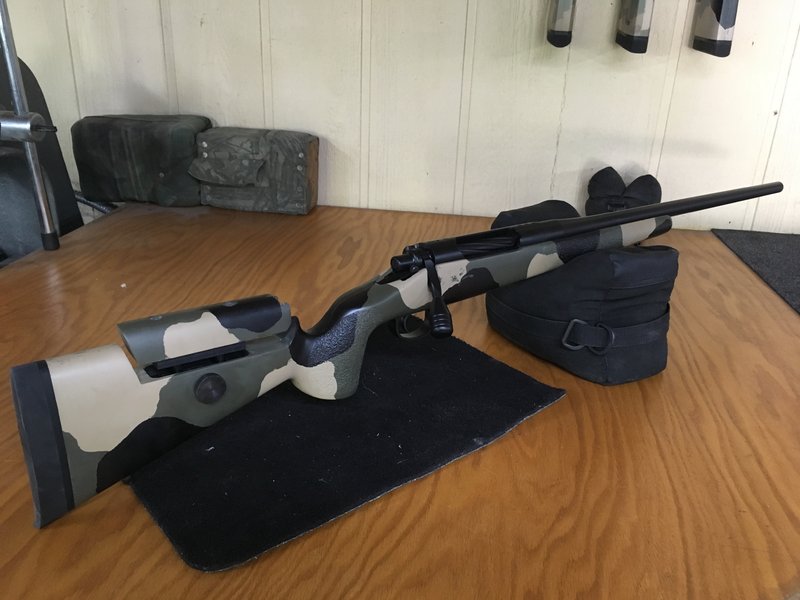

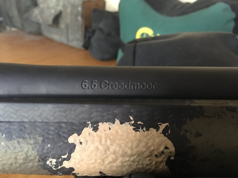

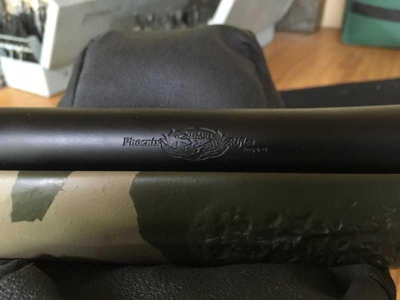

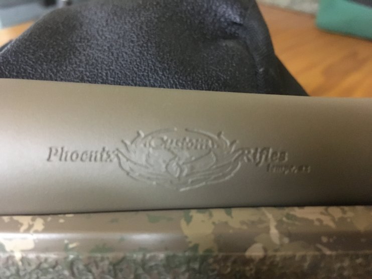

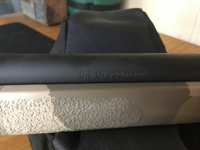

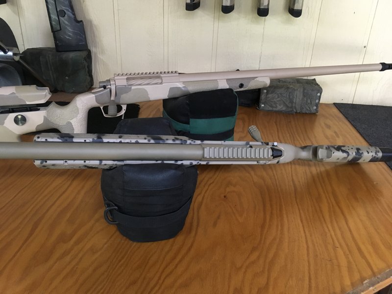

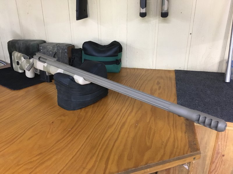

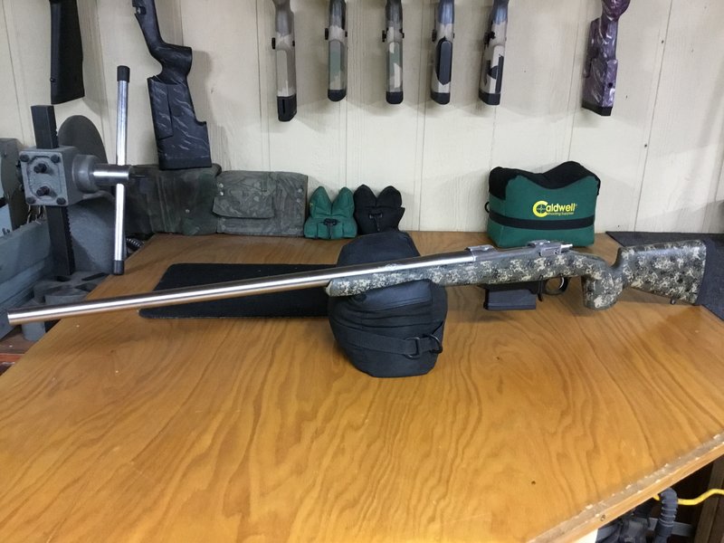

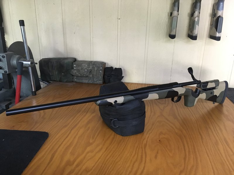

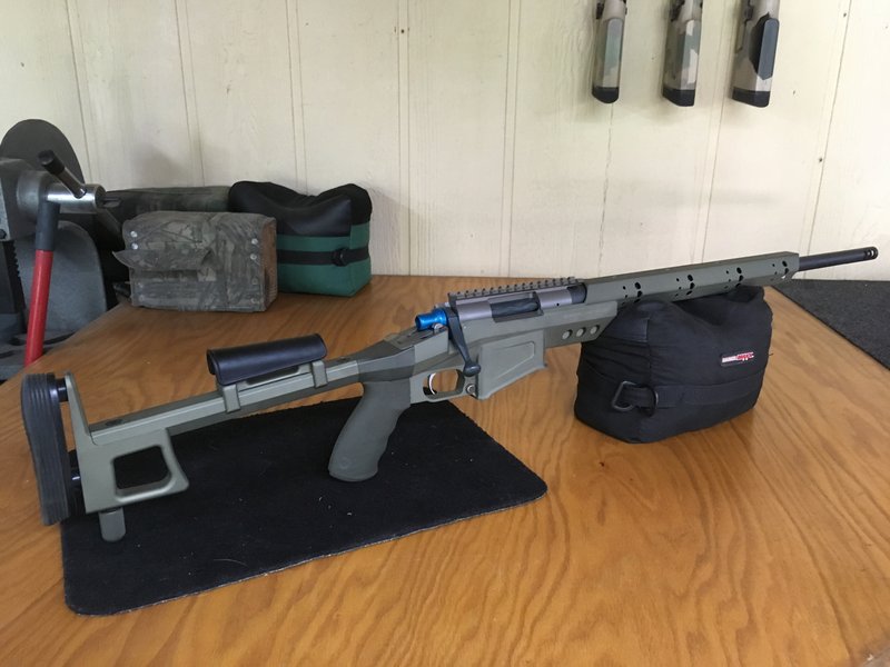

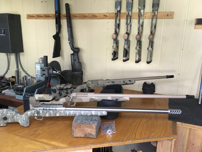

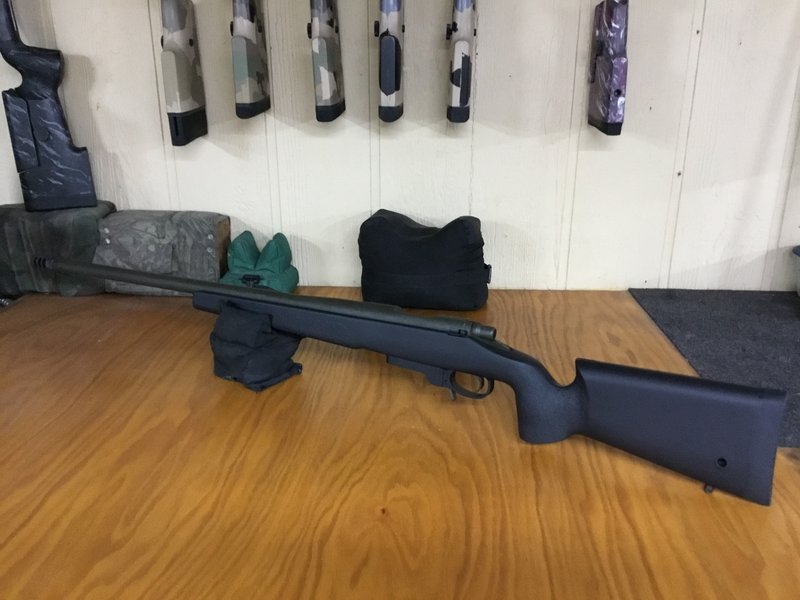

Few rifles just finished up.
Thanks guys!

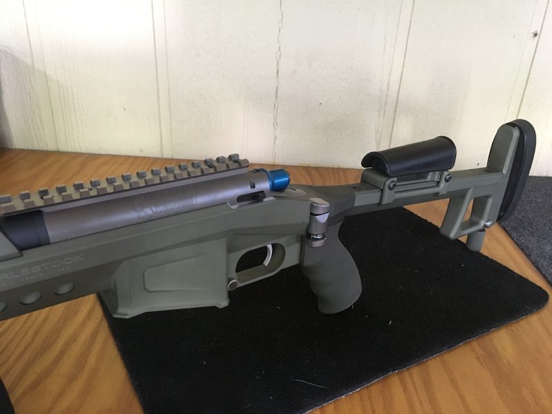

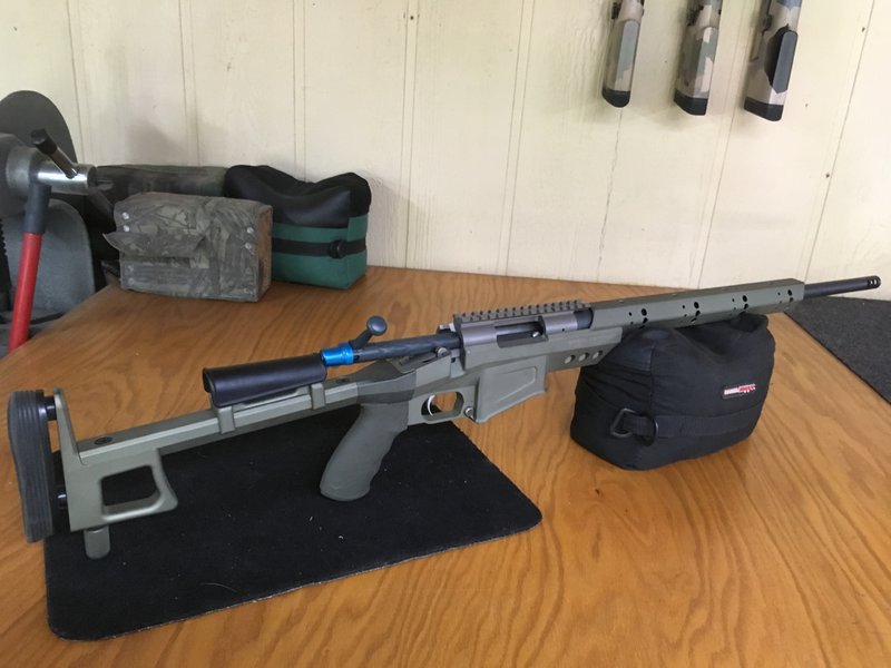

Here's a light weight 308win folder.
Wait times are 1 month for whole builds. 1-2 weeks tops for bed jobs, cerakote, brake installs, etc.
Bolt knobs are 1-4 days.
We've dropped some prices so be sure to check that out!
Thanks very much!
Keith Johns
