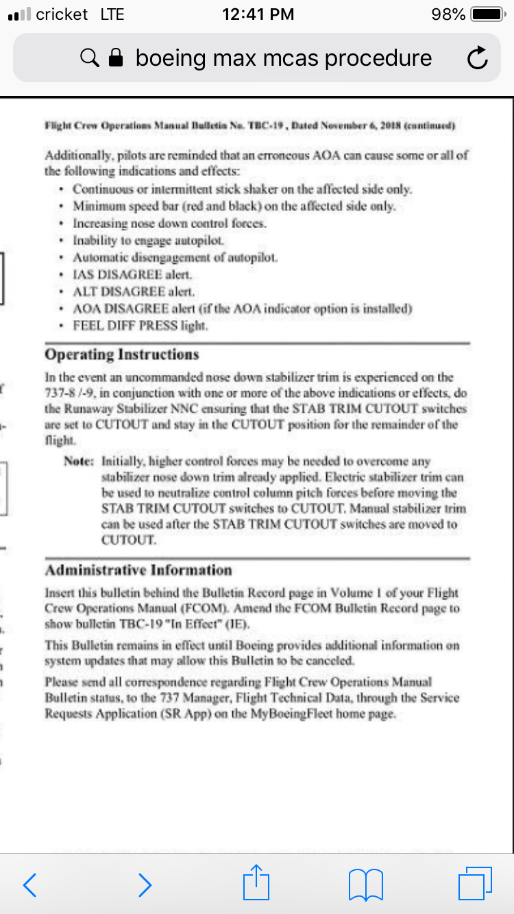

Boeing did release a procedure after the first crash .

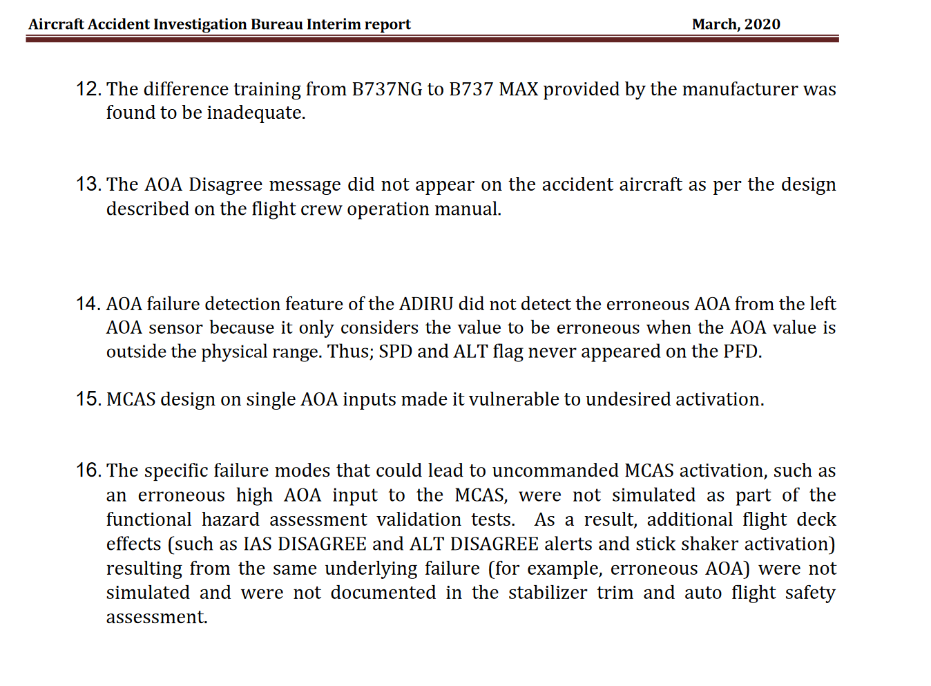

Also on Page 132 it appears the Investigators disagree with our forum warriors about pilot error causing the crash.

Failure to put and leave the stab trim cutout, in the cut out position. Is one.

Did you even read the same report?

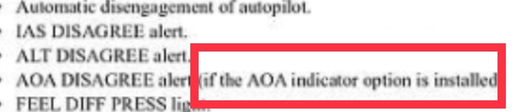

Both AOA indicators were installed but they never displayed the "Disagree" message as they were supposed to. (Finding #13).
Read page 14--phase 4 where they had the stab cutout as you describe. After 3 minutes, flight had stablized, they put them back in and MCAS activated again and crashed the plane 30s later.
If the pilots screwed up--where is it in the report? This is straight Boeing corporate line blaming the pilots before they got caught with their pants down.

I thought AA was the only airline that actually purchased the optional AoA Disagree comparator….at least that’s my memory from being told exactly that by a cog within APA.
If turning a system off stabilizes things… dafuq do you turn it back on for? Without SLOWING DOWN when you have a known flight control issue impacting pitch?
Boeing absolutely deserves blame for shitty engineering and insufficient FCOM/Systems information for training…but (non-extraordinary) flight crew action could have saved the aircraft.

I don’t believe these aircraft(edit- The ones that crashed ) were equipped with an aoa disagree /“idiot” light. It was an optional purchase. Yes I read what you posted. But from the research that I’ve done that’s what I find.
