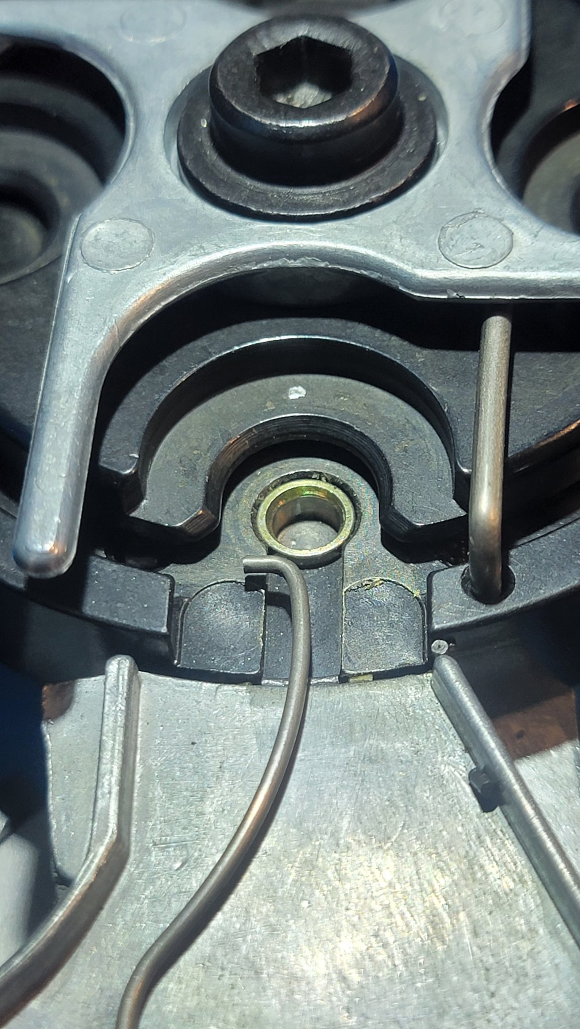

How hard are you pressing forward when you seat the primer? I push forward with a fair bit of force.
How much time is spent getting a good adjustment on the primer stem on your Dillon? Keeping them clean and adjusted is essential, plus a good consistent stroke on seating.
I never adjust anything on mine, I wouldn't exactly call it clean though I do wipe the decapping puke from off the lower portion of the press periodically. I do have a consistent priming stroke - push forward all the way, hard. Probably 30-40lbs of forward force on the handle. My press is rock-solid mounted on a strong mount on super sturdy bench, roller handle about chest high. I give it a good straight arm full body lean into the press to seat the primer.
I thought mine was good to go until I took it all apart and cleaned and readjusted everything. Lots of powder residue built up in places I didn't know existed.

I grab the back of the press frame with my left hand and push forward with my right; never had trouble seating primers deep enough that way.
OP - if you're applying enough force but still having trouble getting primers seated, you might need to clean the primer pockets. I don't normally do that for anything loaded on a Dillon, but multiple firings in a rifle case can leave enough residue to make primers sit high (or just require more force to seat them correctly).
Although my first guess is that you're probably just not pushing hard enough to seat the primers.

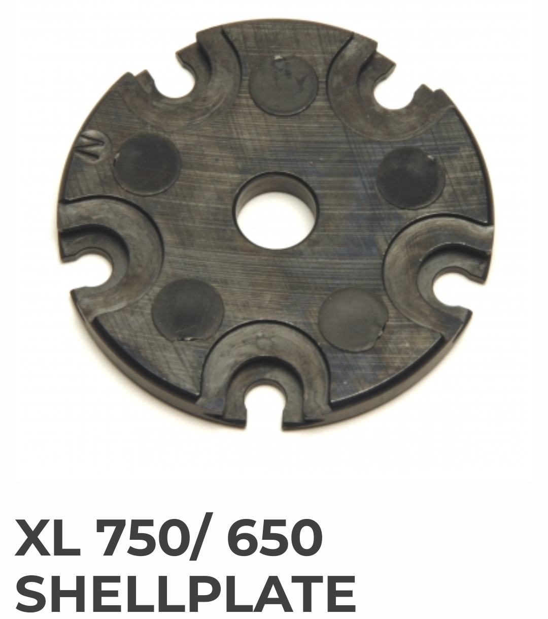

I also highly recommend polishing the bottom of your shell plates that smoothed and tightened my shell plates up considerably.

Can someone give me some pointers on honing the bottom of the shell plates? I bought some polishing paper (cant remember the grit, its whatever FC John recommends) for this, but I'm scared to do it. I cant find anyone giving an explanation on what to look for, how to know when to stop.
I haven't quite wrapped my head around honing, I get what to do but I'm not sure I see the value. I'd test it on a piece of glass (probably hone with that under the sand paper too) but just see if it rocks any direction. Wouldn't the head of the ram be the part you'd want flat? Maybe I'm missing something there.
I wet sanded 1500,2000, than 2500 on a price of glass. I went until the whole thing was almost mirror finish. You will see the high spots as you go as they will loose the finish first.
Before I honed the shellplate I would find certain plates would bind while spinning therefore would have to back the screw off to the point where there was quite a bit of play in the shellplate. After honing I was able to tighten them down more to reduce that “wobble”.
Wether it does anything for precision 🤷🏿‍♂️, but it probably took all of five minutes per shellplate.
thanks for that explanation. I might get brave and give it a shot this weekend.
That misses the point of honing the shell plate though. The intent is not just to polish it, as you did, but to actually remove material so that the cases in the shellplate are held tighter and don't wobble. Check out the article posted by Sheldon N earlier in the thread; it mentions removing .005-.015", which is a lot to remove by hand.
1500 grit doesn't do jack to remove any significant material by hand from a surface that large; you need to start with something much coarser. Finishing with fine grit like that is fine, although it doesn't have to be mirror polished to be smooth. You could even finish at 600 grit and it'll rotate smoothly with just a very thin film of lube (whether oil, grease, or dry). Personally I like dry teflon or moly spray.
Reactions: impactaddict
Your probably right but it definately smoothed out the surface I kept inspecting it and could see where certain parts would lose their finish before others which in my opinion would be the high points. I kept going until all finish was off and down to bare metal than polished.
Whatever I did was an improvement and I’m happy with it and I have no play in shellplate or brass so I’ll leave it at that.
For anyone else doing this, it's important to realize that doing this by hand on a piece of glass will wear some areas faster than others, specifically the leading and trailing edges as you move front and back or side to side. Because of that it's important to keep rotating the part in you hand, and try to keep pressure in the center as much as possible rather than on the edges.
