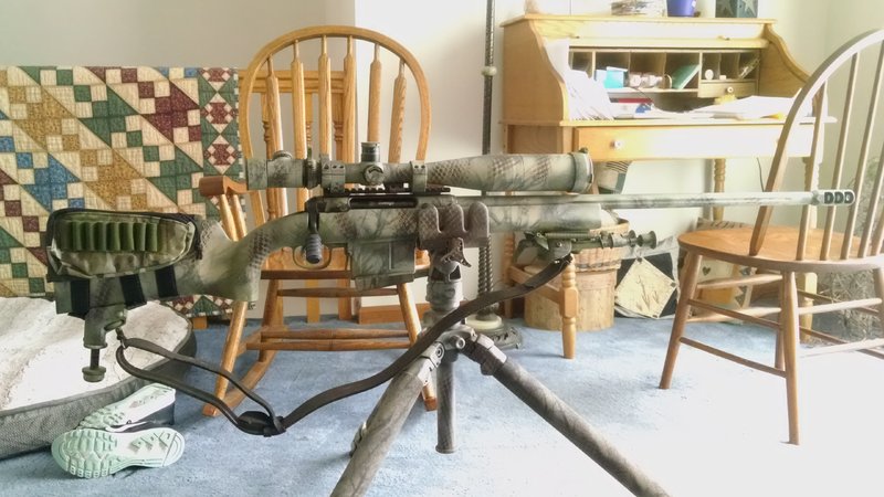

As stated above, rapid transition to different positions with a tripod doesn't happen. But with a good pan and tilt head you shouldn't have to. I use the Reaper Grip, and heavy Slik tripod for my .338 LM. Very smooth tracking, and solid lock up. IMG_20170108_132519245.jpg
