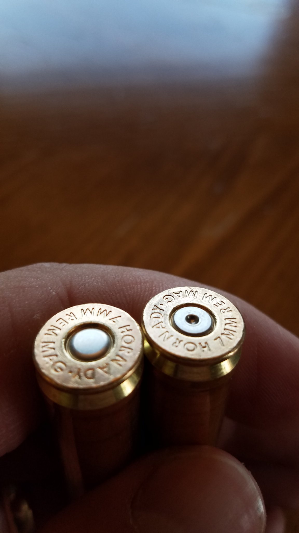

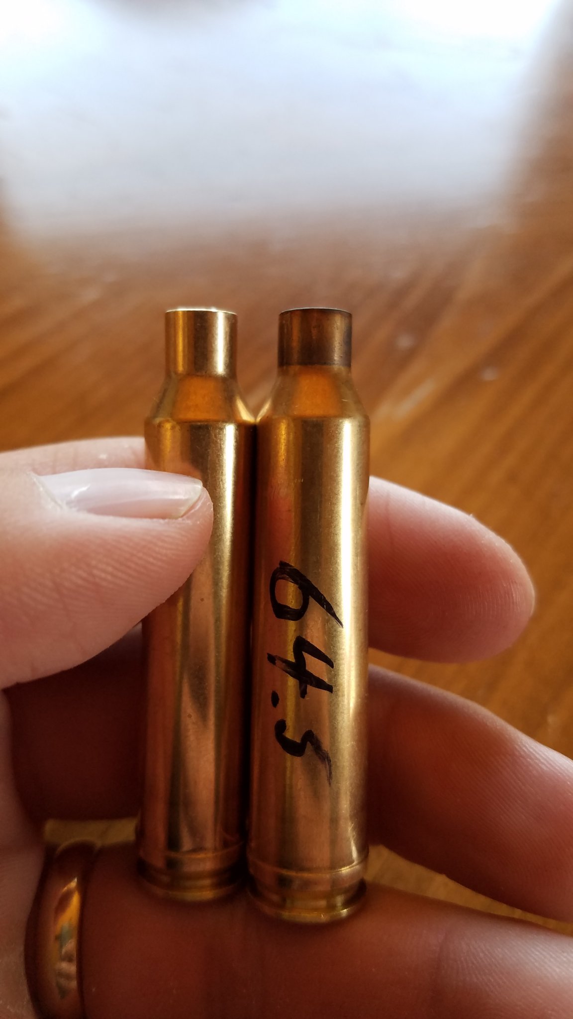

So I've been reading through but it seems like some mixed ideas on what's serious. I've started load development on a 7 mag, and I made the mistake of using hornady brass and it seems like its giving me indicators out the wazoo...
I'm using 162gr eldx & H4831, not ideal, but I was hoping to get me to 2900fps but even down at 2825 I'm getting ejector marks. I pushed it close to my goal but I'm not really liking what I'm seeing. Do I just back it off more or should I try a powder better suited? Say H1000?
Also how do I stop the carbon build up on the neck? Even at my starting load I had this problem.
Isn't the carbon buildup on fired necks just an unavoidable consequence of neck clearance, and that the carbon residue makes its way onto the outside of the necks before the neck expands and "seals" the chamber?
This^^^ carbon on the necks indicates sealoff points. Now if carbon makes it's way to the shoulder, now you have issues because buildup here messes with your headspace.

I was more just curious about carbon residue on the necks and if there were any guidelines/rules of thumb/methods as to how far down the neck the residue should go, or if any specific practices can reduce this buildup, or if it is pretty much guaranteed.
Lol, I knew you didn't bump it, I just stated your advice was correct. In the sequence of firing, gas takes the path of least resistance, it's coming back at you, the neck sealing off prevents us from getting a face full. That is why neck clearance in a chamber is important, too much no good, too little and you have pressure.
