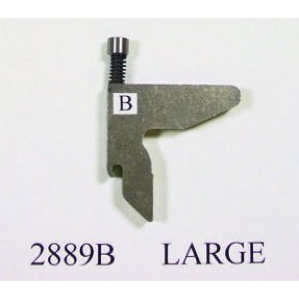

For the Lee you have to put the primmer part (not sure the name)in the press even if you don't prime your sells that way (*pic at bottom). When you pull the ram down the primer moves out of the ram thus letting the spent primer fall and hit it then it gets pushed out the other side of the ram (small whole) into the catch. I didn't use it at first since I wasn't priming on my press and learned the hard way with a mess on the floor. Now I would bet I lose 1 per 250 to the floor. This little part is somewhat annoying in that it rocks in and out but I only put it in the press when I use the universal deprimer and do a bunch of brass at once.

Thanks for the tip smokinace. I'm ordering one of those priming pieces for my press to see if that solves the problem. I would much rather just do that than have to pay for a different press, new die holders, not to mention reset all my dies after changing die holders. I'm gonna cross my fingers that it works.
