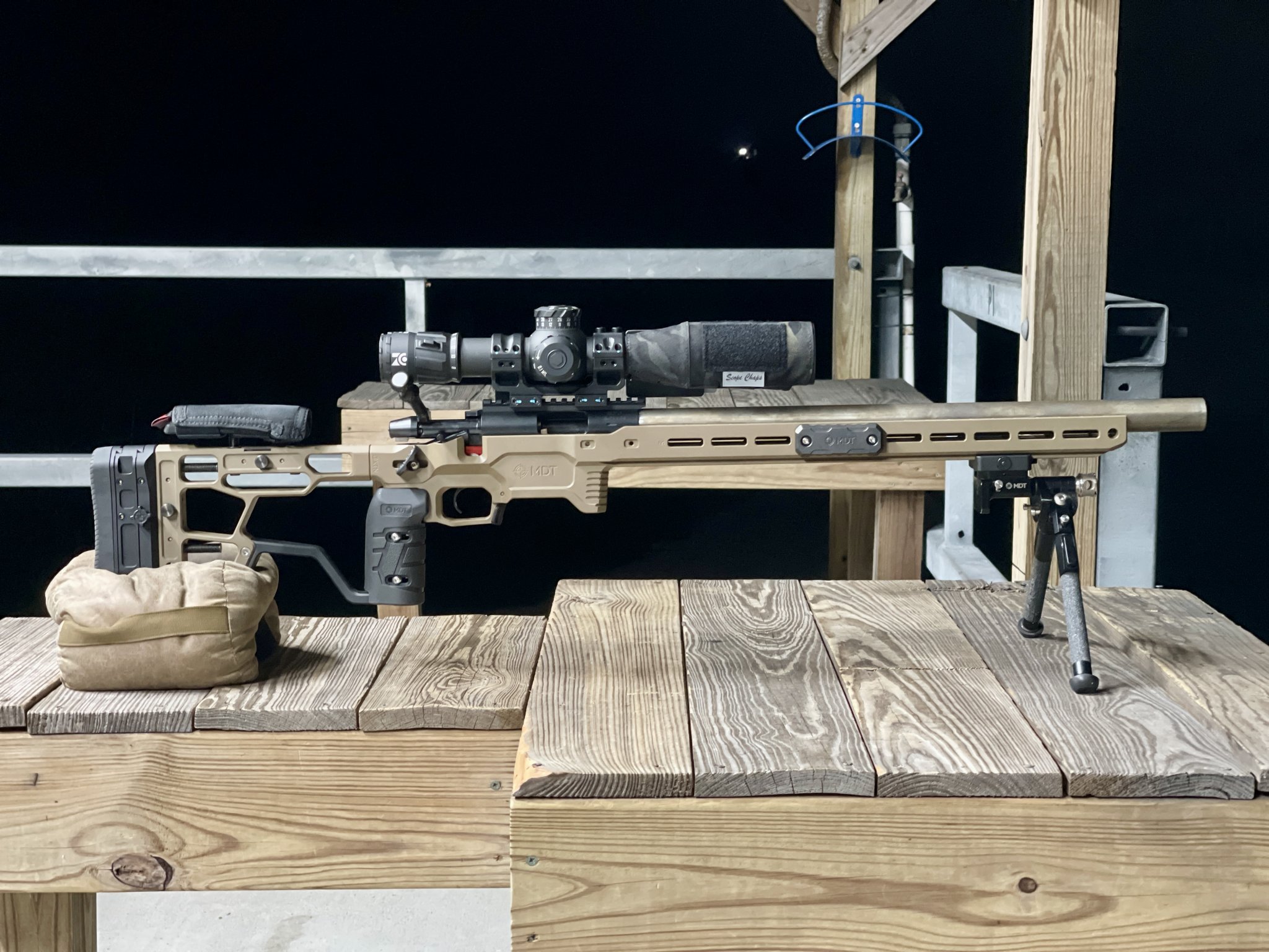

I know this isn’t a Vudoo or an MTU barrel but it’s a 1.2” straight finished at 22”.
Installed in the chassis with no weights added and with a bipod attached it will balance a few inches in front of the mag well. The weight is 19 pounds 11 oz. Take the bipod off and it’ll get just a teeny tiny bit rear heavy. Still not bad.
I threw in a set of internal weights and a pair of external weights and it balances with and without a bipod about 2-3 inches in front of the mag well. The rifle is now 23 pounds and 5 oz. It’s around 21 and some change without the bipod.

Thanks for the info. Do you think if you went with a 24” barrel it would have balanced at the mag well without weights?
Without a bipod I’m sure it’ll be good to go. The ass end on the Elite is heavy. However barrel profile might still matter.

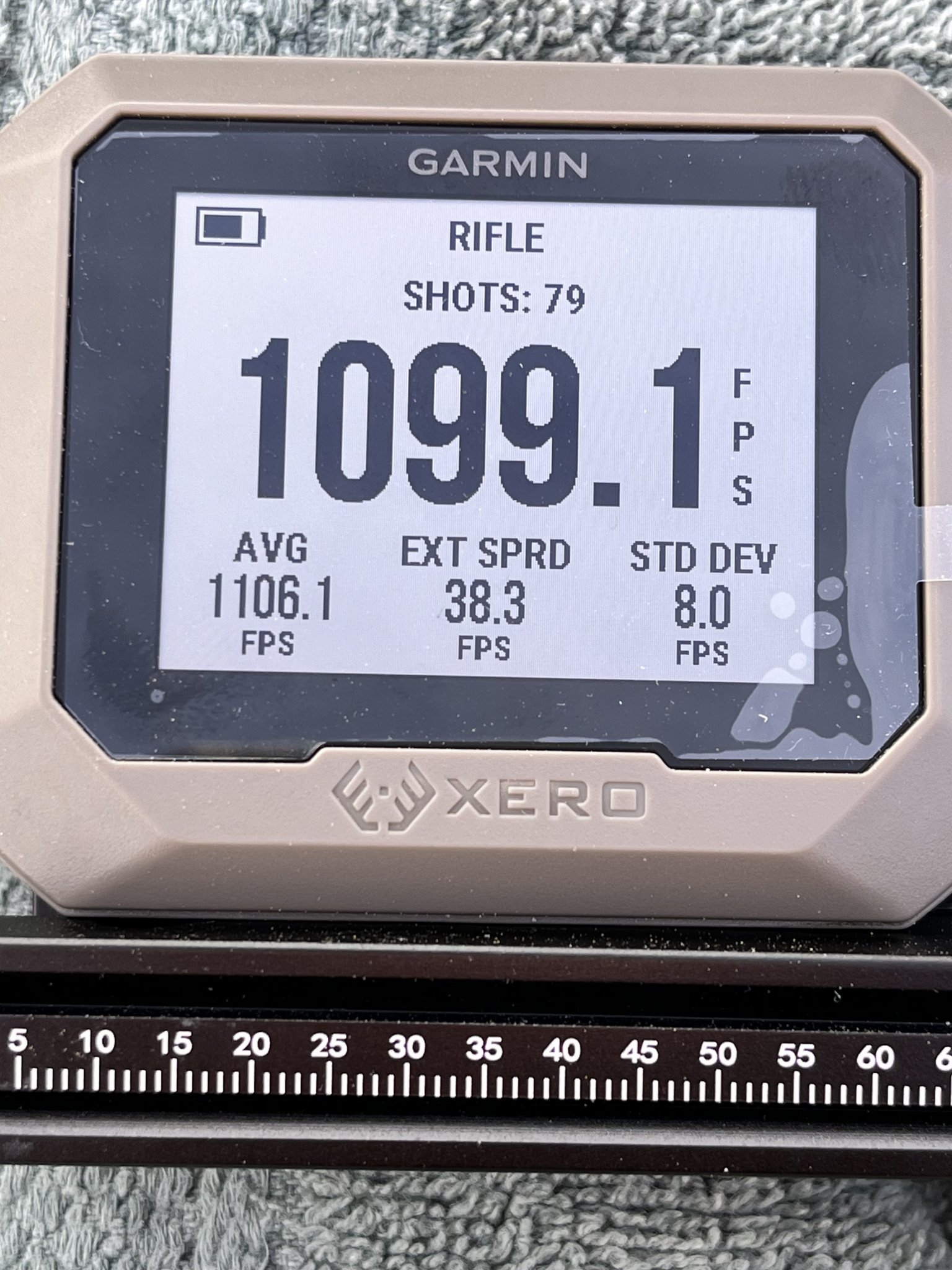

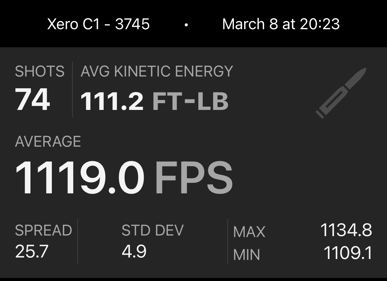

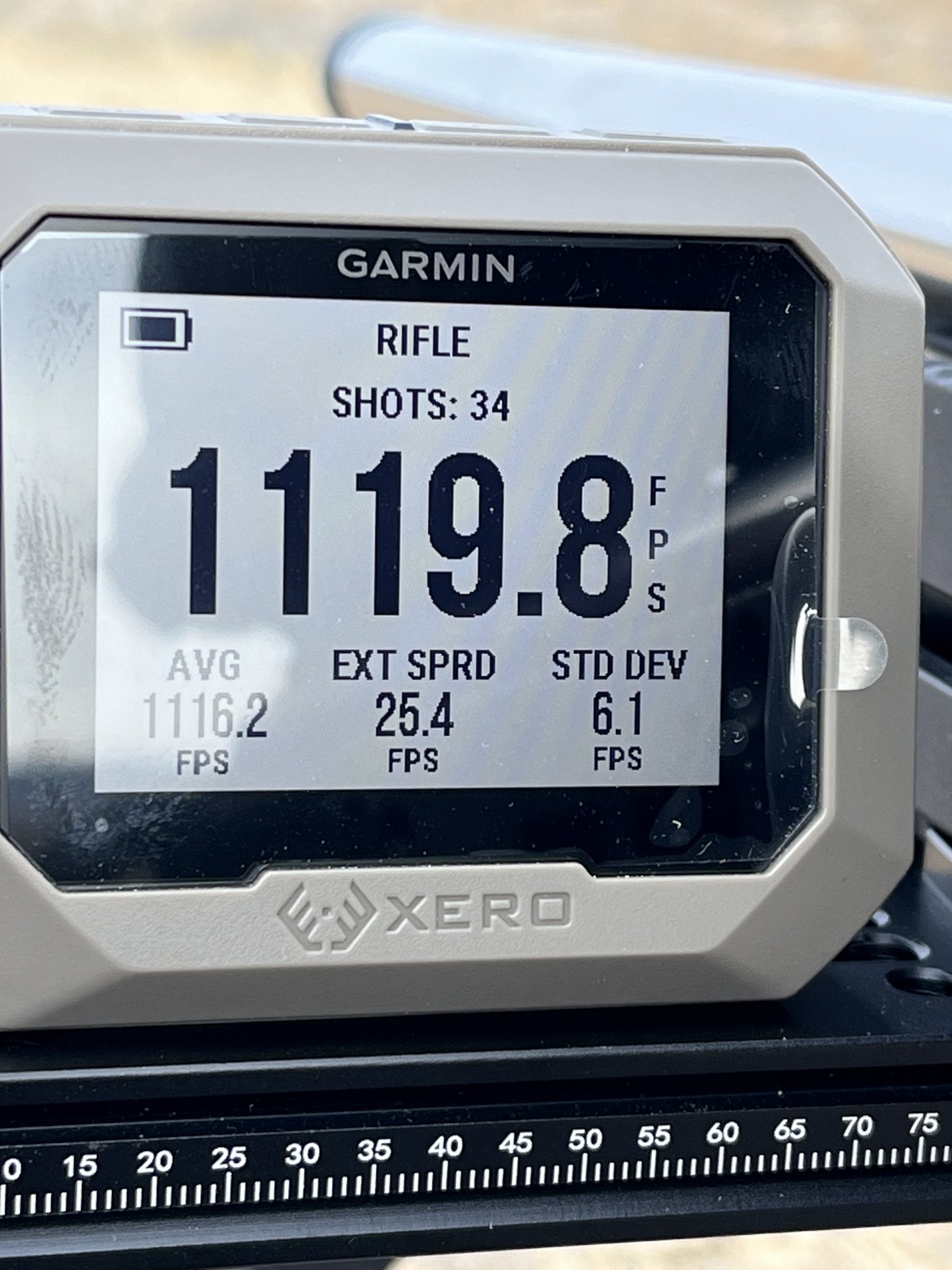

Videos are good resource but as mentioned you need to look at the dates. You will not be losing any substantial velocity with the 24" barrel. I have the same lot of SK Long Range and it's 1106fps in my 22" and 1100 in my 23" and both shoot it very accurately. A few feet per second. So don't stress the length and pic the contour you want and get it ordered.
I have noticed the same thing @Birddog6424 mentions with the SD's...I've ran 16" out to 24" barrels and the longer barrels seem to always produce a little better SD's...I had a CZ 455 trainer in a manners stock years ago, it came with a 24" barrel so I bought 16" and 20" barrels to see which shot the best...they all shot great but the 24" shot just a little better and the SD's were just a bit lower.
These are from my 22" Bartlein Vudoo...the 79 shots was actually 80 shots and was 40 rounds RWS 50 and 40 rounds SK long range match....34 shots were all RWS 50 and was actually 40 shots, missed 6 due to me moving around to much....personally I think a longer barrel produces better SD's.
But my 24" Bartlein barrel is a hair better in the accuracy department, as well as producing better SDs. It isn't world's better than the other two, but good enough that it's the length I'll continue to buy.
