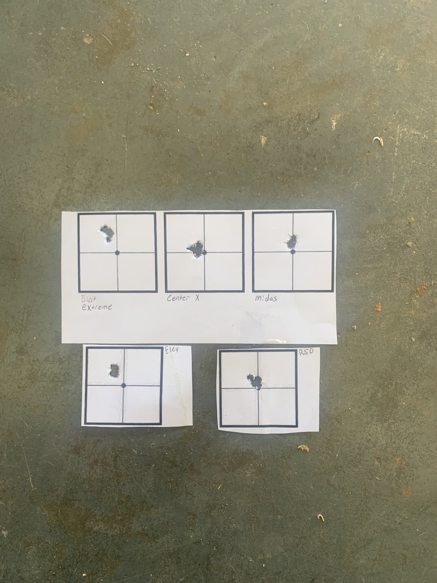

The only way I do much different is if it’s for sure an Eley only chamber. Most people don’t want to be tied down to that though. I ask for that purpose and to know what is best pertinent to test with on the particular rifle.
If you see a 22LR-B after the logo engraving that is the designation for my newest bored reamerless chamber. I’ve tested it for a long time and went into production last quarter of ‘23. There are different dimensions depending on the barrel and purpose.
If done properly typically good ammo will shoot whether Lapua, Eley, or RWS. I have people using all of those. This was a fun one where the customer sent in a bunch of different kinds of ammo to see if anything he had would shoot in it. I think he’s mainly shooting R50 and Eley Team in it now.

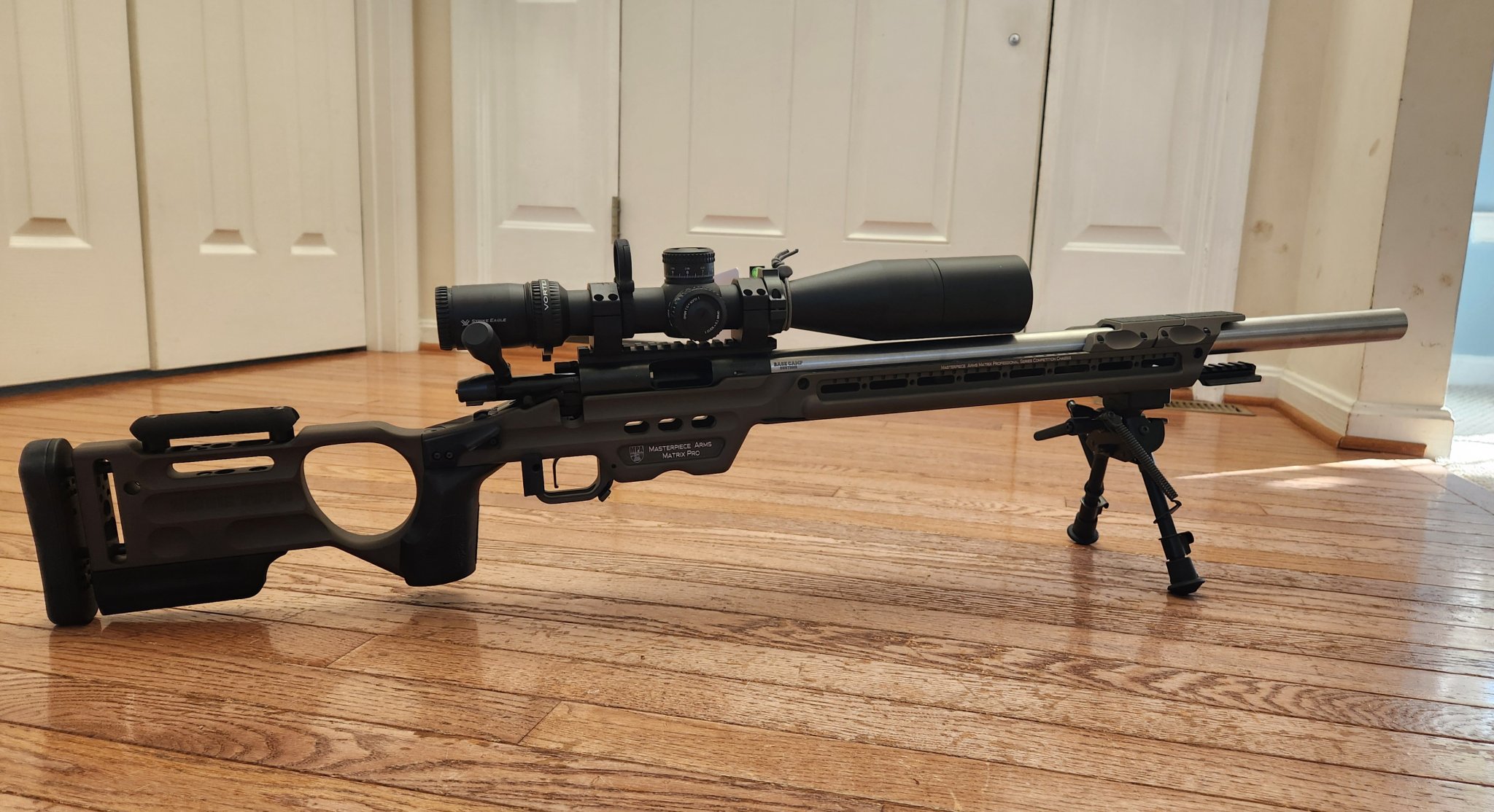

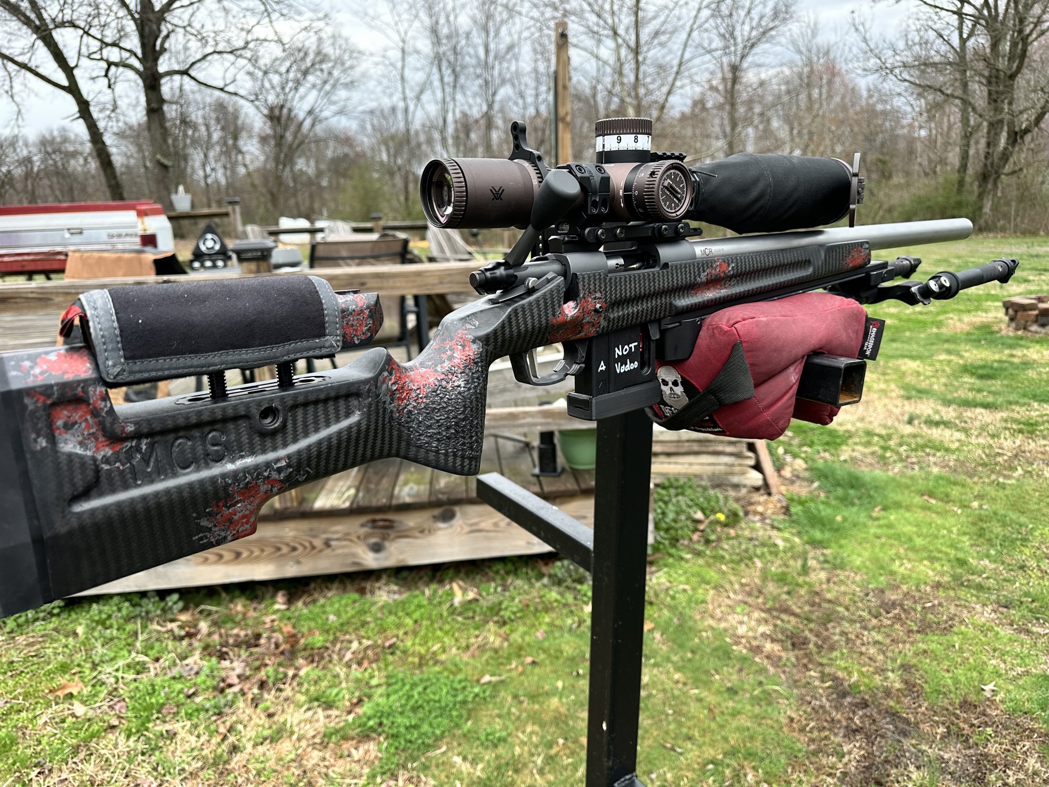

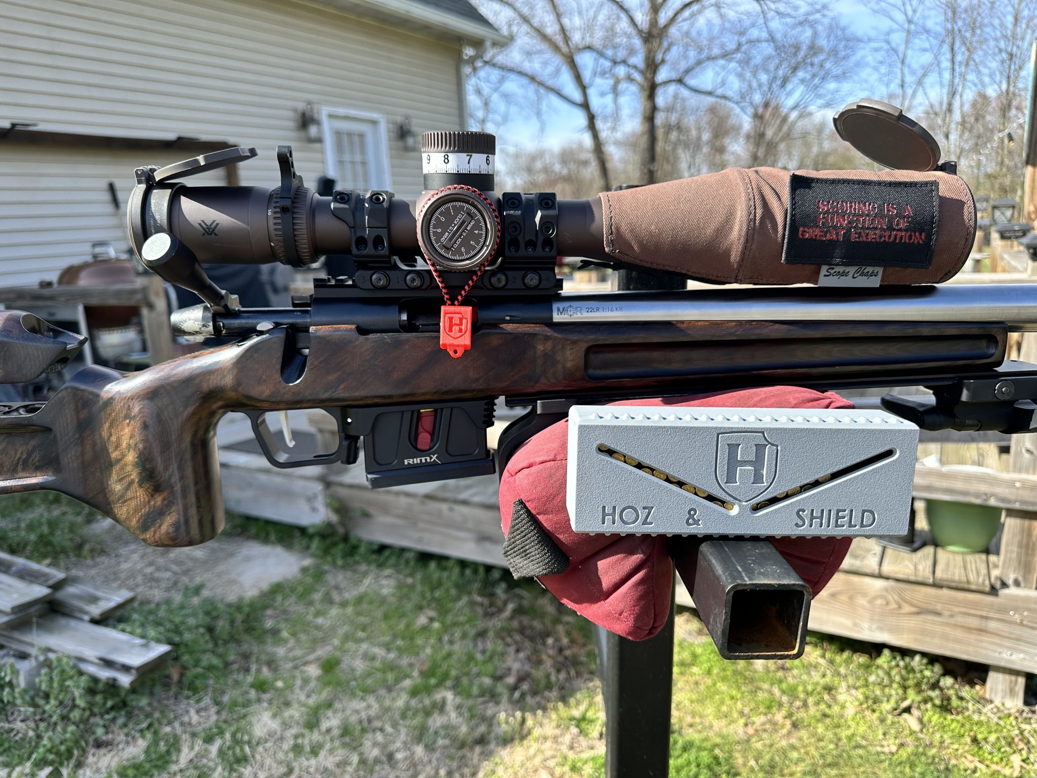

I have 2 @jelrod1 Built rifles now. I is a RimX in a Foundation Stock, 23.5" 1.25" Krieger 16t barrel and Gen1 EC Tuner. It hammers with Eley, RWS R50, Norma Match and SK/ Lapua. Buy a case and adjust the tune. You are good to go till next case is needed.
2nd Rifle is a Remington 40X Conversion with a Mullerworks 16T 24" 1-1/8" Barrel. It will shoot all ammo's as well. It is just a finished crown no tuner. I have 5 different lots of ammo and at 50y it is all 1/2" groups or better for 10 rounds. As of today it has 400 rounds down the barrel and the numbers seem to be settling down. It was had lapped by Paul Tolvastod prior to MCR spinning it up.
Pictures of rifles at balance points. no weights are used in any stock. The 40X in the Manners does need a bipod up front to balance out properly. I can swap stocks with it and it is not needed.
Johnathan & Modacam Custom Rifles have another RimX on the bench for me to do this year. it is getting a 13T Mullerworks and Gen1 EC Tuner.

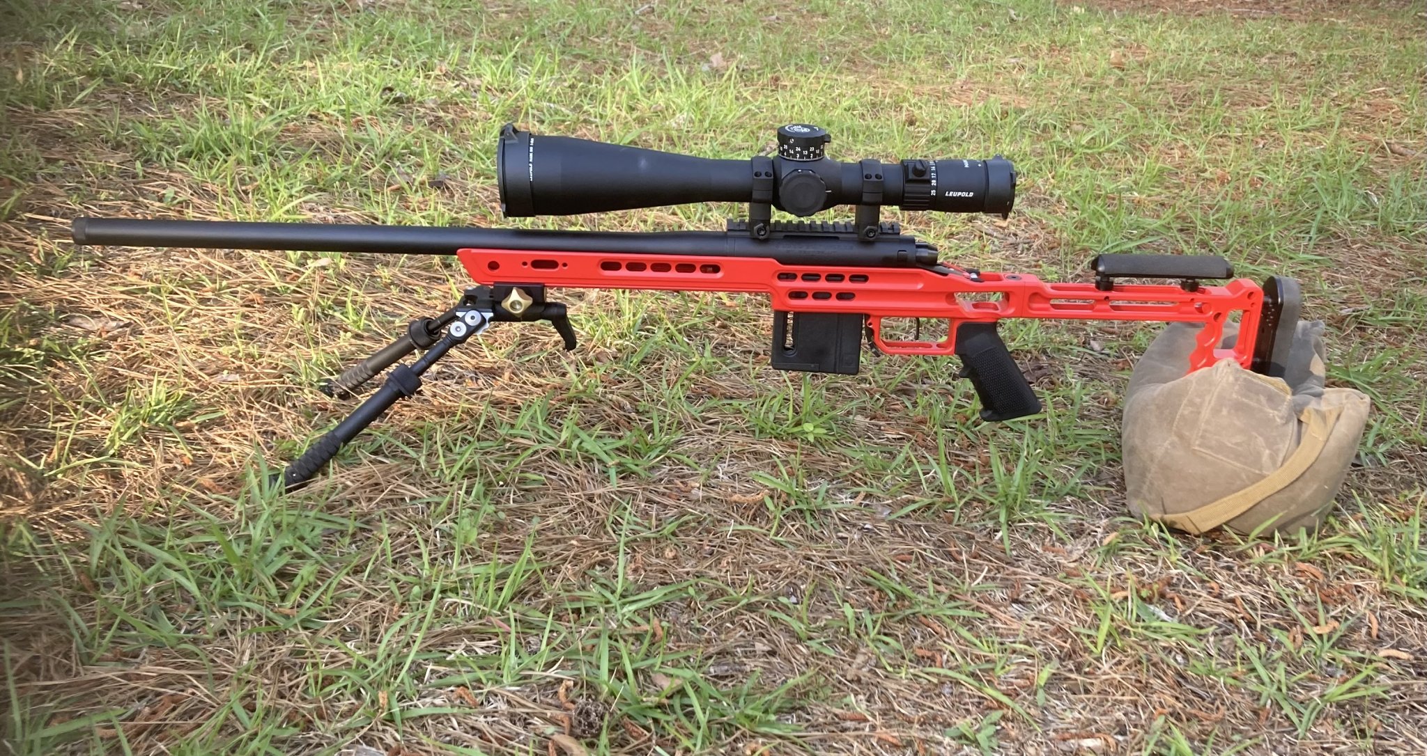

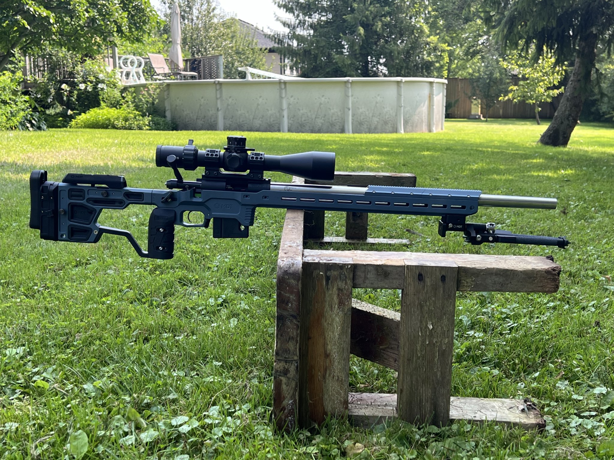

Well it took a good while but I finally received everything and had my local smith work his magic. This pic is as it is in its current configuration. I need to play with the weights to see if I can get the balance point further back towards the mag well. I was a little shocked at how heavy it is at 22lbs 2oz. It’s got all 5 weights in the for-end and I’m going to try to see how it balances without one of them.

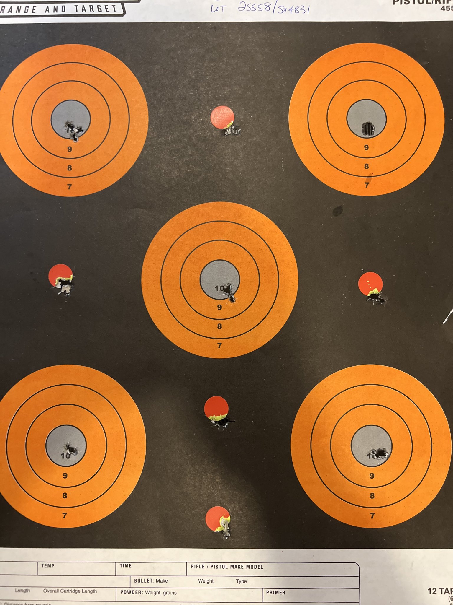

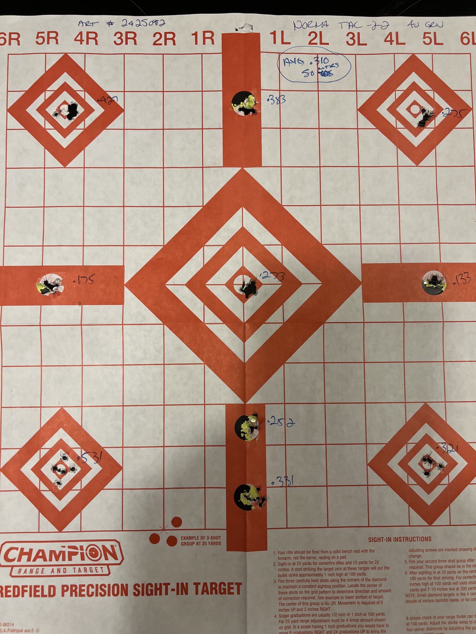

I ordered an ammo sampler pack which arrived yesterday. Took it to the range and started testing different brands of ammo. 7 brands to be exact. I shot 10 groups with 5 rounds per group for a total of 50 rounds per brand. Then used my calipers to determine who had the best groups.
Here are my results in order of best to worst….
Ammo test at 50 meters based on 10 5 shot groups
Lapua Center X .233”
Norma Tac .310”
SK Standard Plus .312”
SK Long Range Match .365”
SK Rifle Match .366”
Eley Tenex .370”
Eley Force .512”
I was surprised that Norma Tac performed as well as it did. Pretty much as good as SK Standard Plus.
I’ll attach a couple pictures of my two best targets. The black target is the Lapua Center X and the white target is the Norma Tac.

Not at all to be negative, but I recommend basing your ammunition decision on 10-round groups. I have seen a whole lot of single hole 5-round group ammo that opens up significantly when upped to 10-round groups. As most stages will be 10 rounds, performance through the string matters.
I try to let my barrel cool for 10 minutes or so between groups, and I will push 10 "fouling/seasoning" rounds through before evaluating a different type or lot. Takes a lot of time, but gives me better data on when it comes to making a significant quantity purchase.
Not trying to derail the topic, just some advice I wish I had when I started.
Reactions: Mark_Dorman
Thanks for the advice. Wish I had it a bit sooner 🙄. Ammo purchased already. Hopefully it works out.

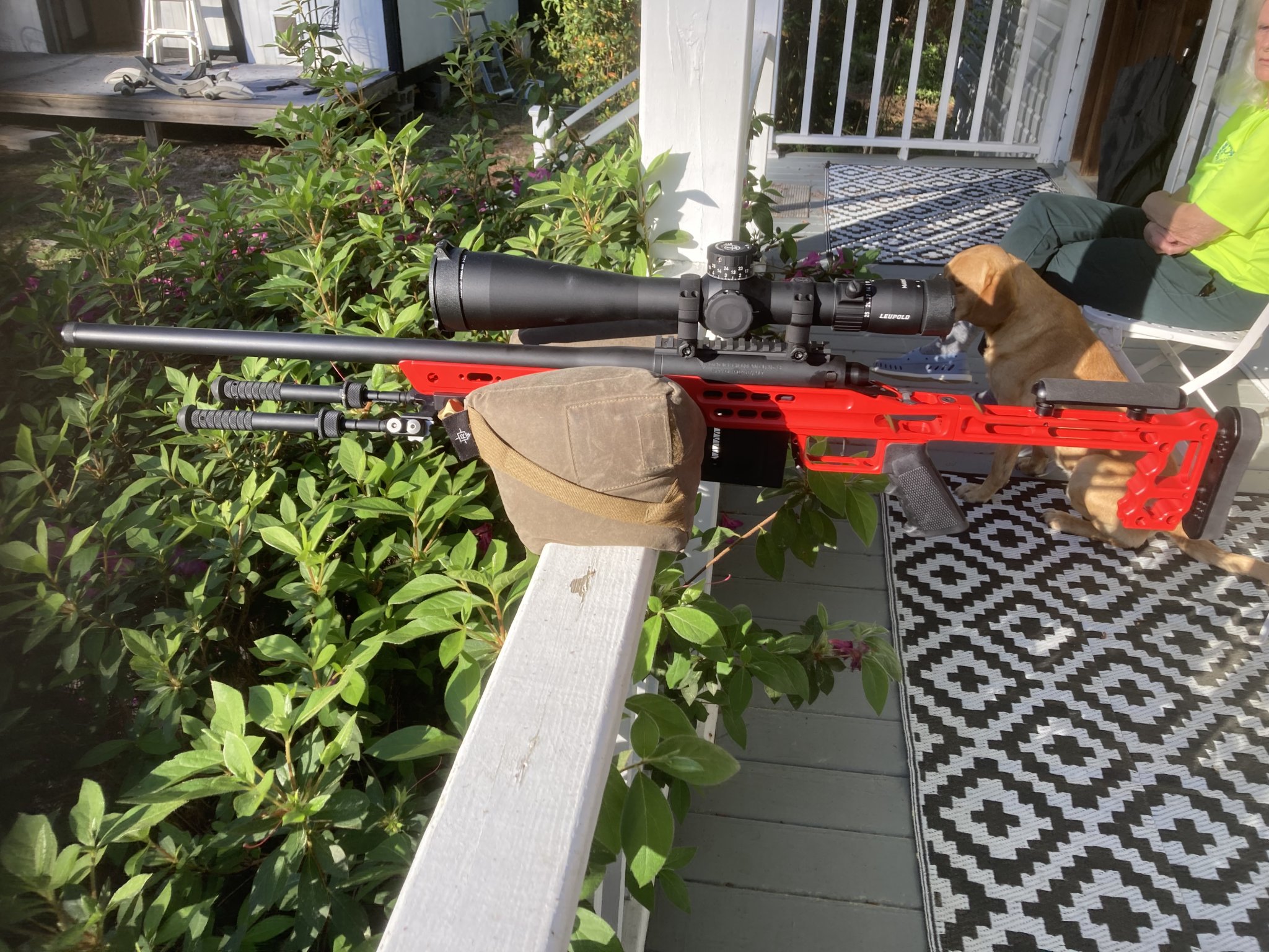

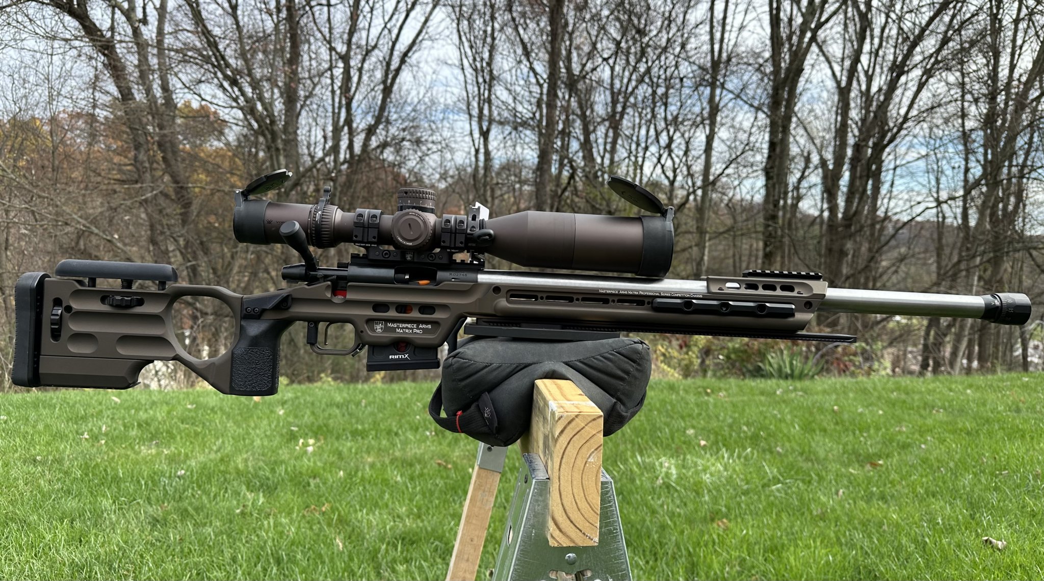

I’m really late, but here’s my direction. I was under “direct” orders from my doctor and my wife to get a lighter rifle. (Shoulder, knee and entire left side bone and joint concerned giving it up)
Still I wanted something that would balance. So, I went with a Kric barrel at 22 inches and an ultra light MPA chassis. I have a straight grip for it but undecided as to whether I want to install it.
The little rifle almost balances perfectly and with the suppressor which I planned to use locally it balances.
Note, it’s happiest with the Armageddon Gear Gamechanger Pint sized bag with sone fill removed. That is an issue with the chassis and the bipod. Stuff just does not fit, because of the shorter length of the fore-end. Really wanted to use my mini plate, which would work, except I have to remove the bipod, which with the 419 adapter, is not an issue EXCEPT, it no longer balances.
Adding weight is Not An Option. Great little rifle, shoots the lights out.
View attachment 8481384View attachment 8481388
Nice rig. IMO and experience the majority of the premium .22 ammo is pretty damn close in quality and performance. In the end its the driver that determines the performance and outcome.
Looks great! I was so close to getting that chassis
Thank you! It's a little different to get used to, but the all of the adjustability options are impressive. I'm very happy I went with this option--and very grateful to a friend who gave me a discount cert to use on the purchase. The chassis balances perfectly with no additional weight.
What’s the overall weight?
