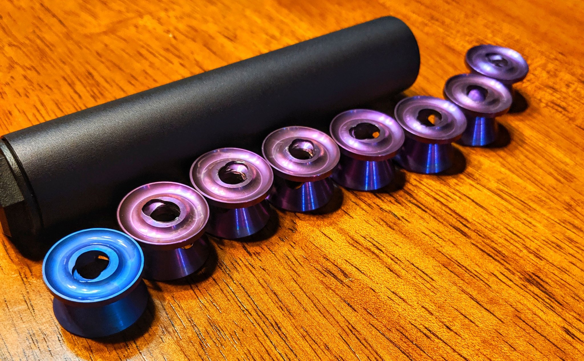

I got my new baffle while I was in Florida and finished it up tonight. I’m hoping to get out and shoot this weekend.

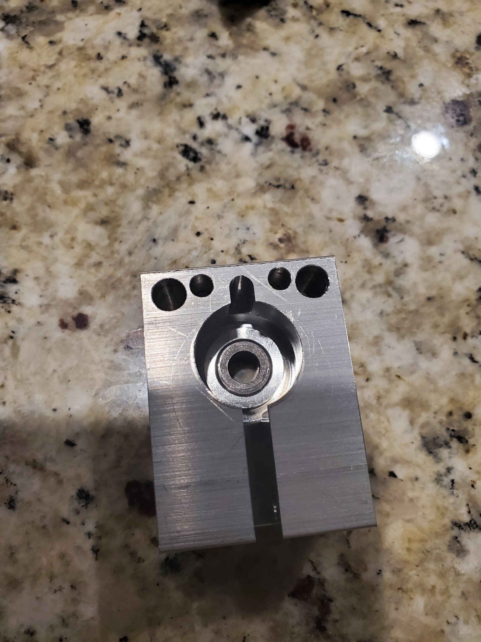

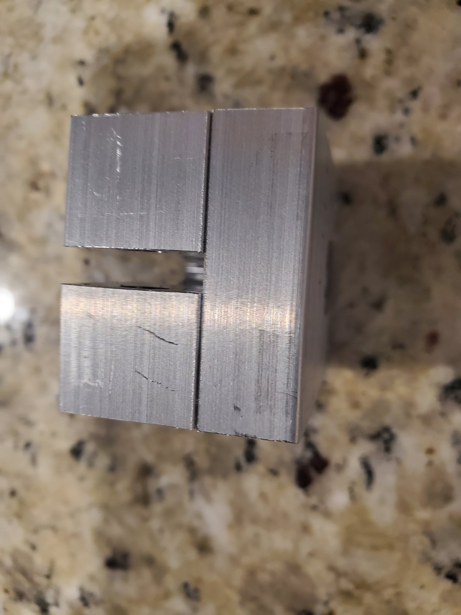

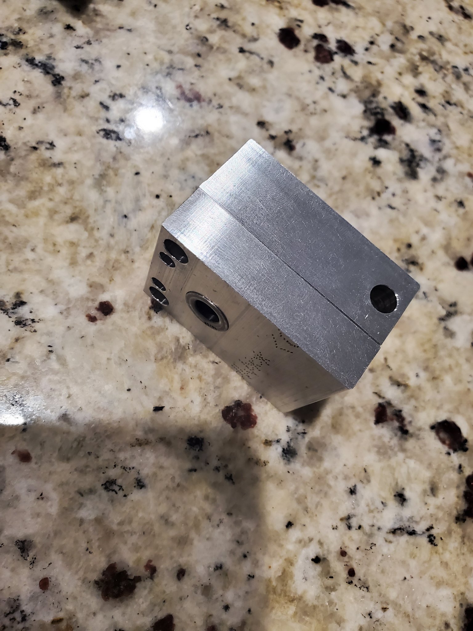

So I'm watching the video on the website for the 22 drill fixture and he mentions the fixture is two pieces. I'm looking at mine and it is only one piece. There is a line scored around the entire fixture but it is superficial and the halves don't separate. Did they change the design? I can't see the back side of his fixture in the video to see if it looks like mine would.
@padom
They seperate, try harder. I can see the pins that the top piece slides onto in your pics. Those 2 bigger holes are what bolt.the top to.the bottom...

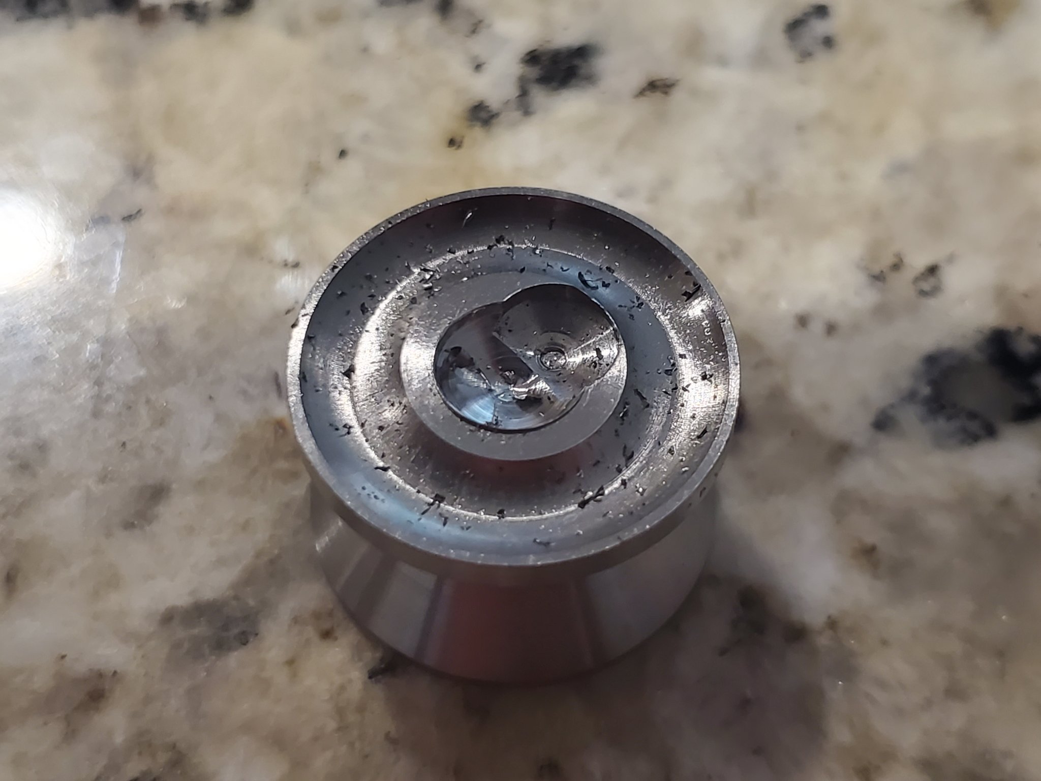

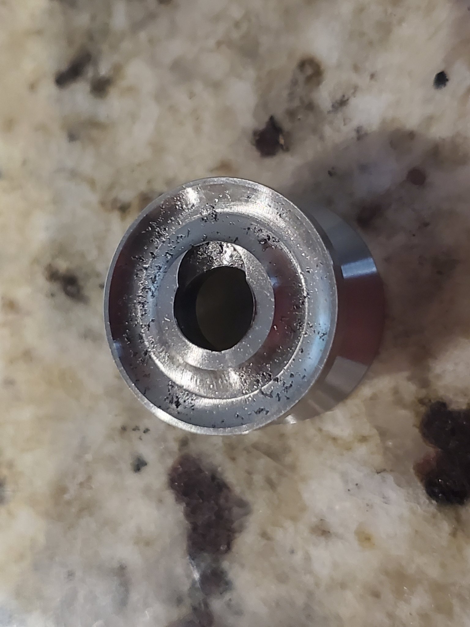

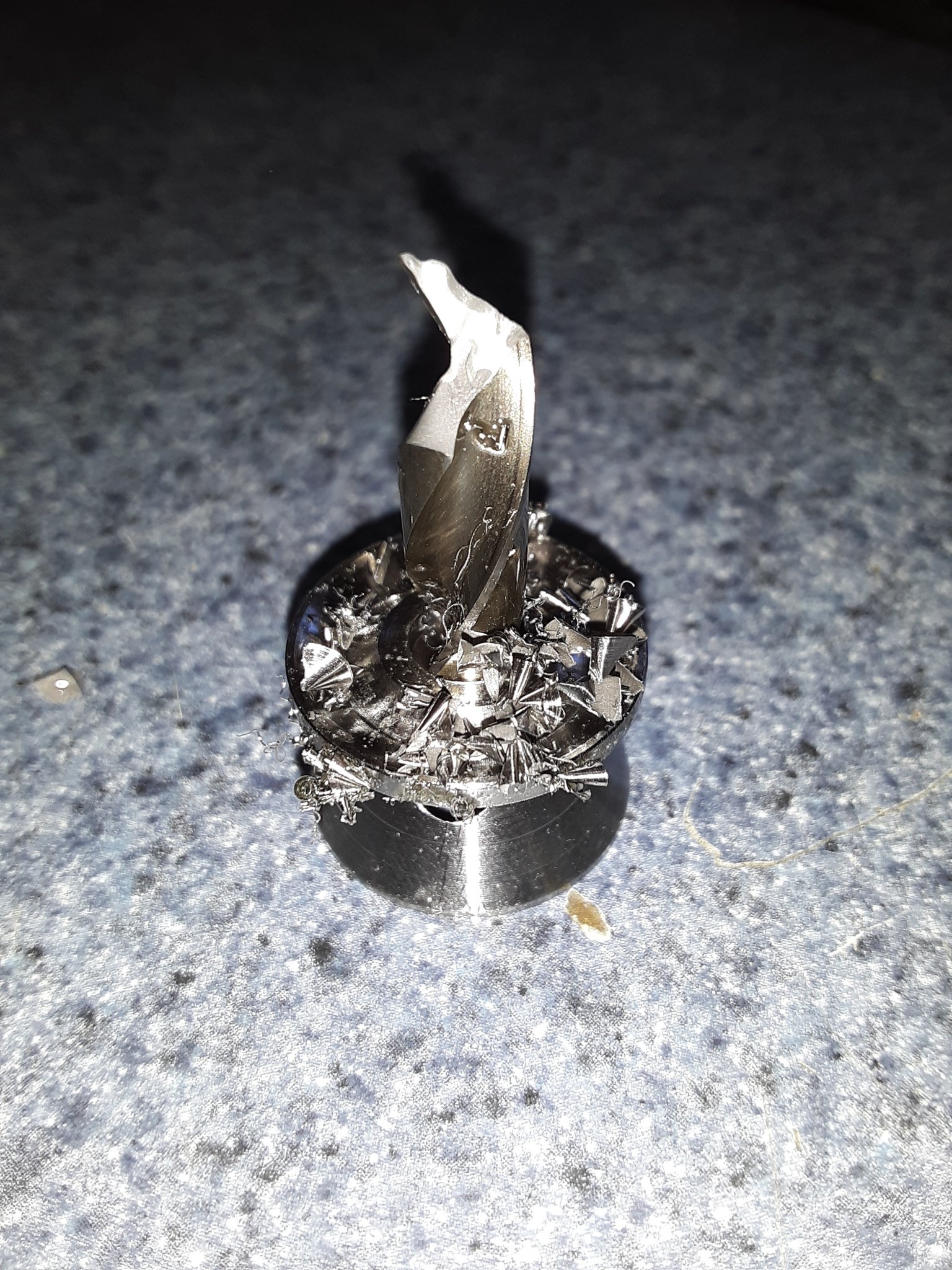

Got them separated but it took quite a bit of force. These titanium cups are crazy hard to drill. Lubed well, tried slow...fast...took over five minutes to do the first cup and my drill bit snapped on the second.
Yeah, it took me about an hour to drill all mine out. The bit tends to grab as it breaks through the cup. It chipped one of my flutes on the last cup. Those short 9/32" cobalt bits are ~$10.50 at McMaster.
I drilled out multiple kits now and have had no such issue... slow, firm pressure and using a pecking technique, tap magic applied to top of cup and tip of bit initially and a squirt between each peck...zero issues.. jig secured in my vice and bit in my Milwaukee M18 Fuel. you're having a tough time over there.

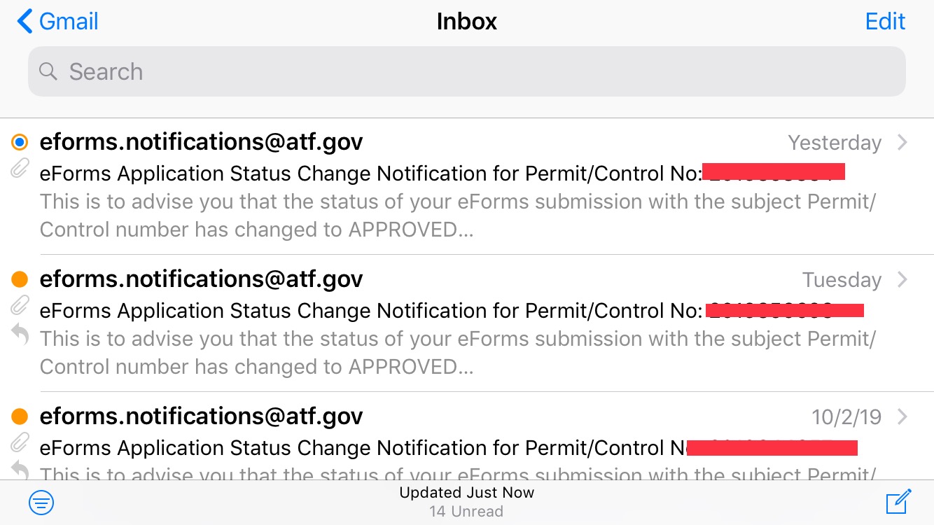

The pain of waiting almost a month for something you want so bad and then getting approval but being stuck overseas for the next two weeks. These two were submitted on 9/15 and 9/17.
  • Sad
Reactions: Geno C.
My Form1 was approved and I finished my can.

I'm thinking I got a bad bit. The new one came today and it is working way better than the bit that broke.
You want to make sure you don’t heat up the Ti. Push firm and get metal removal. If you have lube and a sturdy machine keep going. If you have a drill press or hand drill just peck it repeatedly. If you have the bit touching and not cutting you are making things hard on yourself. It’s easy to go light on pressure and scrape the bit on the surface which dulls the bit and heats/hardens the Ti.

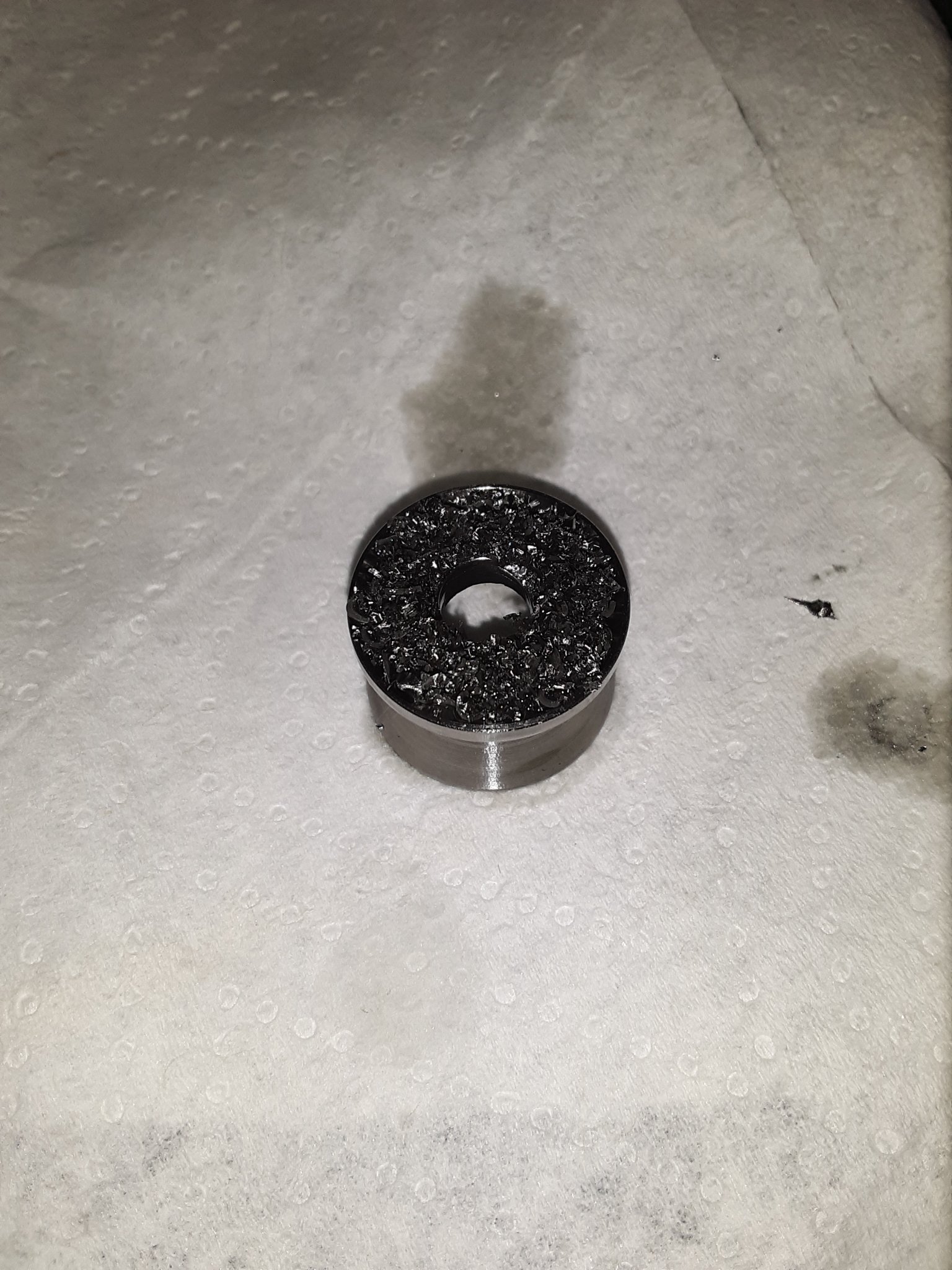

I also had some trouble drilling the Ti 22lr baffles. I was using the jig, a cordless drill, the included bit, and Tap Magic.
On the very first baffle, the bit caught a little when breaking through the cup, and snapped.
After much cursing, I went to the local hardware store and purchased a Milwaukee 9/32 cobalt bit. I was able to finish all 8 baffles with that bit, but it took a loooong time.
IMO: The drill bit that is included in the kit seems like it's a little too aggressive. It cut very quickly, generating big curls of Ti, which seems good until it catches and snaps.
The Milwaukee bit I replaced it with cut very slowly. Even with a lot more downward pressure than I used with the original bit, it would only cut little flecks of Ti.
I bet it took over 2 hours to drill those 8 baffles. Luckily I had some rifles to clean, so I would run it until it started to heat up, then pull out and let it cool off, do some rifle cleaning, then go back to drilling.
The included bit is probably just fine if you have a drill press, where you can keep consistent speed, pressure, and angle on the bit, but if you're going to use a cordless, I would recommend getting a backup 9/32 bit. I was thinking it would have worked great for me to use the original bit to drill most of the way, and then switch to the Milwaukee bit to do the breakthrough.
