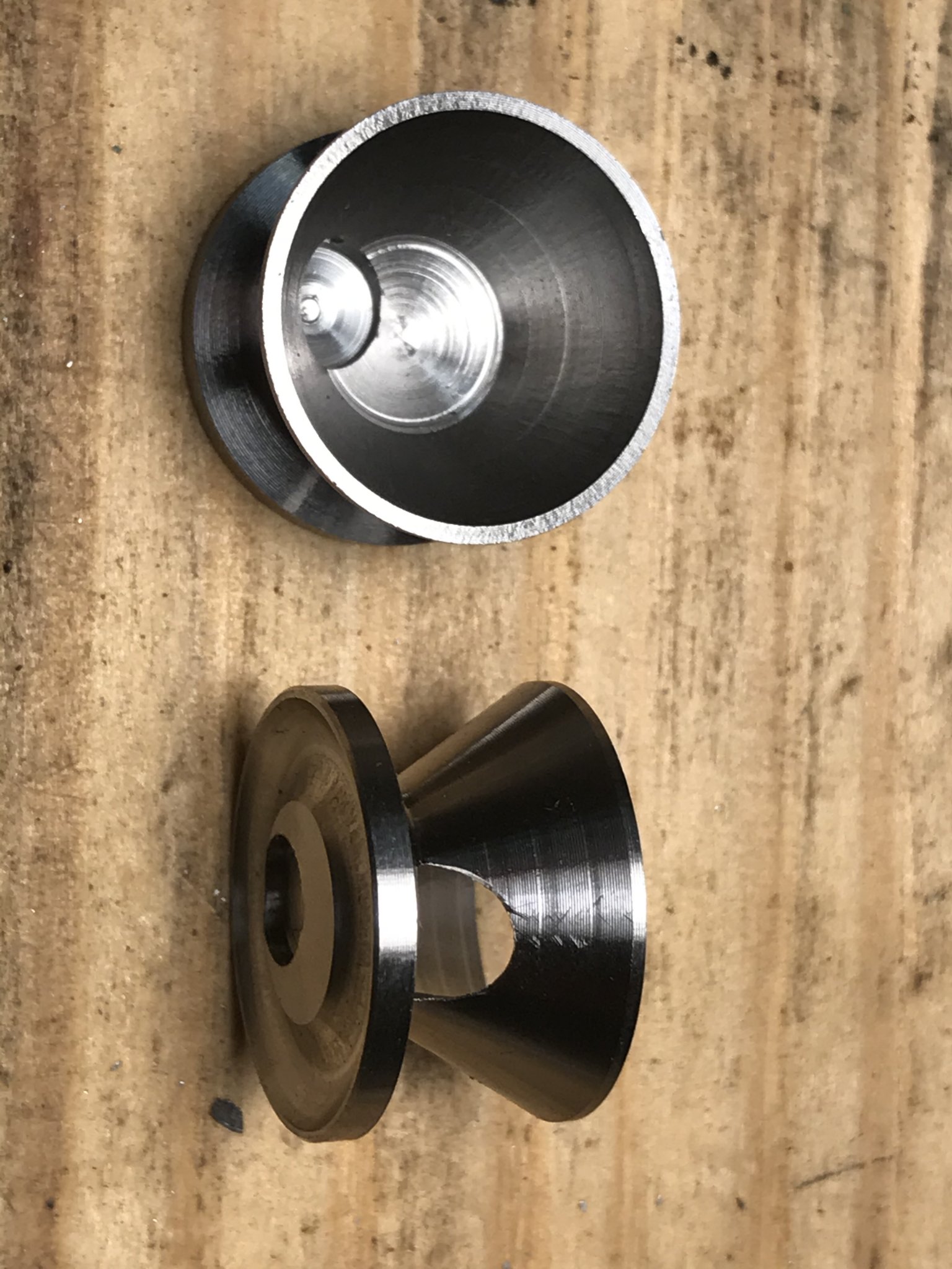

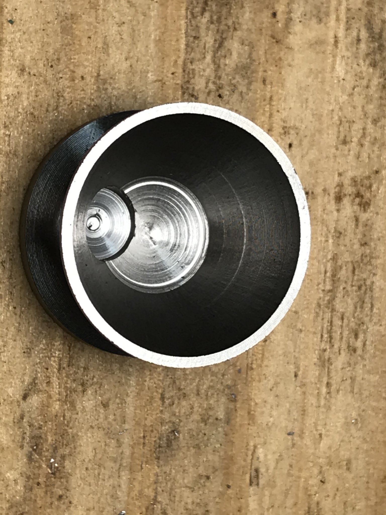

Here are some pics I took at the maker today.
New 5.56/30 SS Cups Both drilled and un-drilled so you can see how they look finished. They are working on a jig for these as well.
New 45cal Cups in AL just for testing. Testing cups vs K cups and double clipped. We have the K cups as well in SS. If sound is equal or better than the factory K cups we will make all the pistol cups in this Cup style vs k style. They are easier to make and my factory Rugged Obsidian 45 uses the cup design so I know it works...
I'd be down for some 9mm stainless cups, esp if it means I could possible run 300blk.
Problem is I believe they are different size cups vs the 45. I havent had any interest for 9mm cups but if we have 10 people that want them we can do those too. Do me a favor and measure the od at the back of the cup and tell me that measurement.
I'm showing 1.1125"
I believe you said before that these have nothing to do with QB? So do you have an O.D. measurement on the cups/spacers so we can match fit to another manufacturer's tube if we want to with Ti? By the way, your work and information is much appreciated!
Correct.
45cal cups = 1.23"
5.56/30 cups = 1.31"

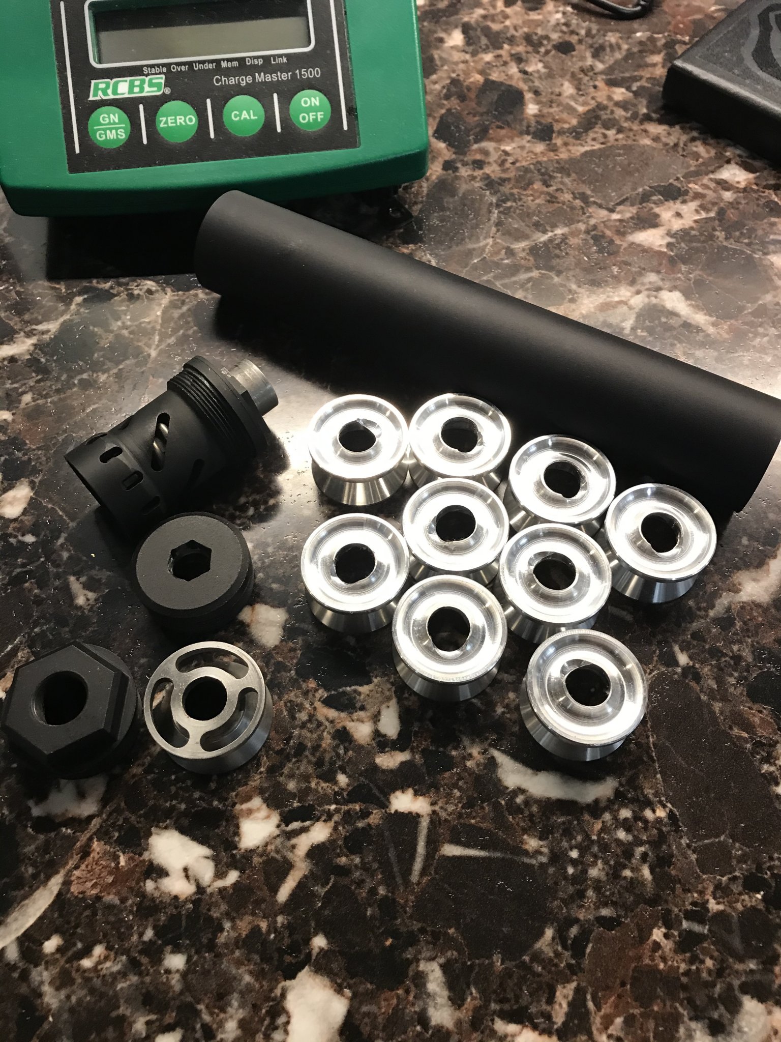

I've completed the .22 kit. 3.4 ounces on my kitchen scale. Happy. As it's my only suppressor exposure I do wonder how it compares db reduction wise to current top retail cans. Who has both that can give a comparison?
I've shot my 22 kit from QB side by side with a rimfire can from Silencer Central, both on Ruger Mark IVs. If there was any discernable difference at all, I would give the slight edge to my QB kit.
Considering I got mine in less than a month and it was nearly half the price of the retail can, I would say you can't go wrong with the QB 22 kit.
