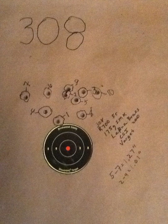

This is my first series of ladder tests. I feel like I got some good info from it. It appears that this thing doesn't care what you feed it. It just loves to eat. This is at 300 yds. I am thinking that 2-4 is where I need to focus. From about 4 up there was some cratering in the primers but no flattening primers. Please let me know what you think.

five thru seven look pretty good to me too. Please tell us what powder charges were in those three rounds.
It could very well be that what you think is a pressure sign is just a firing pin hole in the bolt that is a little over size. That is pretty common in the R700 these days.
44.1, 44.4, 44.7. That's what I thought about the cratering too. There weren't any other signs of pressure. If it is just an over sized FP hole would it not do it with any charge? Thanks.

Not necessarily with any charge. Another indication would be ejector swipes on the case head.
You are within Hodgdon's charge weight range for Varget. I have used 44.7 in several rifles and had great success. As a matter of fact, I use it now in my AI AW and it shoots great.

I've been testing loads with Varget and 175 SMK with my new AAC-SD and around 44.5 grains using Lapua brass seems to be the sweet spot.
I would do the 5-7 in .1gr increments and ideally push it out to 500 yards. Also remember that you are only really looking at the vertical stringing dont worry about windage at this point.
As was already mentioned the cratering is likely due to the slightly oversided firing pin hole I have a ar-10 that craters primers even with the lowest charge weights. Once you start seeing other signs of pressure like the primers flattening or ejector swipe etc I would start to worry but 5-7 should be a good group to try.
