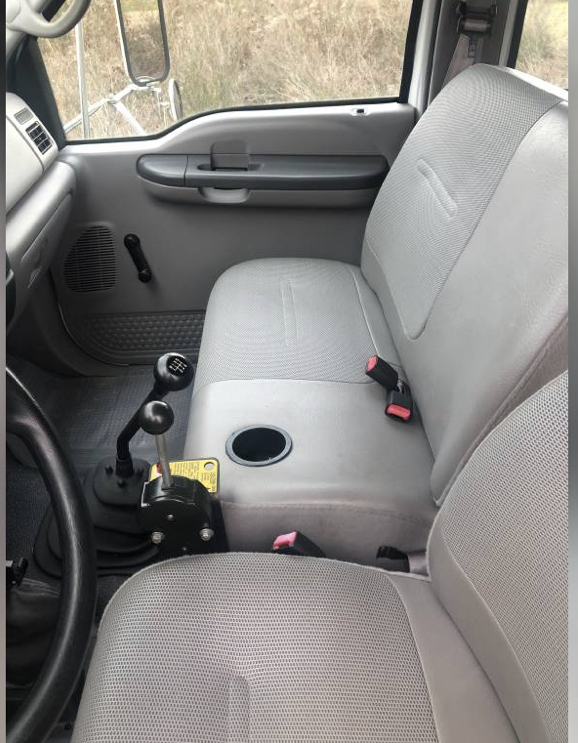

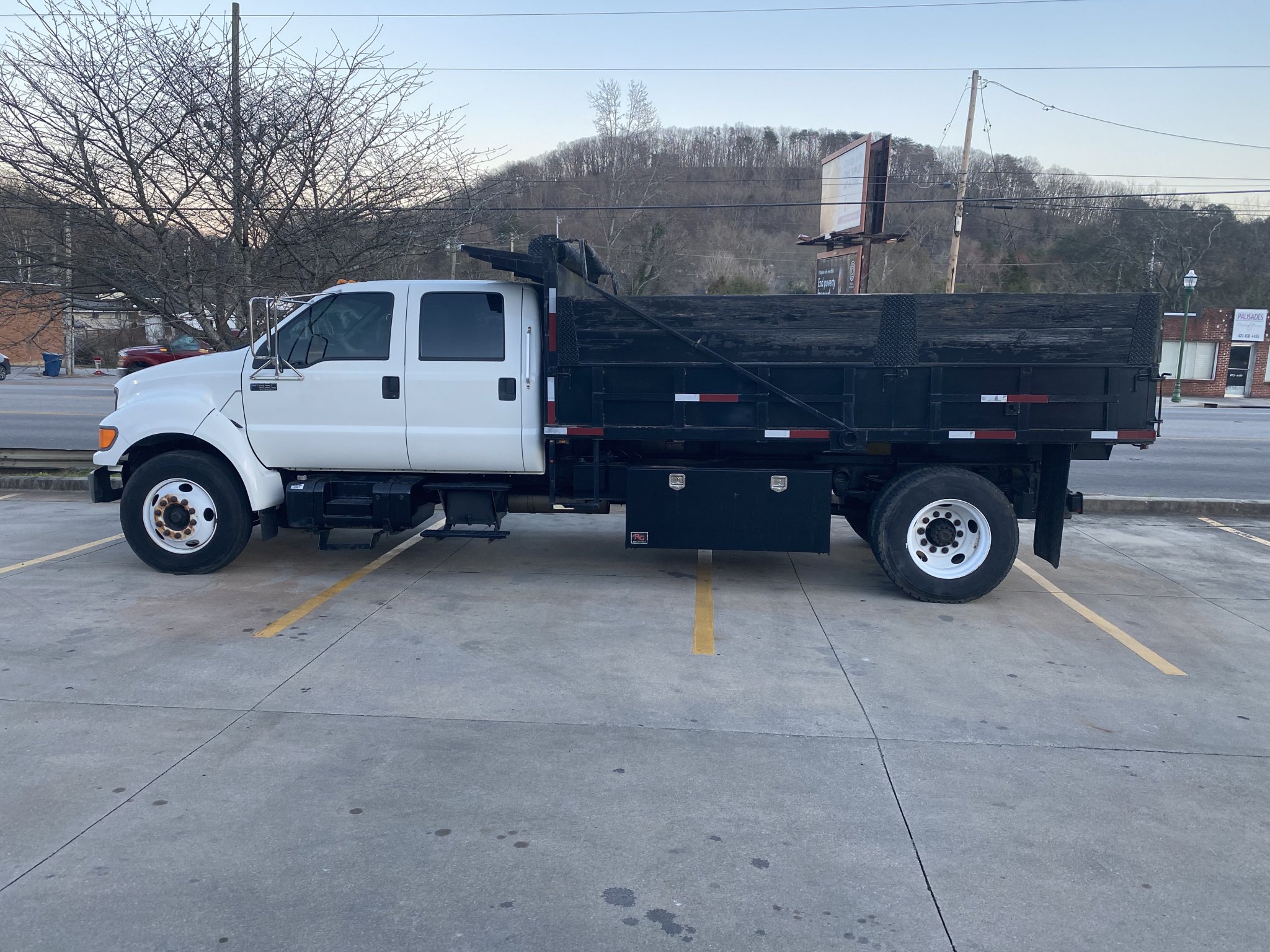

Well, I did some looking around and ended up actually buying a dump truck. 2000 F650 crew. 5.9 24v Cummins. 6sp Eaton trans. Twin cylinder hydraulic dump bed. Pintle hitch. Only had 13500 miles on it. Clean CARFAX. It had a bad injector pump, which was weird, but was drivable and solid elsewhere. Did not look at all like a used dump truck usually looks. New pump, air dog, 75 HP injectors and boost fooler, EGT gauge and it pulls like a choo choo train. Now I can still drive my f150 daily, which fits in my garage, and is paid for. I got it for a third of what a 3500 class truck would have cost new, repairs and all. I’ll be a tad over that with new rubber but still a bargain for the utility provided. Now I just need a Gatormade tilt trailer.
View attachment 7589689View attachment 7589687
That truck is 20+ years old???
Great shape. You got a bargain at any price.
