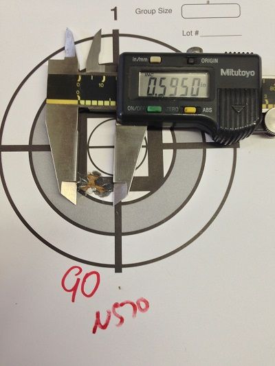

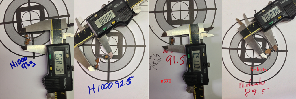

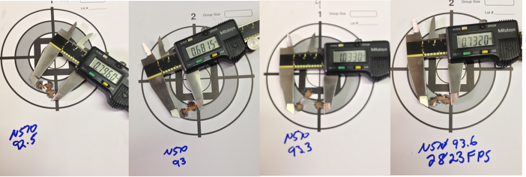

Here are pics of the sets of groups. One's in red are from a couple of weeks ago. My best with Retumbo also here which has been my go to charges. This is a 5 shot group with 89.5 at 2640fps and an identical group with 93.5 at 2840 that I can't find a pic of.
