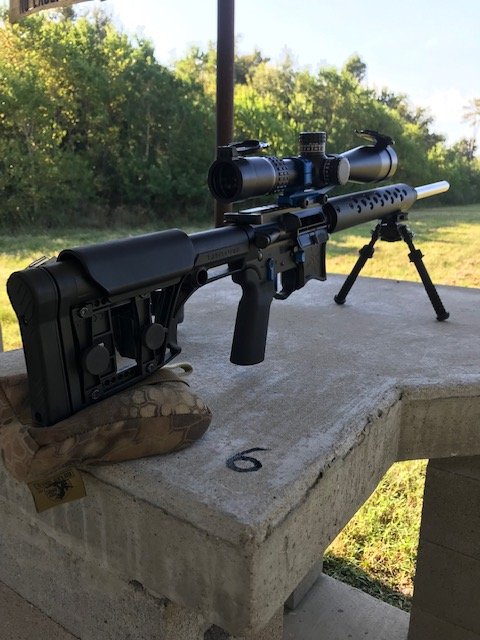

My own shooters:
That's a 12.5" Bartlein, above. Mount a big, fat NF ATACR and it will shoot 1/2" with good ammo. It's hard for me to do much better than MOA with the 1.5 MOA dot in the 8 power NF NX8. But, it's not a bench rest gun. Produces 14.5" chrome lined barrel velocities with the match chamber.
This rifle has a 16" Proof Research CFW barrel that shoots lights out with this old NF 2.5-10x42 NXS. Note the slick RMR mounted at 3 o'clock on the Spuhr mount. The gun is plenty quiet with the TDS Bantam II can, and at 8.5 ounces, you don't really know it's there.

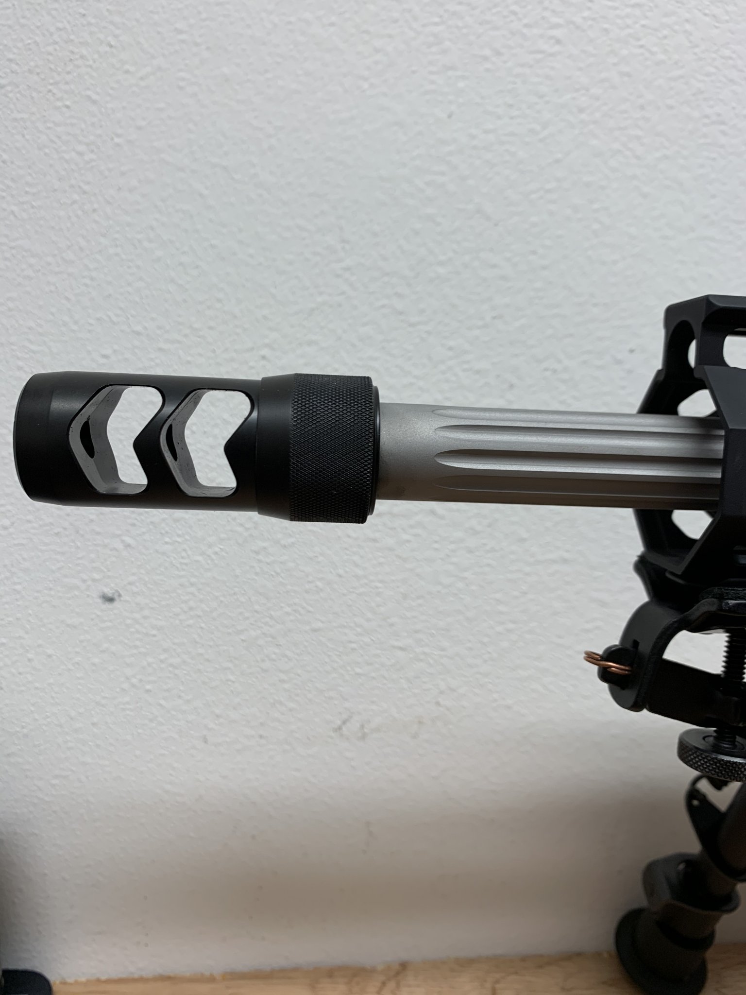

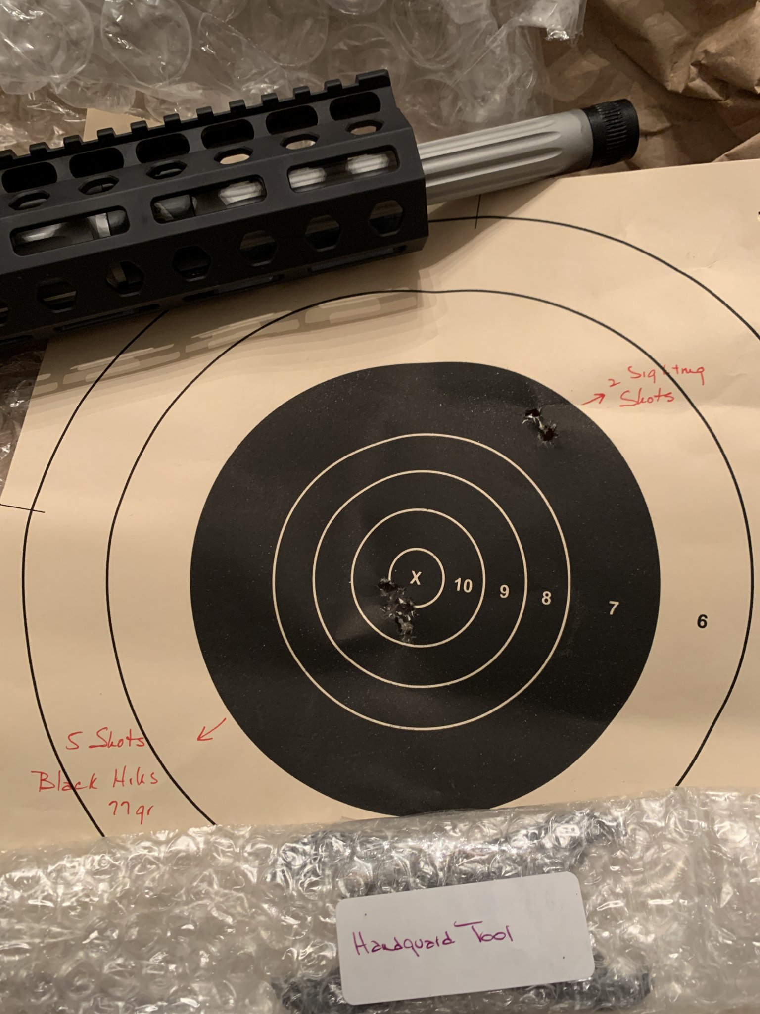

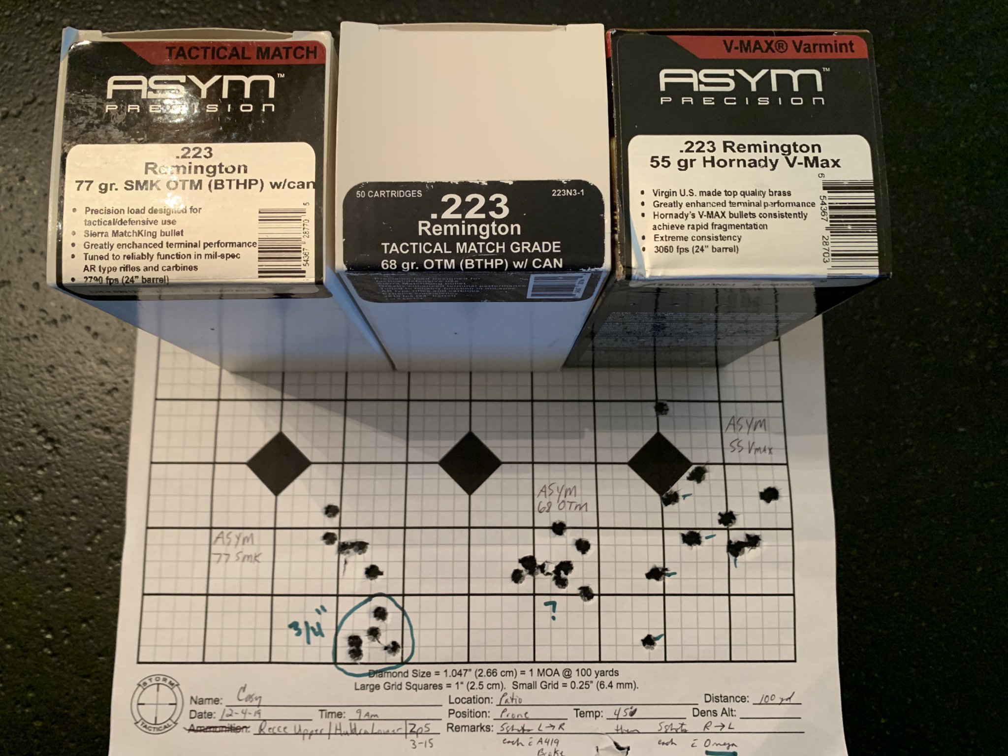

Ok, time for a bit of a review.
First, big thanks to @bigjake83 for reaching out to me with advice, sourcing parts and assembling this upper. I’ve always found the firearms community, and Sniper’sHide in particular, to be full of knowledgeable helpful folks, and Jake has been that and more!
The LaRue Stealth 2.0 rail/upper is very solid, while still slim in the hand, not too big or bulky. I really like it.
The Compass Lake barrel, CLE chamber, SDM contour, fluted and bead blasted, balances and handles well, lighter than I expected. The finish is excellent. Their customer service was top notch as well!
This upper is as handy as my BCM middy with RDS, and would do well with a LPVO. I’m running a Minox ZP5 3-15 to try to extend my range on smaller targets, and shooting paper at 100-300 yds to work on fundamentals. As was the plan, this setup can fill many roles.

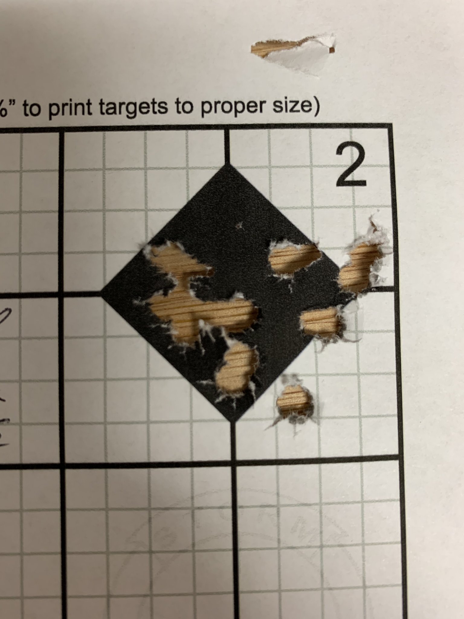

I’m still learning to shoot a precision semi-auto, and these groups reflect that. But I know the potential is there.
Shot Left to Right, 5 shot groups with 77, 68, 55 with Area419 brake.
Then shot Right to Left, 5 shot groups with 55, 68, 77 suppressed. The suppressed 77smk was best group, but with 1 1/2" shift. The 68otm was consistent with brake and suppressor. It doesn't like the Vmax as evidenced by the shotgun pattern. Black Hills 77smk comes in today...kicking myself for not getting a couple boxes of 68gr. I'm no accomplished marksman, but I'm confident in this rifle and with practice should be able to shoot respectably with it!

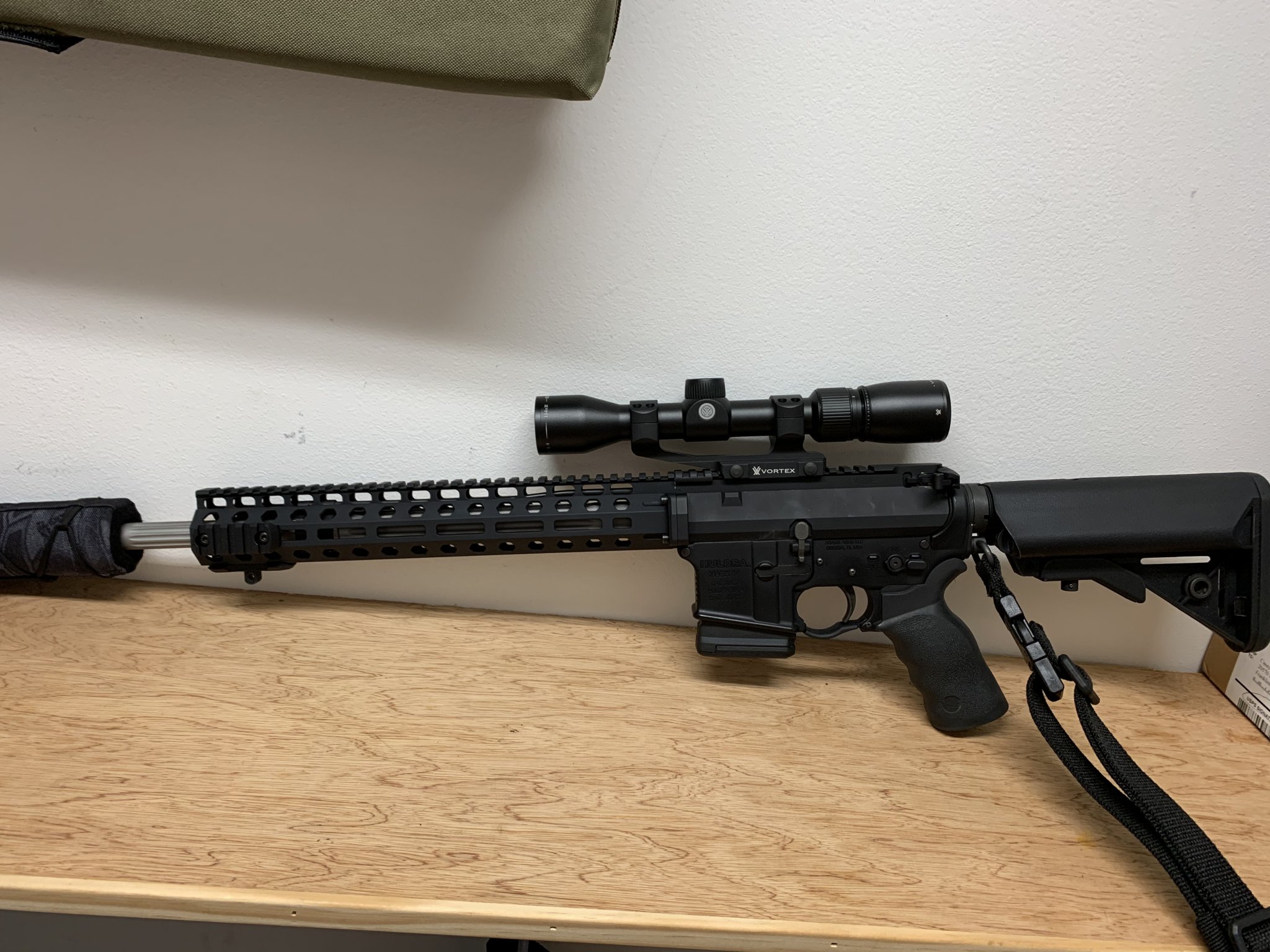

I’m running a BCM stainless upper with a 16 inch barrel and mid gas system. While it did seem to require a lengthy break in period now the thing is a tack driver. Paired with a LPVO, mag pull UBR stock it is a great shooting rifle, highly recommend BCM also have a White Oak barrel in a SPR they are worth checking out also
