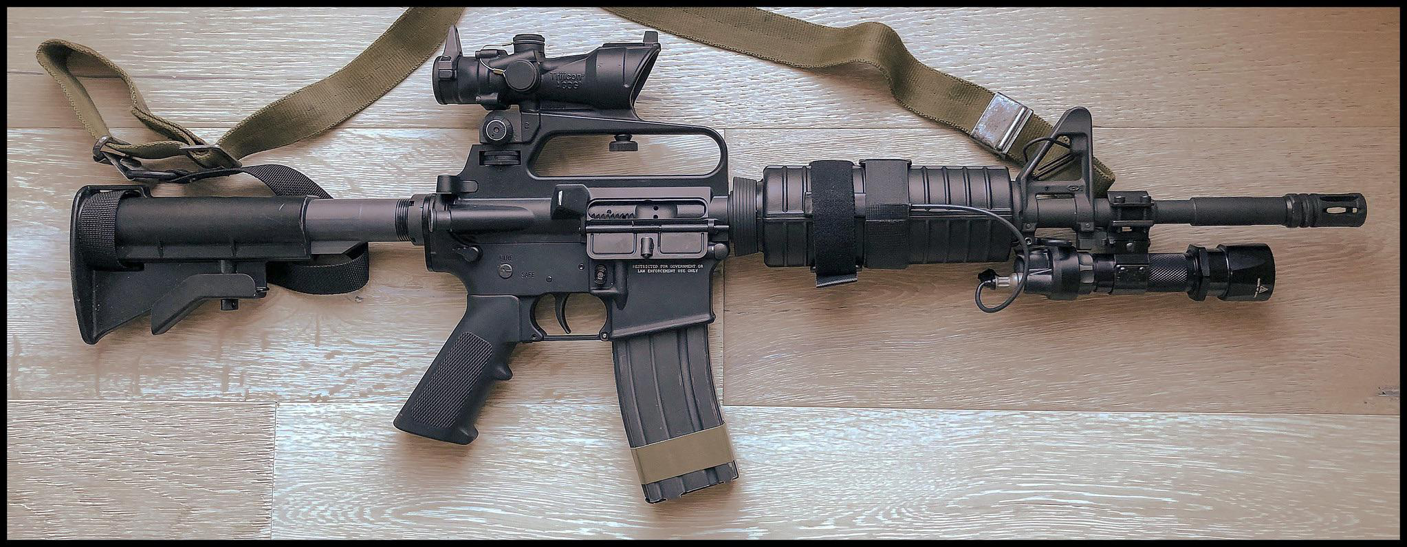

What's old is new again. Different way of doing it, but many years ago, high rise uppers were somewhat popular with a certain crowd, like this RRA EOP.
Reactions: Anb618 and XLR308
While I agree the old-is-new thing and things in this industry goes in cycles (to an annoying level), I can't ever recall this being able to be called even "somewhat popular".
Which crowd was into this?

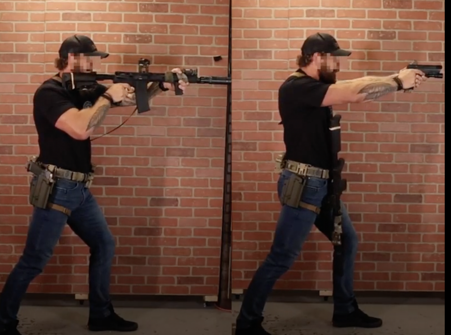

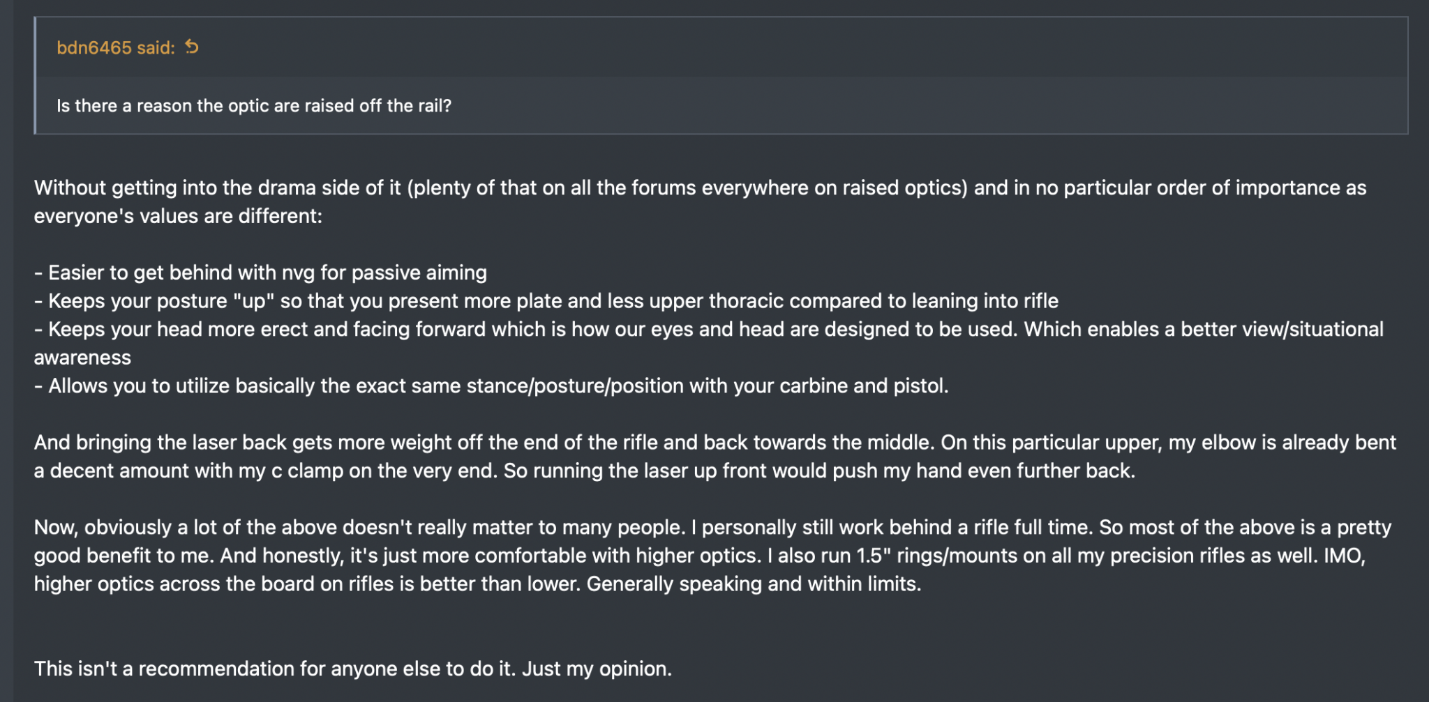

I just typed up an explanation not long ago. I'll post a screenshot below. Also posting a picture that illustrates how you can run your carbine and handgun with the same stance and such.....when you have a taller mount.
Not gonna get into all the drama and such concerning GBRS and such. I'll leave that to the reddit guys who nuthug all the different special operations units from their computers.
I'd personally put passive aiming with NVG at the bottom of the list. Especially anyone who isn't actually going to be up against a near peer enemy (which is probably 99% of anyone using nvg). You'll want to be using active aiming whenever possible.
And I'd definitely opt for an eotech over aimpoint if you're going to be doing any sort of passive aiming.

Still looks way off to me, the guy in the pic barely has the bottom edge/toe of the stock touching the top edge of the pocket in his shoulder.
I would think I would have been slapped in the back of the head by a DI if attempted during instruction or as a kid learning to shoot.
Like I mentioned earlier I would have to try one and see how it fits.

It's a carbine with a buffer and spring. Not like the recoil is going to push it off your shoulder.
Give it a try. Might not be for you. But most anyone I know who has tried elevated optics usually sticks with one of the three common heights (2.25, 2.50, 2.91). It really does make for a very comfortable experience.
We'd have all gotten slapped 20yrs ago doing stuff we do now. Evolution happens.

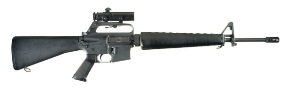

1.70 master race
Which is why we ended up with the A3 upper to bring the sight height back to were it was designed and intended.
Carry handles were standard when those sights were invented. It's impossible for them to have been "designed and intended" to be anywhere else. The aimpoint electronic g1 was first released in 1975. The first flat top ARs were from colt around 1990. And there were plenty of people who complained about losing the carry handle as they preferred their optics higher.
There was literally no design intent for the optics to be anywhere. Hence why there were multiple mounting options.

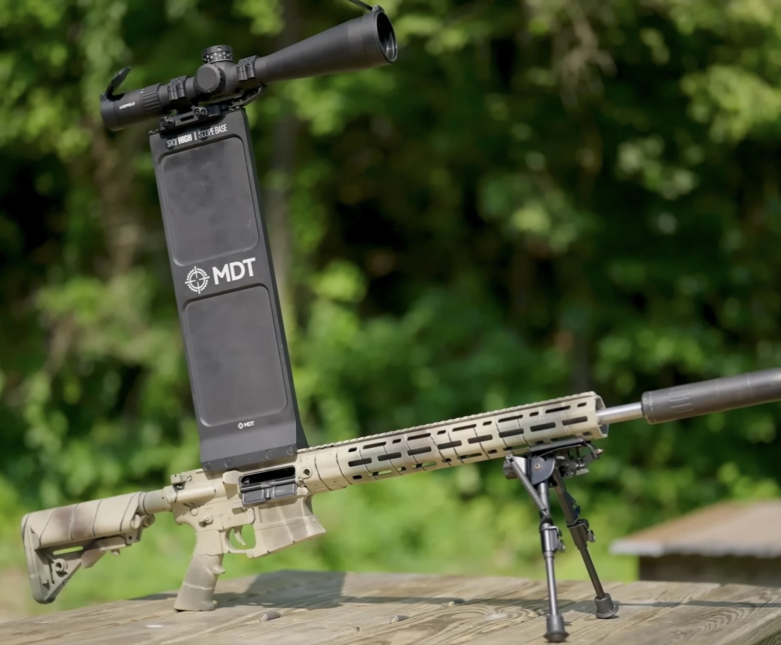

This is just a rehash of the same shit that happened in the precision rifle world when people started running 1.5" rings. Everyone insisted the optic should be as close to the barrel as possible.
