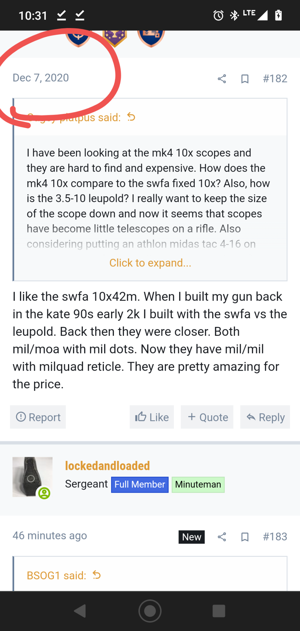

I have been looking at the mk4 10x scopes and they are hard to find and expensive. How does the mk4 10x compare to the swfa fixed 10x? Also, how is the 3.5-10 leupold? I really want to keep the size of the scope down and now it seems that scopes have become little telescopes on a rifle. Also considering putting an athlon midas tac 4-16 on cause it's one of the smaller scopes out there (have one on a different rifle and really like it).
Currently have a scope I had laying around mounted on the m24 but will be changing that out that down the line probably after Christmas and new years.
I like the swfa 10x42m. When I built my gun back in the late 90s early 2k I built with the swfa vs the leupold. Back then they were closer. Both mil/moa with mil dots. Now they have mil/mil with milquad reticle. They are pretty amazing for the price.
